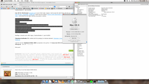

Only AMD builds. Only tested working builds. Post your successful OSX instalation, listing CPU, Motherboard (detailing what works and doesn't), OSX version, boot loader brand and revision, with the boot flags if possible, graphics, sound and any other information you can or want to share with your fellow AMD users.
I'll be the first:
AMD Athlon II X2 250 3.0 GHZ;
ECS EliteGroup A780 LM-MB:
- Audio codec VIA 1705 (working with Voodoo HDA)
- LAN RTL 8111E (not working)
- On-board video ATI HD3100 (not working, neither QE/CI nor resolution)
- 6 USB ports, 4 rear, two front, USB 2.0, all working
- PS2 working but unstable with VoodooPS2;
GeForce G210 VGA/DVI/HDMI - QE/CI with all outs in both Snow Leopard and Lion with GraphicsEnabler=Y, HDMI audio with VoodooHDA;
Network card (PCI-e): RTL 8168, worked out of the box;
Bluetooth USB dongle: Cambridge Silicon Radio Firmware v. 3164, bluetooth 2.4.5f3;
8 GB RAM;
3 HDs: 1x500GB (250 for each OS), 1x40GB (IDE, for Windows, not seen on OSX), 1x500GB (time machine);
Snow Leopard 10.6.8, 32-bit kernel from AnV (http://www.osx86.net...do=file&id=1675) with 64-bit user land: take a little while to boot, but shuts down and restart in less than 3 seconds. For using more than 4GB of RAM, i had to use this method: [GUIDE] Use more than 4gb RAM on AMD with 32 and 64 bit apps ..., bootflags: legacy_kernel arch=i386 -force64, GraphicsEnabler=Y, npci=0x2000;
Lion 10.7.5. 32-bit kernel (connactic.zip) in pure 32-bit mode (-legacy): had to swap the stock finder with this one: Finder from Lion DP 2 - Downloads - OSx86.net), iCloud with this method: iCloud for AMD hackintoshes: a workaround. - OSx86 10.7 (Lion ... and solved the core apps crashing using jeaton's method:
1) Wait for xpchelper to crash
2) Open terminal and type these in:
"sudo su"
"cd /private/var/folders"
"find /private/var/folders/ -type f | grep -i com.apple.xpchelper.cache"
3) cd to the first one that shows up on the list (it will be in a separate folder from the other xpchelper caches)
"rm -r com.apple.xpchelper.cache"
"pico com.apple.xpchelper.cache" ---> hit ctrl+o to save and ctrl+x to exit
"chflags uchg com.apple.xpchelper.cache"
4) Reboot and you're done!
Bootflags: connactic arch=i386 -legacy, GraphicsEnabler=Y, npci=0x2000;
Chameleon bootloader 2.2, installed with this package (no modules selected): Chameleon 2.2svn r2117 - Downloads - OSx86.net
Least but not last: Geekbench 64bit: 4450! (screenshot in the zip file: Screen shot 2012-12-19 at 7.18.55 AM.png.zip)
Post yours!

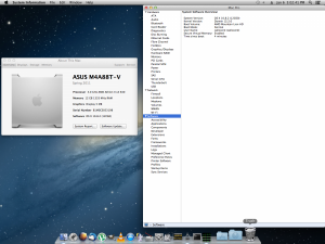

Here's mine, it's an Acer Aspire X3400-U4032:
CPU: AMD Athlon II X4 645 3.1 GHz
RAM: 6 GB 1600 MHz DDR3 (2x 1 GB, 2x 2 GB)
Hard Drive: WDC WD10EARS-22Y5B1 1 TB
Graphics: ASUS EAH5450 SILENT 512MB, full QE/CI with this, only VGA and DVI tested; Onboard NVIDIA GeForce 9200 no QE/CI
Network: Ralink RT3090; Using self-built X86 Wifi; Ethernet not tested.
Audio: Using AppleAzaliaAudio.kext, back audio-out port working.
PS/2: Not tested.
Optical drive: HL-DT-ST DVDRAM GH60N working
I/O Ports: 3/4 Back USB working, 2/5 front USB working. Tested front headphone jack, not working.
Now on to my OS X configuration:
Snow Leopard: Successfully installed with the following guide: http://philtesone.com/hackintosh/; 64-bit Snow Leopard success, although no sound.
Lion: Successfully installed using this guide: http://www.insanelym...erimental-only/ then updated to 10.7.5 using the method theconnactic mentioned.
Mountain Lion: Successfully installed with iATKOS_ML2 and AnV's latest amd_kernel! Retail installer crashes:

I booted with the following flags:
npci=0x2000 GraphicsEnabler=Yes -v
I used the kernel "test2" here and AnV's corecrypto found at the first post of this thread.
Thanks to the devs for their hard work and dedication to the AMD Hackintosh scene!
:soldiers:
For complete installation and mods, check out my guide here: http://acert0sh.weebly.com
Who's next? :afro:

Me me me!
CPU: AMD Athlon II x4 640 3.0 GHz
Motherboard: ASUS M4A88T-V EVO/USB3
SB/NB: AMD 880G/AMD SB710
RAM: 12GB 1333 MHz DDR3 (2x2GB, 2x4GB)
SATA: Any device attached to the onboard SATA or eSATA (AHCI set in BIOS, of course) port works just fine.
IDE: Not detected. Google's not being helpful, and I'm being lead to believe that perhaps there is no OS X driver for AMD IDE controllers.
USB 2.0: All four rear ports plus the three internal headers work perfectly.
USB 3.0: I don't have any USB 3 devices, so I have no idea. USB 2 devices plugged in work fine.
Firewire: Quickly tested it. The HDD shows up in Disk Utility, so I say it works.
GPU: XFX ATI Radeon HD 5670 1GB (Works perfectly in Snow Leopard 10.6.8 and Lion 10.7.5.)
LAN: Realtek RTL8168B PCI-Express (onboard) (Works with Lnx2Mac's RTL8XXX driver.)
Sound: Intel HDA (Azalia) (I'm sure this would work fine if only I could figure out DSDT patching... Using AppleAzaliaAudio.kext for now.)
PS2: I am now typing this on an old PS2 HP keyboard with VoodooPS2Controller.kext, so I guess it works.
Bootloader: Chameleon v2.1svn ErmaC (Trunk) r1926
