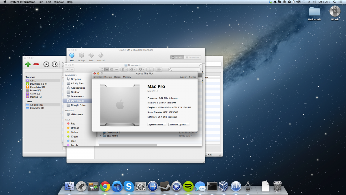

CPU: AMD FX 8320
GPU: GIGABYTE GEFORCE GTX 670 (Running Dual Monitor) (Works, subpar performance)
Motherboard: ASUS M5A78L-M/USB3
RAM: 8GB 1600MHz (667mhz wat?)
HDD: Intel 335 240GB
USB : 2.0 All working
LAN: Realtek RTL8111 (Works with RTL8111 driver)
Sound: O2+DAC (Standard USB Sound Device, works)
Sleep: Not Tested (Not Needed)
Geekbench was 9900 something, and Cinebench OpenGL was only 40 fps :(
God I love the AMD kernel hackers. To boot I use GraphicsEnabler=Yes PCIRootUID=1 or else I get Black display / screen after bootsplash. The Graphics performance is under Linux and Windows, can play Dota 2 and stuff but Minecraft.. oh god Minecraft is really {censored}.
  • When launching mission control the UI isn't so smooth.
  • Tried editing AGPM to my device and change everything to 100, nothing changed :(
  • Also tried changing to this kernel by andy with full SSE4 support link but alas no change, probably 5 percent faster.
  • I even did download the new nvidia driver for mavericks, got it from some guy somewhere, nothing changed so must be the kernel.
How does Minecraft run for you guys?, should I ask in the kernel testing thread? I am really an idiot when it comes to hackintoshing. Been running for over a day now and its really stable, so it's stable atleast with no memory leaks ;)
