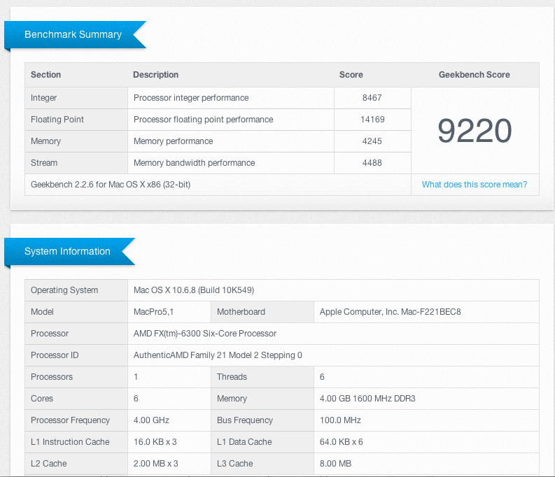

rajkunisetti Posted August 15, 2013 Share Posted August 15, 2013 I successfully installed mountain lion 10.8.4 on my amd pc.Here are my specs CPU - AMD fx-6300 six core 3.5 ghz (code name VISHERA) MOBO - Gigabyte GA-78lmt s2pt(rev 4...) GPU -AMD Radeon HD 7750 (Gigabyte OC'd) - working with screen rotation trick. SOUND- ALC887 (voodoo 2.8.2) LAN - ATHEROS AR8161 (ALX kext) PS2 -keyboard and mouse BOOTLOADER -chameleon 2.2 svn2256 KERNEL - Sinutek's fx kernel os x 10.8.4 using myhack method.All are fine but lot of graphic glitches Link to comment https://www.insanelymac.com/forum/topic/285110-amd-working-builds/page/4/#findComment-1939037 Share on other sites More sharing options...

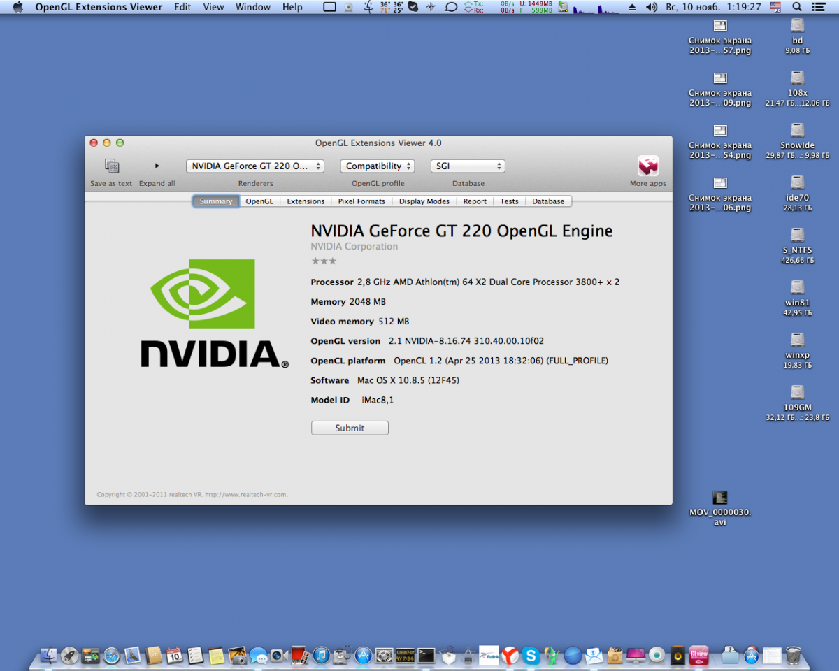

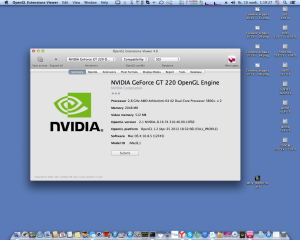

granik Posted October 2, 2013 Share Posted October 2, 2013 - AMD Athlon 64 X2 3800+ Manchester - DFI LANParty UT NF4 SLI-DR Expert / No AHCI - Dual ch OCZ EL PC3200 Platinum Rev2 1024 - HIS ATI X1300 IceQ Turbo 256MB DDR2 PCIe - ALC850 / AC97 Internal sound SNOW LEOPARD - Screen + bench Install ; Hazard 10.6.6i -> 10.6.8 Kernel ; Nawcom 10.8 v2, flags ; arch=i386 -force64 Graphic ; Natit + RadeonHD Framebuffer (QE/CI) Sound ; AppleAC97Audio LION - Screen + bench Install ; Retail 10.7.4. Tested ; Retail 10.7.2 + iAtkos L2, Niresh 10.7.3, 10.7.5 Virgin install image Kernel ; RAW:86/Sinetek/Connactic (x86), flags ; arch=i386 -legacy. IiTz ShAnE build (x64), flags ; -nossse3bit * bronzovka latest kernel failed, instant reboot.. too bad Graphic ; DSDT (QE/CI) Sound ; AppleAC97Audio (x86) MOUNTAIN LION - Screen + bench Install ; iAtkos ML2 Kernel ; Andy Vandijck (md5: 8F8E8B639E2CFB37293EDE5A34458B49), no-flags Graphic ; DSDT + 10.7.5 ATI kexts (No - QE/CI) Sound ; AppleAC97Audio (x86) * All need "VoodooTSCSyncAMD" to reduce lag + hang Thanks to all developers who made this happen can you provide a link to Kernel ; Andy Vandijck (md5: 8F8E8B639E2CFB37293EDE5A34458B49), no-flags ? Link to comment https://www.insanelymac.com/forum/topic/285110-amd-working-builds/page/4/#findComment-1950119 Share on other sites More sharing options...
