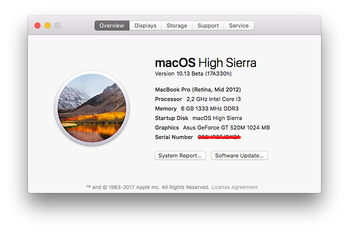

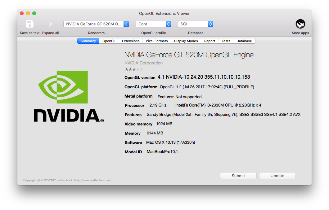

Sherlocks Posted August 14, 2017 Share Posted August 14, 2017 Sorry, my 2nd Gen. laptop with SingleNvidia doesn't use such graphics, but since U've also committed this: [4164] "Update id of NVIDIA Fermi/Kepler/Maxwell/Pascal families", ...so I give U some reports from another Nvidia Fermi variant: GT520M (10de:1050 aka GF119M). Using 10.13 Beta 5 (17A330h) with Clover v2.4k r4166 all are still good. Some minor issues that I (actually) don't really care are: 1. with InjectNvidia=False & w/o @rehabman's GT520M DSDT patch, my Graphics on ATM shows only 1023MB VRam. 2. with InjectNvidia=True & w/o GT520M DSDT patch it shows "Asus GT520M" (NP, as seen on nvidia.c Platform; 0x1043 is detected as Asus, so the graphics injection is working well). VRam shown properly as it is: 1024MB. 3. with InjectNvidia=False and using GT520M DSDT patch, ATM shows my graphics as Nvidia and 1024MB VRam (it's just "cosmetics" for sure ) Overall, is still good (for now) since my QE/CI works well. For El Capitan I stick with No. 3 but using Nvidia Web Driver. Minor issues are exactly same. Thanks. #EDIT: Plz ignore my 3rd party kexts logs from EFI folder except FakeSMC & PS2, since some of them (maybe) obsolete or even not working under 10.13. First of all, thank you for detail test.Ram size issue is just cosmetic. I see your all log. Log fine that my think and theroy. I don't know exactly El capitan issue. I have a 525m model. I can success install and qc/ei on el capitan. Thanks 나의 LG-F800S 의 Tapatalk에서 보냄 Here is the bootlog for 1070 with and without injectionI will send pm. Check please thanks. 나의 LG-F800S 의 Tapatalk에서 보냄 1 Link to comment https://www.insanelymac.com/forum/topic/284656-clover-general-discussion/page/562/#findComment-2478989 Share on other sites More sharing options...

xtddd Posted August 15, 2017 Share Posted August 15, 2017 Sorry, my 2nd Gen. laptop with SingleNvidia doesn't use such graphics, but since U've also committed this: [4164] "Update id of NVIDIA Fermi/Kepler/Maxwell/Pascal families", ...so I give U some reports from another Nvidia Fermi variant: GT520M (10de:1050 aka GF119M). Using 10.13 Beta 5 (17A330h) with Clover v2.4k r4166 all are still good. Some minor issues that I (actually) don't really care are: 1. with InjectNvidia=False & w/o @rehabman's GT520M DSDT patch, (Native) my Graphics on ATM shows only 1023MB VRam. 2. with InjectNvidia=True & w/o GT520M DSDT patch it shows "Asus GT520M" (NP, as seen on nvidia.c Platform; 0x1043 is detected as Asus, so the graphics injection is working well). VRam shown properly as it is: 1024MB. 3. with InjectNvidia=False and using GT520M DSDT patch, ATM shows my graphics as Nvidia and 1024MB VRam (it's just "cosmetics" for sure ) Overall, is still good (for now) since my QE/CI works well. For El Capitan I stick with No. 3 but using Nvidia Web Driver. Minor issues are exactly same. Thanks. #EDIT: Plz ignore my 3rd party kexts logs from EFI folder except FakeSMC & PS2, since some of them (maybe) obsolete or even not working under 10.13. #EDIT2: Sorry, forgot to mention: both on 10.13 Beta or 10.11.6 use MBP10,1 as SMBios. Cheers! hi,,my laptop is also 2nd.thinkapd w520.... the graphic of nvidia quadro 1000m has no QE/CI on 10.13 beta1 but works well on 10.12.6 with dsdt patch. Link to comment https://www.insanelymac.com/forum/topic/284656-clover-general-discussion/page/562/#findComment-2479240 Share on other sites More sharing options...
