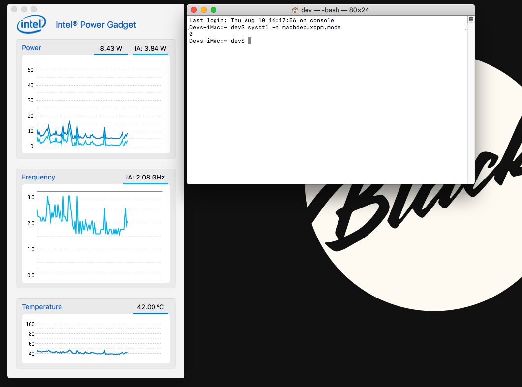

Cyberdevs Posted August 10, 2017 Share Posted August 10, 2017 Hi, what will it return when typing in this in Terminal? sysctl -n machdep.xcpm.mode Hi, could you please try removing the first patch and attempt to boot with Clover r4155+? Thanks in advance. Sure thing, Just give me a minute to prepare a bootable USB with clover r4155. I'll be back with the results Link to comment https://www.insanelymac.com/forum/topic/284656-clover-general-discussion/page/560/#findComment-2477278 Share on other sites More sharing options...
chris1111 Posted August 10, 2017 Share Posted August 10, 2017 Hi, what will it return when typing in this in Terminal? sysctl -n machdep.xcpm.mode Hi, could you please try removing the first patch and attempt to boot with Clover r4155+? Thanks in advance. This Link to comment https://www.insanelymac.com/forum/topic/284656-clover-general-discussion/page/560/#findComment-2477281 Share on other sites More sharing options...
PMheart Posted August 10, 2017 Share Posted August 10, 2017 This Ok. Congratulations, your XCPM would be fine then! 1 Link to comment https://www.insanelymac.com/forum/topic/284656-clover-general-discussion/page/560/#findComment-2477282 Share on other sites More sharing options...
Cyberdevs Posted August 10, 2017 Share Posted August 10, 2017 There you go Link to comment https://www.insanelymac.com/forum/topic/284656-clover-general-discussion/page/560/#findComment-2477285 Share on other sites More sharing options...
PMheart Posted August 10, 2017 Share Posted August 10, 2017 There you go No. XCPM is not enabled. Could you please post your config? (Remove SN etc of course) Link to comment https://www.insanelymac.com/forum/topic/284656-clover-general-discussion/page/560/#findComment-2477288 Share on other sites More sharing options...

Matgen84 Posted August 10, 2017 Share Posted August 10, 2017 @PMHeart All test is under Sierra 10.12.6 As cyberdev :I added the <key>KernelIvyXCPM</key> and <key>AppleIntelCPUPM</key> and the results is 0 As Chris1111: I added the <key>KernelIvyXCPM</key> <key>AppleIntelCPUPM</key> <key>KernelPm</key> ans the results is 0 I still have the patch for testing Edit: with the patch, sysctl -n machdep.xcpm.mode The result is 0 Link to comment https://www.insanelymac.com/forum/topic/284656-clover-general-discussion/page/560/#findComment-2477426 Share on other sites More sharing options...

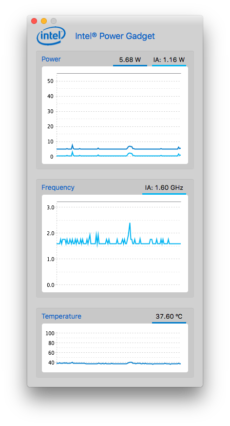

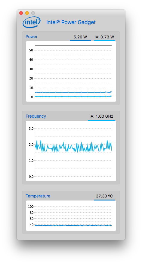

Cyberdevs Posted August 10, 2017 Share Posted August 10, 2017 Absolutely. AppleIntelCPUPM will patch AICPUPM.kext, but with XCPM in place it won't even be loaded, so patching it just makes no sense. The only thing that I need to know now is without the <key>KernelIvyXCPM</key> and with the previous patches in post I had more subtle power management while the system was idle as you can see in my power gadget graphs which is not the same with the new patch is that normal? Link to comment https://www.insanelymac.com/forum/topic/284656-clover-general-discussion/page/560/#findComment-2477452 Share on other sites More sharing options...

PMheart Posted August 10, 2017 Share Posted August 10, 2017 The only thing that I need to know now is without the <key>KernelIvyXCPM</key> and with the previous patches in post I had more subtle power management while the system was idle as you can see in my power gadget graphs which is not the same with the new patch is that normal? You were lack of the critical patch - _xcpm_bootstrap from what I could see in your old post. So XCPM wasn't really enabled, and previous you were probably playing with AICPUPM. To be honest, it's hard for me to say the difference with the two screenshots that you posted. 1 Link to comment https://www.insanelymac.com/forum/topic/284656-clover-general-discussion/page/560/#findComment-2477458 Share on other sites More sharing options...

Cyberdevs Posted August 10, 2017 Share Posted August 10, 2017 You were lack of the critical patch - _xcpm_bootstrap from what I could see in your old post. So XCPM wasn't really enabled, and previous you were probably playing with AICPUPM. To be honest, it's hard for me to say the difference with the two screenshots that you posted. Fair enough, I will do some more tests and see how it goes Update: If there's anything that I can provide to help out I'll be more than happy to oblige. Link to comment https://www.insanelymac.com/forum/topic/284656-clover-general-discussion/page/560/#findComment-2477471 Share on other sites More sharing options...
