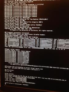

PMheart Posted August 10, 2017 Share Posted August 10, 2017 MSI Z77A-GD65 i7 3770K Not working AptioFix2 - Error, timer 10 sec AptioFix - Reboot This is more likely an Aptiofix driver problem. Not the bug of KernelIvyXCPM. As for AptioFix (v1) you should disable SIP, at least NVRAM protection. (0x40) By the way, this is not a topic for discussions, we'd better contact an administrator to move our posts to somewhere else. Link to comment https://www.insanelymac.com/forum/topic/284656-clover-general-discussion/page/559/#findComment-2477161 Share on other sites More sharing options...

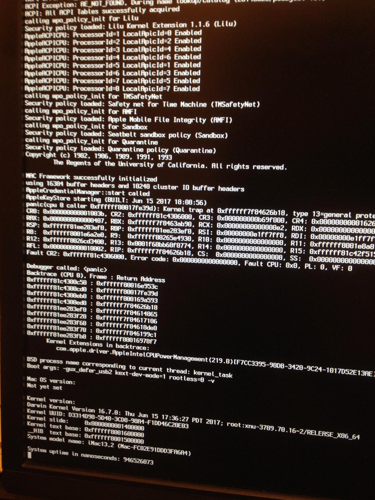

PMheart Posted August 10, 2017 Share Posted August 10, 2017 I've a issue with KernelIvyXCPM alone in Clover r4155. I use Aptiofix2: and AsusAICPUPM or AICPUPM to false, I"ve panic cpu on my system. That's weird. With KernelIvyXCPM, AICPUPM.kext should never be loaded. If your MSR 0xE2 bit 15 is locked then you may also need to turn on KernelPm besides KernelIvyXCPM. I must flag this as a bad answer, sorry.. Slice will never told to existing users (and I saw gujiangjiang is an active users & with great feedbacks so far) to clone & destroy his project to something not even better without knowing their skills first ... Any instrument can be dangerous in improper hands? Or maybe more extreme to told like: Why you dont just switch to other bootmanager on next door which lot more simpler? Never. Do you know wheres @savvas now? Hi, never mind. I must admit that I was radical. And apologies to @gujiangjiang. I wish that the meaningless quarrels would be stopped for the time being. As for @savvas, I remembered that he and Slice gave me some hints on fv2 hibernation and now it starts working. Where is he now? Sorry I just don't know... 1 Link to comment https://www.insanelymac.com/forum/topic/284656-clover-general-discussion/page/559/#findComment-2477228 Share on other sites More sharing options...
Matgen84 Posted August 10, 2017 Share Posted August 10, 2017 That's weird. With KernelIvyXCPM, AICPUPM.kext should never be loaded. If your MSR 0xE2 bit 15 is locked then you may also need to turn on KernelPm besides KernelIvyXCPM. With KernelIvyXCPM + KernelPM = same issue on my system (Asus P8z77-v pro, Core i7 3770K)----> panic cpu Link to comment https://www.insanelymac.com/forum/topic/284656-clover-general-discussion/page/559/#findComment-2477230 Share on other sites More sharing options...
PMheart Posted August 10, 2017 Share Posted August 10, 2017 With KernelIvyXCPM + KernelPM = same issue on my system (Asus P8z77-v pro, Core i7 3770K)----> panic cpu Besides these two ones, could you please try adding this one (via KernelToPatch) and continue testing? Thanks. Find: BE 0B 00 00 00 5D E9 08 00 00 00 0F 1F 84 00 00 00 00 00 55 48 89 E5 41 57 Replace: BE 0B 00 00 00 5D E9 08 00 00 00 0F 1F 84 00 00 00 00 00 C3 48 89 E5 41 57 2 Link to comment https://www.insanelymac.com/forum/topic/284656-clover-general-discussion/page/559/#findComment-2477239 Share on other sites More sharing options...
Matgen84 Posted August 10, 2017 Share Posted August 10, 2017 Besides these two ones, could you please try adding this one (via KernelToPatch) and continue testing? Thanks. Find: BE 0B 00 00 00 5D E9 08 00 00 00 0F 1F 84 00 00 00 00 00 55 48 89 E5 41 57 Replace: BE 0B 00 00 00 5D E9 08 00 00 00 0F 1F 84 00 00 00 00 00 C3 48 89 E5 41 57 Sorry, I don't how to add this: can you explain how to? I'll continue to test later this afternoon. Thanks Link to comment https://www.insanelymac.com/forum/topic/284656-clover-general-discussion/page/559/#findComment-2477243 Share on other sites More sharing options...
PMheart Posted August 10, 2017 Share Posted August 10, 2017 Sorry, I don't how to add this: can you explain how to? I'll continue to test later this afternoon. Thanks Just copy/paste it under KernelToPatch sections. Perhaps Clover Configurator or CCE help you... Link to comment https://www.insanelymac.com/forum/topic/284656-clover-general-discussion/page/559/#findComment-2477245 Share on other sites More sharing options...

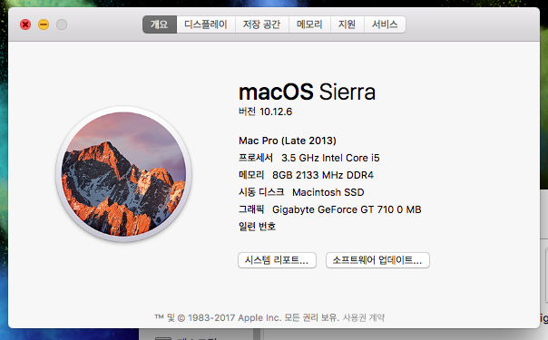

Sherlocks Posted August 10, 2017 Share Posted August 10, 2017 First of all my laptop working vers good with out the new patch see my Geekbench Testing the patch on HP Probook 6570b CPU i5 3440m I try to ad the patch <key>KernelIvyXCPM</key> <true/> Not working , Instant reboot, sorry for bad news Chris1111I i use inject nvidia without ramsize on gt 710, shown ramsize 0. You too? I guess some bug on some ramsize over. 8600 gt did no problem about ram size 256mb. This issue reported by FredWst. Also im checking. Sorry for my bad english 나의 LG-F800S 의 Tapatalk에서 보냄 Link to comment https://www.insanelymac.com/forum/topic/284656-clover-general-discussion/page/559/#findComment-2477249 Share on other sites More sharing options...
chris1111 Posted August 10, 2017 Share Posted August 10, 2017 Chris1111 I i use inject nvidia without ramsize on gt 710, shown ramsize 0. You too? I guess some bug on some ramsize over. 8600 gt did no problem about ram size 256mb. Sorry for my bad english 나의 LG-F800S 의 Tapatalk에서 보냄 This card working Inject Nvidia = false 2047 Vram Not need Web Drivers Link to comment https://www.insanelymac.com/forum/topic/284656-clover-general-discussion/page/559/#findComment-2477252 Share on other sites More sharing options...
PMheart Posted August 10, 2017 Share Posted August 10, 2017 First of all my laptop working verry good with out the new patch see my Geekbench Testing the patch on HP Probook 6570b CPU i5 3440m I try to ad the patch <key>KernelIvyXCPM</key> <true/> Not working , Instant reboot, sorry for bad news Hi, maybe you need to also turn on KernelPm? Link to comment https://www.insanelymac.com/forum/topic/284656-clover-general-discussion/page/559/#findComment-2477254 Share on other sites More sharing options...
Sherlocks Posted August 10, 2017 Share Posted August 10, 2017 This card working Inject Nvidia = false 2047 Vram Not need Web Drivers Just case if check inject nvidia. I found ram size issue. 나의 LG-F800S 의 Tapatalk에서 보냄 EDIT1 here ofc without inject nvidia, our card is working good. 4:671 0:000 mem_detected 12841767665664Mb 4:671 0:000 read_nVidia_ROM 4:671 0:000 Using PRAMIN fixups 4:767 0:096 PROM 4:971 0:203 version 80.28.A6.00.58 4:971 0:000 nVidia Gigabyte GeForce GT 710 -184549376MB NV106 [10DE:128B] :: PciRoot(0x0)\Pci(0x1,0x0)\Pci(0x0,0x0) => device #1 4:971 0:000 Nvidia: VideoPorts: undefined, default to: 2 EDIT2 some users reported this issue in clover bug/report thread about 1~2months ago EDIT3 if i put ramsize "2047" on config.plist, there is no problem. just cosmetic issue. EDIT4 i will debug and fix this issue. 1 Link to comment https://www.insanelymac.com/forum/topic/284656-clover-general-discussion/page/559/#findComment-2477255 Share on other sites More sharing options...

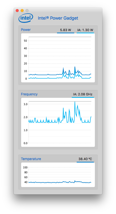

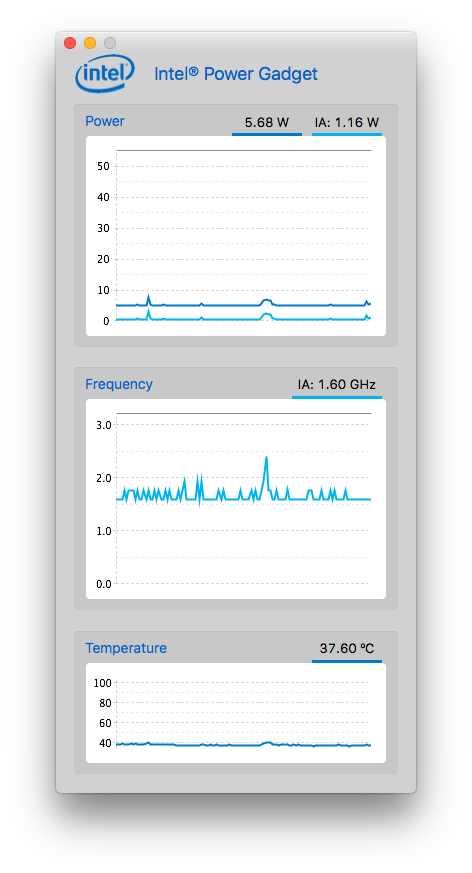

Cyberdevs Posted August 10, 2017 Share Posted August 10, 2017 Everything seems to be working fine on my IvyBridge i3 3210. macOS High Sierra 17A330h Clover r4156 I'm using these patches under KernelToPatch: F: 554889e5 41574156 41554154 53504189d64889fb 85f60f84 84000000 R: c39089e5 41574156 41554154 53504189d64889fb 85f60f84 84000000 Commenst: Comment xcpm_program_msrs ⓒ Pike R. Alpha MatchOS: 10.13.x and F: 89d8c1e0 084863d0 R: b800ff00 004863d0 comments: xcpm performance fix(wrsmr fix to get CPU max) ⓒ okrasit MatchOS: 10.13.x Link to comment https://www.insanelymac.com/forum/topic/284656-clover-general-discussion/page/559/#findComment-2477266 Share on other sites More sharing options...

PMheart Posted August 10, 2017 Share Posted August 10, 2017 Edit*** BootLog attaching Hi, what will it return when typing in this in Terminal? sysctl -n machdep.xcpm.mode Everything seems to be working fine on my IvyBridge i3 3210. macOS High Sierra 17A330h Clover r4156 I'm using these patches under KernelToPatch: F: 554889e5 41574156 41554154 53504189d64889fb 85f60f84 84000000 R: c39089e5 41574156 41554154 53504189d64889fb 85f60f84 84000000 Commenst: Comment xcpm_program_msrs ⓒ Pike R. Alpha MatchOS: 10.13.x and F: 89d8c1e0 084863d0 R: b800ff00 004863d0 comments: xcpm performance fix(wrsmr fix to get CPU max) ⓒ okrasit MatchOS: 10.13.x Hi, could you please try removing the first patch and attempt to boot with Clover r4155+? Thanks in advance. 1 Link to comment https://www.insanelymac.com/forum/topic/284656-clover-general-discussion/page/559/#findComment-2477273 Share on other sites More sharing options...
