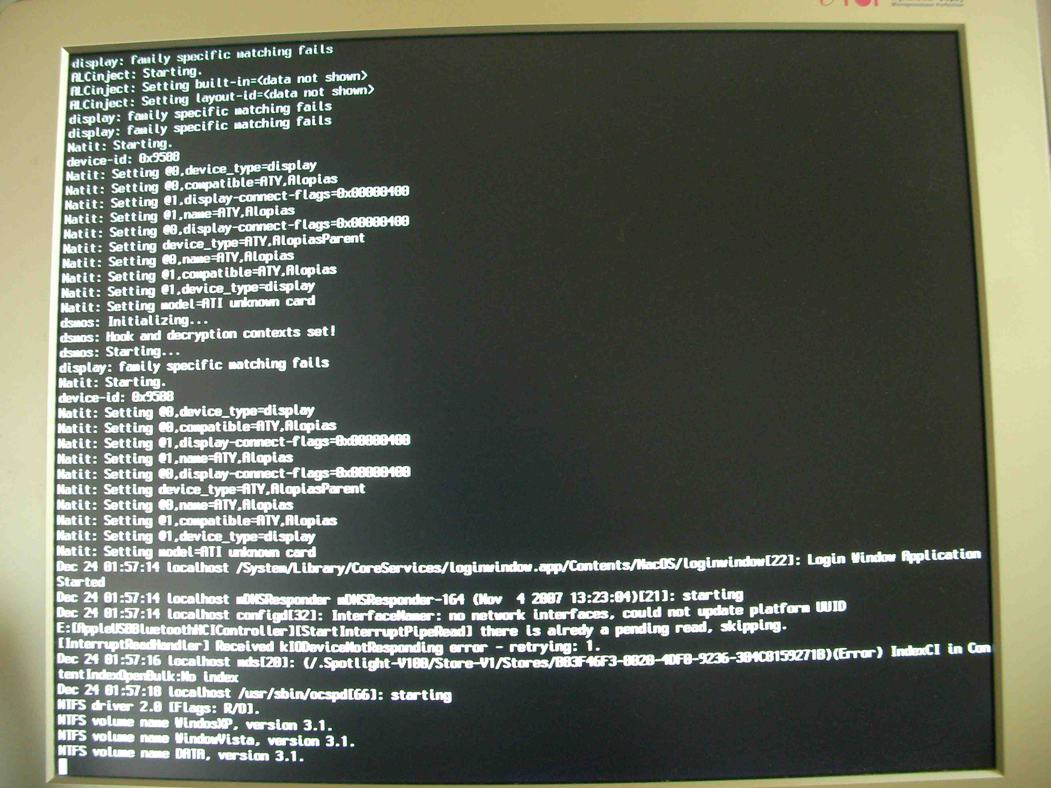

Racer23 Posted December 23, 2007 Share Posted December 23, 2007 Ok, I re installed again, I partitioned my HDD using diskutil then GUID. I customized the options and installed both Vanillas no displays and only GUID (when I tried to install using MBR it failed) So I get to a successfull install it reboots and rapidly reboots again. I chose to boot from the HD with Leo on it then "pressed any key for options" made sure to select the Leo HDD and typed -v but I could not read any thing it wrote out... Going to re install yet once again.... My specs are listed here http://h10025.www1.hp.com/ewfrf/wc/documen...cname=c00303941 Link to comment https://www.insanelymac.com/forum/topic/77069-kalyway-1051-dvd-release-the-official/page/19/#findComment-549368 Share on other sites More sharing options...

mdg Posted December 24, 2007 Share Posted December 24, 2007 I have an Intel 945G (ICH7 in AHCI setting) with Pentium D 940. Install went fine, but after install it didn't boot. I tried following the Bad Axe 2 method. This seemingly worked, but now my computer begins to boot and immediately reboots. I installed Vanill_Kernel and ACPI fix, plus the GUI efi... Any help on how to get my installation working? Thanks, /mdg. Link to comment https://www.insanelymac.com/forum/topic/77069-kalyway-1051-dvd-release-the-official/page/19/#findComment-549679 Share on other sites More sharing options...
w1n78 Posted December 24, 2007 Share Posted December 24, 2007 Dear Kaly & Dune31, O.K., I'm begging you guys, make that groveling -- Is there an answer to the spontaneous reboot problem that I (and others) reported in the initial run of Darwin from the DVD? If there isn't, or if there is no solution, would you guys be kind enough so reply so I won't waste any more of your excellent forum's time and space? Greatly appreciate a moment of your time. Thanks. waiting for an answer too Link to comment https://www.insanelymac.com/forum/topic/77069-kalyway-1051-dvd-release-the-official/page/19/#findComment-549730 Share on other sites More sharing options...
-DuNe- Posted December 24, 2007 Share Posted December 24, 2007 Dear Kaly & Dune31, O.K., I'm begging you guys, make that groveling -- Is there an answer to the spontaneous reboot problem that I (and others) reported in the initial run of Darwin from the DVD? If there isn't, or if there is no solution, would you guys be kind enough so reply so I won't waste any more of your excellent forum's time and space? Greatly appreciate a moment of your time. Thanks. Yes, try at boot, pres F8 and type -legacy or -r or cpus=1. try each of this Link to comment https://www.insanelymac.com/forum/topic/77069-kalyway-1051-dvd-release-the-official/page/19/#findComment-549772 Share on other sites More sharing options...
Cohen The Barbarian Posted December 24, 2007 Share Posted December 24, 2007 I have an Intel 945G (ICH7 in AHCI setting) with Pentium D 940. Install went fine, but after install it didn't boot. I tried following the Bad Axe 2 method. This seemingly worked, but now my computer begins to boot and immediately reboots. I installed Vanill_Kernel and ACPI fix, plus the GUI efi... Any help on how to get my installation working? Thanks, /mdg. Pentium D cannot use the Vanilla kernel...only Core architecture chips can. You must use a patched kernel with the Pentium D 940. Link to comment https://www.insanelymac.com/forum/topic/77069-kalyway-1051-dvd-release-the-official/page/19/#findComment-549774 Share on other sites More sharing options...
mdg Posted December 24, 2007 Share Posted December 24, 2007 Pentium D cannot use the Vanilla kernel...only Core architecture chips can. You must use a patched kernel with the Pentium D 940. Any advice on how I can repair this installation so I don't have to reinstall all over again? Thanks, /mdg. Link to comment https://www.insanelymac.com/forum/topic/77069-kalyway-1051-dvd-release-the-official/page/19/#findComment-549781 Share on other sites More sharing options...
