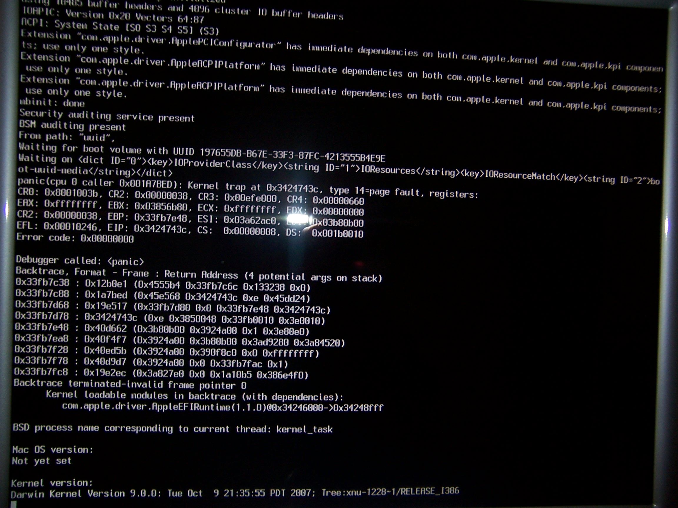

i_am...me Posted December 10, 2007 Author Share Posted December 10, 2007 I need some help with this error. I used ToH DVD RC2 to install Leopard after I followed your guide. Read through the thread, i explained kernel panics and how to know what they are. See where it says backtrace? (ex. ... loadable modules with backtrace com.apple.drive.AppleEFIRuntime) That means that the AppleEFIRuntime.kext (driver) is making the kernel panic. so delete it Link to comment https://www.insanelymac.com/forum/topic/73952-guidesupport-to-installing-efi-v8-dual-bootingpics/page/11/#findComment-534479 Share on other sites More sharing options...

tom_m Posted December 11, 2007 Share Posted December 11, 2007 does this work with the ToH Leopard disc? I couldn't get it working, kernal panic. and i followed the instructions properly. Link to comment https://www.insanelymac.com/forum/topic/73952-guidesupport-to-installing-efi-v8-dual-bootingpics/page/11/#findComment-534759 Share on other sites More sharing options...
i_am...me Posted December 11, 2007 Author Share Posted December 11, 2007 does this work with the ToH Leopard disc?I couldn't get it working, kernal panic. and i followed the instructions properly. Boot in verbose and see where the panic happens Link to comment https://www.insanelymac.com/forum/topic/73952-guidesupport-to-installing-efi-v8-dual-bootingpics/page/11/#findComment-534760 Share on other sites More sharing options...
tom_m Posted December 11, 2007 Share Posted December 11, 2007 says something about: Extension "com.apple.driver.AppleACPIPlatform" has immediate dependencies on both com.apple.kernel and com.apple.kpi components; use only one style. mbinit: done Security auditing service present BSM auditing present ... Mac OS version: Not yet set Kernel version: Darwin Kernel Version 9.0.0 I can attach photos of the screen if need be. Link to comment https://www.insanelymac.com/forum/topic/73952-guidesupport-to-installing-efi-v8-dual-bootingpics/page/11/#findComment-534781 Share on other sites More sharing options...
socal swimmer Posted December 11, 2007 Share Posted December 11, 2007 says something about: Extension "com.apple.driver.AppleACPIPlatform" has immediate dependencies on both com.apple.kernel and com.apple.kpi components;use only one style. mbinit: done Security auditing service present BSM auditing present ... Mac OS version: Not yet set Kernel version: Darwin Kernel Version 9.0.0 I can attach photos of the screen if need be. you seriously just dotted out ("...") the most important part look for a kernel panic. read what it tells you, see what is causing it. if you can't figure it out, post the pic. Link to comment https://www.insanelymac.com/forum/topic/73952-guidesupport-to-installing-efi-v8-dual-bootingpics/page/11/#findComment-534783 Share on other sites More sharing options...
tom_m Posted December 11, 2007 Share Posted December 11, 2007 I have absolutely no clue what any of it means... Thanks so much for your time. I REALLY appreciate it. Link to comment https://www.insanelymac.com/forum/topic/73952-guidesupport-to-installing-efi-v8-dual-bootingpics/page/11/#findComment-534785 Share on other sites More sharing options...
i_am...me Posted December 11, 2007 Author Share Posted December 11, 2007 I have absolutely no clue what any of it means...Thanks so much for your time. I REALLY appreciate it. Did you try my post patches? they are in the EFI pack in the first post Link to comment https://www.insanelymac.com/forum/topic/73952-guidesupport-to-installing-efi-v8-dual-bootingpics/page/11/#findComment-534818 Share on other sites More sharing options...
tom_m Posted December 11, 2007 Share Posted December 11, 2007 ok used the postpatch script. it doesn't seem to panic now but it gets stuck with video. problems with x3100 perhaps..? so i loaded with "Graphics"="1024x768x32" to see if I could get basic resolution. worked. but now it's asking me to register and move over an account or create a new one...can't create new one, it just goes back to the beginning asking me to select a language. I've read about this issue before -- and I didn't have Tiger installed first because I reformatted for the GUID partition. So I didn't have a user account - but I do have a Mac at work, perhaps I can use firewire to transfer that account... Any thoughts? Thanks. -- edit --- I got it booted finally...took a bunch of tries. specified in the startup -x -v "Graphics"="1024x768x32@60" (edit again: actually, it only seems to work once in a while like this, gotta restart over and over til it works) and it worked... i'm assuming there's issues with my intel 965 / x3100 video card. i saw drivers for it but can't find them now on the forums. burried under 50 million posts. i swear once i get this setup i'm gonna setup some sort of page that just has a list of stuff. finding files is nearly impossible on here. i don't think a million replies under guides and important info is necessarily bad - i just think burring links to file somewhere in the middle of those million replies is bad. should be at the top of the order/new thread. anyway. any ideas? is it some kexts i can get and update? i had to create a new user on a real mac and use firewire to transfer it to get past the annoying setup screen. edit: changed some things, appears to boot to just a blue blank screen now - i'm assuming thats on external display. have to hook it up to external monitor to test. still though i'm curious why sometimes it doesn't load all the way. and i always have to boot -x -v (at least i think, maybe it's just randomly not loading all the way) ok and now the screen went black after it was blue for quite some time. computer still running...i don't know... Link to comment https://www.insanelymac.com/forum/topic/73952-guidesupport-to-installing-efi-v8-dual-bootingpics/page/11/#findComment-535026 Share on other sites More sharing options...
