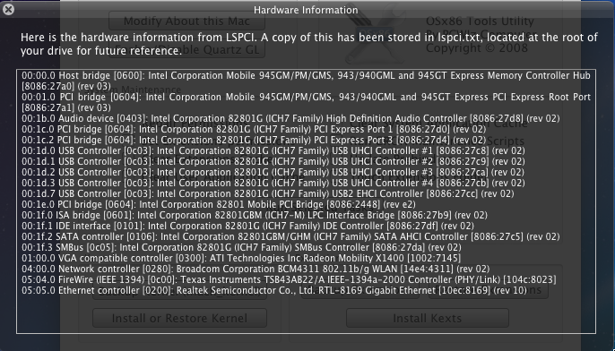

e5m1r Posted March 22, 2010 Share Posted March 22, 2010 If anyone could help me get this 4311 working please here is the log if it helps please help me with editing plis and or kext so i get it working as it is now i cant se card in macos at all, it works just fine in windows and since i posted log it would be nice if someone could help me to get the audio working on the built in speekers right now only headphone output is working 00:00.0 Host bridge [0600]: Intel Corporation Mobile 945GM/PM/GMS, 943/940GML and 945GT Express Memory Controller Hub [8086:27a0] (rev 03) 00:01.0 PCI bridge [0604]: Intel Corporation Mobile 945GM/PM/GMS, 943/940GML and 945GT Express PCI Express Root Port [8086:27a1] (rev 03) 00:1b.0 Audio device [0403]: Intel Corporation 82801G (ICH7 Family) High Definition Audio Controller [8086:27d8] (rev 02) 00:1c.0 PCI bridge [0604]: Intel Corporation 82801G (ICH7 Family) PCI Express Port 1 [8086:27d0] (rev 02) 00:1c.2 PCI bridge [0604]: Intel Corporation 82801G (ICH7 Family) PCI Express Port 3 [8086:27d4] (rev 02) 00:1d.0 USB Controller [0c03]: Intel Corporation 82801G (ICH7 Family) USB UHCI Controller #1 [8086:27c8] (rev 02) 00:1d.1 USB Controller [0c03]: Intel Corporation 82801G (ICH7 Family) USB UHCI Controller #2 [8086:27c9] (rev 02) 00:1d.2 USB Controller [0c03]: Intel Corporation 82801G (ICH7 Family) USB UHCI Controller #3 [8086:27ca] (rev 02) 00:1d.3 USB Controller [0c03]: Intel Corporation 82801G (ICH7 Family) USB UHCI Controller #4 [8086:27cb] (rev 02) 00:1d.7 USB Controller [0c03]: Intel Corporation 82801G (ICH7 Family) USB2 EHCI Controller [8086:27cc] (rev 02) 00:1e.0 PCI bridge [0604]: Intel Corporation 82801 Mobile PCI Bridge [8086:2448] (rev e2) 00:1f.0 ISA bridge [0601]: Intel Corporation 82801GBM (ICH7-M) LPC Interface Bridge [8086:27b9] (rev 02) 00:1f.1 IDE interface [0101]: Intel Corporation 82801G (ICH7 Family) IDE Controller [8086:27df] (rev 02) 00:1f.2 SATA controller [0106]: Intel Corporation 82801GBM/GHM (ICH7 Family) SATA AHCI Controller [8086:27c5] (rev 02) 00:1f.3 SMBus [0c05]: Intel Corporation 82801G (ICH7 Family) SMBus Controller [8086:27da] (rev 02) 01:00.0 VGA compatible controller [0300]: ATI Technologies Inc Radeon Mobility X1400 [1002:7145] 04:00.0 Network controller [0280]: Broadcom Corporation BCM4311 802.11b/g WLAN [14e4:4311] (rev 02) 05:04.0 FireWire (IEEE 1394) [0c00]: Texas Instruments TSB43AB22/A IEEE-1394a-2000 Controller (PHY/Link) [104c:8023] 05:05.0 Ethernet controller [0200]: Realtek Semiconductor Co., Ltd. RTL-8169 Gigabit Ethernet [10ec:8169] (rev 10) Link to comment https://www.insanelymac.com/forum/topic/51725-broadcom-bcm43xx-wireless-driver-beta/page/22/#findComment-1432868 Share on other sites More sharing options...

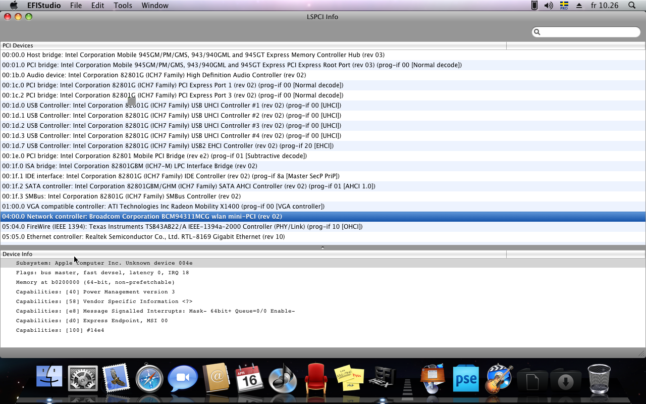

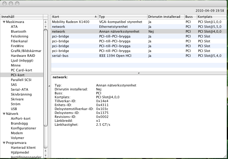

e5m1r Posted April 9, 2010 Share Posted April 9, 2010 I have done some progres but the damn card wont show up in the network part I can se it in pci section (see attached picture) but it does not load any drivers for it ? could it be the vender information that is making the device not to load ? please help Link to comment https://www.insanelymac.com/forum/topic/51725-broadcom-bcm43xx-wireless-driver-beta/page/22/#findComment-1445217 Share on other sites More sharing options...

e5m1r Posted April 16, 2010 Share Posted April 16, 2010 some more progres from my side i successfully rebranded the card to Apple Airport but i can still not se it in networks ?? i am attaching a snapshot from effi studio Anyones help solwing this would be apprishiated I have 2 of this hp cards, i am offering the card as a reward for anyone that can solve get this card to work on my amilo li 1536 this cards originaly come in HP/Compaq Presario laptops Card is working just fine in Windows (having some issues with driver for the rebranded one) i also have a intel 3495 RTL 8187B, and RT2571WF Link to comment https://www.insanelymac.com/forum/topic/51725-broadcom-bcm43xx-wireless-driver-beta/page/22/#findComment-1449593 Share on other sites More sharing options...

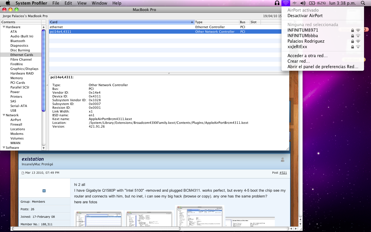

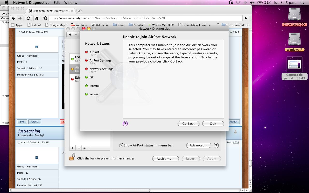

jorgep83 Posted April 19, 2010 Share Posted April 19, 2010 HI EVERYBODY!!!! i have a prob, i first had an atheros ar5007eg card, and i never made it work, now i bought a BCM4311KFGB and it doesn't work properly, my system recognizes as an airport card, i see the fan in the system bar, and it shows me the avaible networks, but i can't join to any network, it asks me for the password but instantly when i hit the enter button tells me that i can join network.... what could i do.??????? in the system profiler under the ethernet card it displays as Type: Other Network Device could it be this the prob??? Console Log Reports 19/04/10 16:37:40 kernel AirPort: Link Down on en1. Reason 1 (Unspecified). 19/04/10 16:39:23 airportd[423] Error: process_command_dict() failed Toshiba L45SP4016 SnowLeo DVD 10.6.3 Intel T2080 Core Duo 2.2 Ghz 1.5 GB Ram 20 Gb Partition Dual Boot Windows 7 Link to comment https://www.insanelymac.com/forum/topic/51725-broadcom-bcm43xx-wireless-driver-beta/page/22/#findComment-1451887 Share on other sites More sharing options...
