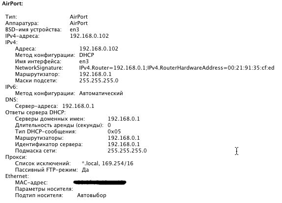

Asus 138G-V2 PCI (Broadcom 4318).
Detect's like AirPort without any modifications (OUT OF THE BOX),
but work unstable (low speed and periodicaly disconect).
Vanila 10.5.7
Anybody fix this?
