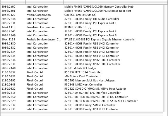

broadcom wifi kext not working in snow leopard i have broadcom 4312 on hp pavillion dv9000 ....so i use IO8211 kext it works but it tends to timeout after every new webpage i open plus it reads it as 4315 not 4312.help.post-122477-1263402666_thumb.jpg
Use this script and it must works!

I have D250 with this device (wi-fi, model 4312, id 4315).
I install Leo 10.5.6 Retail (with some kexts: disabler, touchpad etc.) and use it with DSDT.
See your IOreg and find what is your wi-fi device named. Then change this device in DSDT like that
                Device (ARPT)

Now system think that you have a native Dell Wireless whith ID 4312 and workin whith native kext and services. :)

But what to do, if Airport is shown as "pci14e4,4318" in IOReg and in does not show up in DSDT at all ?
in IOreg your airport have name (for example PX1) find this name in DSDT and change section of this device (code in my post)
you must change device id in my code by yours device id. it have native support (change model too, BTW this cosmetics change)
Nope, its not there in DSDT, it should be after LAN. But never mind, I rebranded the card under Linux into Airport.
