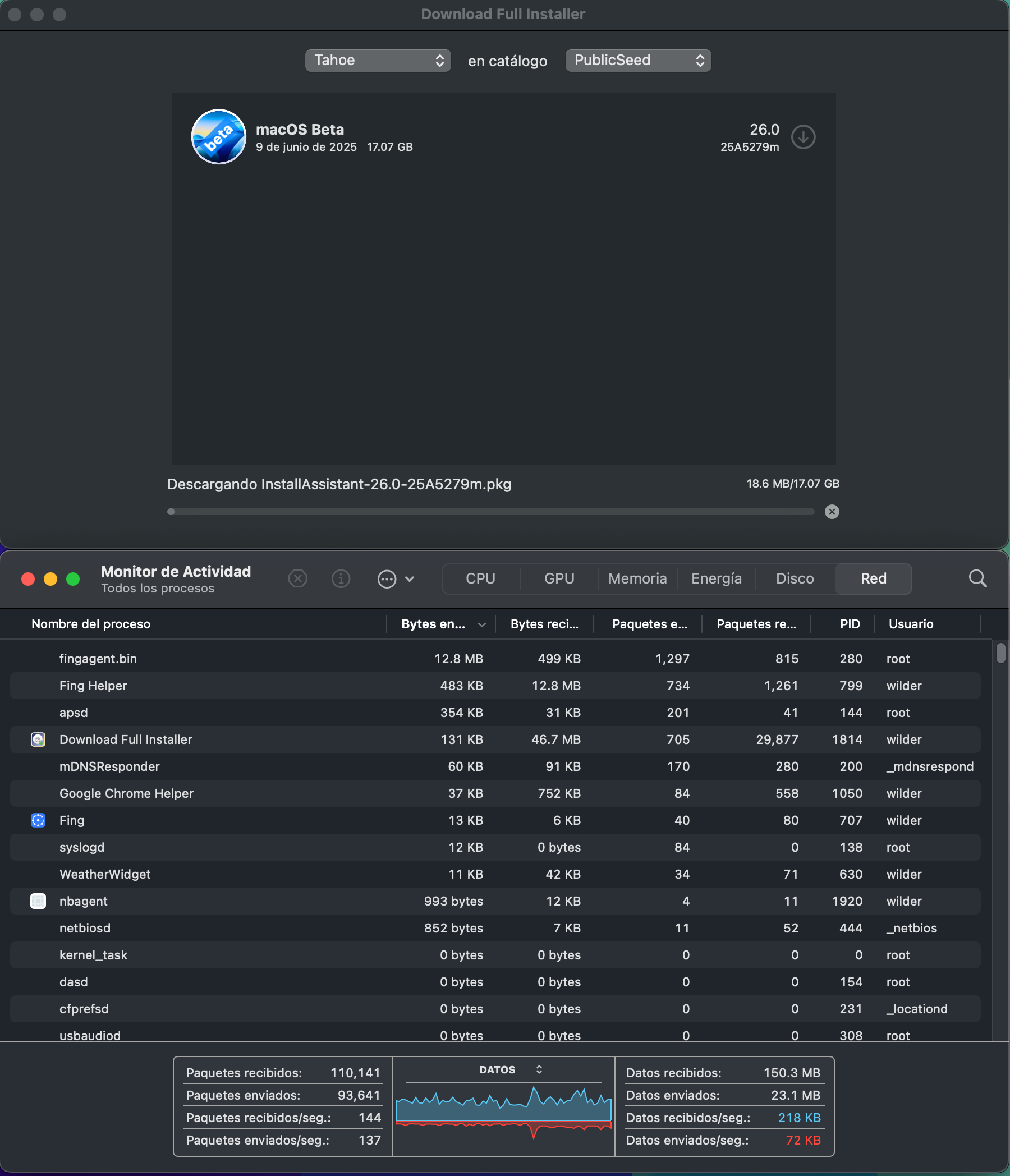

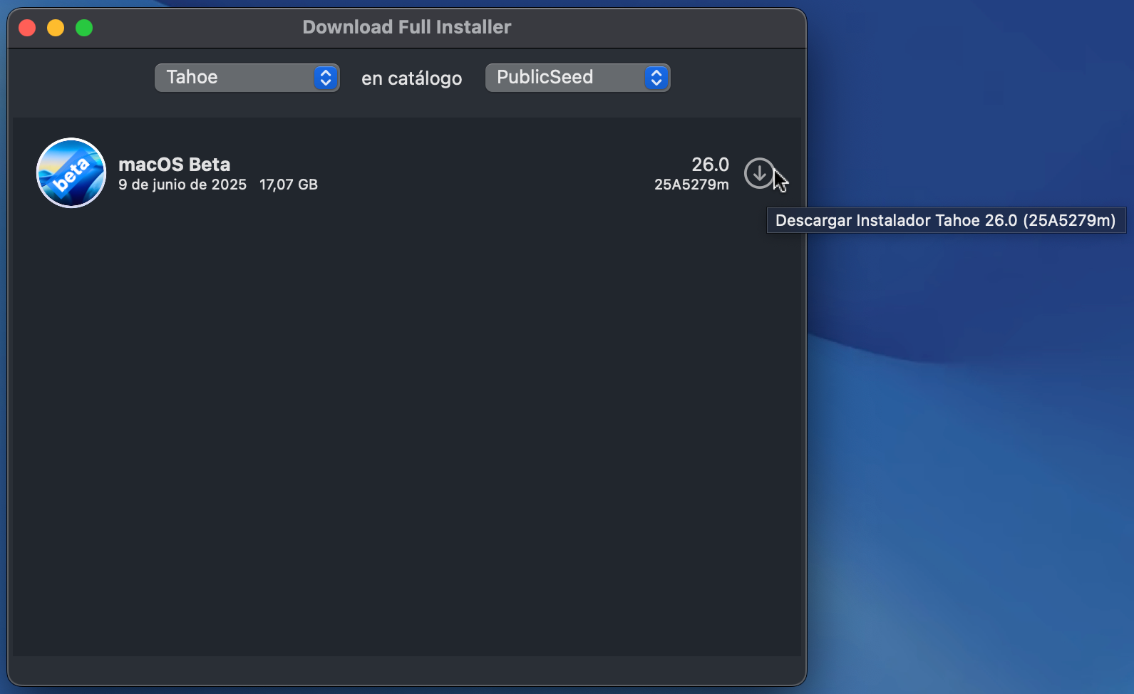

Oyecomova Posted June 13, 2025 Share Posted June 13, 2025 1 hour ago, miliuco said: @Anto65 Updated the Download Full Installer repo with initial support for macOS Tahoe. Note that Tahoe beta is listed in the PublicSeed catalog. Package name in the catalog list doesn't include the word Tahoe but it is visible in the ToolTip, and the build number is correct. Reveal hidden contents Regarding the name Tahoe in the package, I've noticed that GibMacOS displays it the same way. ####################################################### # gibMacOS # ####################################################### Available Products: 1. macOS Beta 26.0 (25A5279m) 2. macOS Ventura 13.7.6 (22H625) 3. macOS Sonoma 14.7.6 (23H626) 4. macOS Sequoia 15.5 (24F74) 5. macOS Sequoia 15.4.1 (24E263) 6. macOS Sonoma 14.7.5 (23H527) 7. macOS Ventura 13.7.5 (22H527) 8. macOS Sequoia 15.4 (24E248) 9. macOS Sequoia 15.3.2 (24D2082) 10. macOS Sequoia 15.3.2 (24D81) 11. macOS Ventura 13.7.4 (22H420) 12. macOS Sonoma 14.7.4 (23H420) 13. macOS Sequoia 15.3.1 (24D70) ... Download Full Installer-2.0.2.zip 3.53 MB · 19 downloads and why is the download slow? 1 Link to comment https://www.insanelymac.com/forum/topic/361162-pre-release-macos-tahoe/page/19/#findComment-2833447 Share on other sites More sharing options...

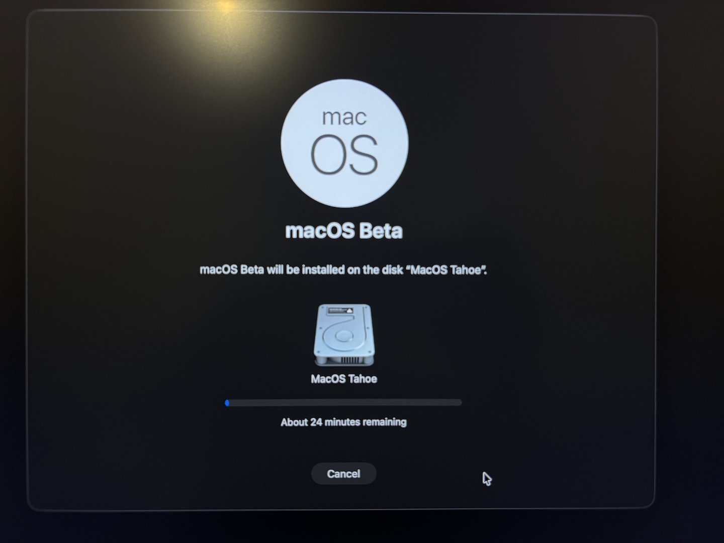

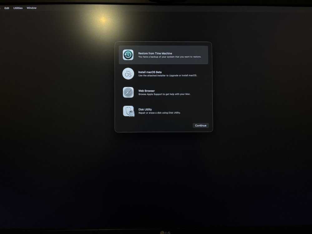

Moviemakergr Posted June 13, 2025 Share Posted June 13, 2025 1 minute ago, Oyecomova said: Did you physically disconnect the rx 580? Yes my friend totaly out from machine It was impossible for me to install with the RX 580. (later i upload my EFI too) 2 Link to comment https://www.insanelymac.com/forum/topic/361162-pre-release-macos-tahoe/page/19/#findComment-2833449 Share on other sites More sharing options...
kaoskinkae Posted June 13, 2025 Share Posted June 13, 2025 3 minutes ago, Oyecomova said: ¿Desconectaste físicamente el rx 580? In my case, I have an IGPU, see NEW: below, I only had to activate the IGPU as default and deactivate the Radeon RX570 to install, but it still crashes once you enter the system waiting for OpenCore and Kext to update, but this has been super fast, we were afraid of not having support, the OpenCore team is great. Link to comment https://www.insanelymac.com/forum/topic/361162-pre-release-macos-tahoe/page/19/#findComment-2833450 Share on other sites More sharing options...

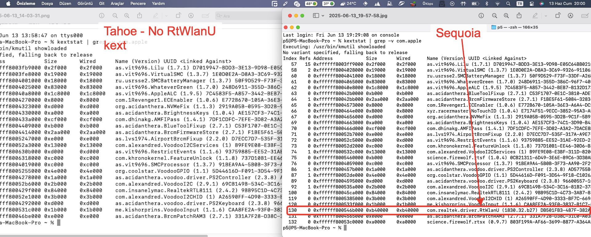

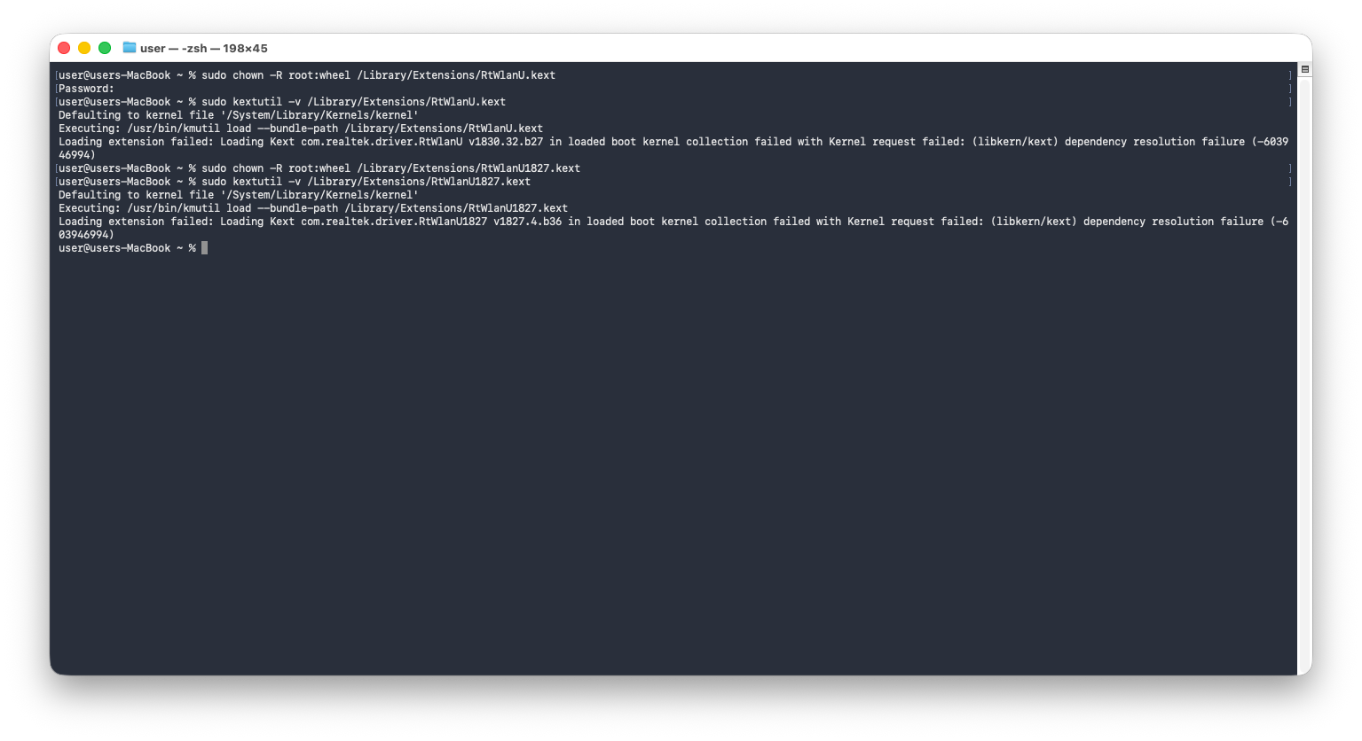

HyperX7 Posted June 13, 2025 Share Posted June 13, 2025 As seen on the right, RtWlanU kexti is installed on macOS Sequoia. However, macOS Tahoe doesn't install either. USB configuration complete successfully. @chris1111 hear my voice. 1 1 Link to comment https://www.insanelymac.com/forum/topic/361162-pre-release-macos-tahoe/page/19/#findComment-2833457 Share on other sites More sharing options...

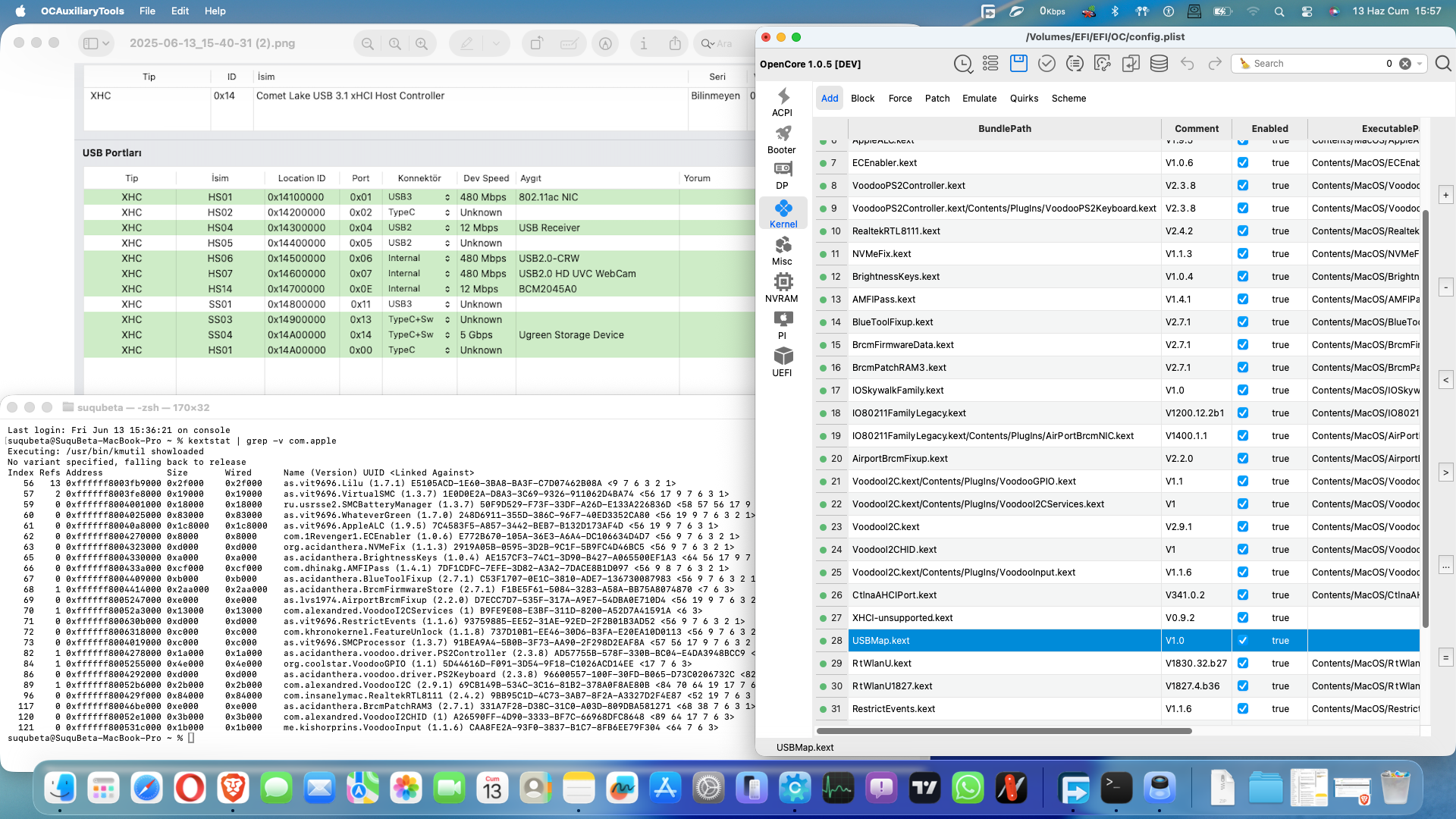

mnfesq Posted June 13, 2025 Share Posted June 13, 2025 7 hours ago, surenmunoo said: Gonna retire again for the night but got much further then last night. I now get to the Language screen but have no usb so cannot proceed further. After verifying the SSDT.UIAC works in Sequoia it does not recognise usb ports at that loading screen so I am still in the bush. Looks like I will have to give up on this Tahoe on my Hack. Not working on Z890 nor the Z790. Thanks @Cyberdevs for the help you provided to get me that far. Try booting with SSDT-RHUB-reset.aml along with your SSDT-UIAC.aml. Link to comment https://www.insanelymac.com/forum/topic/361162-pre-release-macos-tahoe/page/19/#findComment-2833460 Share on other sites More sharing options...

robi62 Posted June 13, 2025 Share Posted June 13, 2025 (edited) 6 hours ago, HyperX7 said: Thank you for the reply. I successfully completed my USB Mapping and when I checked again, I realized that the relevant kexts were still not installed. @chris1111 I am having same problem we have to look for the script to install kexts in library/extensions I used ages ago but cant remember @Slice know is cos he uses it for installing voodoohda We need to look for that 😊 Edited June 13, 2025 by robi62 1 Link to comment https://www.insanelymac.com/forum/topic/361162-pre-release-macos-tahoe/page/19/#findComment-2833464 Share on other sites More sharing options...
robi62 Posted June 13, 2025 Share Posted June 13, 2025 (edited) @HyperX7 I tried script but gives me error Not sure if the script is the right one .In case it is we have to wait for @chris1111 to update the driver for Tahoe PS The script is right so we have to wait for someone capable of fixing the issue..... I have no ethernet so without wifi Im am stuck Edited June 13, 2025 by robi62 more info 1 Link to comment https://www.insanelymac.com/forum/topic/361162-pre-release-macos-tahoe/page/19/#findComment-2833466 Share on other sites More sharing options...

miliuco Posted June 13, 2025 Share Posted June 13, 2025 4 hours ago, Oyecomova said: and why is the download slow? Mine downloads at the expected speed, just as the other downloads do. 1 Link to comment https://www.insanelymac.com/forum/topic/361162-pre-release-macos-tahoe/page/19/#findComment-2833471 Share on other sites More sharing options...

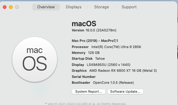

surenmunoo Posted June 14, 2025 Share Posted June 14, 2025 Finally, after so many days and late nights, Maestro @MaLd0n managed to get my Z890 Asus ProArt with Ultra 9 285K working properly with 10G LAN working as well. Thanks @MaLd0n and Thanks @Cyberdevs for helping out 8 Link to comment https://www.insanelymac.com/forum/topic/361162-pre-release-macos-tahoe/page/19/#findComment-2833474 Share on other sites More sharing options...

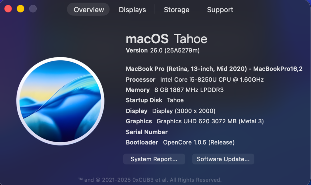

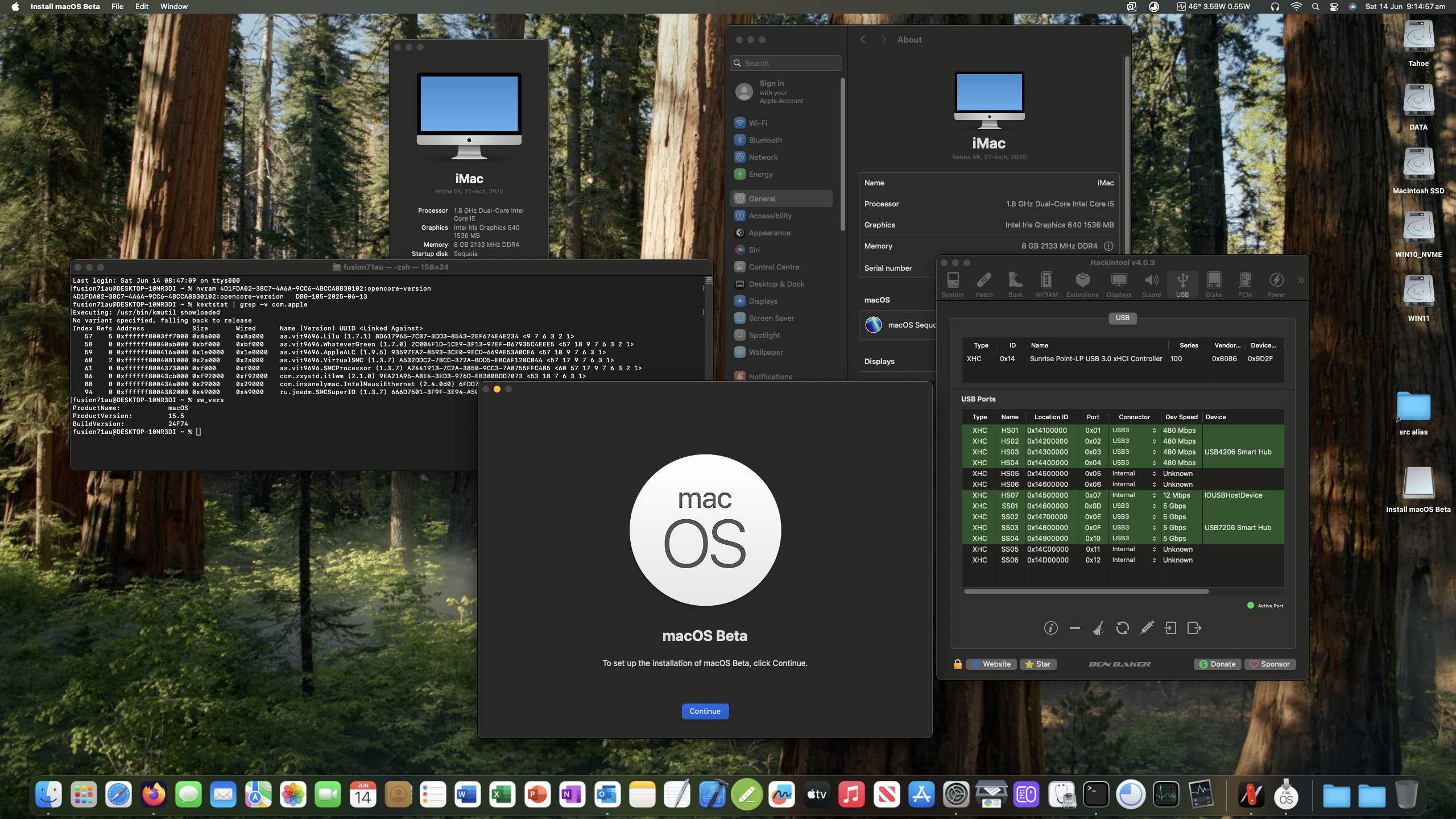

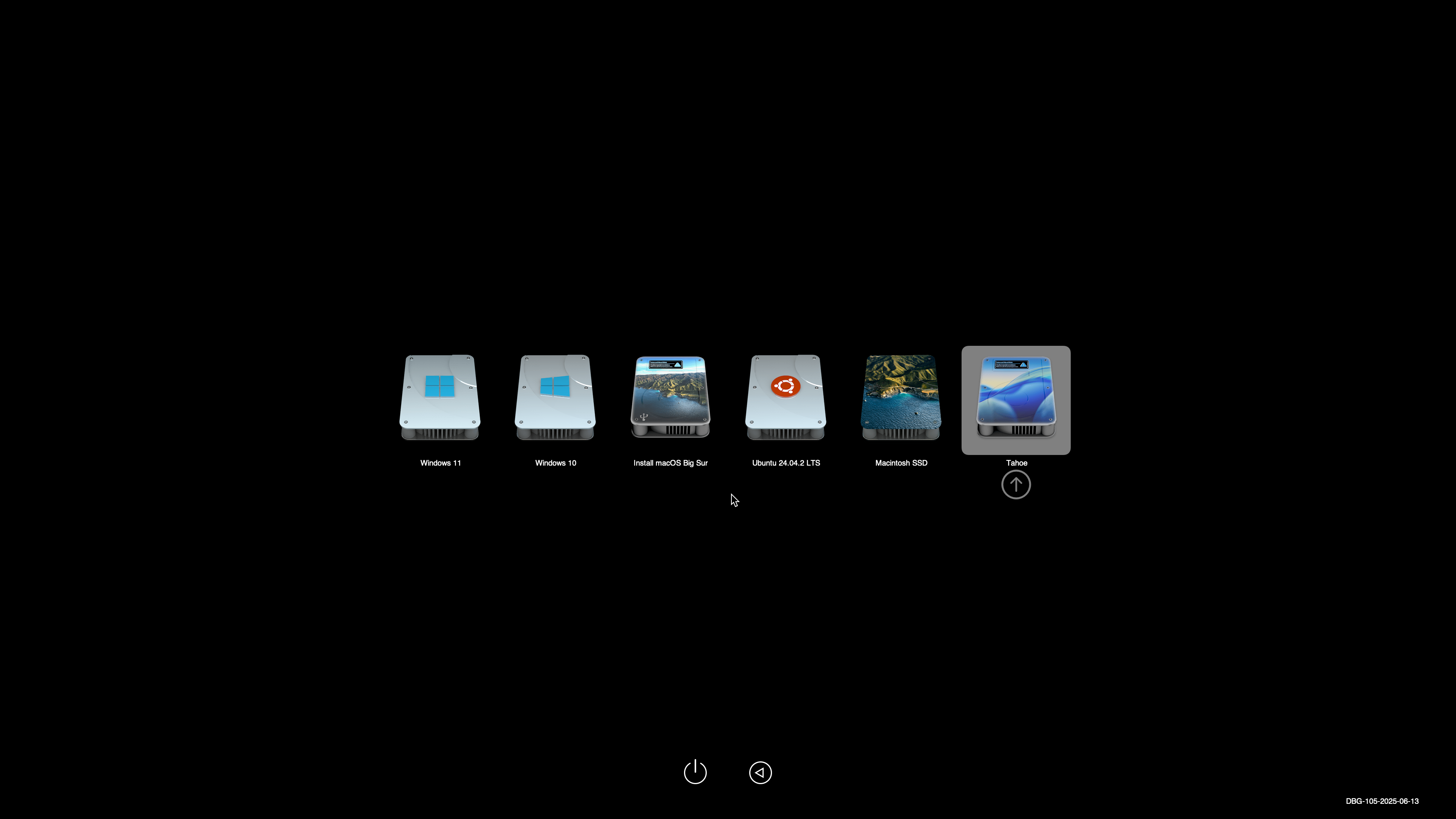

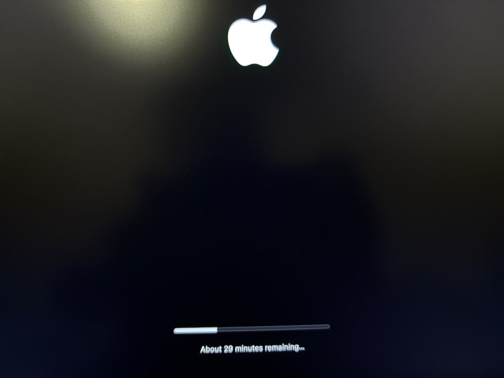

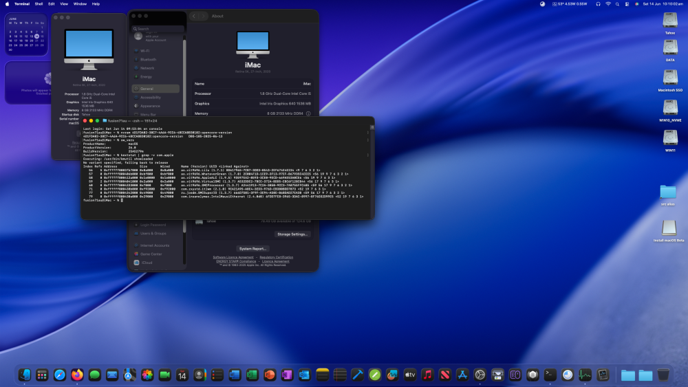

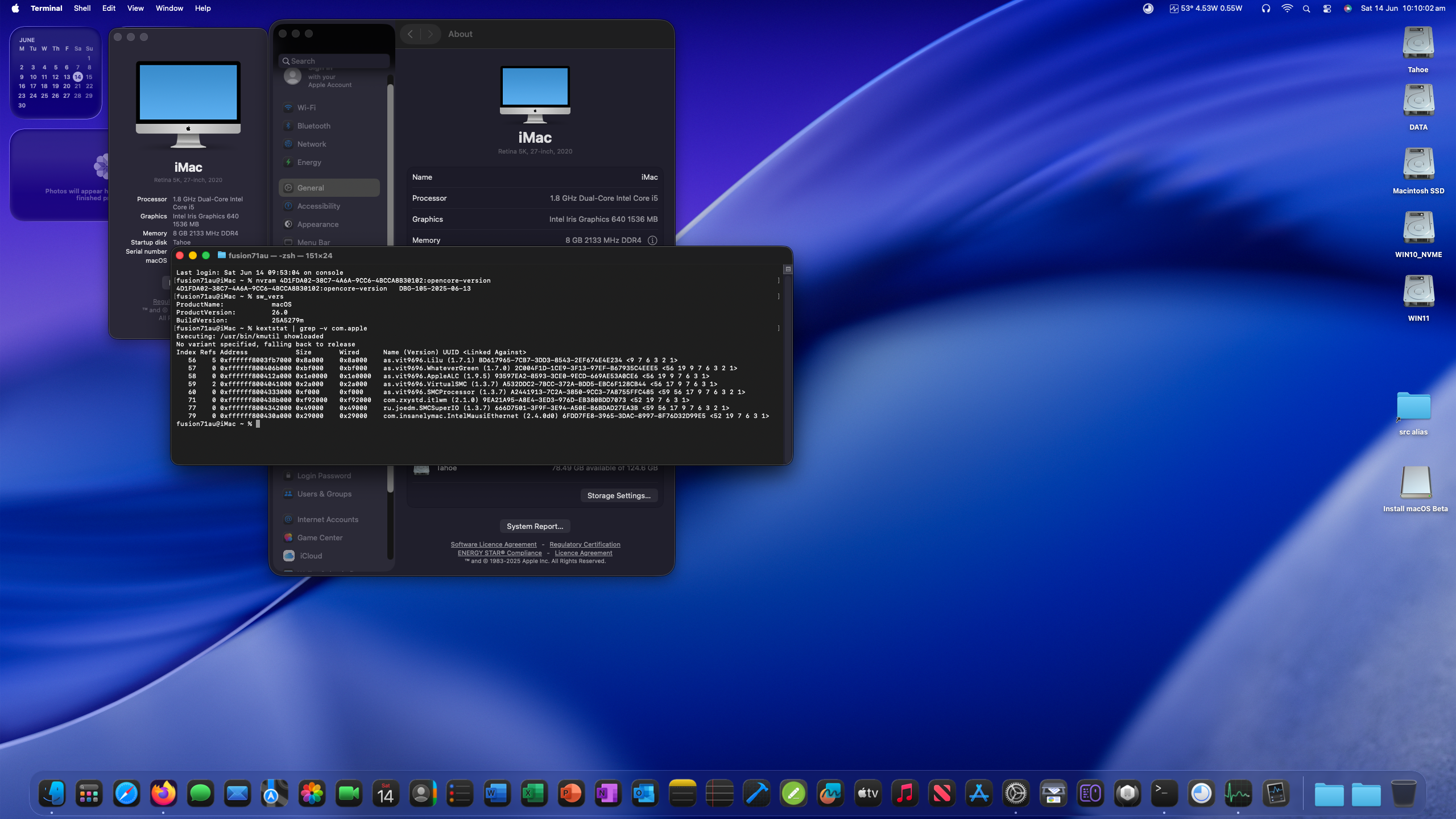

fusion71au Posted June 14, 2025 Share Posted June 14, 2025 Hi Guys. I managed to successfully upgrade from Sequoia 15.5 to macOS 26 Tahoe Beta on my Skylake NUC6i5SYH after a few tweaks to my OC EFI config... Spoiler Preparation Changed SMBIOS in OC config.plist/Platforminfo/Generic/SystemProductName to one that is still supported by macOS 26 eg iMac20,1 Add boot arg -lilubetaall to OC config.plist/NVRAM/Add/7C436110-AB2A-4BBB-A880-FE41995C9F82/boot-args Update OC and kexts to latest available: OC from 1.0.4 to 1.0.5_15cdd853, Lilu v1.7.1, VirtualSMC v1.3.7, WhateverGreen v1.7.0. Revise USBMap.kext to new format for Tahoe. Upgrade Notes Temporarily logged out of iCloud (on my real Mac M4 MBP, it prevented upgrade from Sequoia until I disabled Find My Mac) Download full installer app and create USB installer with createinstallmedia. Make sure your OC EFI is able to boot the USB installer to ensure as smooth an upgrade as possible. I then booted to my Sequoia volume and ran the full installer app from there to perform the upgrade install of my hack. Cosmetic - added Tahoe icons to OC/Resources/Image/Acidanthera/GoldenGate. Note naming icons file to Apple26.icns instead of Apple 16.icns. OC_Skylake NUC6i5SYH.zip 9 Link to comment https://www.insanelymac.com/forum/topic/361162-pre-release-macos-tahoe/page/19/#findComment-2833484 Share on other sites More sharing options...
