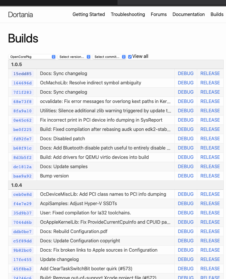

Joshua60 Posted June 14, 2025 Share Posted June 14, 2025 39 minutes ago, ivak4eto said: OK, I got a little further - but now I'm stuck at this line: 509: Successfully initialized AHCI controller Any ideas what could be the issue here? update OC, it worked for me. https://github.com/dortania/build-repo/releases 5 Link to comment https://www.insanelymac.com/forum/topic/361162-pre-release-macos-tahoe/page/20/#findComment-2833503 Share on other sites More sharing options...
surenmunoo Posted June 14, 2025 Share Posted June 14, 2025 6 minutes ago, Joshua60 said: update OC, it worked for me. https://github.com/dortania/build-repo/releases Shows Lilu has been update for Tahoe, same version number but updated 3 Link to comment https://www.insanelymac.com/forum/topic/361162-pre-release-macos-tahoe/page/20/#findComment-2833504 Share on other sites More sharing options...
Joshua60 Posted June 14, 2025 Share Posted June 14, 2025 2 minutes ago, surenmunoo said: Shows Lilu has been update for Tahoe, same version number but updated look for OpenCorePkg 164696d 2 Link to comment https://www.insanelymac.com/forum/topic/361162-pre-release-macos-tahoe/page/20/#findComment-2833505 Share on other sites More sharing options...

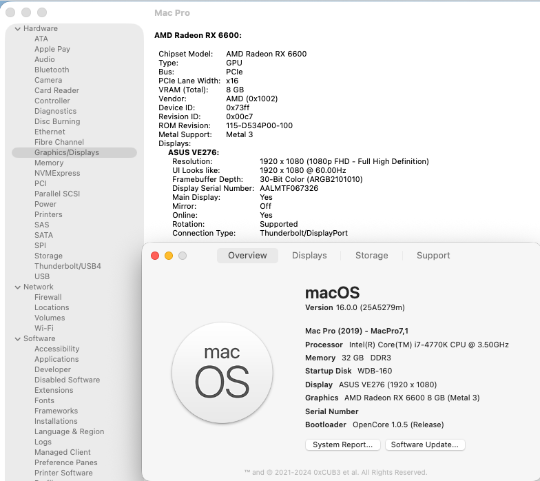

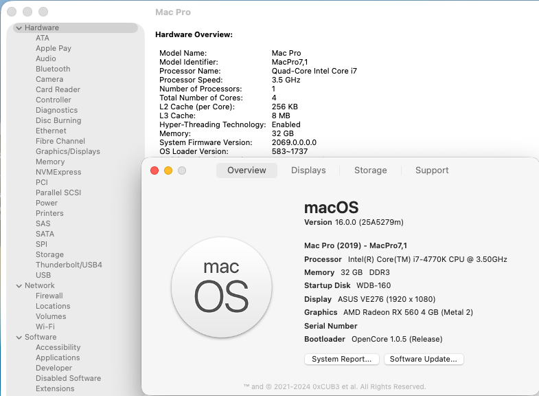

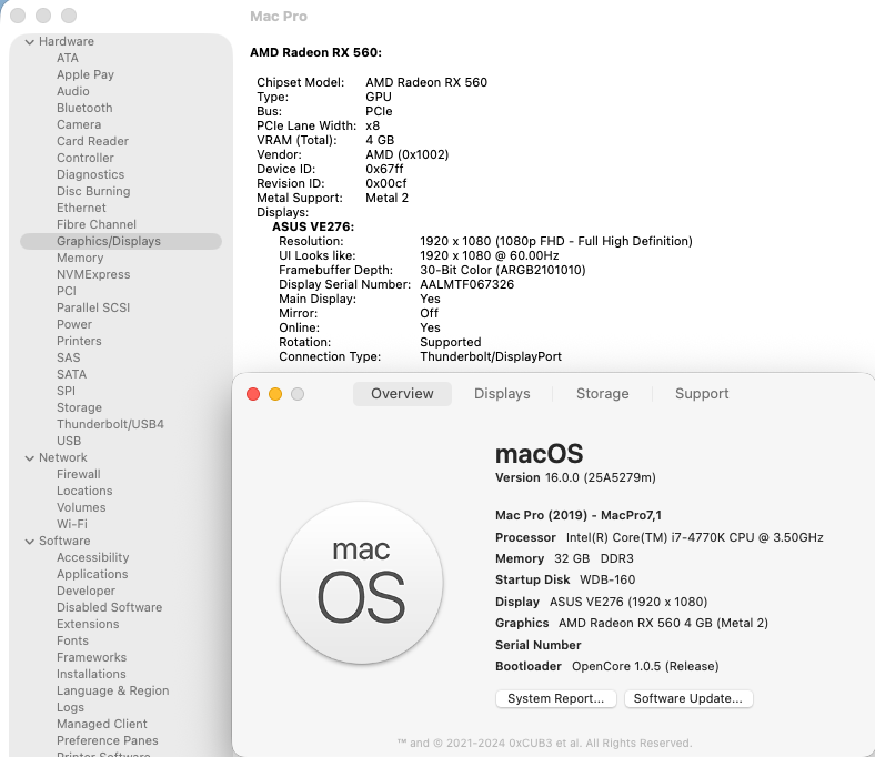

jsl Posted June 14, 2025 Share Posted June 14, 2025 (edited) 1 hour ago, eSaF said: @jsl How are you booting with Mac Pro1.1 without Integrated Graphics? Forgive my ignorance but I thought that was one of the dropped models. I will give it a shot, but must confess my USB mapping skills are somewhat flaky. Never knowing what is correct or wrong. After repeated trial and modification my H97M-E hackintosh can boot TaHoe with RX-560 GPU without IGPU now. But it's quite unstable. Edited June 14, 2025 by jsl 4 Link to comment https://www.insanelymac.com/forum/topic/361162-pre-release-macos-tahoe/page/20/#findComment-2833506 Share on other sites More sharing options...

surenmunoo Posted June 14, 2025 Share Posted June 14, 2025 2 minutes ago, Joshua60 said: look for OpenCorePkg 164696d There is a newer OC Package available 3 Link to comment https://www.insanelymac.com/forum/topic/361162-pre-release-macos-tahoe/page/20/#findComment-2833508 Share on other sites More sharing options...

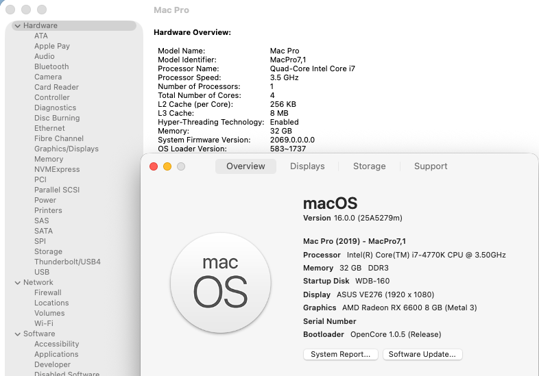

arsradu Posted June 14, 2025 Share Posted June 14, 2025 (edited) 43 minutes ago, jsl said: After repeated trial and modification my H97M-E hackintosh can boot TaHoe with RX-560 GPU without IGPU now. But it's quite unstable. Dare I ask how did you manage to boot with that card? I thought RX400/500 cards are not working/not supported etc. Does it work with RX560 but not RX580? :)) Cause that would be something. Also, WEG is not updated, as far as I know. So...how? What did you change? And what are the stability issues you say you have? Edited June 14, 2025 by arsradu Link to comment https://www.insanelymac.com/forum/topic/361162-pre-release-macos-tahoe/page/20/#findComment-2833513 Share on other sites More sharing options...
jsl Posted June 14, 2025 Share Posted June 14, 2025 (edited) 2 hours ago, arsradu said: Dare I ask how did you manage to boot with that card? I thought RX400/500 cards are not working/not supported etc. Does it work with RX560 but not RX580? :)) Cause that would be something. Also, WEG is not updated, as far as I know. So...how? What did you change? And what are the stability issues you say you have? WEG 1.7.0. SMBIOS=MacPro7,1 boot-args=-wegnoigpu Unstable when I try to edit something here with Firefox it became black screen immediately and no response to my instruction any more ! So it must be fixed ASAP. Replaced it with RX-6600 seems more stable at TaHoe, however it got panic during booting at 15.5. I can boot 15.5 with RX-560 without any issue. But Safari is much stable than Firefox at TaHoe now! [Edit] Replaced with RX-6600 made my H97M-E hackintosh working stably at TaHoe now ! Much much better than with RX-560. It can be wake-up normally from S3 sleep without blank screen issue. Edited June 14, 2025 by jsl 3 Link to comment https://www.insanelymac.com/forum/topic/361162-pre-release-macos-tahoe/page/20/#findComment-2833514 Share on other sites More sharing options...
etorix Posted June 14, 2025 Share Posted June 14, 2025 1 hour ago, verdazil said: For some reason there is a delay compared to previous macOS releases... The release schedule is on the first Tuesday of the month, so official OC 1.0.6 should not land before July. You may look into nighly builds, but give it some time to stabilise and solve issues. 1 Link to comment https://www.insanelymac.com/forum/topic/361162-pre-release-macos-tahoe/page/20/#findComment-2833516 Share on other sites More sharing options...
arsradu Posted June 14, 2025 Share Posted June 14, 2025 40 minutes ago, jsl said: WEG 1.7.0. SMBIOS=MacPro7,1 boot-args=-wegnoigpu Unstable when I try to edit something here with Firefox it became black screen immediately and no response to my instruction any more ! So it must be fixed ASAP. Replaced it with RX-6600XT seems more stable at TaHoe, however it got panic during booting at 15.5. I can boot 15.5 with RX-560 without any issue. But Safari is much stable than Firefox at TaHoe now!` Interesting... Well, wegnoigpu only disables the iGPU, as far as I know, so that has no effect on booting with the RX 560. I guess there's either something else going on, or...for some reason it works with the 560 but not the 580, which I find really weird. Anyway, thank you very much for your answer. 2 Link to comment https://www.insanelymac.com/forum/topic/361162-pre-release-macos-tahoe/page/20/#findComment-2833517 Share on other sites More sharing options...

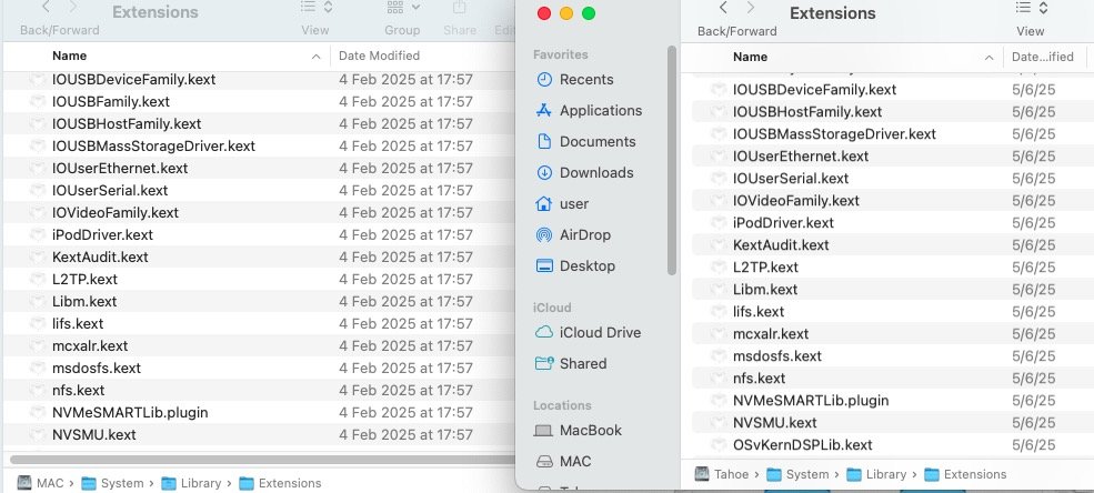

robi62 Posted June 14, 2025 Share Posted June 14, 2025 @HyperX7 No idea how to fix our problem although I have noticed that a required iokit in not used anymore in Tahoe I believe that is why kext won't load and script does not work iOkitUSBFamily kext not in Tahoe 😪 2 1 Link to comment https://www.insanelymac.com/forum/topic/361162-pre-release-macos-tahoe/page/20/#findComment-2833518 Share on other sites More sharing options...
