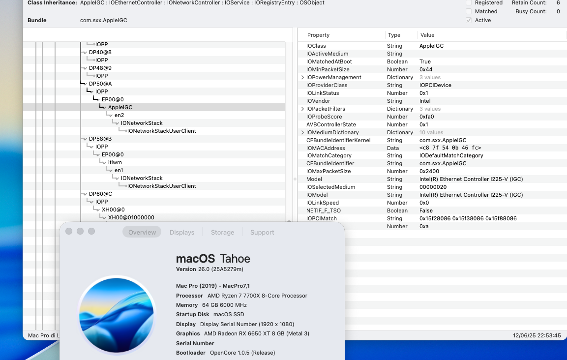

lorys89 Posted June 12, 2025 Share Posted June 12, 2025 Just now, surenmunoo said: Same on Sequoia, the I226-V does not work. for me work i225v with appleigc 2 1 Link to comment https://www.insanelymac.com/forum/topic/361162-pre-release-macos-tahoe/page/16/#findComment-2833358 Share on other sites More sharing options...

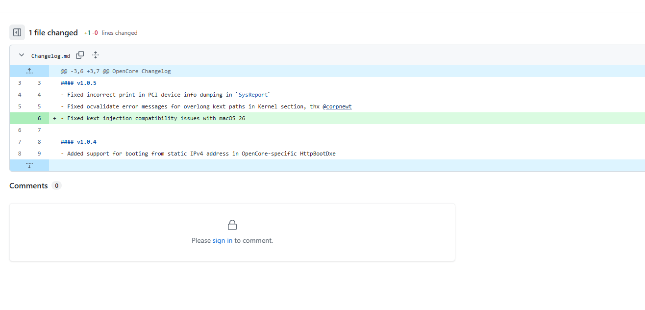

arsradu Posted June 12, 2025 Share Posted June 12, 2025 (edited) Hey guys, I see we're getting a fix for kext injection compatibility for MacOS Tahoe according to this commit. Has anyone tried the latest builds of OC on Tahoe? Did it make a difference to you guys? I tried one of the latest ones earlier today but didn't make a difference to me. Just curious if it did to you. Edited June 12, 2025 by arsradu Link to comment https://www.insanelymac.com/forum/topic/361162-pre-release-macos-tahoe/page/16/#findComment-2833360 Share on other sites More sharing options...
surenmunoo Posted June 12, 2025 Share Posted June 12, 2025 3 minutes ago, arsradu said: Hey guys, I see we're getting a fix for kext injection compatibility for MacOS Tahoe according to this commit. Has anyone tried the latest builds of OC on Tahoe? Did it make a difference to you guys? I tried one of the latest ones earlier today but didn't make a difference to me. Just curious if it did to you. I used the version as of last night for me and did not help. I did not check the release notes to see if this was available at the time though. 2 Link to comment https://www.insanelymac.com/forum/topic/361162-pre-release-macos-tahoe/page/16/#findComment-2833361 Share on other sites More sharing options...

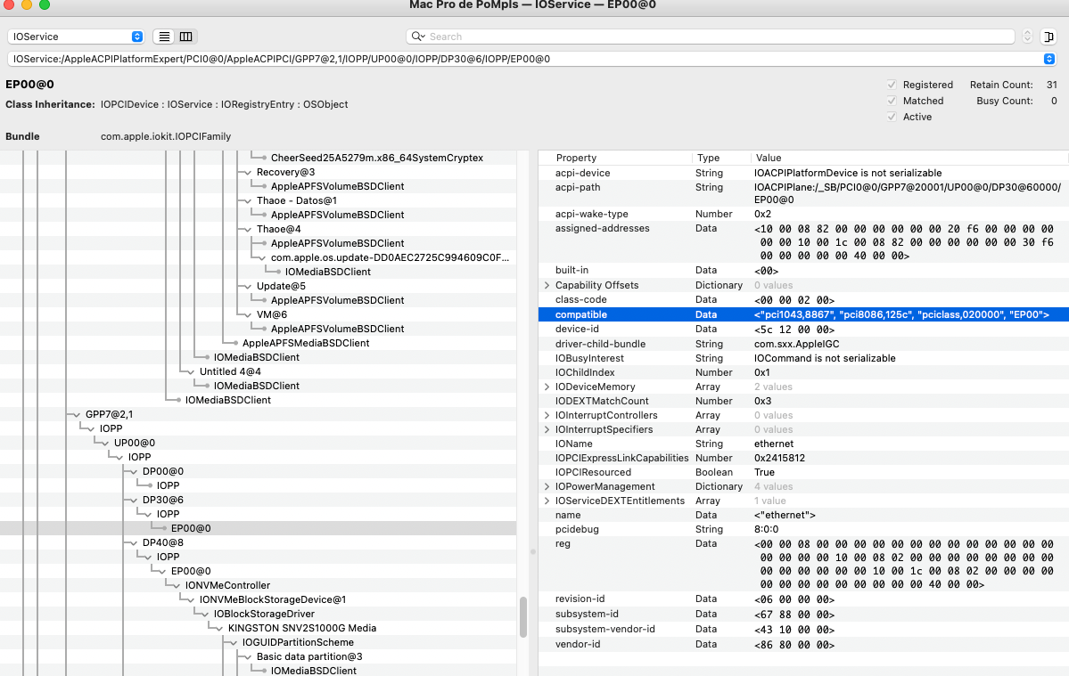

PoMpIs Posted June 12, 2025 Share Posted June 12, 2025 1 hour ago, lorys89 said: for me work i225v with appleigc The i225v is good, but my motherboard has i226v... nothing works...🥲 1 Link to comment https://www.insanelymac.com/forum/topic/361162-pre-release-macos-tahoe/page/16/#findComment-2833363 Share on other sites More sharing options...

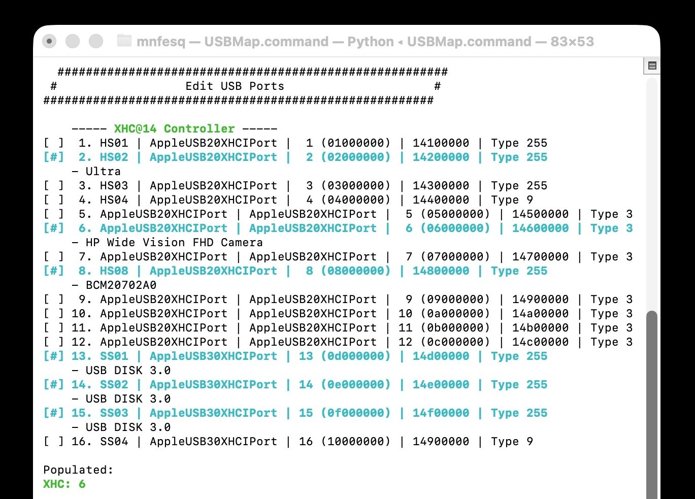

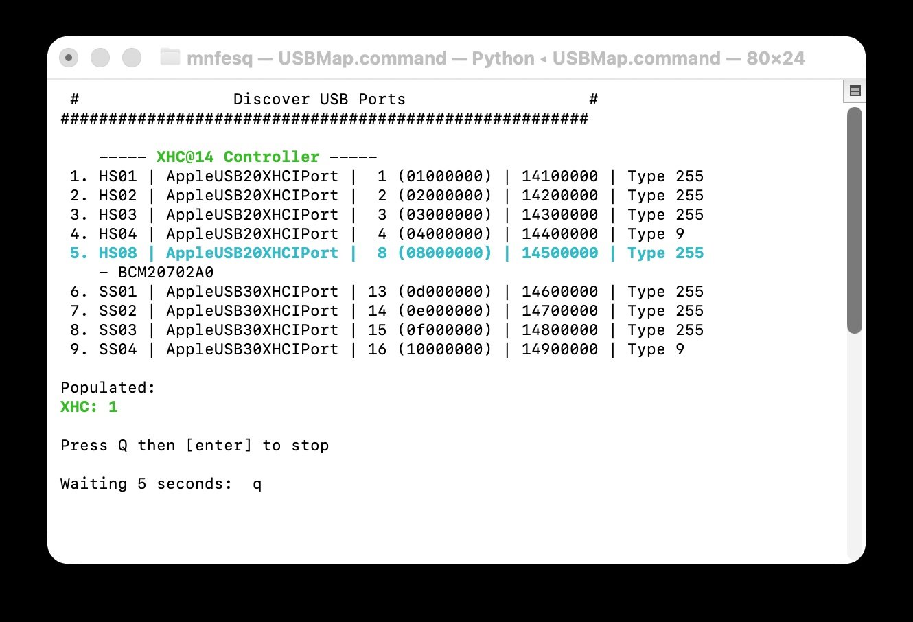

mnfesq Posted June 12, 2025 Share Posted June 12, 2025 (edited) So I solved my problem with my internal webcam not working. I needed to reset the USB RHUB using SSDT-RHUB-Reset.aml. I need to use this every time I boot into Tahoe. When I don't use it, my USB ports detected looks like this: When I use the RHUB-reset, it looks like this: Maybe others with trouble getting all of their USB ports detected can try this method. It's an option in the USBMap-tahoe-test app. Oh, and another thing. Sometimes it takes me 2 times to boot up. I get into a boot loop and need to power off the laptop and restart. So far, it will boot up correctly on the second try. Also, my ethernet adapter is either going to sleep on me or stops working for some unknown reason. I was able to get it to work again without rebooting by going into the networks settings for ethernet and making the service inactive and then reactivating it. Edited June 12, 2025 by mnfesq 1 Link to comment https://www.insanelymac.com/forum/topic/361162-pre-release-macos-tahoe/page/16/#findComment-2833364 Share on other sites More sharing options...
lorys89 Posted June 12, 2025 Share Posted June 12, 2025 (edited) @PoMpIsPut this bootarg pci=0x8000000 and reboot The patches for am5 are broken, with bootarg you get back to working all Edited June 12, 2025 by lorys89 1 1 Link to comment https://www.insanelymac.com/forum/topic/361162-pre-release-macos-tahoe/page/16/#findComment-2833365 Share on other sites More sharing options...
lorys89 Posted June 12, 2025 Share Posted June 12, 2025 You can also disable the kernel patches "Disable 10 bit tags" for am5 if you use bootarg 1 Link to comment https://www.insanelymac.com/forum/topic/361162-pre-release-macos-tahoe/page/16/#findComment-2833366 Share on other sites More sharing options...

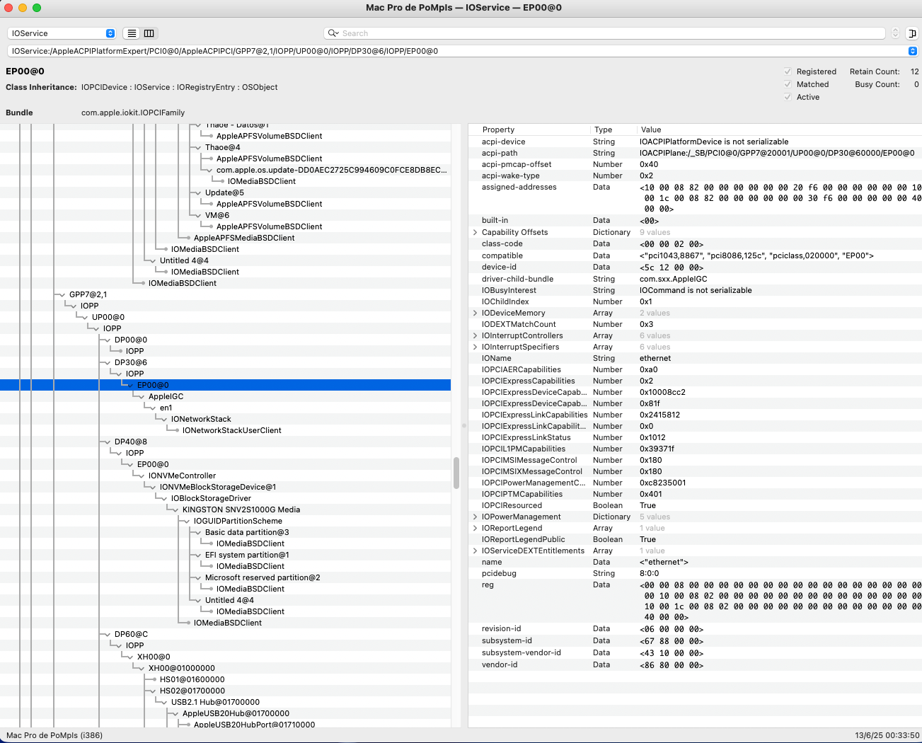

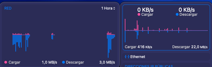

PoMpIs Posted June 12, 2025 Share Posted June 12, 2025 (edited) 25 minutes ago, lorys89 said: @PoMpIsPut this bootarg pci=0x8000000 and reboot The patches for am5 are broken, with bootarg you get back to working all Well, it started with that boot flag, but in 30 seconds there is no more traffic, although the card is still active, I have to deactivate and activate it and it works again for another 30 seconds, and so on continuously. Edited June 12, 2025 by PoMpIs 1 1 Link to comment https://www.insanelymac.com/forum/topic/361162-pre-release-macos-tahoe/page/16/#findComment-2833367 Share on other sites More sharing options...

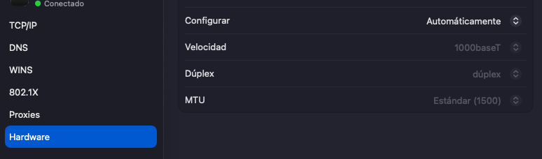

lorys89 Posted June 12, 2025 Share Posted June 12, 2025 28 minutes ago, PoMpIs said: Well, it started with that boot flag, but in 30 seconds there is no more traffic, although the card is still active, I have to deactivate and activate it and it works again for another 30 seconds, and so on continuously. From the settings try it at 1000t 2 1 Link to comment https://www.insanelymac.com/forum/topic/361162-pre-release-macos-tahoe/page/16/#findComment-2833369 Share on other sites More sharing options...

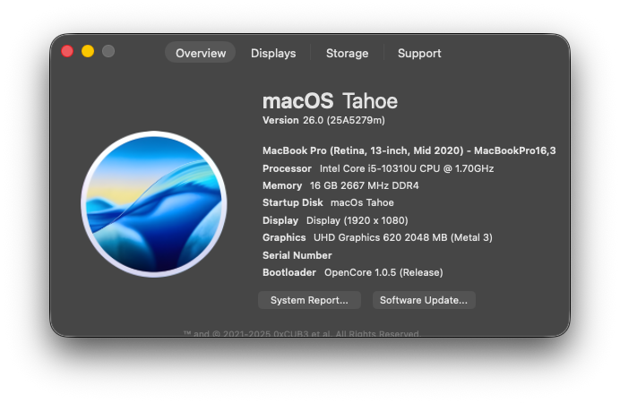

LockDown Posted June 13, 2025 Share Posted June 13, 2025 6 hours ago, Takiller said: I can now confirm that HD 620 is compatible, as I finally made it into Tehoa and VoodooI2C was the culprit all along. What was the issue of VoodooI2C? Link to comment https://www.insanelymac.com/forum/topic/361162-pre-release-macos-tahoe/page/16/#findComment-2833370 Share on other sites More sharing options...
PoMpIs Posted June 13, 2025 Share Posted June 13, 2025 (edited) 1 hour ago, lorys89 said: From the settings try it at 1000t Thank you very much!! but it seems impossible, something is not right with this i226v, sometimes it works for 30 seconds, other times for 1 minute... but no more... I have noticed and being in MacOS, if I disconnect the cable, MacOS does not notice and continues to mark the connection as working in settings/network 🤷♂️ Edited June 13, 2025 by PoMpIs Link to comment https://www.insanelymac.com/forum/topic/361162-pre-release-macos-tahoe/page/16/#findComment-2833371 Share on other sites More sharing options...

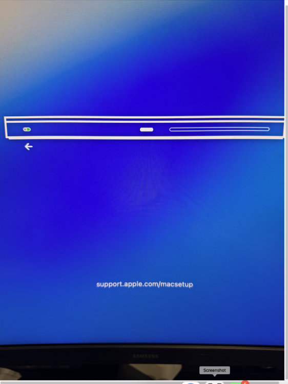

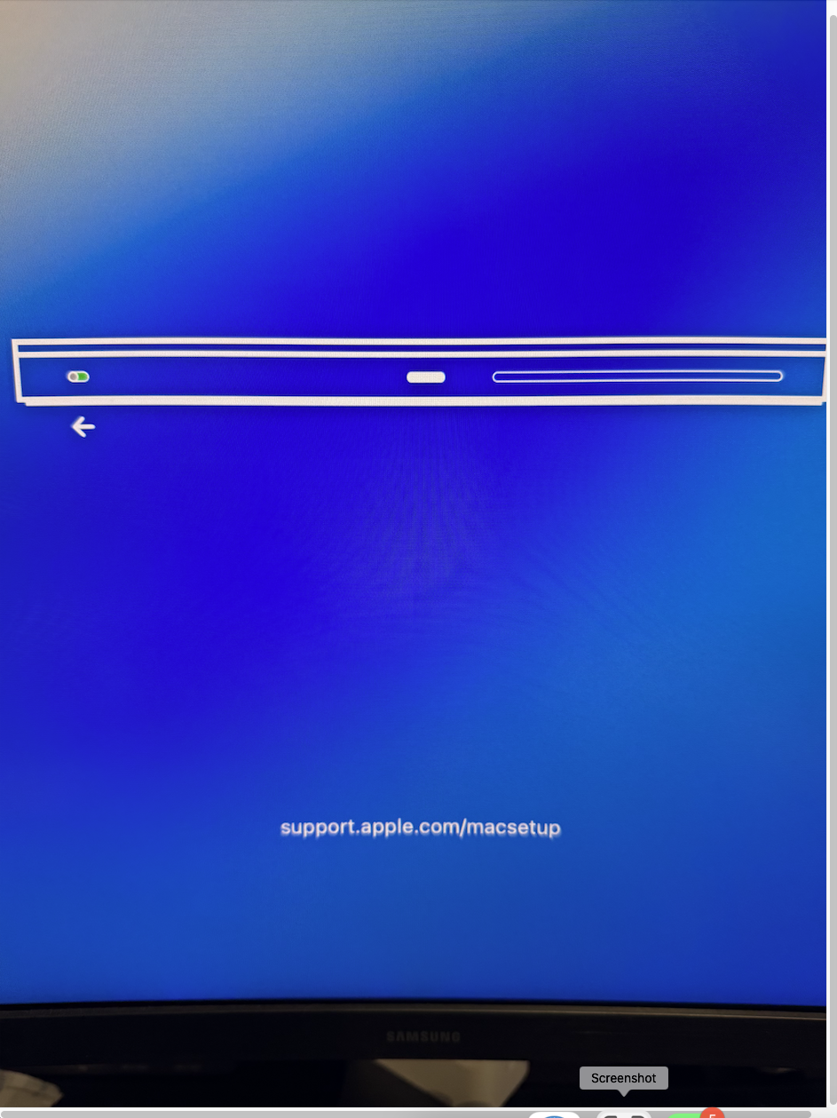

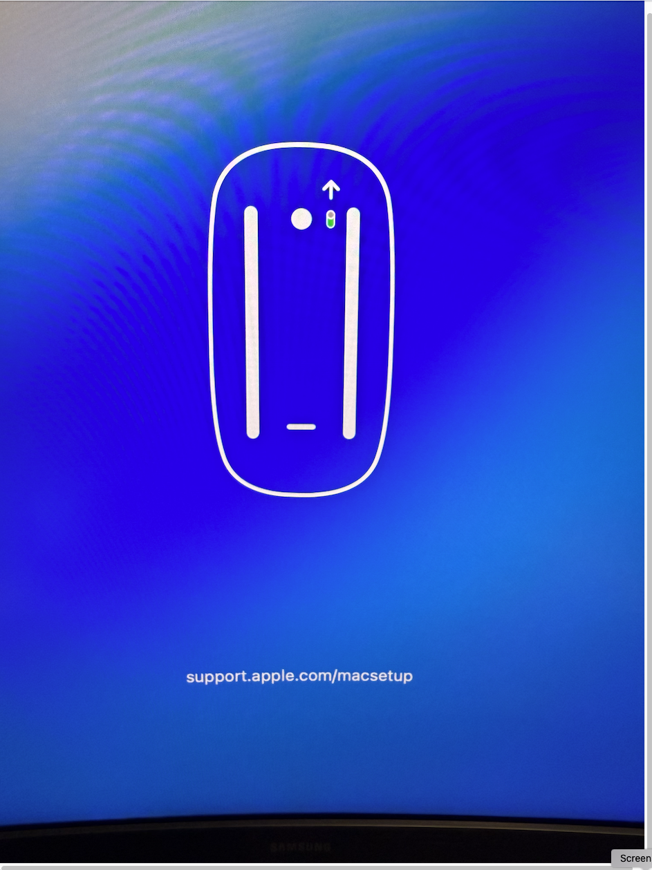

surenmunoo Posted June 13, 2025 Share Posted June 13, 2025 @Cyberdevs Image below, stuck here now on the Z790. Seems that I need usb or bluetooth. Have enable the usb kext again but nothing Link to comment https://www.insanelymac.com/forum/topic/361162-pre-release-macos-tahoe/page/16/#findComment-2833373 Share on other sites More sharing options...

Takiller Posted June 13, 2025 Share Posted June 13, 2025 1 hour ago, LockDown said: What was the issue of VoodooI2C? It was preventing the installation to reach the login screen and I am still trying to figure out the way around this cause my mouse & trackpad are not working as we speak. I am still trying to figure out how to map my USB's, as the provided way in this forum is failing on my side. Link to comment https://www.insanelymac.com/forum/topic/361162-pre-release-macos-tahoe/page/16/#findComment-2833375 Share on other sites More sharing options...
LockDown Posted June 13, 2025 Share Posted June 13, 2025 (edited) @Takiller https://github.com/corpnewt/USBMap/tree/tahoe-test As for the trackpad, its a race issue between the Voodoo and Apple's own driver 🤔. We have to wait till the 2nd release Edited June 13, 2025 by LockDown 1 Link to comment https://www.insanelymac.com/forum/topic/361162-pre-release-macos-tahoe/page/16/#findComment-2833376 Share on other sites More sharing options...

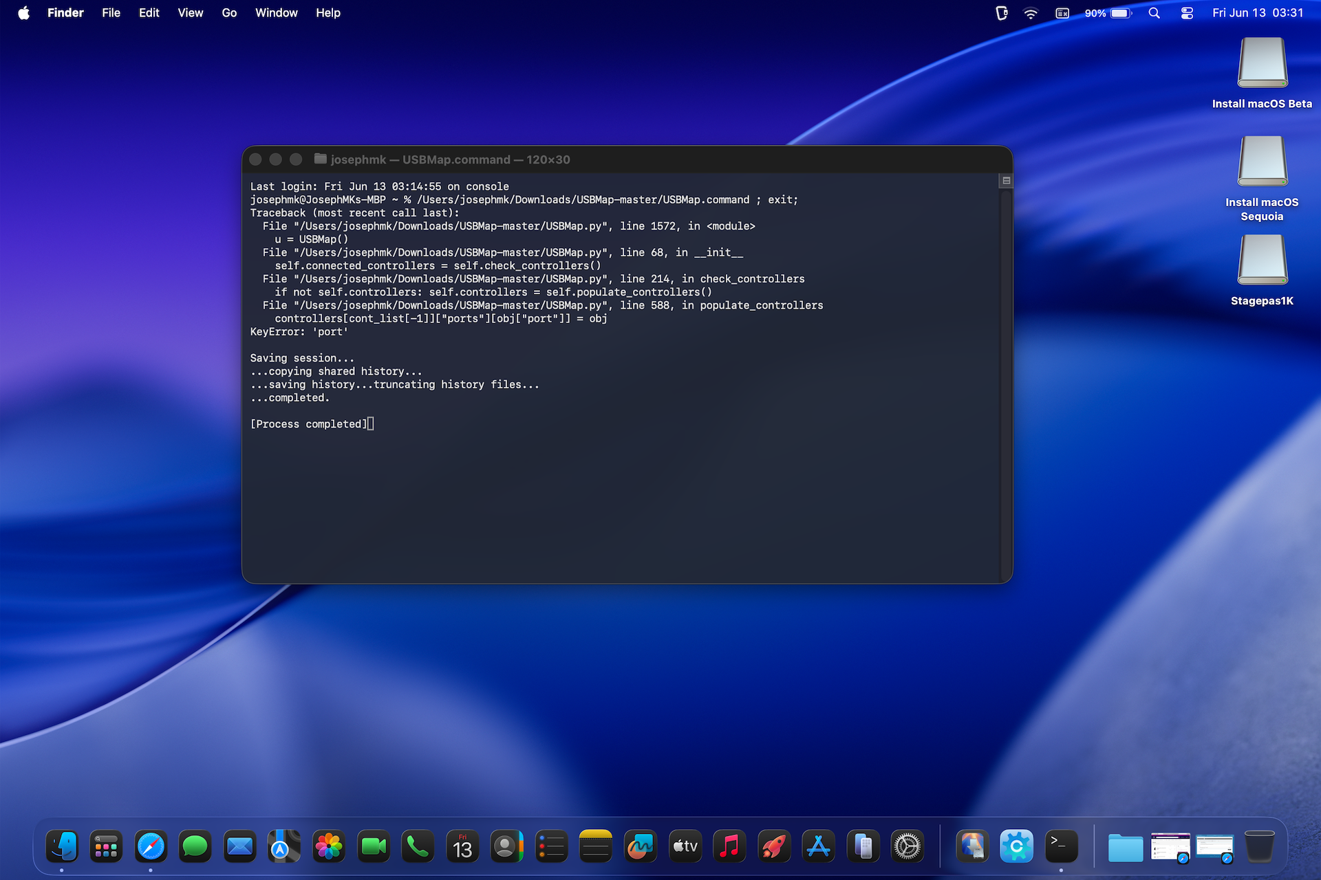

Takiller Posted June 13, 2025 Share Posted June 13, 2025 15 minutes ago, LockDown said: @Takiller https://github.com/corpnewt/USBMap/tree/tahoe-test As for the trackpad, its a race issue between the Voodoo and Apple's own driver 🤔. We have to wait till the 2nd release After running the ./USBMap.command, I get "KeyError: 'port'" and I don't know what might be the cause. Link to comment https://www.insanelymac.com/forum/topic/361162-pre-release-macos-tahoe/page/16/#findComment-2833377 Share on other sites More sharing options...

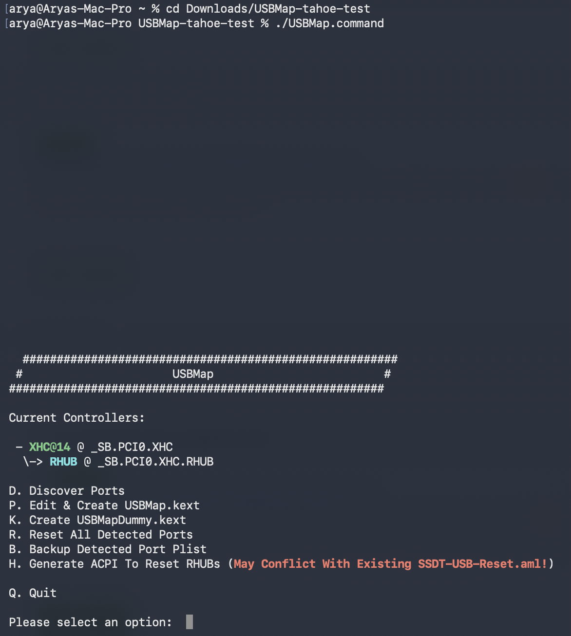

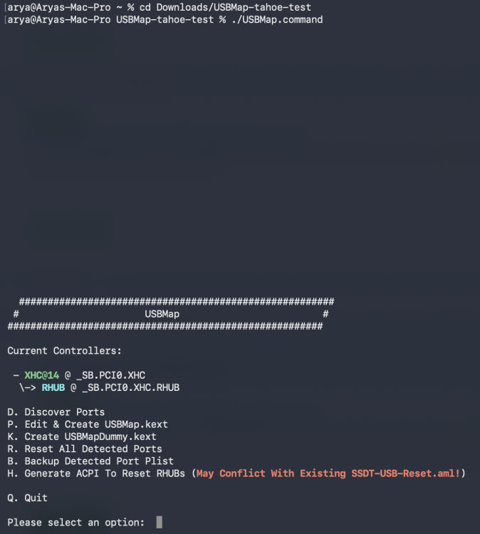

arya Posted June 13, 2025 Share Posted June 13, 2025 38 minutes ago, Takiller said: After running the ./USBMap.command, I get "KeyError: 'port'" and I don't know what might be the cause. for Me, i just xcode-select --install download test repo, unzip, make +x and run 2 Link to comment https://www.insanelymac.com/forum/topic/361162-pre-release-macos-tahoe/page/16/#findComment-2833380 Share on other sites More sharing options...
