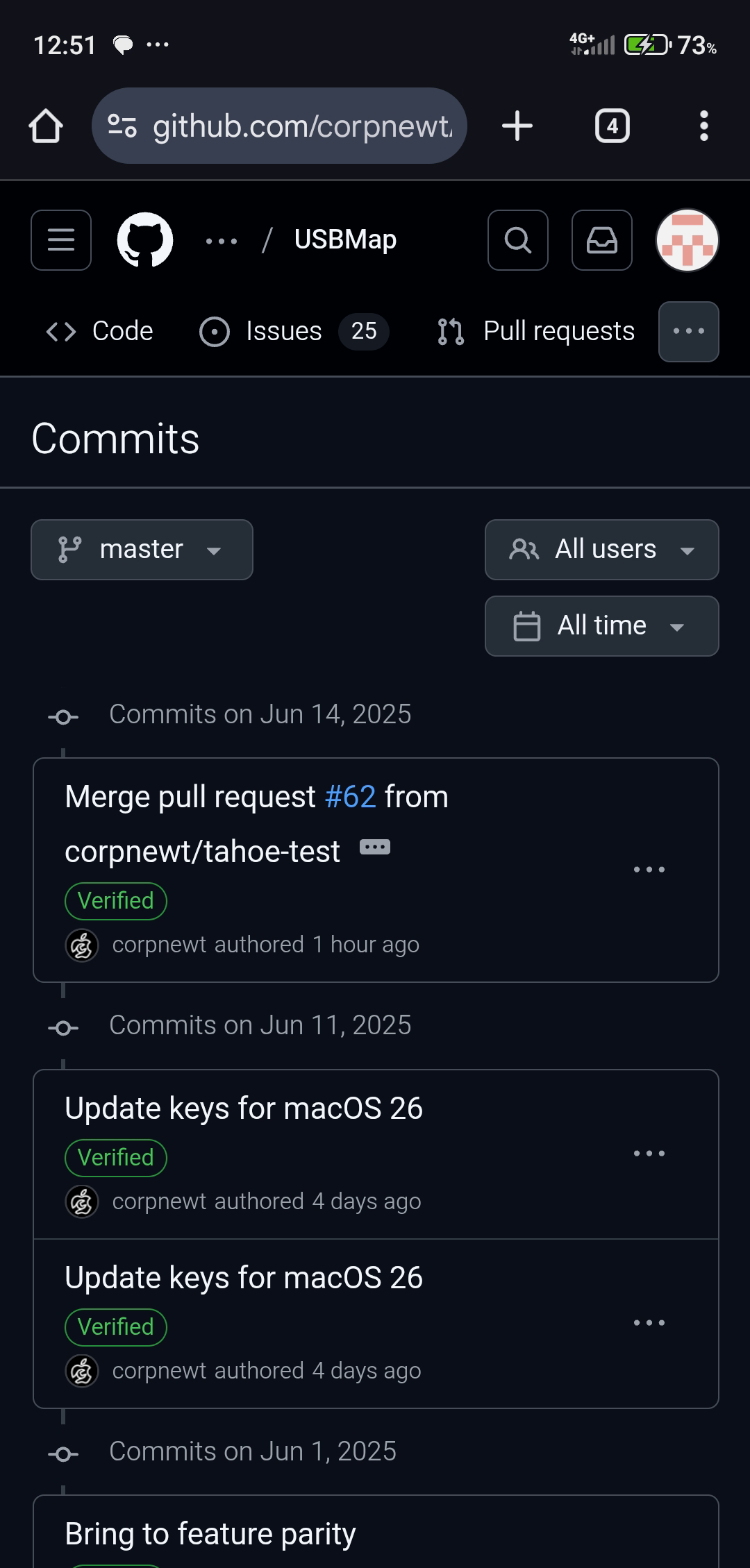

Anto65 Posted June 14, 2025 Share Posted June 14, 2025 (edited) https://github.com/corpnewt/USBMap Merged, Usbmap is official now and ready for macOS 26 , just generated kext Spoiler Edited June 14, 2025 by Anto65 9 Link to comment https://www.insanelymac.com/forum/topic/361162-pre-release-macos-tahoe/page/21/#findComment-2833519 Share on other sites More sharing options...

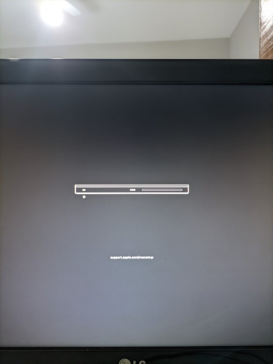

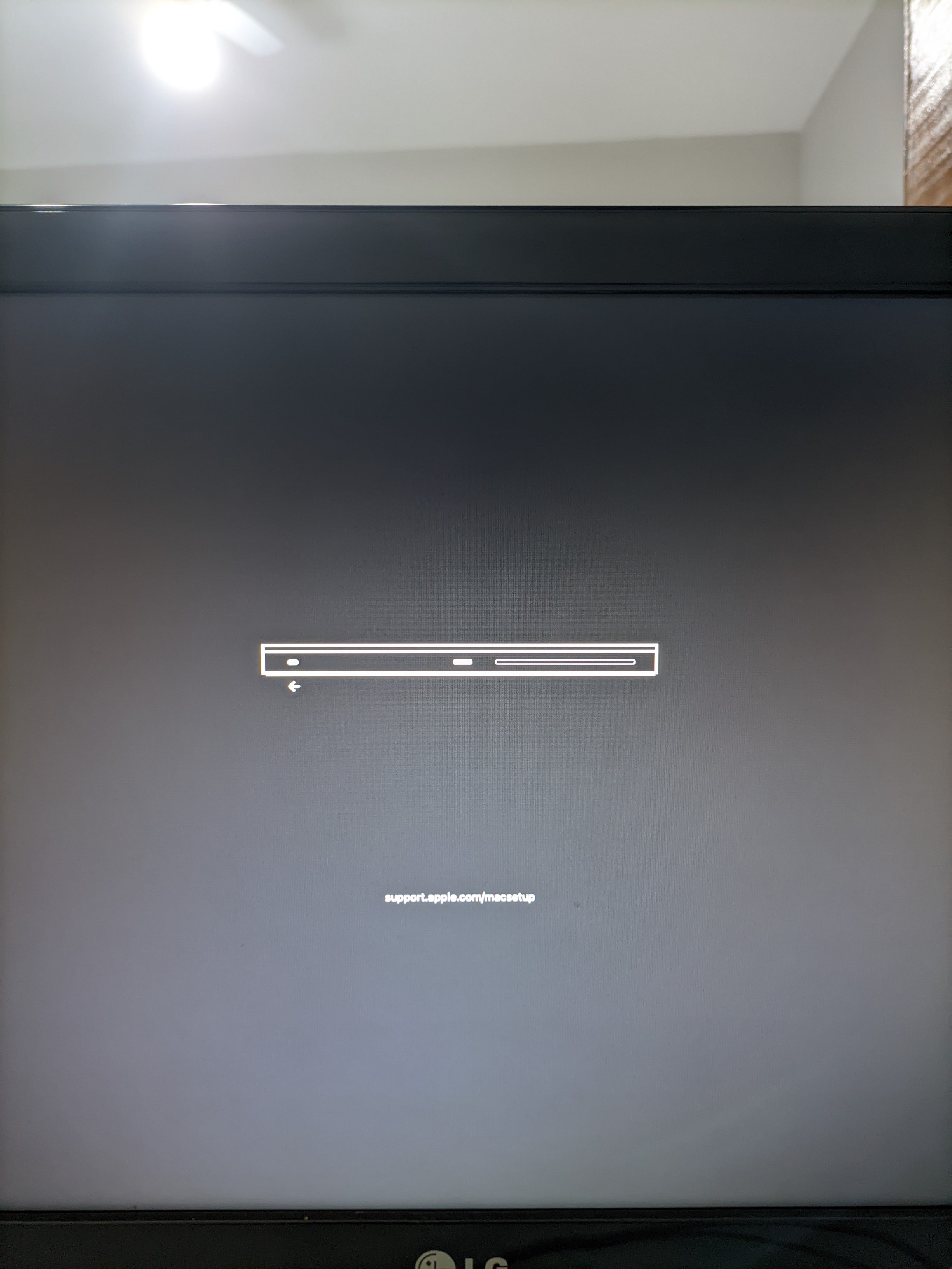

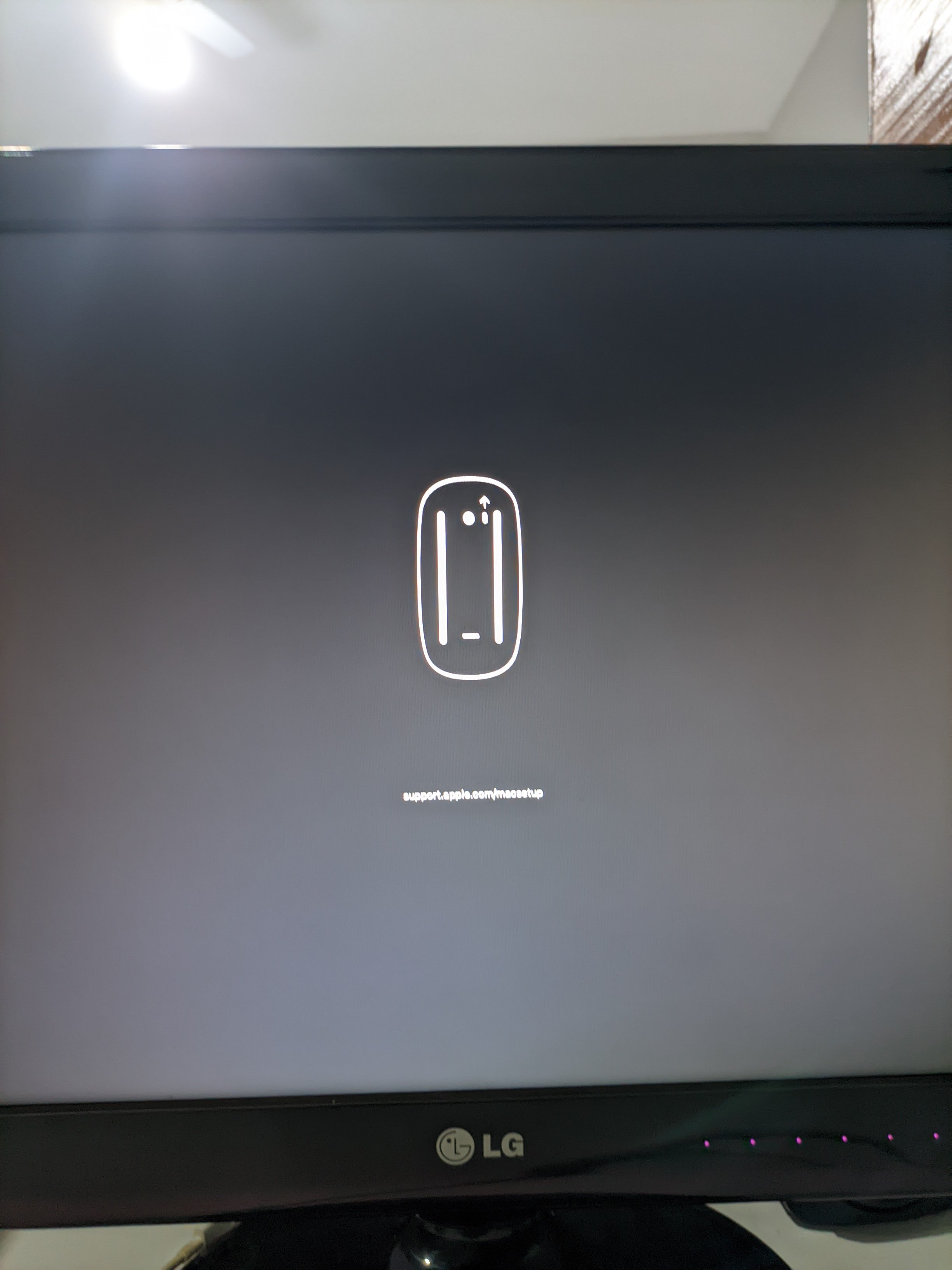

taga Posted June 14, 2025 Share Posted June 14, 2025 When I start installing Tahoe on my hackintosh, this image appears and the USB mouse doesn't work. HP Mini PC Elite Desk 800 G6. i5. Video hd630 OS Sequoia Perfect 2 1 Link to comment https://www.insanelymac.com/forum/topic/361162-pre-release-macos-tahoe/page/21/#findComment-2833521 Share on other sites More sharing options...
HyperX7 Posted June 14, 2025 Share Posted June 14, 2025 2 minutes ago, taga said: When I start installing Tahoe on my hackintosh, this image appears and the USB mouse doesn't work. HP Mini PC Elite Desk 800 G6. i5. Video hd630 OS Sequoia Perfect This sounds like a USB mapping problem. https://github.com/corpnewt/USBMap You need to create your re-USB mapping file compatible with this version Tahoe. Or you need to add your SSDT-UIAC.aml file to OC/ACPI and deaktivate all USB kexts. 4 Link to comment https://www.insanelymac.com/forum/topic/361162-pre-release-macos-tahoe/page/21/#findComment-2833522 Share on other sites More sharing options...

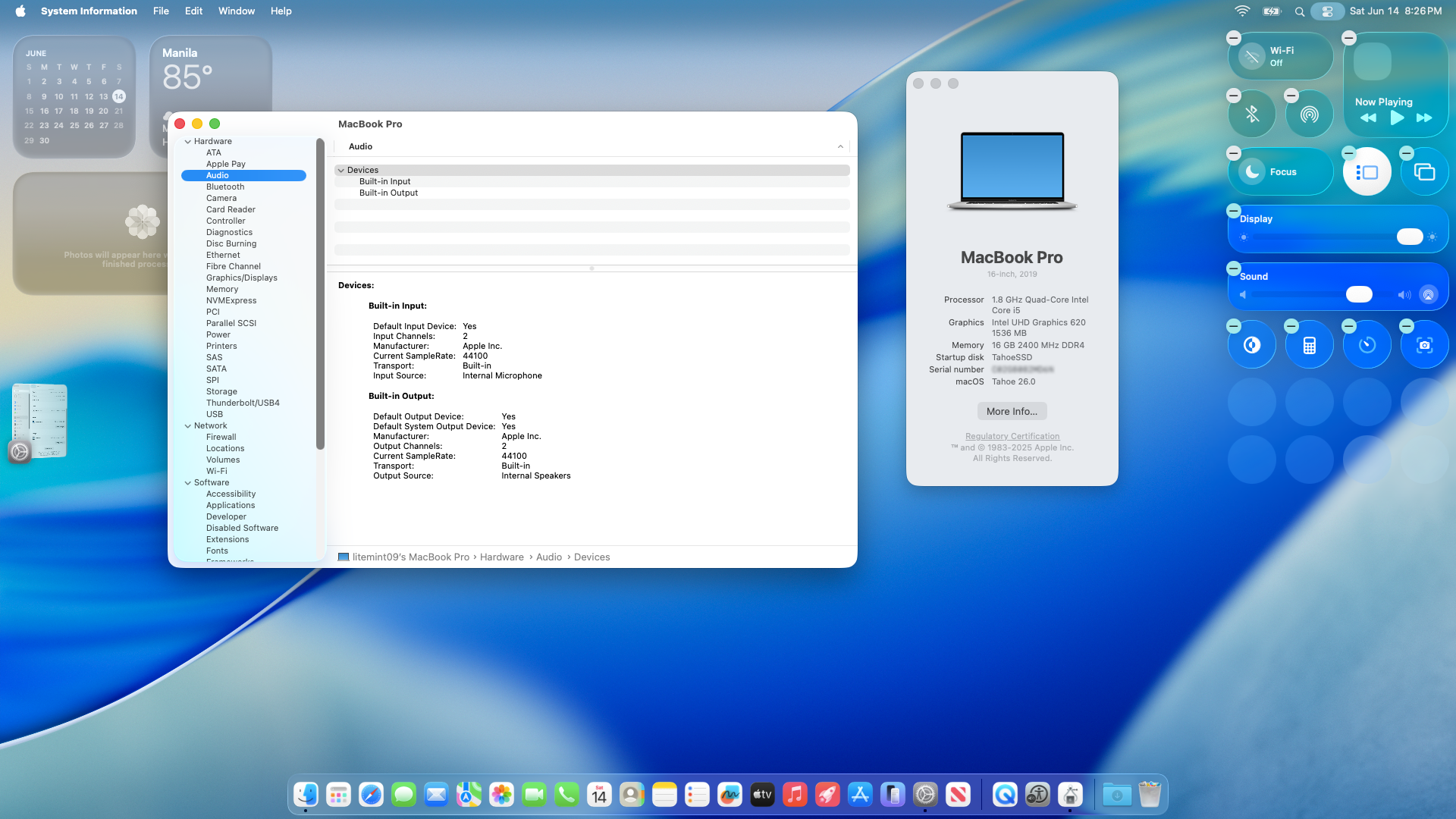

litemint09 Posted June 14, 2025 Share Posted June 14, 2025 Finally made it to the finish line. Thinkpad T480. I used OpCore Simplify to generate the EFI Folder. - Set the SMBIOS to MacBookPro6,1 - Didnt make the USB Port Mapping. I throw the EFI into the install media EFI Partition, and gone through the installation. It was sweet. 6 Link to comment https://www.insanelymac.com/forum/topic/361162-pre-release-macos-tahoe/page/21/#findComment-2833524 Share on other sites More sharing options...

Joshua60 Posted June 14, 2025 Share Posted June 14, 2025 (edited) 19 minutes ago, taga said: When I start installing Tahoe on my hackintosh, this image appears and the USB mouse doesn't work. HP Mini PC Elite Desk 800 G6. i5. Video hd630 OS Sequoia Perfect Imho it could be a smbios problem, try changing it to a supported one. For example iMac20,1, iMac20,2. Edit: Sorry for the late reply, just forget it. Edited June 14, 2025 by Joshua60 Link to comment https://www.insanelymac.com/forum/topic/361162-pre-release-macos-tahoe/page/21/#findComment-2833528 Share on other sites More sharing options...

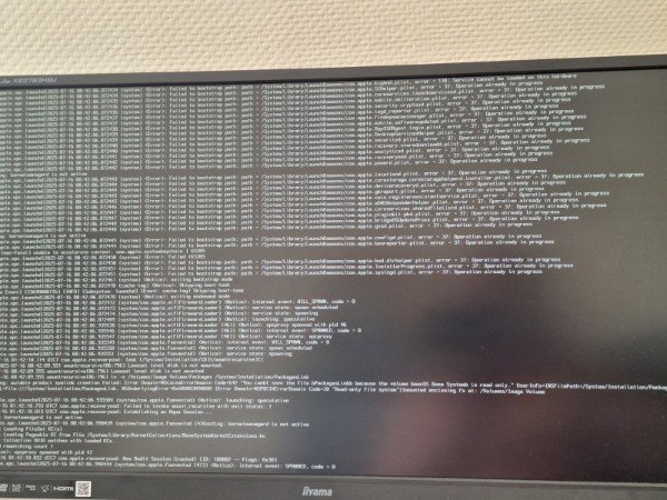

D-an-W Posted June 14, 2025 Share Posted June 14, 2025 (edited) Does anyone have a clue what might be going on here please (I have been away and trying to catch up!) when trying to boot the installer? It get's this far then I get the no entry sign, I enabled verbose so I could see what was happening. I have updated the kexts and (I think!) disabled USB and added a SSDT-UIAC.aml created by Hackintool but still can't boot it. IMG_6140.heic FullSizeRender.heic Edited June 14, 2025 by D-an-W Link to comment https://www.insanelymac.com/forum/topic/361162-pre-release-macos-tahoe/page/21/#findComment-2833531 Share on other sites More sharing options...

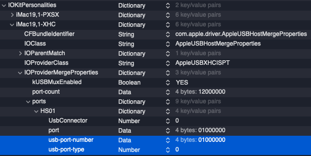

etorix Posted June 14, 2025 Share Posted June 14, 2025 2 hours ago, HyperX7 said: You need to create your re-USB mapping file compatible with this version Tahoe. Or edit your USB map as discussed above to add the new entries for Tahoe. 1 Link to comment https://www.insanelymac.com/forum/topic/361162-pre-release-macos-tahoe/page/21/#findComment-2833535 Share on other sites More sharing options...

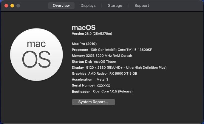

Alpha22 Posted June 14, 2025 Share Posted June 14, 2025 (edited) after reading all your comments, today I installed macOS Thaoe Edited June 14, 2025 by Alpha22 4 Link to comment https://www.insanelymac.com/forum/topic/361162-pre-release-macos-tahoe/page/21/#findComment-2833543 Share on other sites More sharing options...

Anto65 Posted June 14, 2025 Share Posted June 14, 2025 I missed that they added " Another Brick in the Wall " 😄 I went to Git to see the actions ... thx Matgen84 3 1 Link to comment https://www.insanelymac.com/forum/topic/361162-pre-release-macos-tahoe/page/21/#findComment-2833545 Share on other sites More sharing options...

Takiller Posted June 14, 2025 Share Posted June 14, 2025 2 hours ago, D-an-W said: Does anyone have a clue what might be going on here please (I have been away and trying to catch up!) when trying to boot the installer? It get's this far then I get the no entry sign, I enabled verbose so I could see what was happening. I have updated the kexts and (I think!) disabled USB and added a SSDT-UIAC.aml created by Hackintool but still can't boot it. IMG_6140.heic 2.56 MB · 9 downloads FullSizeRender.heic 604 kB · 6 downloads It is because FileVault got activated and is preventing you entry. You must deactivate it by booting to recovery by following a previously posted procedure in this forum and you'll be good to go. 2 1 Link to comment https://www.insanelymac.com/forum/topic/361162-pre-release-macos-tahoe/page/21/#findComment-2833547 Share on other sites More sharing options...
