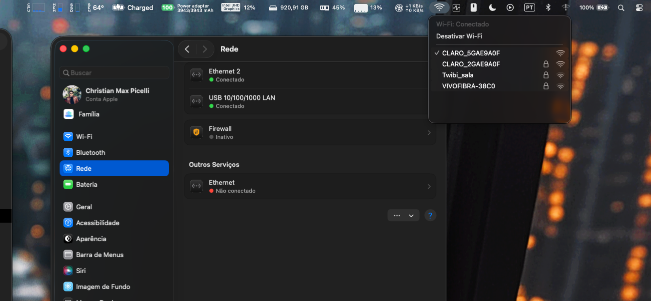

Max.1974 Posted June 12, 2025 Share Posted June 12, 2025 7 minutes ago, robi62 said: o it from the beta ?? I did not as I have no in Yes I run program from beta but I study my hardware for along time to get ACPI fine tuned 1 Link to comment https://www.insanelymac.com/forum/topic/361162-pre-release-macos-tahoe/page/14/#findComment-2833296 Share on other sites More sharing options...

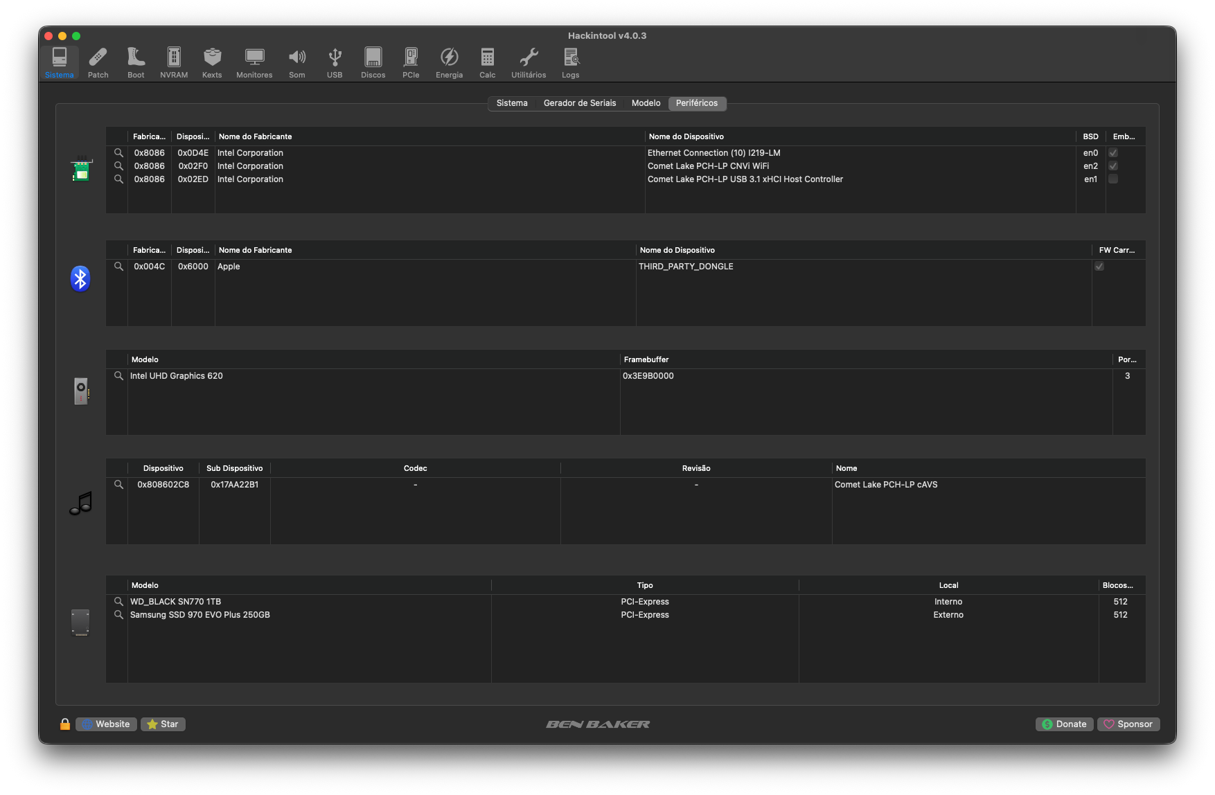

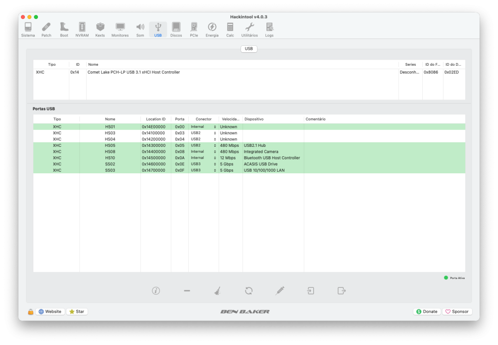

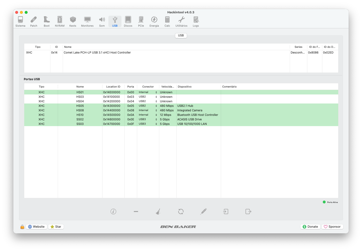

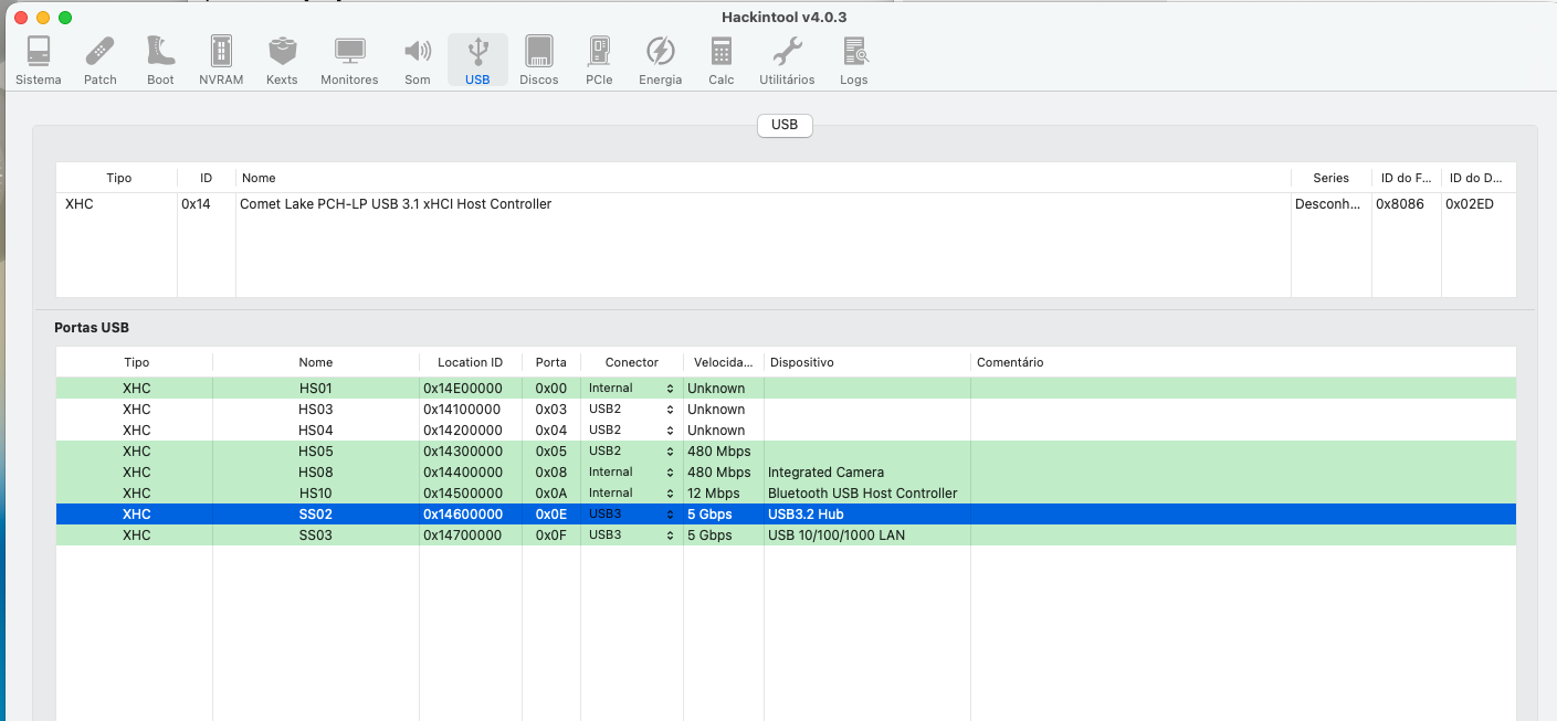

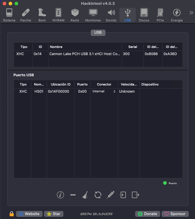

robi62 Posted June 12, 2025 Share Posted June 12, 2025 (edited) 1 hour ago, Max.1974 said: Yes I run program from beta but I study my hardware for along time to get ACPI fine tuned Hi I did that created the kext but not showing in hackintool but on system info they look good?? I used the wrong kext that is why not showing silly me 😂😂 Edited June 12, 2025 by robi62 1 Link to comment https://www.insanelymac.com/forum/topic/361162-pre-release-macos-tahoe/page/14/#findComment-2833299 Share on other sites More sharing options...

Max.1974 Posted June 12, 2025 Share Posted June 12, 2025 (edited) 14 minutes ago, robi62 said: Hi I did that created the kext but not showing in hackintool but on system info they look good?? Maybe you need reforce (enforce) use your RHUB XHCI UIAC testing one by one (I did before) @lorys89 you are genius brother, works fine !! God bless you all !! Edited June 12, 2025 by Max.1974 5 Link to comment https://www.insanelymac.com/forum/topic/361162-pre-release-macos-tahoe/page/14/#findComment-2833301 Share on other sites More sharing options...

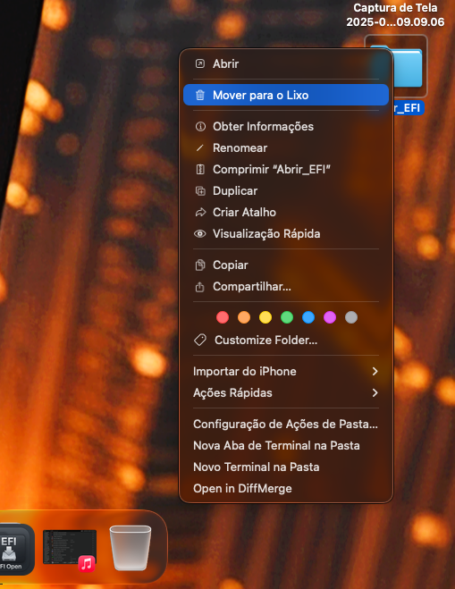

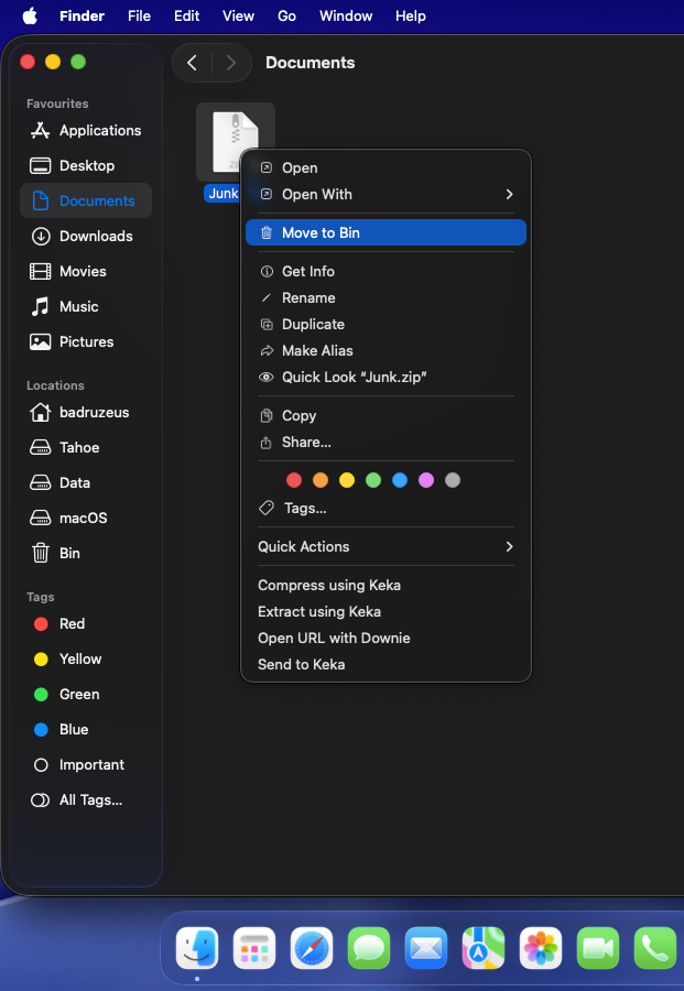

Max.1974 Posted June 12, 2025 Share Posted June 12, 2025 3 hours ago, Badruzeus said: Have you realized that no more "Trash" on macOS 26 but it's now "Bin" w/o "Recycle"..!? 🤦🏻♂️ @Badruzeus Here is the same name in Brazilian Portuguese always was "Lixo" (trash) Maybe is because I can get fresh install 🤷♂️ 2 Link to comment https://www.insanelymac.com/forum/topic/361162-pre-release-macos-tahoe/page/14/#findComment-2833303 Share on other sites More sharing options...

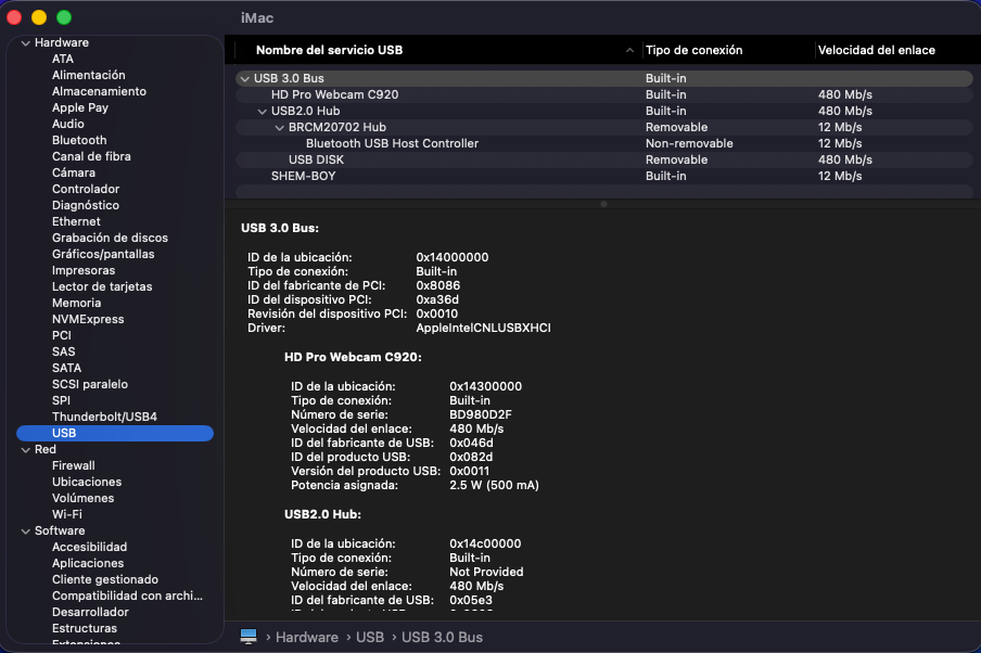

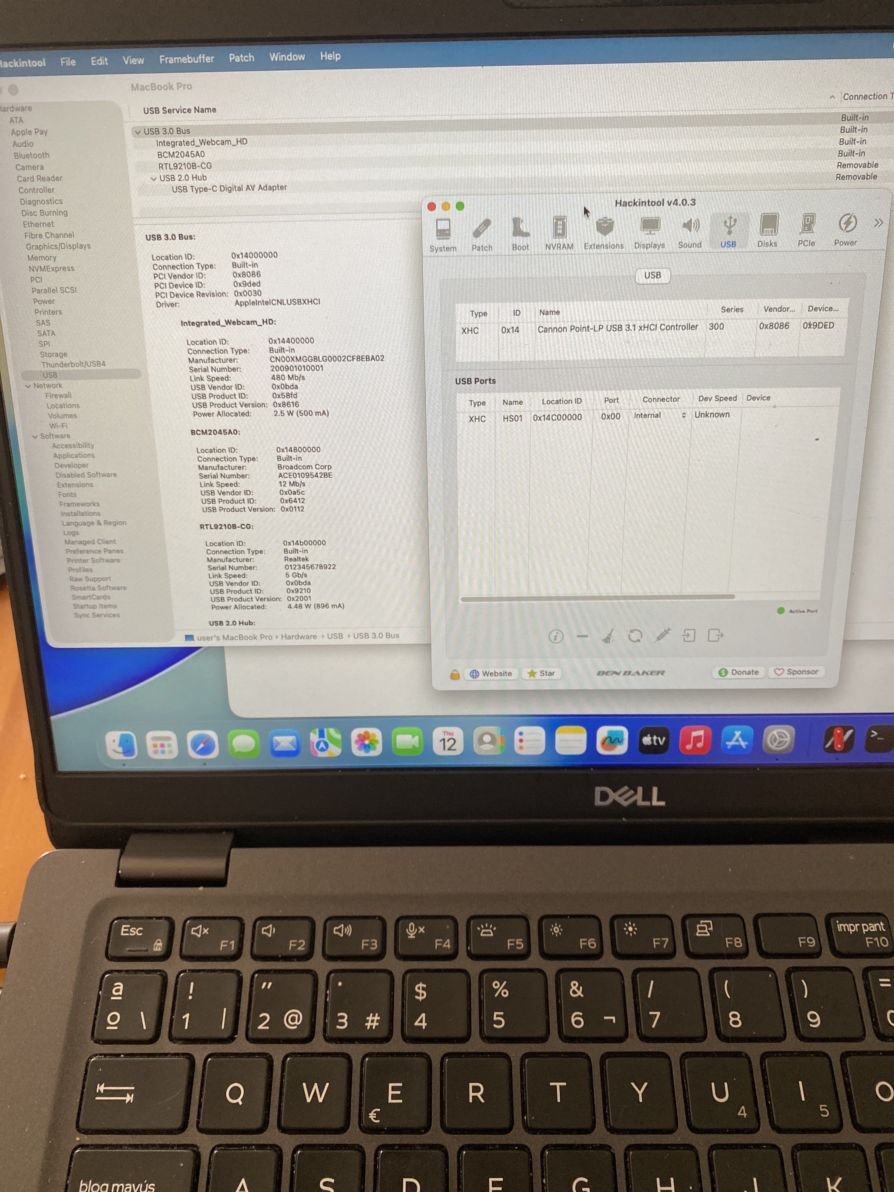

kaoskinkae Posted June 12, 2025 Share Posted June 12, 2025 (edited) I managed to install the NEW: OS X with great effort. First major problem: no support for the Rx570 graphics card. The solution was an installation or boot USB with the UHD630 graphics card active. Without the OCPL kext. After an update that encrypted the computer, I had no choice but to install from scratch. This time, everything was perfect, knowing that the best option is a USB with iMac20.1 to be able to install and boot the system. After using the iMac 19.1 plus Skip-Board-ID-Chek.plist the system works very well with UDH 630 to be able to use the Mac bluetooth keyboard and mouse I needed to remove the USBInjectAll.kext kext and leave only SSDT-UIAC.aml it recognizes all the connected devices but it does not appear reflected in hackitools I have tried the USBMap.kext kext creation method including only this kext I don't know if it is correct without result even blocking the Mac bluetooth keyboard and mouse Is there any other method that could be effective or do I need to include some other kext besides USBMap.kext Edited June 12, 2025 by kaoskinkae 2 Link to comment https://www.insanelymac.com/forum/topic/361162-pre-release-macos-tahoe/page/14/#findComment-2833319 Share on other sites More sharing options...

Anto65 Posted June 12, 2025 Share Posted June 12, 2025 @kaoskinkae use this https://github.com/corpnewt/USBMap/tree/tahoe-test 2 Link to comment https://www.insanelymac.com/forum/topic/361162-pre-release-macos-tahoe/page/14/#findComment-2833321 Share on other sites More sharing options...

kaoskinkae Posted June 12, 2025 Share Posted June 12, 2025 17 minutes ago, Anto65 said: @kaoskinkae use this https://github.com/corpnewt/USBMap/tree/tahoe-test That is the method I used, I created the kext but I only used the created kext and it didn't work. I don't know if the other 2 kexts are necessary. 1 Link to comment https://www.insanelymac.com/forum/topic/361162-pre-release-macos-tahoe/page/14/#findComment-2833323 Share on other sites More sharing options...
