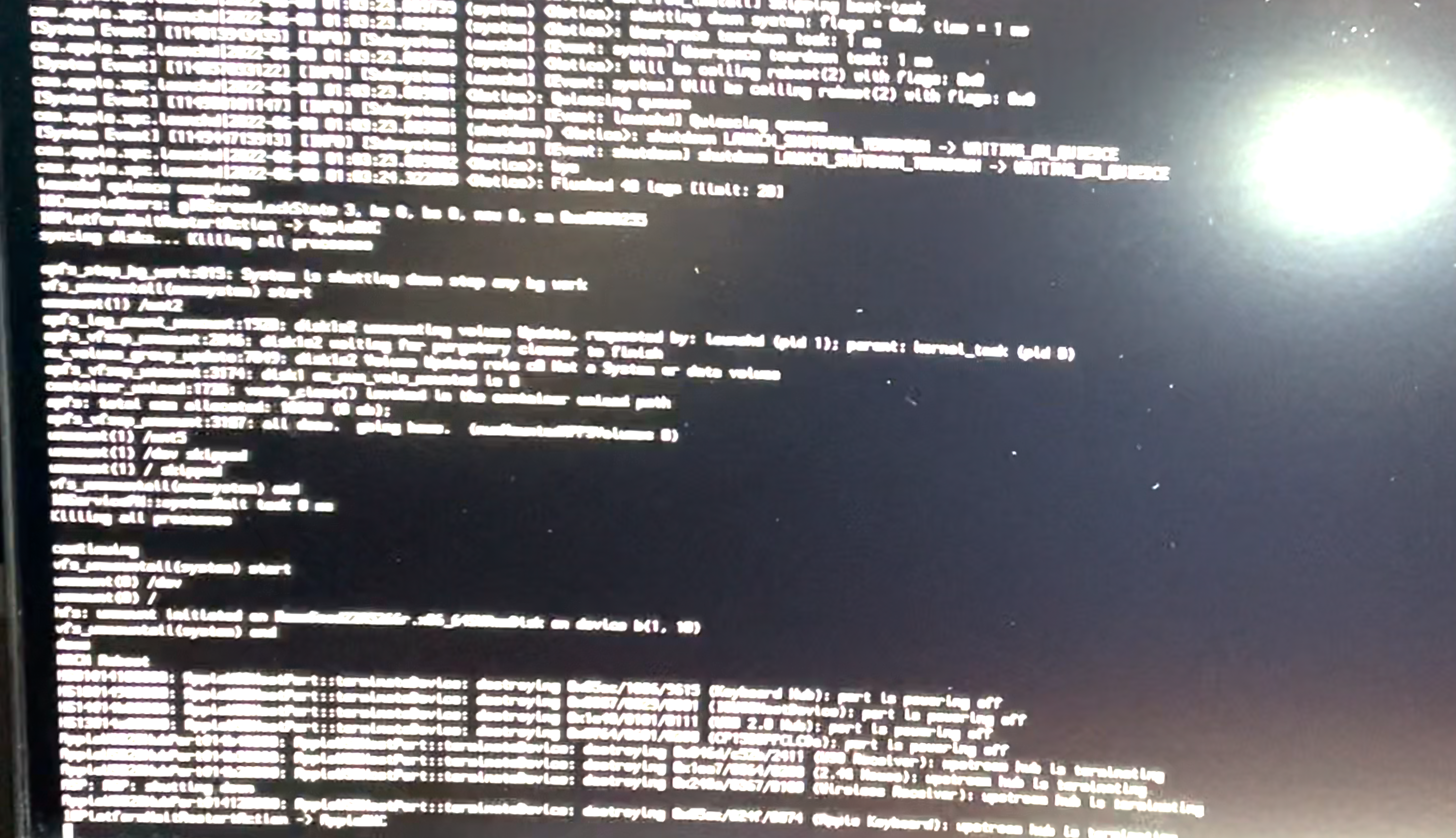

Skyfallkavu Posted June 8, 2022 Share Posted June 8, 2022 2 minutes ago, PropoFlexWX4 said: That is precisely the error I'm seeing. gIOScreenLockState. Seems like some sort of issue with graphics. Exactly mine on Z370. Good job getting a picture of it, that was frustrating me. Link to comment https://www.insanelymac.com/forum/topic/351969-pre-release-macos-ventura/page/7/#findComment-2784051 Share on other sites More sharing options...

Dragster27 Posted June 8, 2022 Share Posted June 8, 2022 28 minutes ago, Skyfallkavu said: Exactly mine on Z370. Good job getting a picture of it, that was frustrating me. Same error here on Dell XPS 7590 i7 9th gen... Link to comment https://www.insanelymac.com/forum/topic/351969-pre-release-macos-ventura/page/7/#findComment-2784055 Share on other sites More sharing options...
Skyfallkavu Posted June 8, 2022 Share Posted June 8, 2022 34 minutes ago, Dragster27 said: Same error here on Dell XPS 7590 i7 9th gen... It has to be something with memory space inaccuracy if we all get it at the same point. If I leave this off, I get NVMe errors booting into Monterey. I was trying to mess with other quirks with no success. Does anyone have their KASLR slide values calculated? I provide mine but have it set to 0 1 Link to comment https://www.insanelymac.com/forum/topic/351969-pre-release-macos-ventura/page/7/#findComment-2784057 Share on other sites More sharing options...
PropoFlexWX4 Posted June 8, 2022 Share Posted June 8, 2022 14 minutes ago, Skyfallkavu said: It has to be something with memory space inaccuracy if we all get it at the same point. If I leave this off, I get NVMe errors booting into Monterey. I was trying to mess with other quirks with no success. Does anyone have their KASLR slide values calculated? I provide mine but have it set to 0 Leave what off? And if you can boot into Ventura, than its fine! Link to comment https://www.insanelymac.com/forum/topic/351969-pre-release-macos-ventura/page/7/#findComment-2784064 Share on other sites More sharing options...
Skyfallkavu Posted June 8, 2022 Share Posted June 8, 2022 17 minutes ago, PropoFlexWX4 said: Leave what off? And if you can boot into Ventura, than its fine! I meant the AvoidRuntimeDefrag quirk, and no, since it looks like 300 series boards typically need this quirk enabled to boot anything. We’re either stuck in the Ventura installer on GPU errors or unable to boot Monterey with it disabled. I myself get NVMe errors on Monterey, so it seems PCIE allocation is the culprit here. It’s something with how the kernel is allocating PCIE address space on our boards. Properly declared KASLR slides might be a solution? I only have 140 pages available. Link to comment https://www.insanelymac.com/forum/topic/351969-pre-release-macos-ventura/page/7/#findComment-2784067 Share on other sites More sharing options...

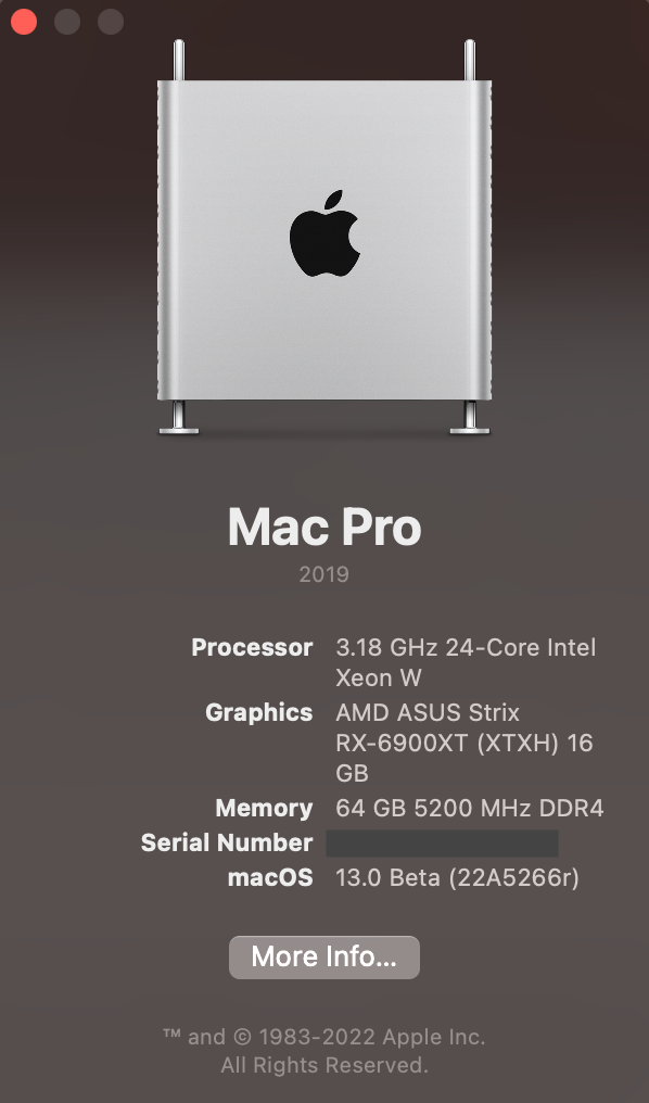

iGPU Posted June 8, 2022 Share Posted June 8, 2022 Formatted an internal NVMe drive, and installed Ventura very easily on an ASUS Z690 Max Extreme with OC v082, latest updated kexts, after downloading file as described here. boot argument -lilubetaall was necessary as was Booter/Quirks/AvoidRuntimeDefrag being disabled. *** also, need to remember to re-set any MaxKernel to either blank or 22.99.99; otherwise those items won't be loaded in Ventura. *** One nice thing is that both I225V and Aquantia AQC113 are working as shown below in Ventura (using only Kernel/Quirks/ForceAquantiaEthernet): The built-in thunderbolt has drivers loaded but is not working (Spoiler): Spoiler Link to comment https://www.insanelymac.com/forum/topic/351969-pre-release-macos-ventura/page/7/#findComment-2784070 Share on other sites More sharing options...
