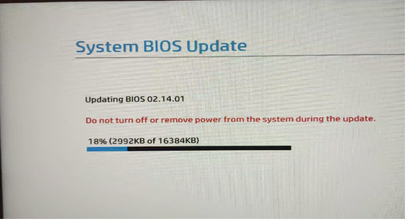

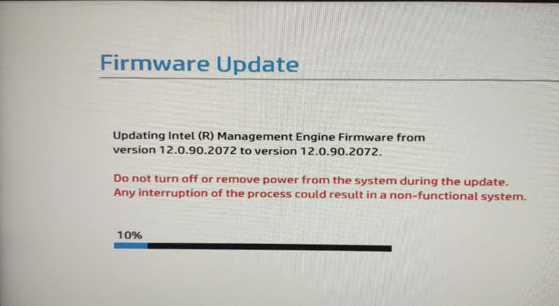

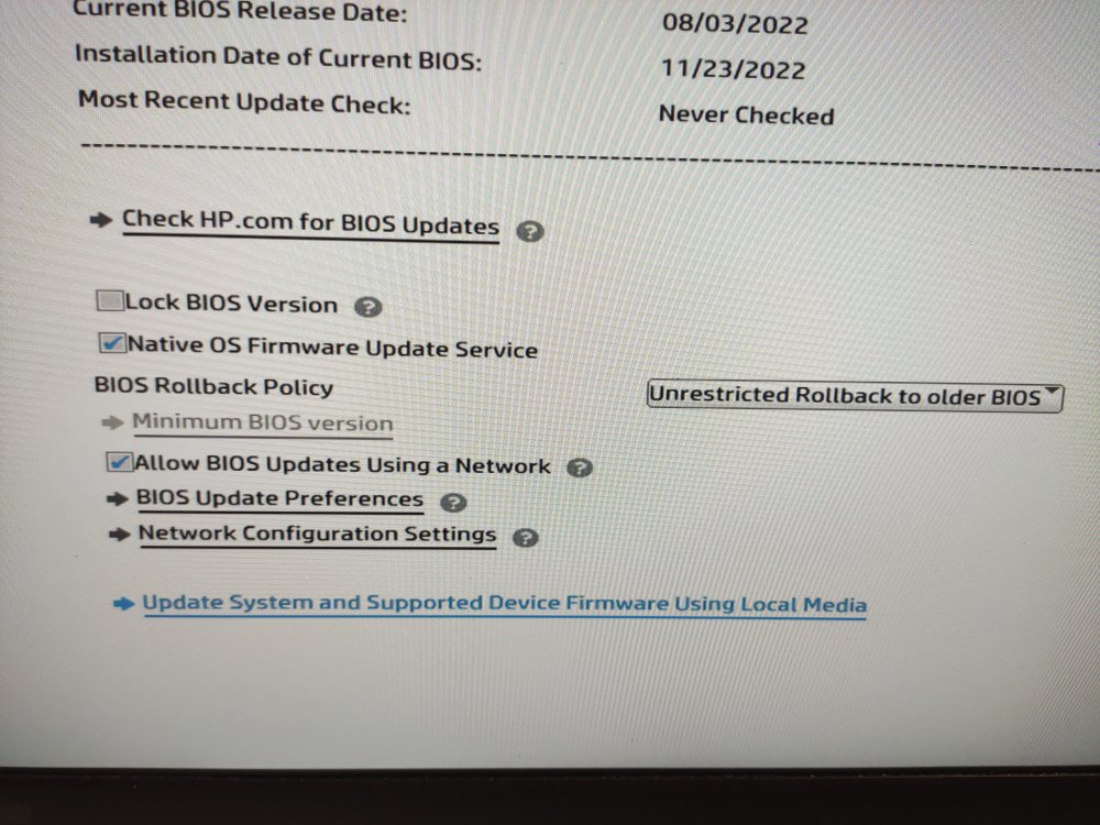

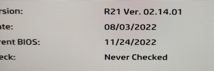

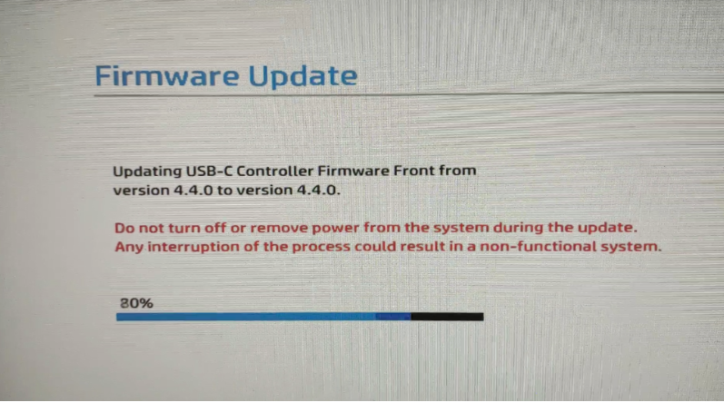

Following @Jazzoo 's lead, I upgraded my HP EliteDesk 800 G5 Mini BIOS to version 02.15.00 Rev.A.  Similar to @Stefano Pugliese 's experience, the BIOS upgrade was not available via the built-in updater in BIOS.  To upgrade BIOS, I performed the following steps (using a BIOS Recovery flash drive):
  1. In Windows (not macOS), visit the support website for the HP EliteDesk 800 G5 Mini (or the website for the G4 Mini if you have a G4 Mini).  I don't have Windows installed on my HP EliteDesk Mini, so I needed to use a separate Windows PC for this.
  2. Insert a USB flash drive into a USB port on the Windows PC and format it using FAT formatting
  3. Download the latest BIOS update executable (e.g, sp142789.exe for the G5 Mini or sp143306.exe for the G4 Mini)
  4. Run the BIOS update executable downloaded in step 3 above and follow the steps to create a Recovery USB flash drive.
  5. When prompted, select the USB flash drive that you inserted in step 2 above and allow the HP utility to create the recovery flash drive.   If the BIOS update executable does not create a recovery flash drive, manually create a BIOS recovery flash drive by copying the BIOS .bin file from the HP BIOS folder to \HP\DEVFW\FIRMWARE.BIN on the flash drive.
  6. Eject the USB flash drive and insert it into a USB port on your HP EliteDesk Mini
  7. Boot your HP EliteDesk Mini into BIOS configuration (press F10 while booting)
  8. Choose the option to upgrade BIOS and scroll down and click "Update System and Supported Device Firmware Using Local Media"
  9. Be patient while your HP EliteDesk Mini copies the new BIOS from your USB flash drive. This may require multiple reboots.  Do not interrupt the BIOS upgrade process.
  10. When the BIOS upgrade is finished, your HP EliteDesk Mini will boot normally
NOTE:
I upgraded my HP EliteDesk 800 G4 and G5 Mini BIOS using the steps I outlined above.  The BIOS upgrade executable for the G5 Mini worked fine for me and it created the BIOS Recovery flash drive without any problems.  The BIOS upgrade executable for the G4 Mini did not work for me, so I needed to manually create the BIOS recovery flash drive for the G4 Mini as follows:
  1. Download the G4 Mini BIOS upgrade executable (e.g., sp143306.exe)
  2. Run the BIOS upgrade executable (sp143306.exe) to create folder c:\swsetup\sp143306 which contains the BIOS upgrade files.
  3. Create folder \HP on the USB flash drive
  4. Create folder \HP\DEVFW on the USB flash drive
  5. Copy the BIOS .bin file (q21_022100.bin) from c:\swsetup\sp143306 to \HP\DEVFW\firmware.bin on the flash drive.
  6. The BIOS upgrade file (firmware.bin) is now in folder \HP\DEVFW on your flash drive.  Proceed with the G4 Mini BIOS upgrade by continuing with step 6 in my procedure above
Edited by deeveedee
  • Like 4
@Stefano Pugliese I apologize for the mistake in my instructions.  I should have said to upgrade using local media (not external media).  I have made the correction in my instructions.  After inserting the USB flash drive with \HP\DEVFW\FIRMWARE.BIN, choose the option "Update System and Supported Device Firmware Using Local Media."
  • Thanks 1
2 hours ago, deeveedee said:
@Stefano Pugliese I'm sorry that my instructions did not help you.  I have no more suggestions.  Please contact HP for technical support.
Done
The answer is to start the machine holding down win+B for all the startup process (with the bios usb drive plugged in)
Nothing changed
Edited by Stefano Pugliese
@Stefano Pugliese Holding Win + B when powering-up the HP EliteDesk with the USB flash drive inserted is a shortcut for the same BIOS recovery that you perform when selecting "Update System and Supported Device Firmware Using Local Media."
The only way to perform a BIOS recovery without changing the BIOS version is if the BIOS version on the recovery flash drive is the same as the BIOS version that is already installed.
 I'm guessing since I don't know all the steps you performed, but when you used Win + B to perform your BIOS recovery, I suspect that you also downloaded the new BIOS version to your flash drive.

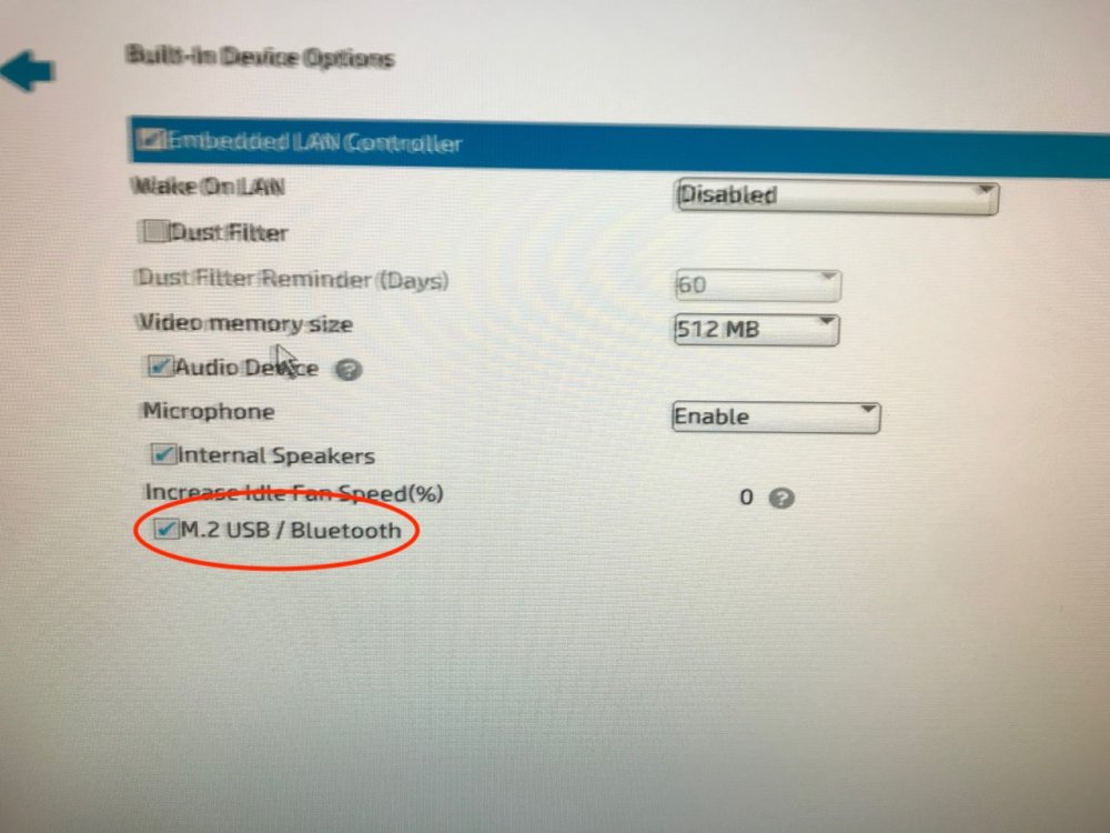

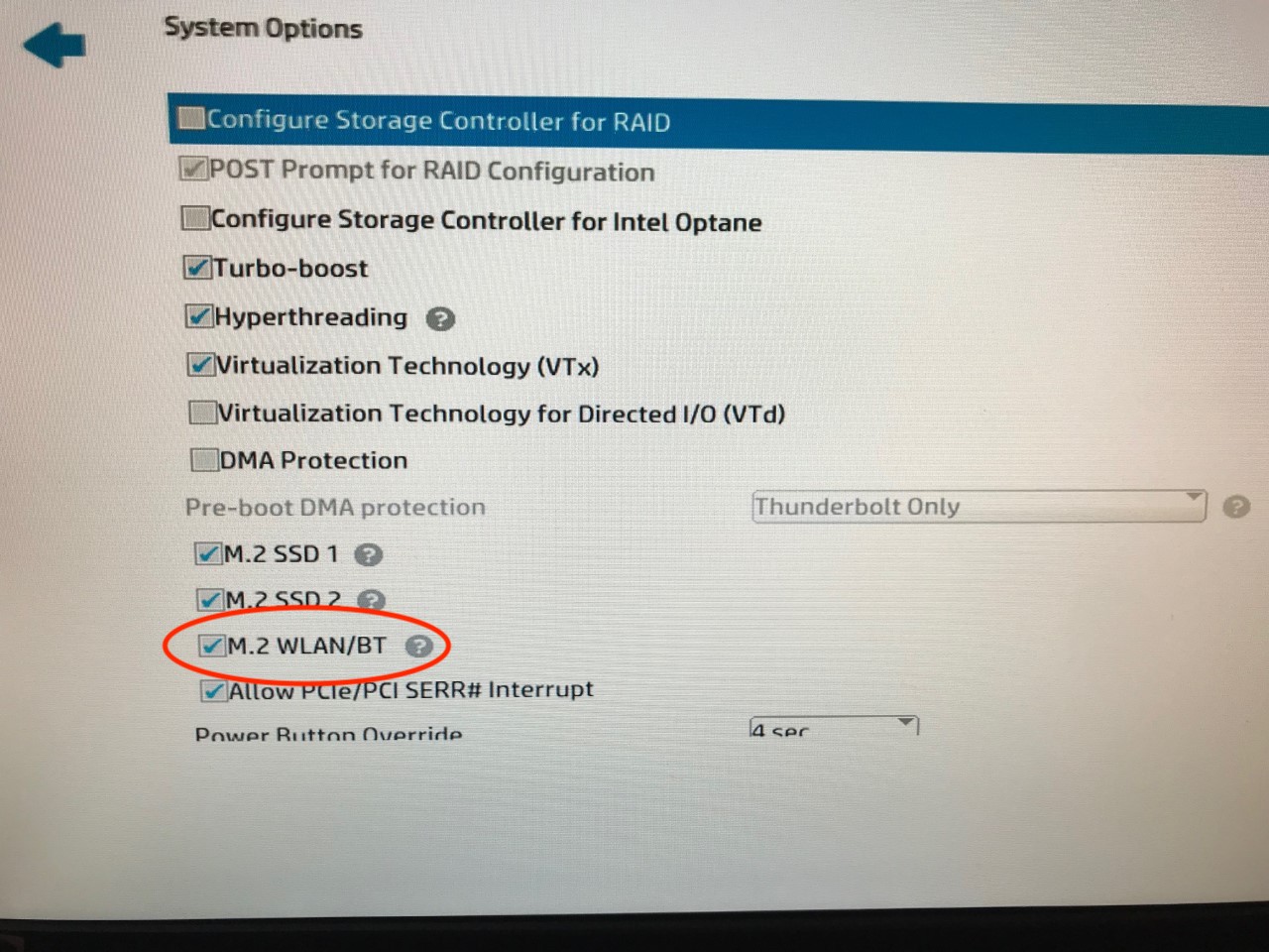

BCM94360NG Installation Steps
  • Install BCM94360NG card and connect antennas
  • Enable Bluetooth USB in BIOS (there are two items in BIOS that must be configured for working Bluetooth)
    BIOS System Options
    Spoiler
    BIOS Built-in Device Options
    Spoiler
  • Revise EFI as follows:
    • Create a new USBPorts.kext by editing the USBPorts-16.kext that I include in my EFI: Edit USBPorts-16.kext/Contents/Info.plist to remove port SS10 so that the Info.plist has only 15 USB ports while enabling port HS14 (for Bluetooth).  15 USB ports  is the max allowed by macOS Ventura.
    • Replace the existing USBPorts kext in my EFI with this new USBPorts.kext that now includes USB port HS14
    • Add AirportBrcmFixup.kext to OC/Kexts and in the config.plist Kexts > Add (addition of this kext is probably optional but just a habit for me)
  • Boot Ventura and configure Wi-Fi
  • Turn-on Bluetooth and connect to Bluetooth devices

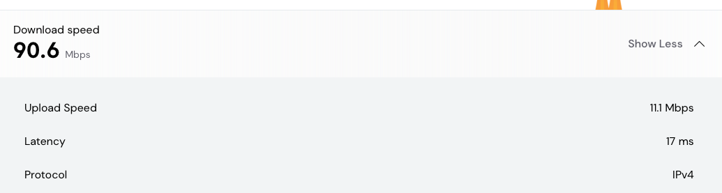

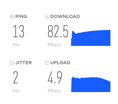

My home Internet connection is 75 Mbps down and 5 Mbps up.  As you can see, with an 802.11a Wi-Fi link, I'm maxing out my home Internet speed.  For the test below, I'm 100 feet way from my router / AP on a different floor through several walls (wood /  drywall construction).  This Wi-Fi / Bluetooth card is fine for me.  If you have blazing fast Internet with a modern router / 802.11ac AP, this card will limit your performance as discussed here.  I am using the antennas that came with the EliteDesk 800 G4 Mini 65W.
My home Internet connection is 75 Mbps down / 5 Mpbs up, so this card is fine for me
Spoiler
EDIT: New Internet connection speedtest
I checked with my Internet provider and learned that I'm supposed to be getting 10Mbps up, so I re-ran the test with a different speedtest (still connected via Wi-Fi).  New results are below.  Up and down speeds are good.  It appears that different speed tests produce different results.
Spoiler
