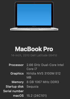

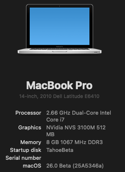

deeveedee Posted October 18, 2022 Share Posted October 18, 2022 (edited) I do not believe that OCLP is safe to use for secure operations (like accessing bank records and investments). If you need to perform secure computing operations in Sonoma, buy a Mac or a hack that supports it without OCLP. See here. This thread is for Big Sur and later macOS installations on the 2010 Dell Latitude E6410 Laptop with Nvidia Graphics. I have successfully created an Open Core EFI based on my work here (which had a custom DSDT, used CLOVER and used DosDude's patcher). This new solution employs Open Core ACPI hot patches (binary renames and SSDTs, no custom DSDT). The working solution has virtually no ACPI errors. Sleep / Wake, Wi-Fi, BlueTooth, USB, Audio, WebCamera, Graphics Acceleration and everything else I have tested is working perfectly in High Sierra and Big Sur. Virtually all except for BlueTooth is working perfectly in Monterey and Ventura. In this solution, I used Open Core Legacy Patcher (OCLP, which is designed for real Macs) to create an EFI that I selectively combined with my own custom EFI to produce the correct EFI for Big Sur. No legacy patching (patches from OCLP) are necessary for High Sierra (which natively supports Nvidia graphics). My known issues with this hack are here. If I don't list the issue, it works or I didn't test it. This thread is for a Dell Latitude E6410 with the following specifications: Nvidia graphics (this thread will not work for the Dell Latitude E6410 that uses Intel graphics) Broadcom Wi-Fi / Bluetooth (this thread will not work if you have not replaced your original Intel Wi-Fi with Broadcom. I am using BCM 94352HMB. Note that at the time of this writing, Bluetooth is not working in Monterey and Ventura, but is working in Big Sur. BIOS Version A17 I am not planning to make this thread a tutorial for beginners. You will require hackintosh patching experience to follow and use my methods documented here. If you find something you do not understand, Google is your friend. I will expand this thread into a brief guide for installing macOS Big Sur and later (as supported) on this old but very capable laptop. A summary of my hacking approach is documented here. Big Sur Spoiler Monterey Spoiler Ventura Spoiler Sonoma Spoiler Sequoia Spoiler Tahoe Spoiler See here for High Sierra EFI See here for Big Sur EFI (use for Big Sur, Monterey, Ventura, Sonoma and Sequoia) Edited August 20, 2025 by deeveedee 5 2 Link to comment https://www.insanelymac.com/forum/topic/354497-guide-dell-latitude-e6410-nvidia-hackintosh-big-sur-monterey-ventura-sonoma-sequoia-tahoe-installations-with-open-core-legacy-patching/ Share on other sites More sharing options...

deeveedee Posted October 18, 2022 Author Share Posted October 18, 2022 (edited) Big Sur, Monterey, Ventura, Sonoma and Sequoia Solution *** Important *** In order to upload the attached EFI without exceeding my 10MB upload limit, I removed IO80211FamilyLegacy.kext from OC/Kexts folder. Add IO80211FamilyLegacy.kext to OC/Kexts from here. *** Important *** At the time of this post, if running Ventura, DO NOT upgrade Safari beyond version 18.1.1. If you accidentally upgrade beyond 18.1.1 and have problems, see here. Note that the Safari 18.1.1 installer may no longer be available for direct download from Apple. This EFI will boot multiple versions of macOS as stated below. If you switch from one version of macOS to another (e.g., you boot Ventura, shutdown and boot Big Sur), be sure to ResetNVRAM before booting the new version of macOS. This EFI uses VirtualSMC with boot-arg vsmcgen=1. FakeSMC and related sensor kexts are included in OC/Kexts, but are not enabled in config.plist. IF you want to use HWMonitor here to view FakeSMC sensors, you must disable VirtualSMC and enable FakeSMC/sensor kexts in config.plist. The attached EFI for Big Sur, Monterey, Ventura, Sonoma and Sequoia is based on Open Core 1.0.4 and incorporates elements of the EFI generated by Open Core Legacy Patcher 2.3.2 for MacBookPro6,2. It boots Big Sur, Monterey, Ventura, Sonoma and Sequoia without issues. Once booted, macOS Ventura through Sequoia work very well with minor limitations as documented by OCLP Devs. It is designed to accompany OCLP 2.3.2 post-install patches. Installing Big Sur through Sequoia Create a Big Sur+ USB installer Use OpenCore's LegacyBoot utility to install Duet on the USB installer Add IO80211FamilyLegacy.kext to the attached EFI OC/Kexts folder (from here). Add your custom PlatformInfo to the attached EFI Copy the attached EFI (with your custom PlatformInfo and added 80211 kext) to the USB EFI Boot from the USB stick and install Big Sur to your SSD Use OpenCore's LegacyBoot Utility to install Duet on the SSD Copy the attached EFI (with your custom PlatformInfo and added 80211 kext) to the SSD EFI Boot Big Sur from the SSD After booting Big Sur for the first time from your SSD, use OpenCore's LogoutHook utility to install emulated NVRAM. Do not reboot. After installing LogoutHook utility, use OpenCore Legacy Patcher to apply patches for MacBookPro6,2. If OCLP does not auto-detect your MacBookPro6,2 SMBIOS Mac model, open OCLP Settings to change SMBIOS to MacBookPro6,2 and then apply patches. Apply power management settings using the script attached here. Reboot WARNING: If installing Ventura, do not upgrade Safari beyond version 18.1.1. OC1.0.4-EFI-BigSur-R04-232.zip Edited May 12, 2025 by deeveedee Upgraded to OC 1.0.4 and OCLP 2.3.2 3 Link to comment https://www.insanelymac.com/forum/topic/354497-guide-dell-latitude-e6410-nvidia-hackintosh-big-sur-monterey-ventura-sonoma-sequoia-tahoe-installations-with-open-core-legacy-patching/#findComment-2795362 Share on other sites More sharing options...
