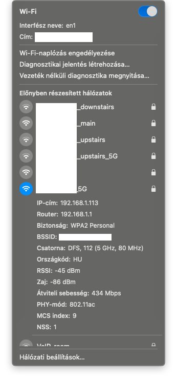

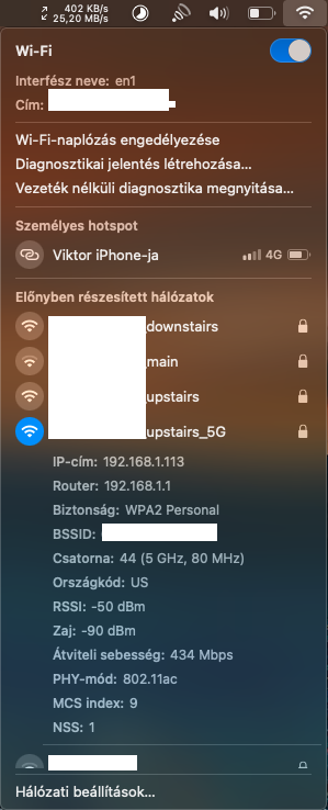

So everything is okay, not lagging, not crashing, but there is a very strange behaviour on macOS and I don't really know what is causing that. Speed/rate was okay with BCM94352Z.
The problem:

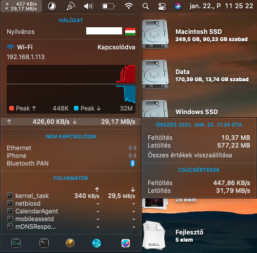

1. If I boot to macOS from a cold start, or from a normal shutdown/start, the rate is always capped at 434 Mbit/s no matter what. Also the download speed is capped at 25-30 MB/s (should be ~60 MB/s)
1137644367_Kpernyfot2021-01-22-11_25_34.png.b4f69432b25898c1e098a3cf3c931f8c.png 1063271302_Kpernyfot2021-01-22-11_25_23.png.cf169475cc230dbd86a4eba151f47c02.png
As you can see, the speed is slow, rate is not 866 Mbit/s

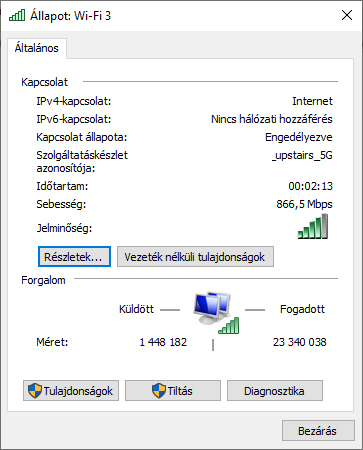

2. On Windows, everything is okay, the rate is 866 Mbit/s, speed is also okay (~45 MB/s, not as good as on macOS, but it's okay).
Speed/rate on Windows is okay

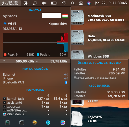

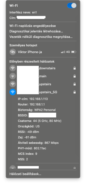

3. So here is the interesting part: If I reboot from Windows (not shutdown and start but reboot) to macOS, the rate is okay, 866 Mbit/s, and the speed is ~60 MB/s. Still good after sleep, breaks after a shutdown.
1061714981_Kpernyfot2021-01-22-11_30_09.png.3d45b9cadabc3a6fad045b9c1bf83636.png 1966641297_Kpernyfot2021-01-22-11_30_45.png.30c7535f89b961fe55aff18478fa7c25.png
Speed/rate are okay after restarting from Windows

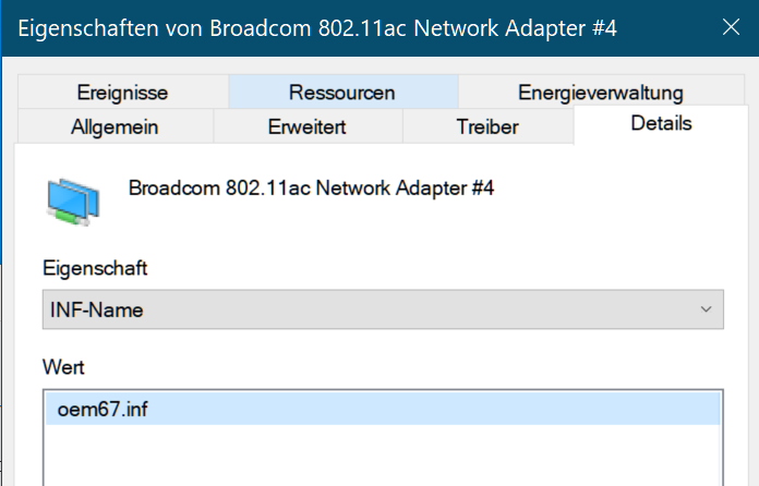

It's installed by Windows Update.
Driver date: 2015. 07. 20.
Version: 7.35.295.2
Someone here on Insanelymac posted a bootcamp driver zip for BCM94360CD, that is also working with this card

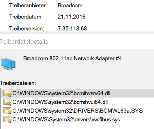

I've tried a Bootcamp driver an a driver from Windows update, the Windows driver is from 2016 and the speed is only 400 MBit/s. Can you please upload the driver you're using? Maybe I find a difference.
I wonder if no one else noticed this issue, or do we have faulty cards?
Spoiler
Spoiler
Edited by wern apfel
@wern apfel You can download it here: https://www.catalog.update.microsoft.com/Search.aspx?q=broadcom+802.11n+network+adapter
version: 7.35.295.2
Others also experienced this issue: https://github.com/acidanthera/bugtracker/issues/1532

On 3/3/2021 at 6:57 PM, kushwavez said:
Thanks, the speed goes up to 866 even after sleep. Let's se what I can find out.

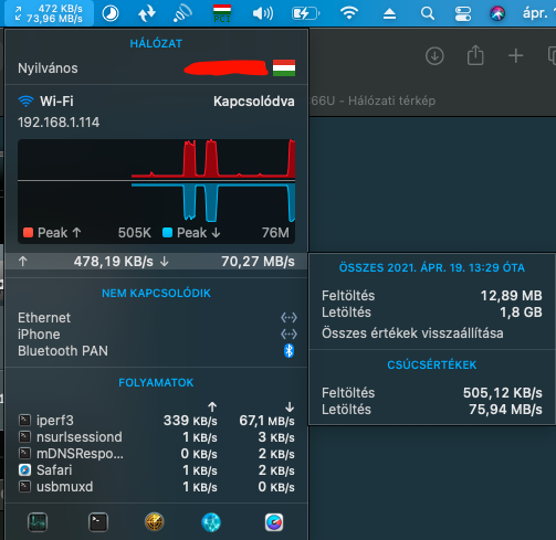

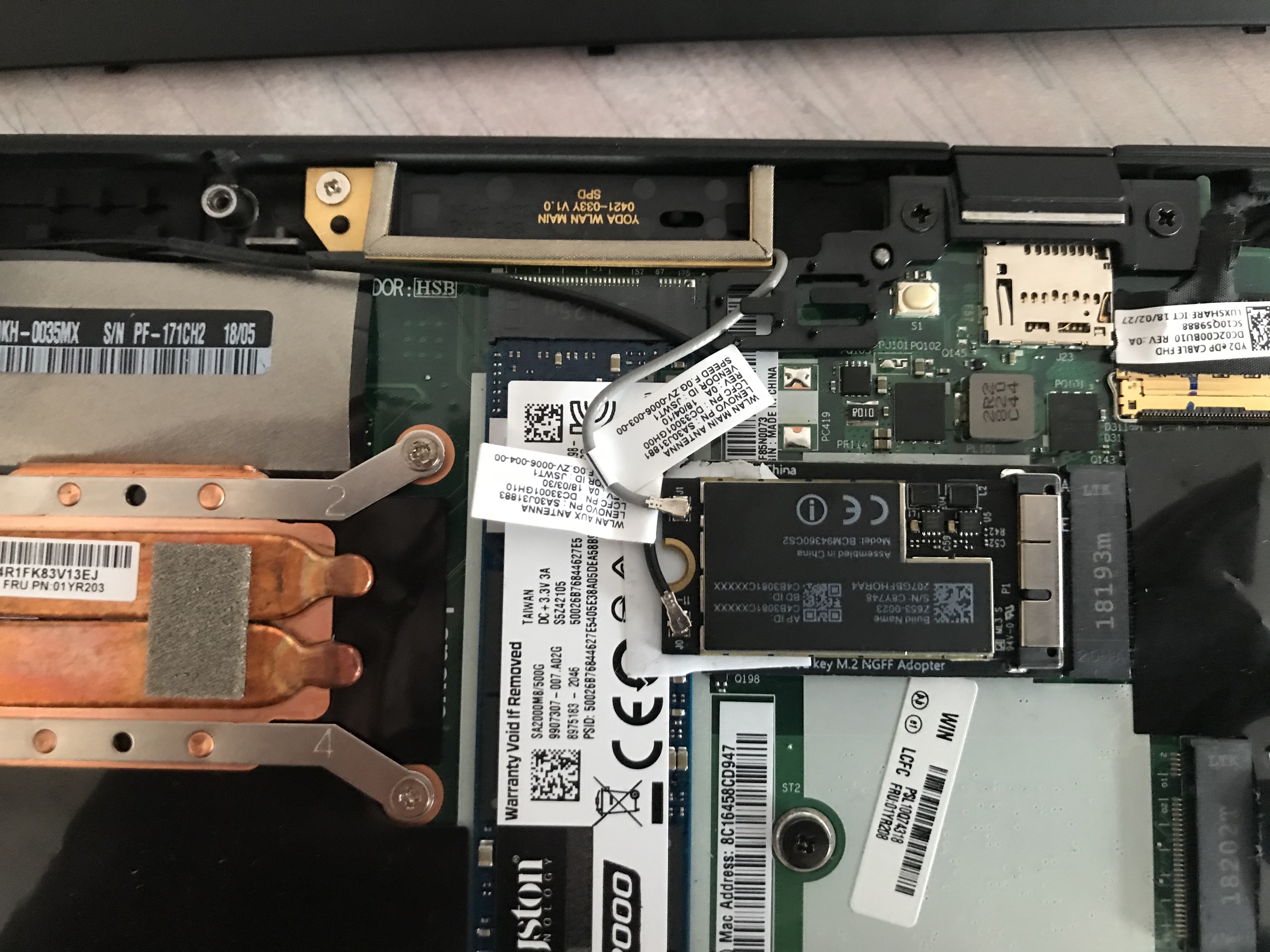

Got an original Apple BCM94360CS2 card with an NGFF adapter (same price as the 94360NG), the speed is perfect, working Instant Hotspot, all good! Glad I bought it.
94360NG is a piece of junk.
Just barely fit in the X1 Carbon 6th, because of the size the SSD and the wifi card made contact, so I used 3 layer tape so they won't make contact anymore
iperf3 local speedtest
76 MB/s max Download speed!!!!
On Windows it's about ~60 MB/s but it's jumping between 20-60 MB/s quite often.
Most likely because of the driver is older (2015), so I'll update and see if it changes the speed or not, but I don't really care, it is perfect either way.
EDIT: Yes, it was the driver. After updating to the latest (2016) it went stable ~60 MB/s
