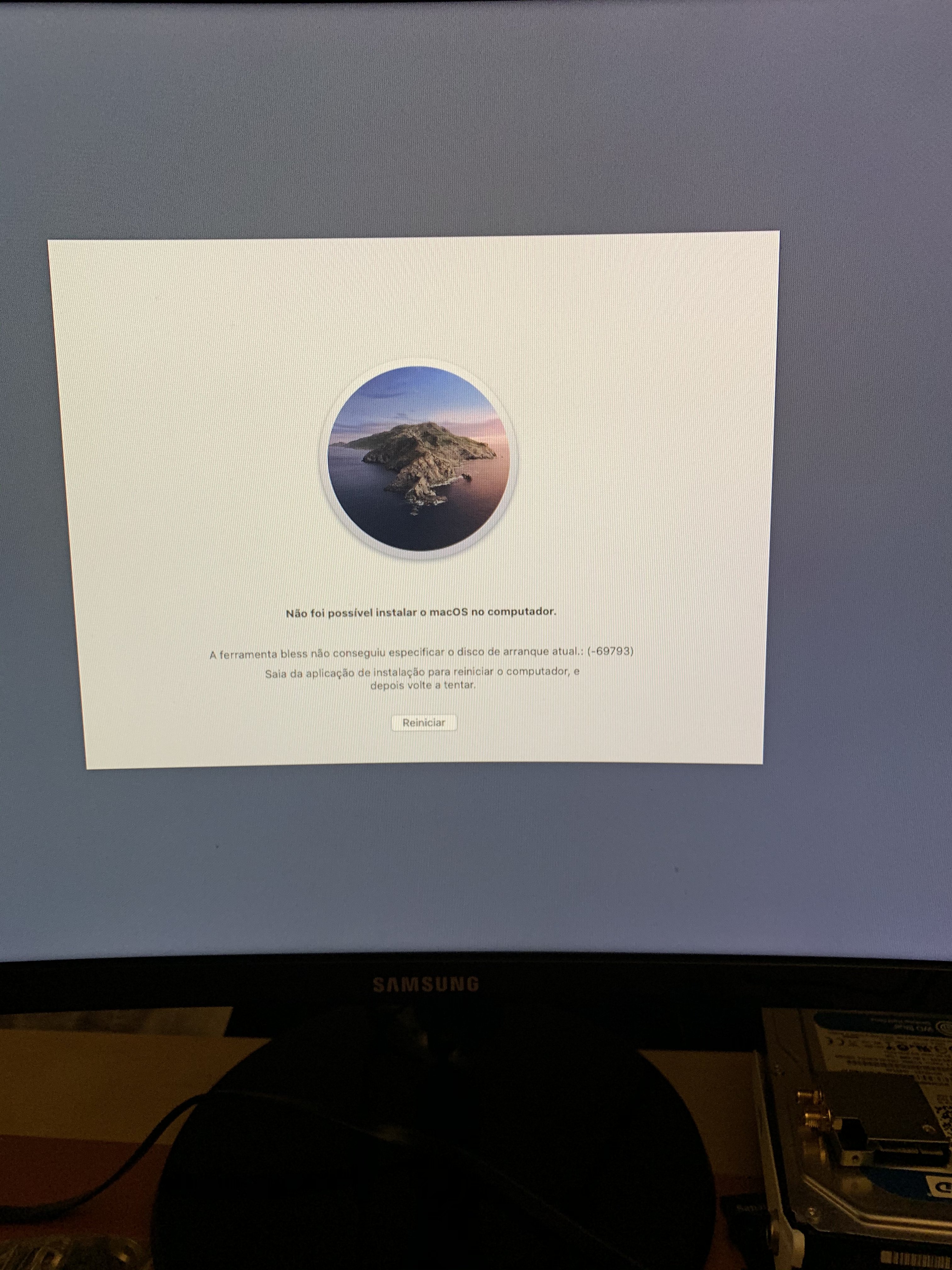

MorenoAv Posted February 19, 2020 Share Posted February 19, 2020 Yep this time the update failed... reboot 2 times and nothing... 1 Link to comment https://www.insanelymac.com/forum/topic/342444-pre-release-macos-catalina-10154/page/2/#findComment-2709056 Share on other sites More sharing options...

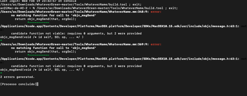

MorenoAv Posted February 19, 2020 Share Posted February 19, 2020 (edited) Hi @Andrey1970, Thanks for the tip, I tried to build WEG from master but it gave 2 errors... Edited February 19, 2020 by MorenoAv Link to comment https://www.insanelymac.com/forum/topic/342444-pre-release-macos-catalina-10154/page/2/#findComment-2709081 Share on other sites More sharing options...
mnfesq Posted February 20, 2020 Share Posted February 20, 2020 (edited) 3 hours ago, Andrey1970 said: Try WEG from master. Yeah, that worked. It was not easy to compile it. I had to make a "Lilu.kext" folder with everything in Contents/Resources and there are two aliases where I had to move a folder and a file into Contents/Resources/Headers but then it compiled and made a Debug version of the kext. I'll be looking forward to a release version of 1.3.8 soon. Oh, here, if anyone else needs it: WhateverGreen-1.3.7-DEBUG.zip Edited February 20, 2020 by mnfesq 3 Link to comment https://www.insanelymac.com/forum/topic/342444-pre-release-macos-catalina-10154/page/2/#findComment-2709086 Share on other sites More sharing options...

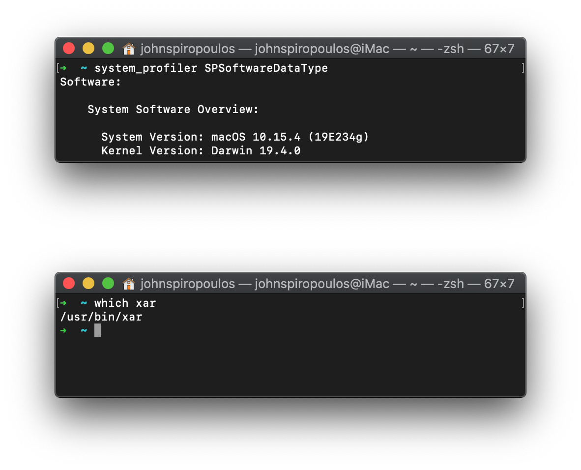

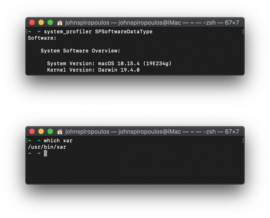

WizeMan Posted February 20, 2020 Share Posted February 20, 2020 (edited) By the way for us Xcode devs who had issues archiving builds with 10.15.4 b1, I can happily report that /usr/bin/xar is back on 10.15.4 b2 Edited February 20, 2020 by WizeMan Link to comment https://www.insanelymac.com/forum/topic/342444-pre-release-macos-catalina-10154/page/2/#findComment-2709111 Share on other sites More sharing options...
ricktm Posted February 20, 2020 Share Posted February 20, 2020 22 hours ago, MorenoAv said: Yep this time the update failed... reboot 2 times and nothing... any luck on this? im having the same issue, no installer at reboot. weg has been compiled, lilu, clover & kexts are the latest Link to comment https://www.insanelymac.com/forum/topic/342444-pre-release-macos-catalina-10154/page/2/#findComment-2709215 Share on other sites More sharing options...
MorenoAv Posted February 20, 2020 Share Posted February 20, 2020 Hi @ricktm, No luck yet, I have used the WEG from @mnfesq but it didn't work... I have the latest kexts also. Link to comment https://www.insanelymac.com/forum/topic/342444-pre-release-macos-catalina-10154/page/2/#findComment-2709218 Share on other sites More sharing options...
Pavo Posted February 20, 2020 Share Posted February 20, 2020 I don't use WEG at all and updated without issues, though I also only have macOS installed and no other OS. Link to comment https://www.insanelymac.com/forum/topic/342444-pre-release-macos-catalina-10154/page/2/#findComment-2709221 Share on other sites More sharing options...
mnfesq Posted February 20, 2020 Share Posted February 20, 2020 1 hour ago, MorenoAv said: Hi @ricktm, No luck yet, I have used the WEG from @mnfesq but it didn't work... I have the latest kexts also. Your issue is different from mine. I was able to get to the first stage of update installation but, upon reboot to get to the second stage, I had repeating errors regarding IGPU. You don't seem to be able to create the preboot installer. I ran into that issue before learning about the WEG problem when I attempted to reinstall the update from my recovery partition. I suggest that you use one of the update scripts available here to download the update and you may possibly need to put it onto a flash drive or other location to be sure it shows up in Clover. Once you get the update to begin, you may still run into the WEG problem I encountered but take it one problem at a time. Link to comment https://www.insanelymac.com/forum/topic/342444-pre-release-macos-catalina-10154/page/2/#findComment-2709224 Share on other sites More sharing options...

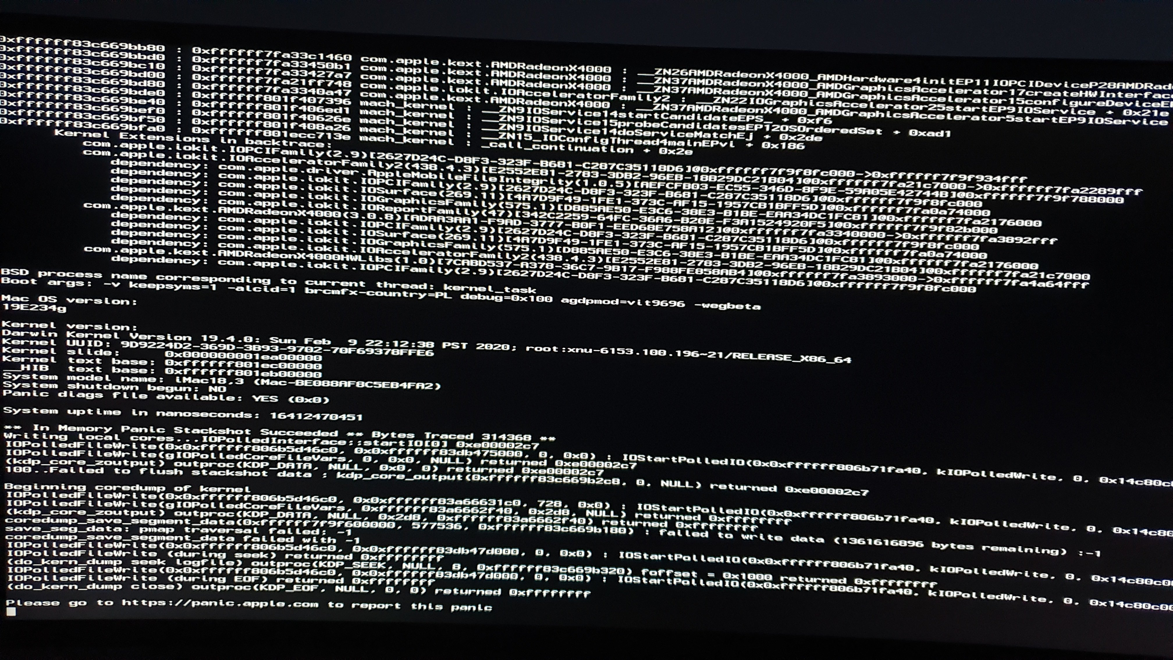

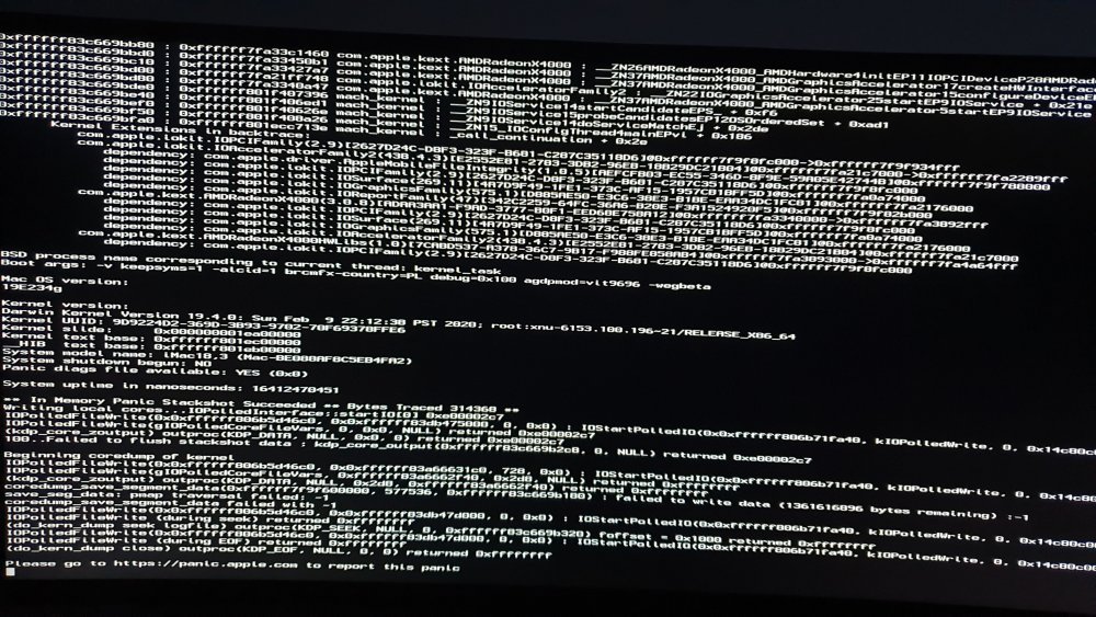

Rymek Posted February 20, 2020 Share Posted February 20, 2020 (edited) Getting kernel panics from AMDRadeonX4000 kext after update. Tried using the WhateverGreen posted here but no luck. Using RX570 for driving hackintosh, iGPU enabled, but with platform-id disabling driving displays. Everything was fine till last update Any help appreciated Edited February 20, 2020 by Rymek Link to comment https://www.insanelymac.com/forum/topic/342444-pre-release-macos-catalina-10154/page/2/#findComment-2709225 Share on other sites More sharing options...
ricktm Posted February 20, 2020 Share Posted February 20, 2020 1 hour ago, MorenoAv said: Hi @ricktm, No luck yet, I have used the WEG from @mnfesq but it didn't work... I have the latest kexts also. Interesting. If I was to guess, our issue may be that the installer isn't able to create the drive necessary for installation. When I try to run the update it does seem to end early before the shutdown & bootup. Does the progress bar complete when you start the upgrade from system preferences? Link to comment https://www.insanelymac.com/forum/topic/342444-pre-release-macos-catalina-10154/page/2/#findComment-2709229 Share on other sites More sharing options...
MorenoAv Posted February 20, 2020 Share Posted February 20, 2020 (edited) Thanks @mnfesq, I'll try that or re install the macOS... No @ricktm the update ends before the shutdown. After the reboot it boots directly to the OS... Edited February 20, 2020 by MorenoAv Link to comment https://www.insanelymac.com/forum/topic/342444-pre-release-macos-catalina-10154/page/2/#findComment-2709230 Share on other sites More sharing options...

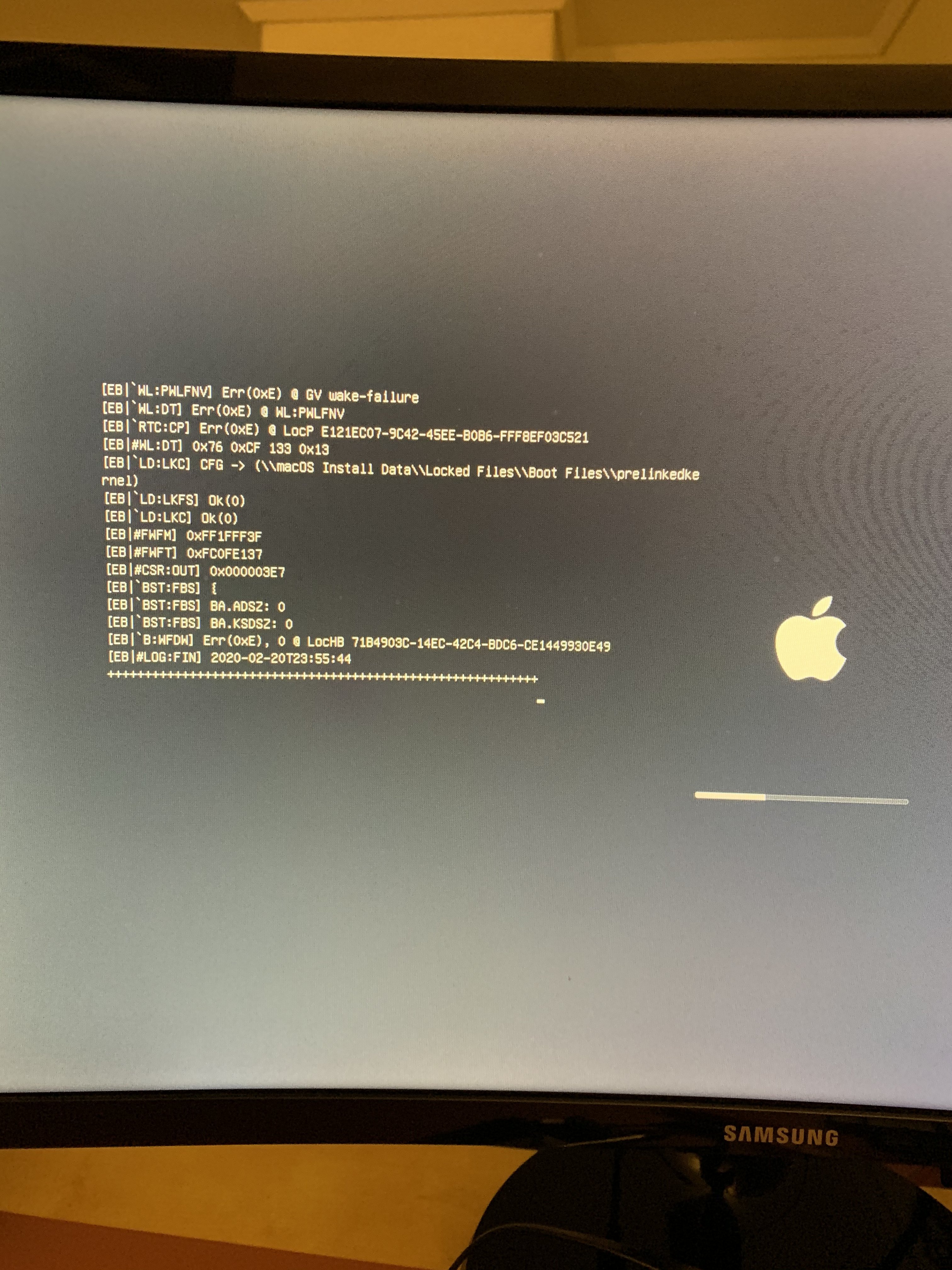

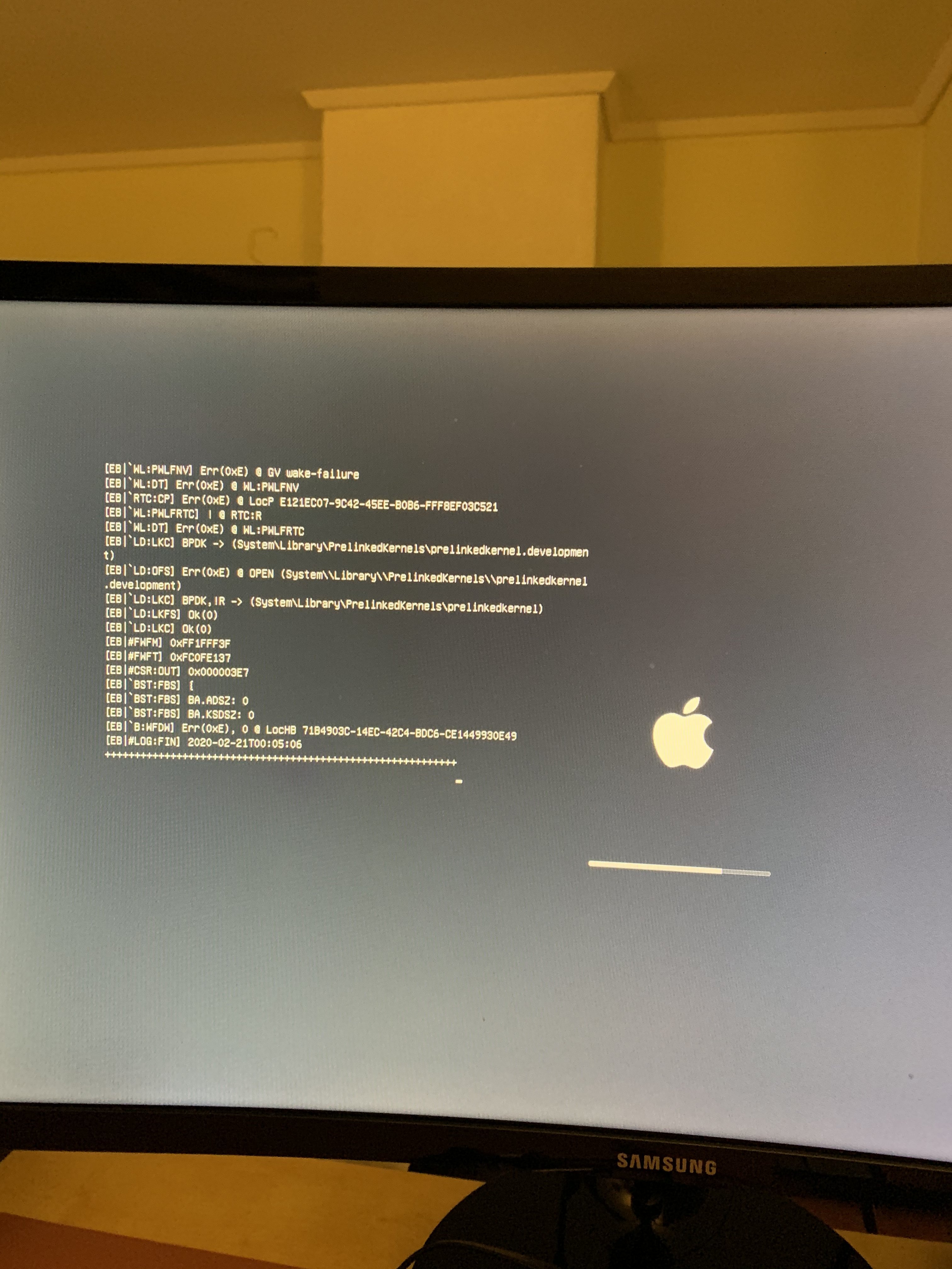

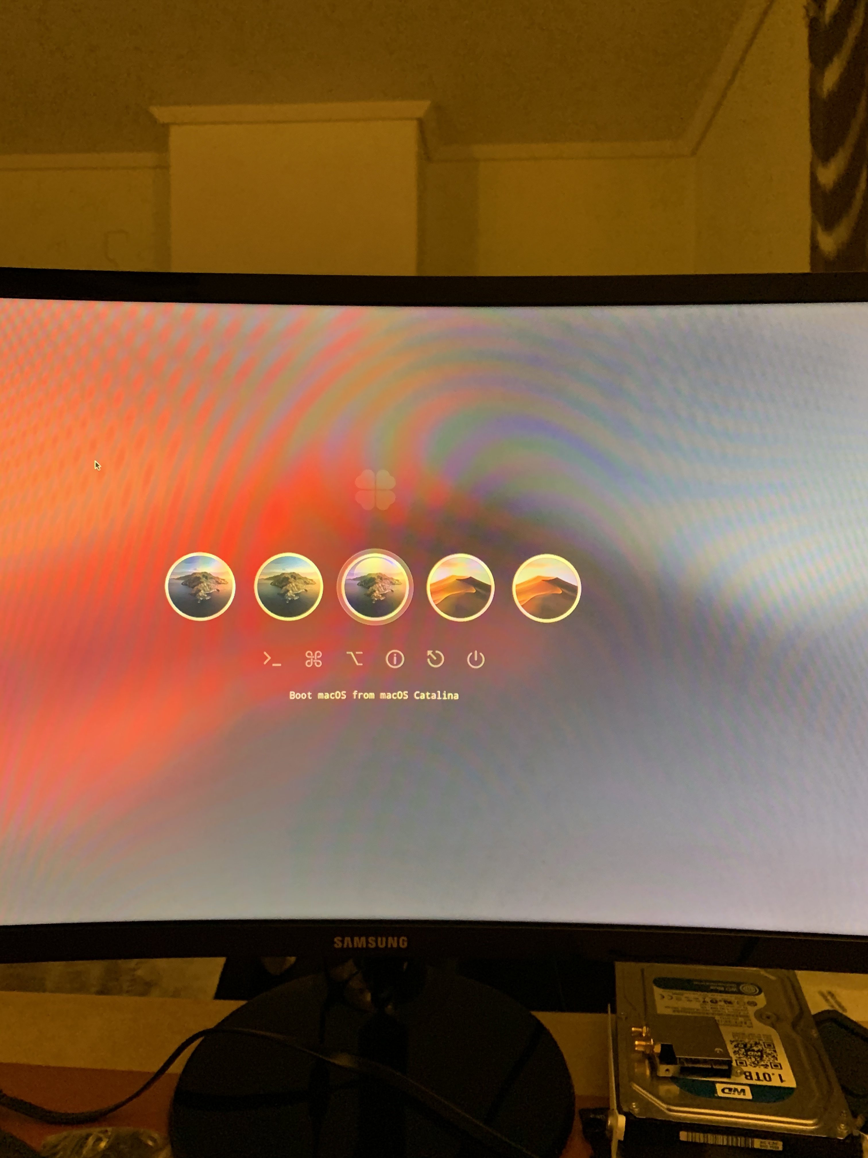

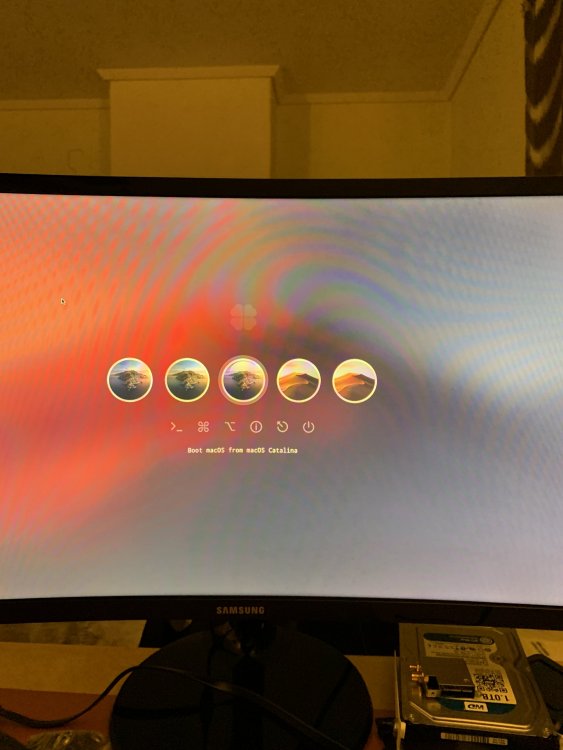

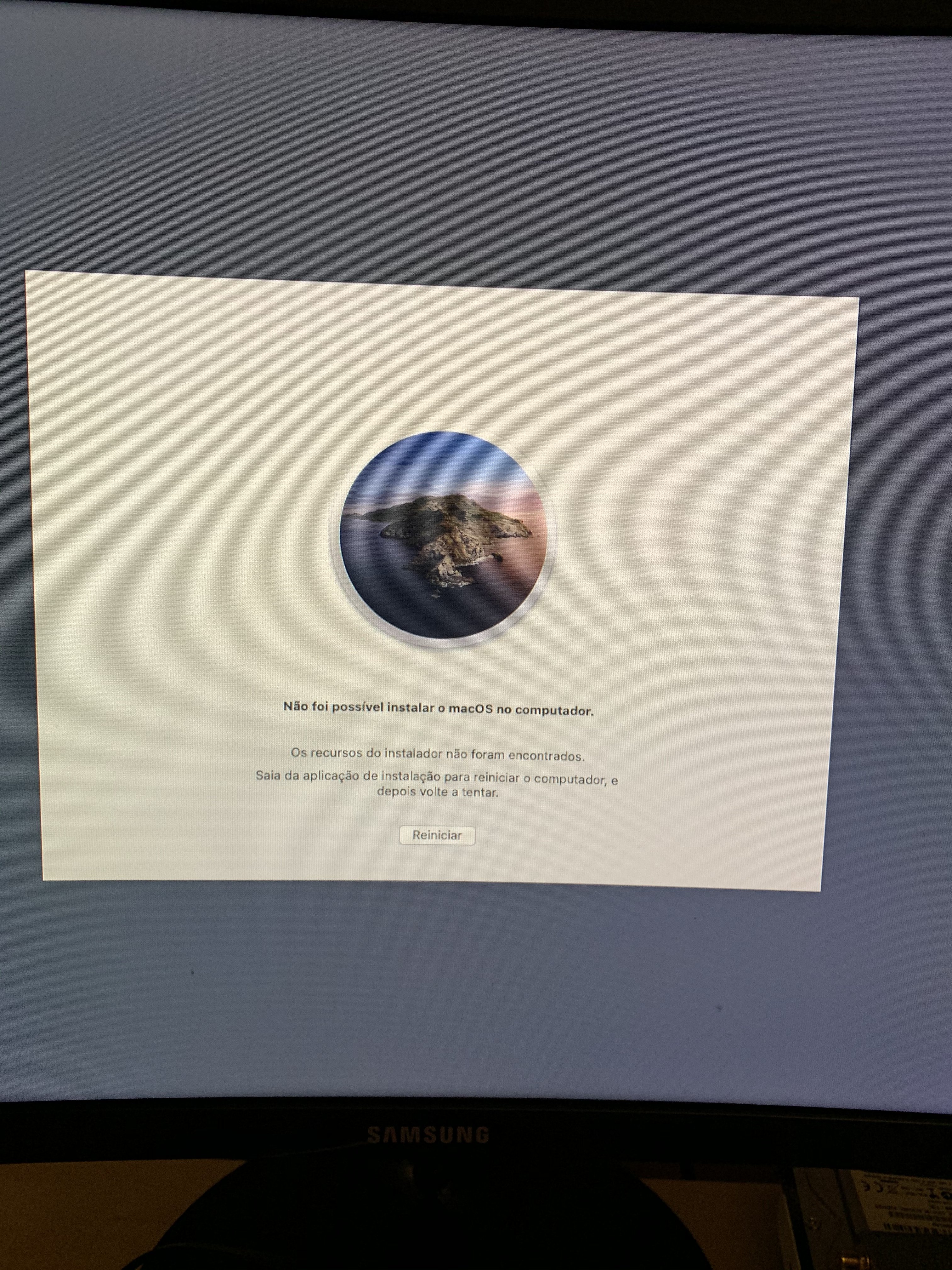

MorenoAv Posted February 20, 2020 Share Posted February 20, 2020 (edited) I'm back after re install macOS Catalina, but now my script for changing the apple catalog stopped working. Anyone has one script that works? Thanks in Advance PS. Solved found an apple developer profile, after that I re download macOS Catalina and this time I have installer but returned the text at boot and the update didn't work... see pictures at bottom... Edited February 21, 2020 by MorenoAv Link to comment https://www.insanelymac.com/forum/topic/342444-pre-release-macos-catalina-10154/page/2/#findComment-2709239 Share on other sites More sharing options...
