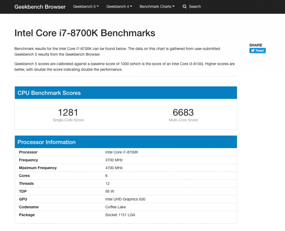

hey guys, thank you once again for the great Tutorial and the EFi Files. I have a similar setup, however when doing my Benchmarks I do not get over a multicore score higher than 6600. Others with an i7 processor seem to get a much higher result (check out this setup: https://www.tonymacx86.com/threads/success-pynty-mac-i7-8700-z390-i-aorus-pro-wifi-16gb-ram-sapphire-rx-580-mojave-10-14-3.271145/ which is almost the same). generally my Hackintosh feels laggy.
Any advice for what could be the reason?
Specs of my Setup:
-Saphire radeon RX580
- 2 x 16GB G Skill Trident Z Ram DDr 4 at 3200 MHz (32 Gb total)
- Samsung SSD 970 EVO Plus 1TB installed as NVMExpress
- Aorus Z390 Pro
- Intel Core I7-8700
- Corsair H60 cooler
Any advice would be greatly appreciated.
Thank you
Simon

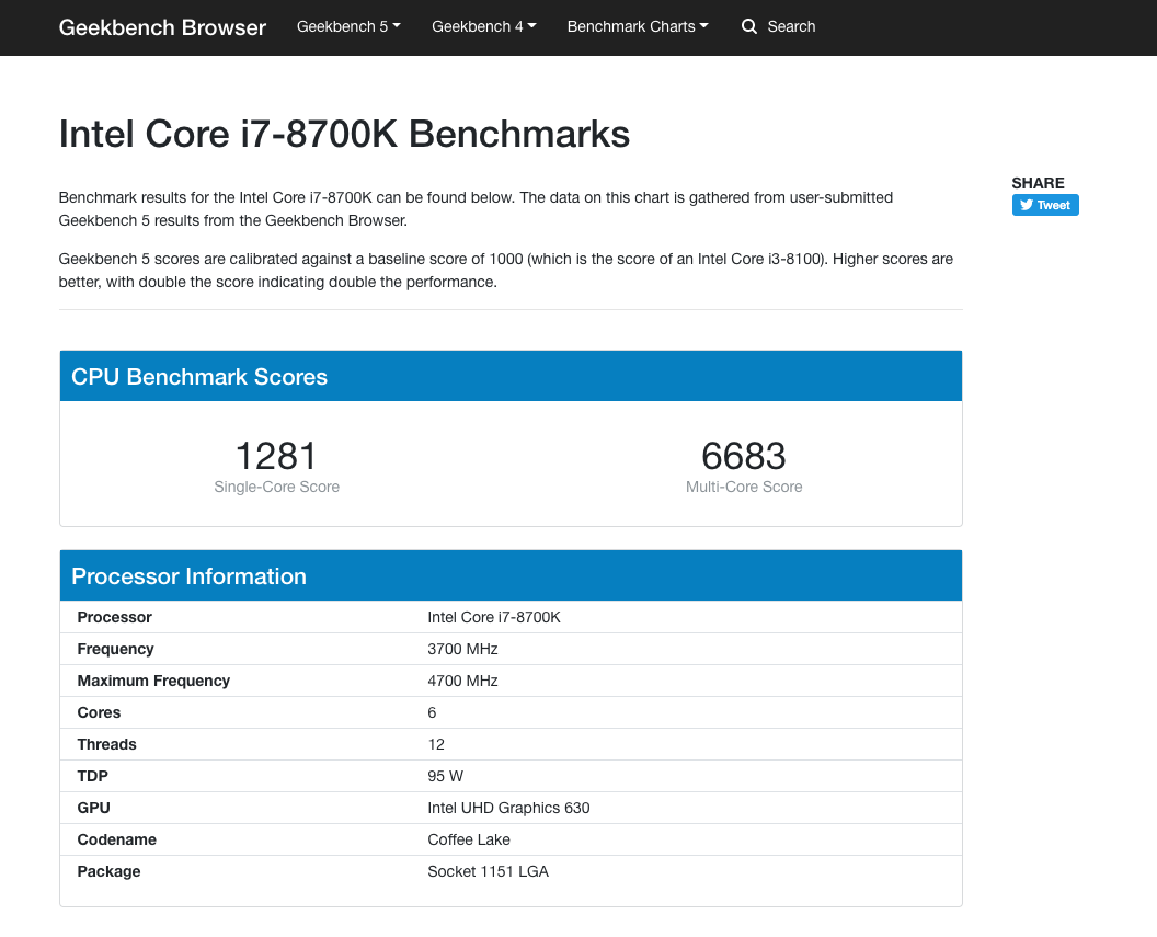

EDIt 1_ just tested it again with the Mac Pro 1.1. EFI:
Score is the same (see screenshot).
You are using Geekbench v 5.0 with new scores formula. Therefore, this is perfectly NORMAL. 100% fine. THey changed everything with the new version...
8700K gets around 1100-1200 and 9900K with default clock and voltage will get around 1350-1400 geek score 5.0
