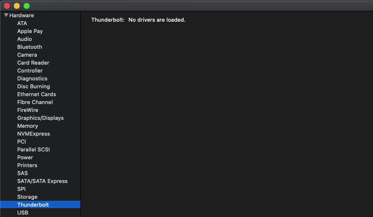

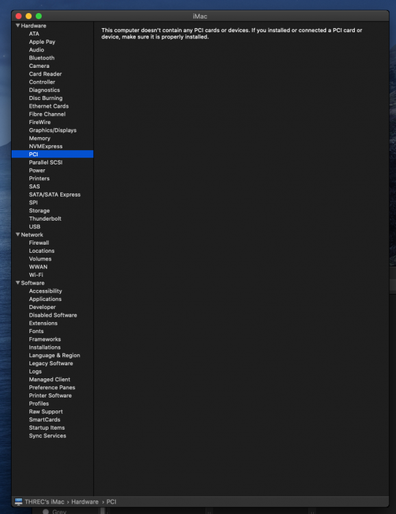

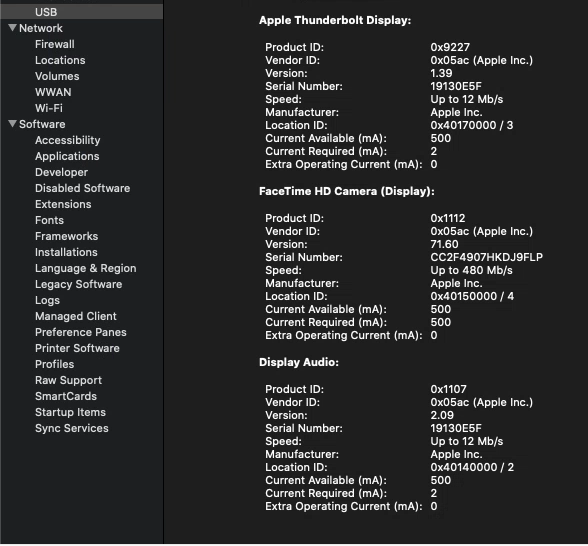

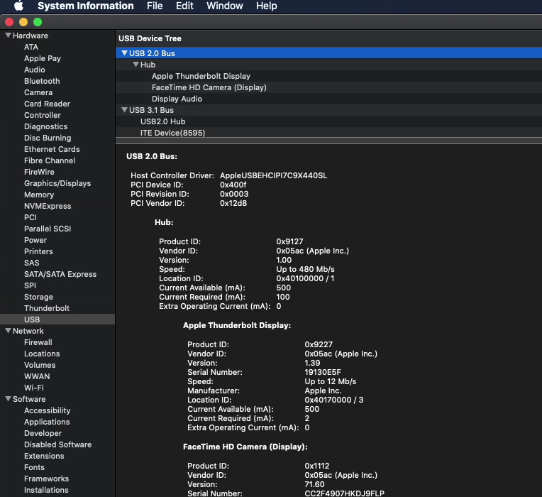

anubious Posted November 15, 2019 Share Posted November 15, 2019 (edited) Hey there. I used your EFI and Im happy to say that im up and running. I'm trying to get thunderbolt to work correctly at this time. My Thunderbolt monitor worked with no issues, but I was only able to get the camera, speakers, etc. working only once and I have no idea what I did. Is there something that I need to do in order to get thunderbolt working correctly (alpine ridge)? My specs if that helps: MB: Aorus z390 Pro (non wifi) CPU: Core i9 9900k (seems common around here #RichNerds) Memory: 32GB 3Ghz Wifi: I forget... Its fenvi though and its working with no issues GPU: Gigabyte Vega 64 (working with no issue with your EFI on page 1) Thunderbolt: Gigabyte Alpine Ridge Rev. 2 (Monitor has worked from the beginning with no issue and the ports on this monitor appear at first as USB 2.0 hub with nothing populated. I left for work and everything became visible (and usable) See screenshots. I have rebooted and cannot get the device recognized again. The hub is recognized but never populates. If I leave it alone, the devices may become recognized over time... who knows.) Monitor: Apple Cinema 27" Monitor (Thunderbolt) (...SEE ABOVE) Beer: Goose Island IPA (90 Minute) Edited November 15, 2019 by anubious added images Link to comment Share on other sites More sharing options...

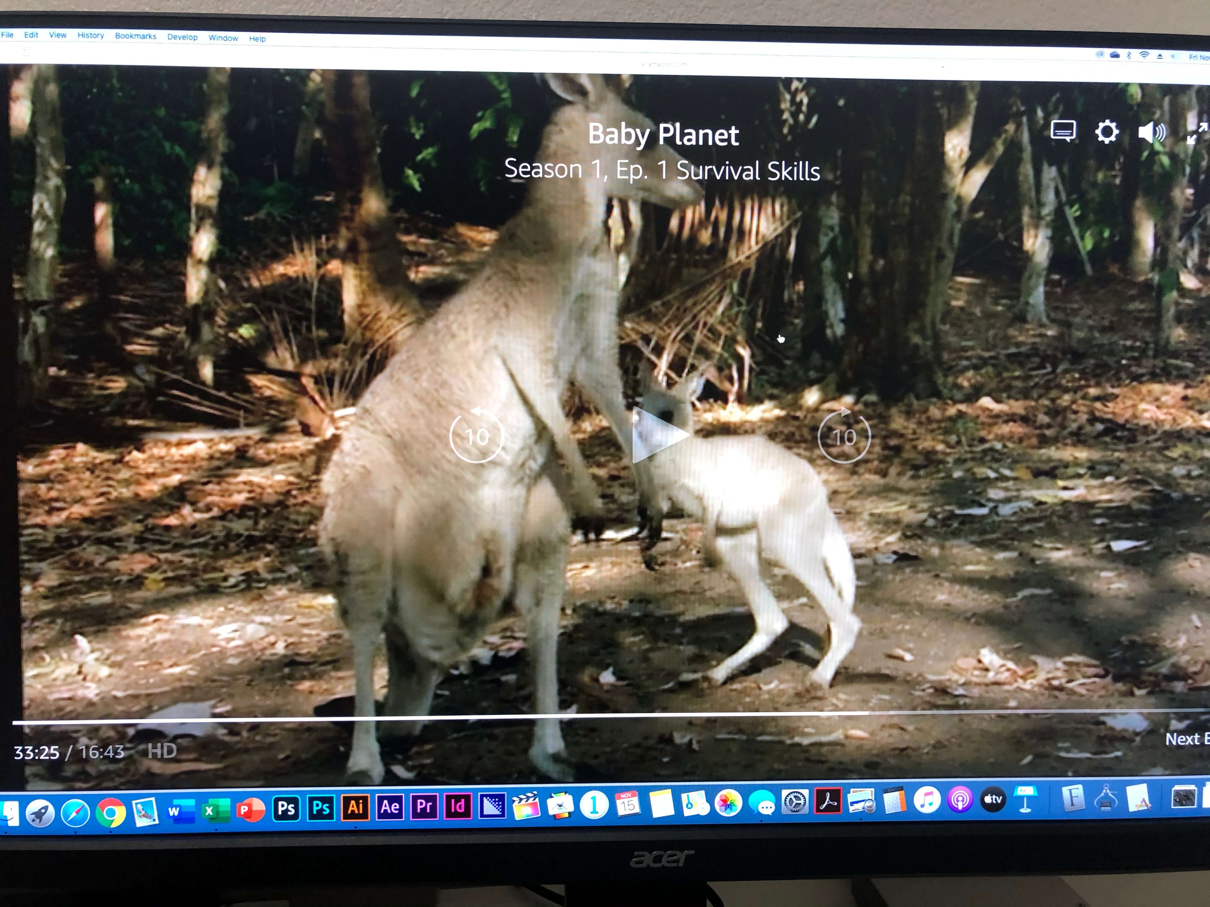

larabee Posted November 15, 2019 Share Posted November 15, 2019 2 minutes ago, tasc said: Just landed on amazon prime video page in safari, and it locked up the computer as well (just like netflix). @larabee are you on iMacPro1,1 and not having this issue? I'm on latest EFI and iMacPro smbios with iGPU disabled. I don't have any issue any all with SMBIOS iMac Pro 1,1 and iGPU disabled. Here is Amazon Prime video playing just fine. 1 Link to comment Share on other sites More sharing options...

larabee Posted November 15, 2019 Share Posted November 15, 2019 (edited) 4 hours ago, anubious said: Hey there. I used your EFI and Im happy to say that im up and running. I'm trying to get thunderbolt to work correctly at this time. My Thunderbolt monitor worked with no issues, but I was only able to get the camera, speakers, etc. working only once and I have no idea what I did. Is there something that I need to do in order to get thunderbolt working correctly (alpine ridge)? Did you tried turn off Thunderbolt force power to see how it works? Install windows and get the card to work on windows first before trying it in hackintosh. @tasc It's your RX560 that's causing issue Edited November 16, 2019 by larabee Link to comment Share on other sites More sharing options...
