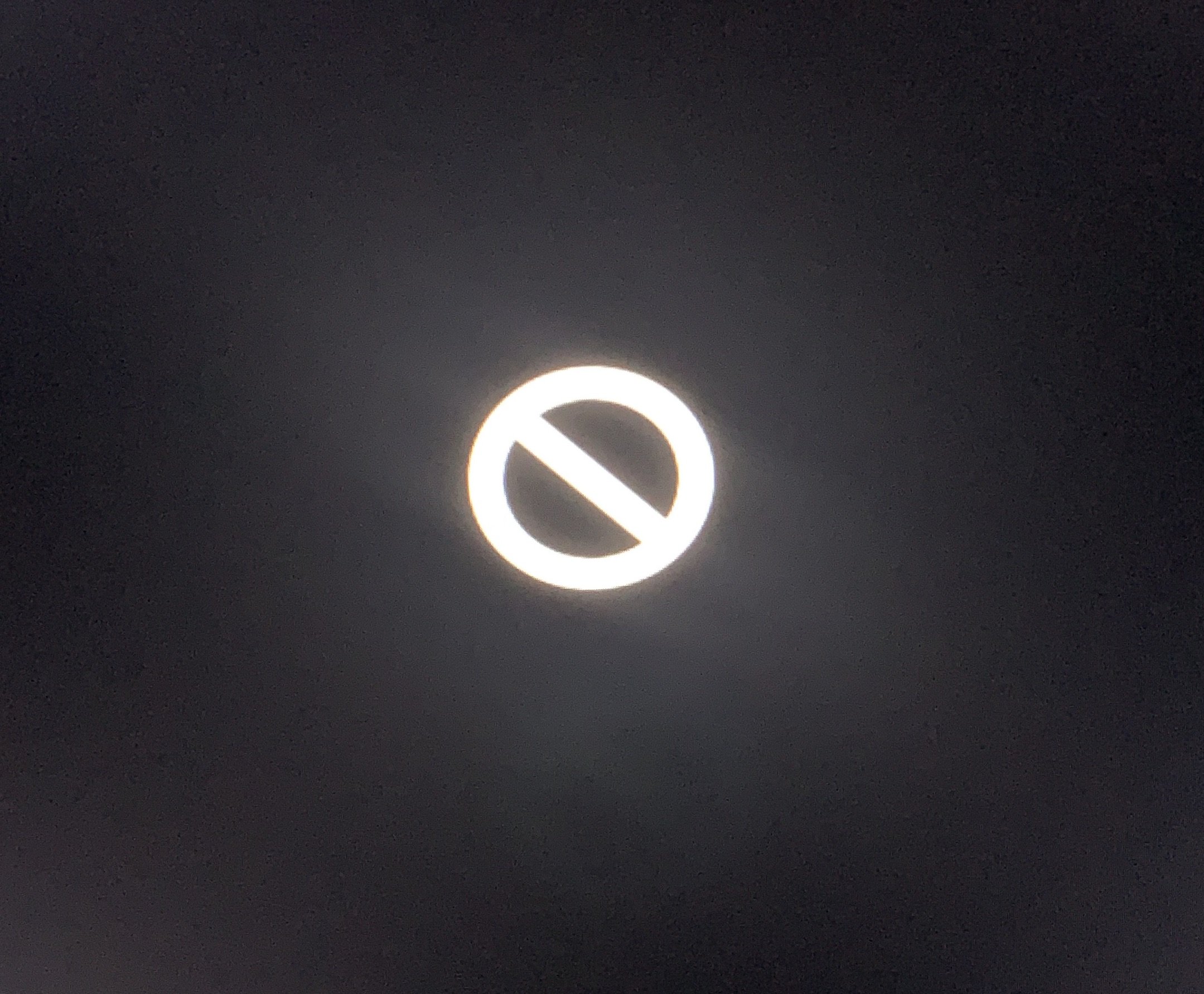

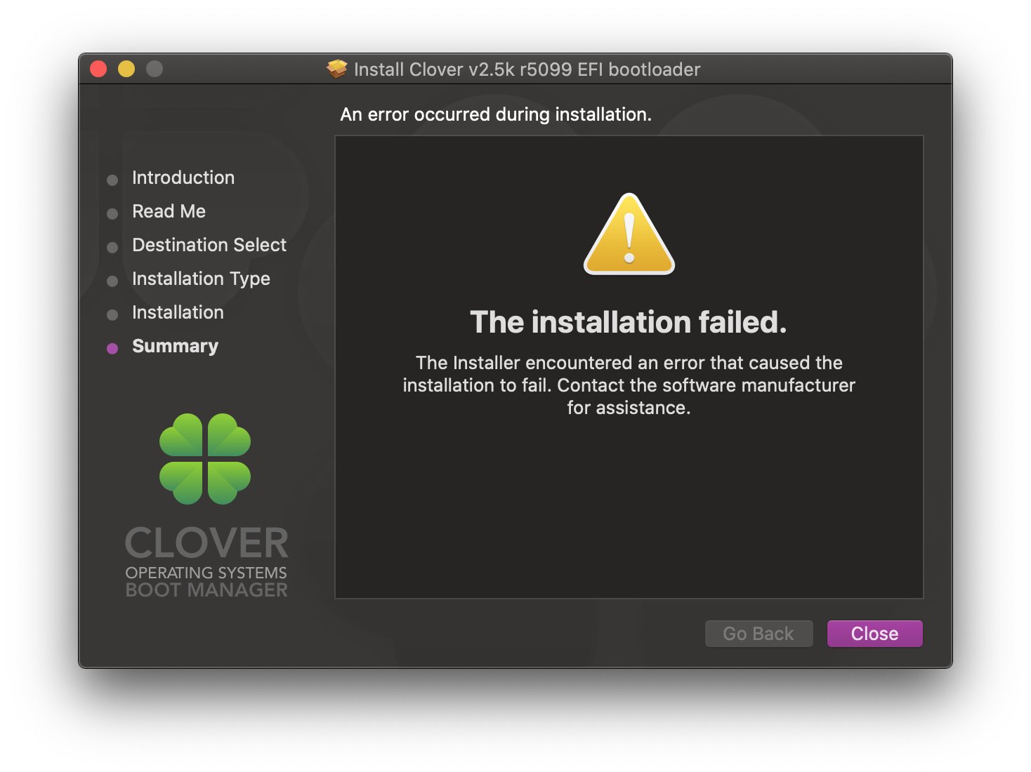

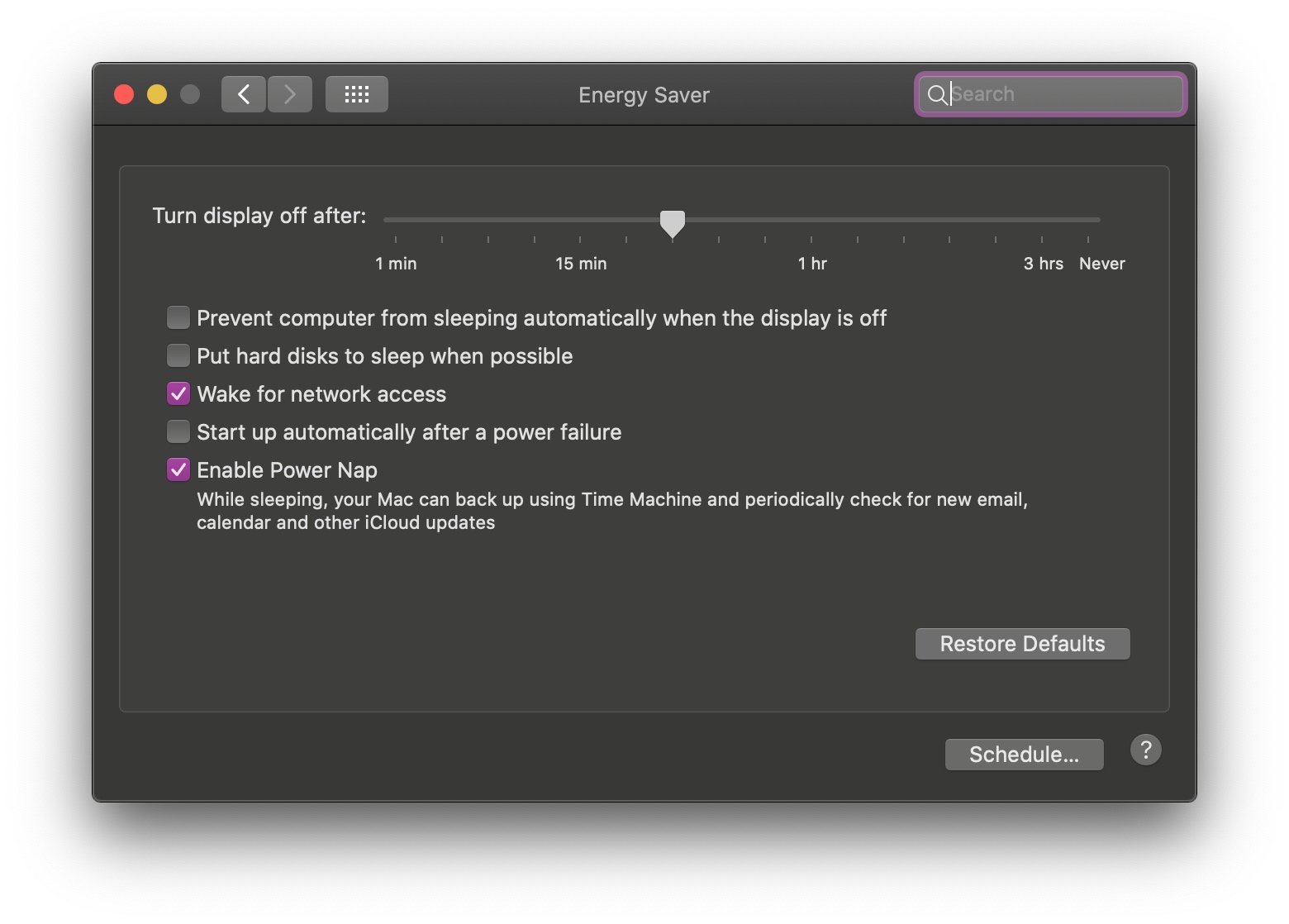

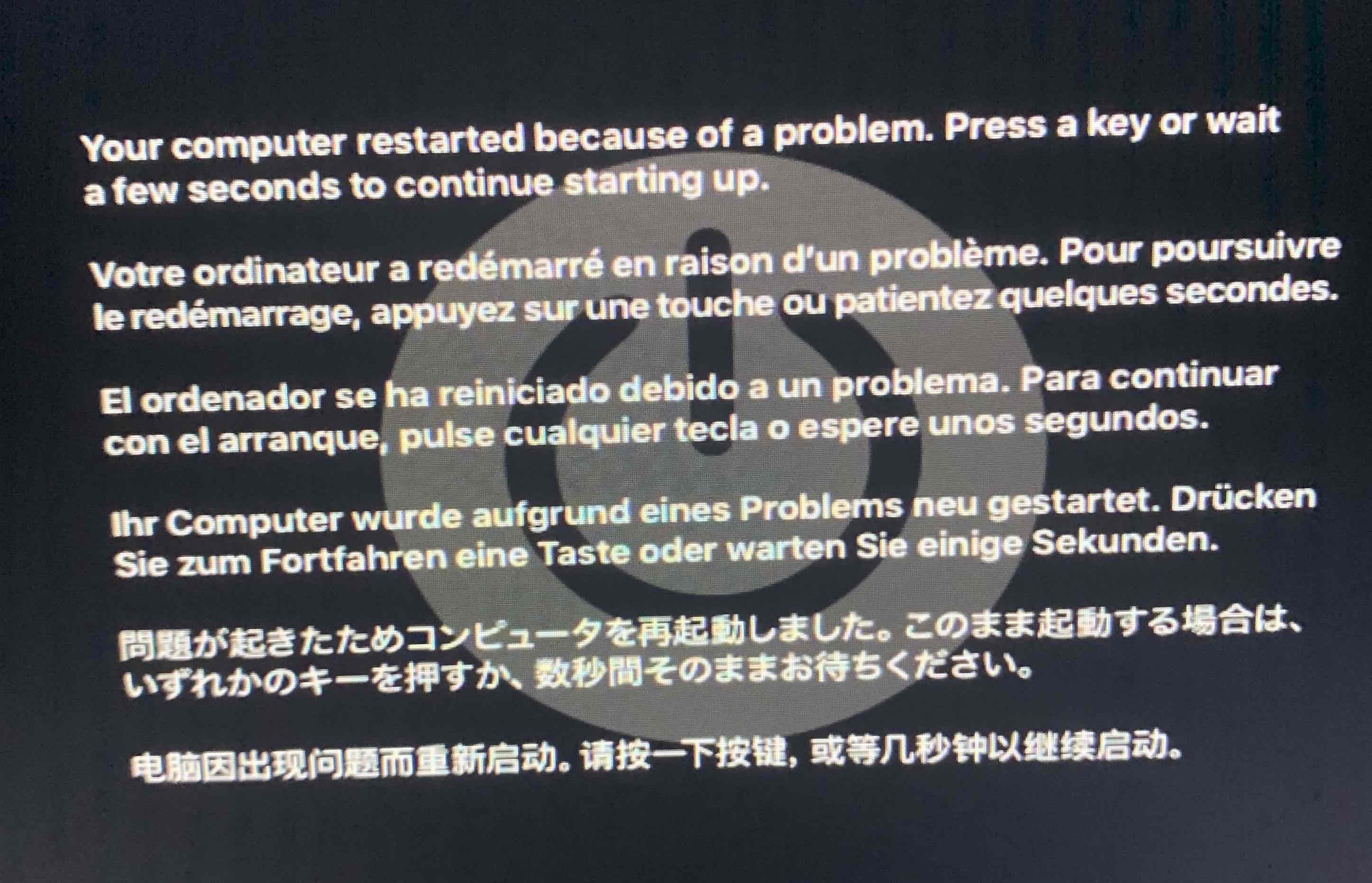

Can anybody help me with some issue please?
I have the almost the same build as author. My GPU is different (RX 5700XT Nitro+) and maybe my PCI-E WiFi/Bt card is different because it does not have works properly for me with this below kexts:
 - AirportBrcmFixup.kext
 - BrcmBluetoothInjector.kext
 - BrcmPatchRAM3.kext
After deleting all this kexts my WiFi/Bt card works natively.
1st problem is when I start PC. I have the "STOP" sign ("first_boot_issue_" screenshot) on the display instead Apple Logo and after reset button OS works as normal. I don't Understand what's I'm do wrong.
2nd problem is have an error when try to Clover update ("clover_update_issue_" screenshot). I tried to disable Gatekeeper via Hackintool ("gate_keeper_" screenshot) but error still have in place.
3rd problem come with sleep mode. I have no sleep settings in Energy Saver for PC only for display off time ("sleep_settings_" screenshot). But if I put my OS manually to sleep after wake up have freeze screen and working only mouse via USB connection. After some time it have reboot automatically and I have the error/ info in next OS loading ("after_sleep_" screenshot).
P.S. sorry for my English this is not my first language.
first_boot_issue_
gate_keeper_
after_sleep_
sleep_settings_
UPD
If after sleep run Google Chrome whole system just freezing and waiting some time reboot it self. After reboot have a "Problem Report" window and error-info "after_sleep_" screenshot.
Edited by velopitex

4 hours ago, velopitex said:
Thank you! You save my life!!!
first_boot_issue_
I have the exact same wifi card , I only use AirportBrcmFixup.kext and remove the rest.
About clover update, did you install it to the right drive?
With 5700XT, I still have some problems with sleep
Your english is really good, брат.
Edited by larabee
Yes I chose the right destination for clover updates but still have an error. For now using USB for clover updating and than copy files from USB to EFI.
And i have another issue, my pc turns on automatically after shut down macOS.
P.S. also using the second method with OsxAptioFix2Drv-free2000.efi and iMac19.1 smbios and now in my system i see intel UHD630 igpu.
Thanks, брат.

If you get random kernel panic at boot, that means some nvram doesn't get clear up. You can do a simple restart and it should work. If this continues, try OsxAptioFix2Drv -free2000 with iMac Pro SMBIOS too :)
Thanks, брат.
Are you using the correct DSDT for your GPU?
download thet DSDT (vega navi) from the guide and try again.
also if your going to use OsxAptioFix2Drv-free2000.efi then make sure your using EmuVariableUefi.efi and install clover RC Scripts.
Edited by AudioGod

Yes, using right DSDT (Vega navi) also I have random system reboot, maybe issue with 5700XT Nitro+ now in 10.15.1 idk.

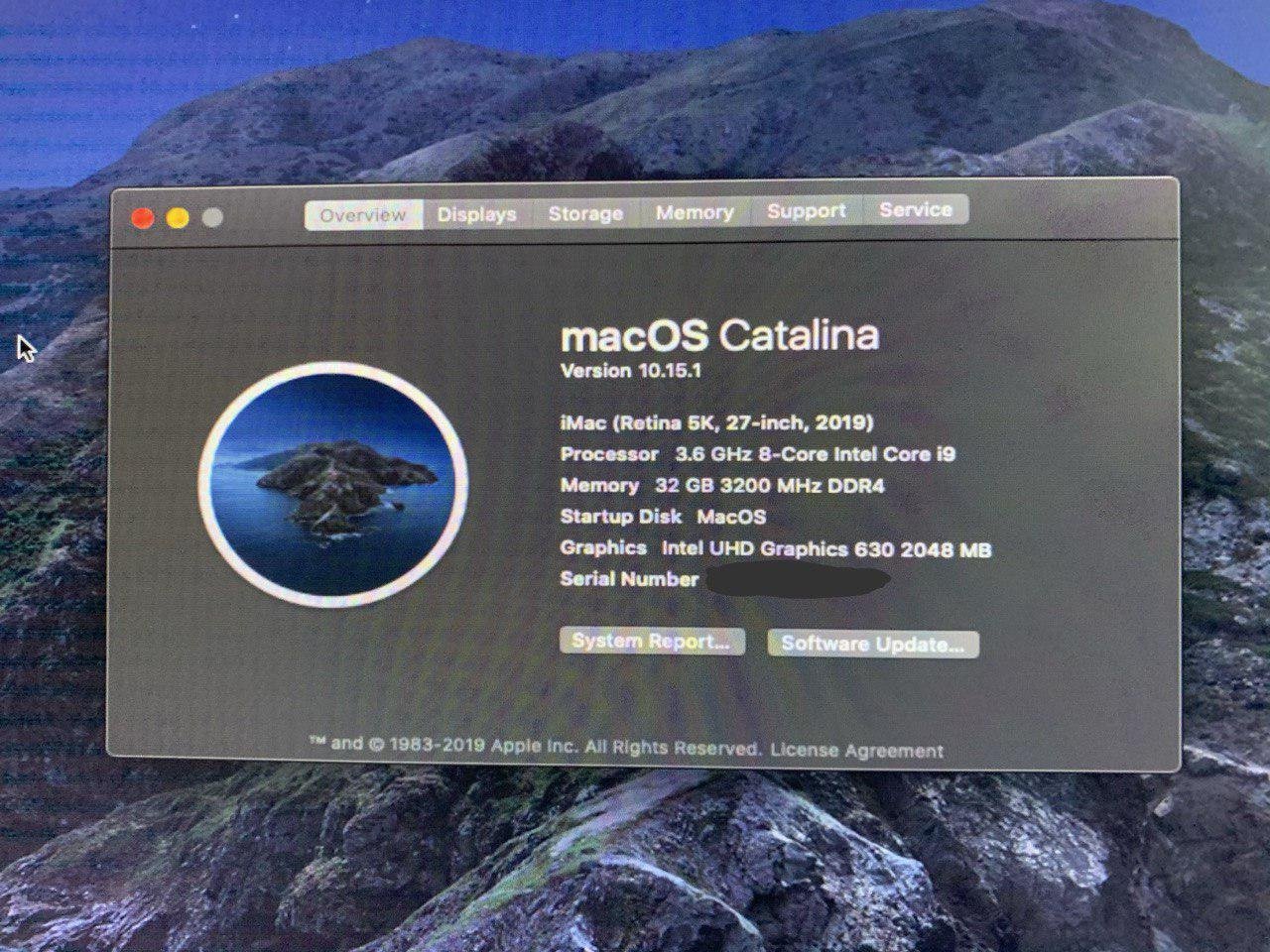

Just to finished clean install with attached EFI and works fine as I see but I have not tested, only sleeps and it works for me (see screenshots please)
EFI Catalina UHD630 (SMBIOS iMac 19.1): http://bit.ly/2KLEPQs
