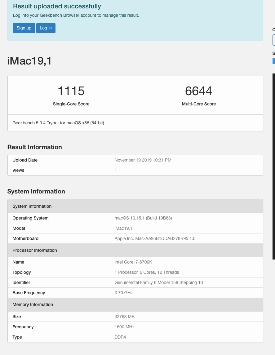

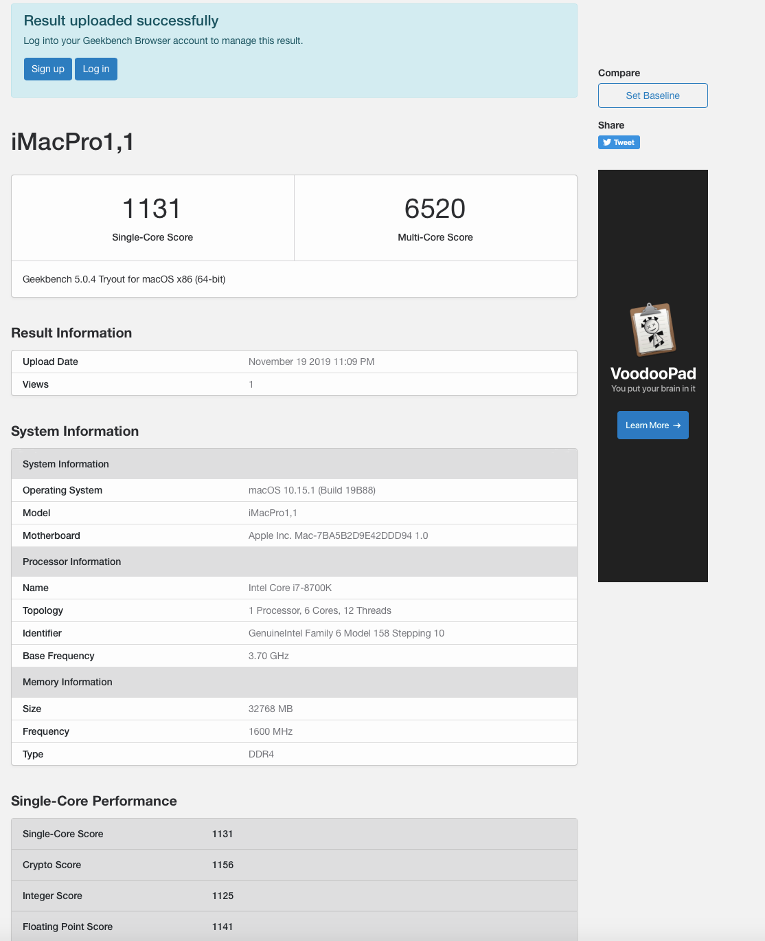

Ive got the dev build of 1.3.5 and il give it a bash on my test bench tomorrow and see if a rx580 and 19,1 with 1.3.5 end DRM Gate for once and for all and il report back for the result.
Edited by AudioGod
21 minutes ago, AudioGod said:
Yes for sure,
That means we have the perfect build once again... :D
36 minutes ago, AudioGod said:
Yes for sure,
Test it with imacPro1,1 - that's where the big problem is as the machine completely freezes and you have to do a hard reboot! At least with 19,1 you get an error message and the machine stays up. I'm sticking with imacPro1,1 for now, performance seems better.

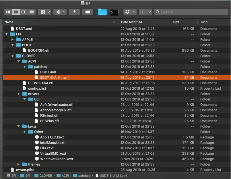

Hello guys, please I need your help,
TLDR THE PLAN IS:
I want to add my 1080GTX as secondary gpu, and use ONLY for WINDOWS (disabling in osx)
So this is my actual situation:
OS: 15.15 (19A602) Mobo: Z390 AORUS PRO (BIOS F10)  I suppose I can stay on F10 if I don't have problem right??
CPU:   I7-9700 K
GFX: MSI Radeon RX Vega 56 Air Boost (on Primary 16X PCI) IGPU: DISABLED
Everything Seems working good (also solved the "sometimes Pink screens" when awaking from sleep) forcing both monitors in RGB mode using the patch-edid.rb (followed this tutorial if can help someone)
NOW THE QUESTIONS:
How Can I add my Nvidia 1080 GTX for using ONLY with WINDOWS partition ?
Can I just add to the secondary (or is better primary) PCI express slot ?
How to DISABLE it in the OSX boot (I mean with some clover config, or some DSDT magic strings :whistle: I'm not good with that stuff :cry:) ??
(I don't want to use bios to disable)
Eventually I'll use some HDMI hardware switch to change input to monitor when switching OS
Please can someone help me?
thank youuu!

I do the same thing. Put your nVidia card in your PCI slot 2, and add this SSDT to your ACPI/patched folder (where the DSDT.aml is). This will prevent the nVidia card from showing up on your macOS side.
SSDT-Z390-Disable-Slot-2-GPU.aml
Wow great that was fast!!
But I already had another SSDT (SSDT-6-A M I.aml) in that folder, is that a problem?
this is my actual EFI folder
thank you!!
thank you!!
No that’s fine, you need ssdt-6-AM for usb
add airportfixup.kext to your kext folder. Streams and gaming will run better with it in
