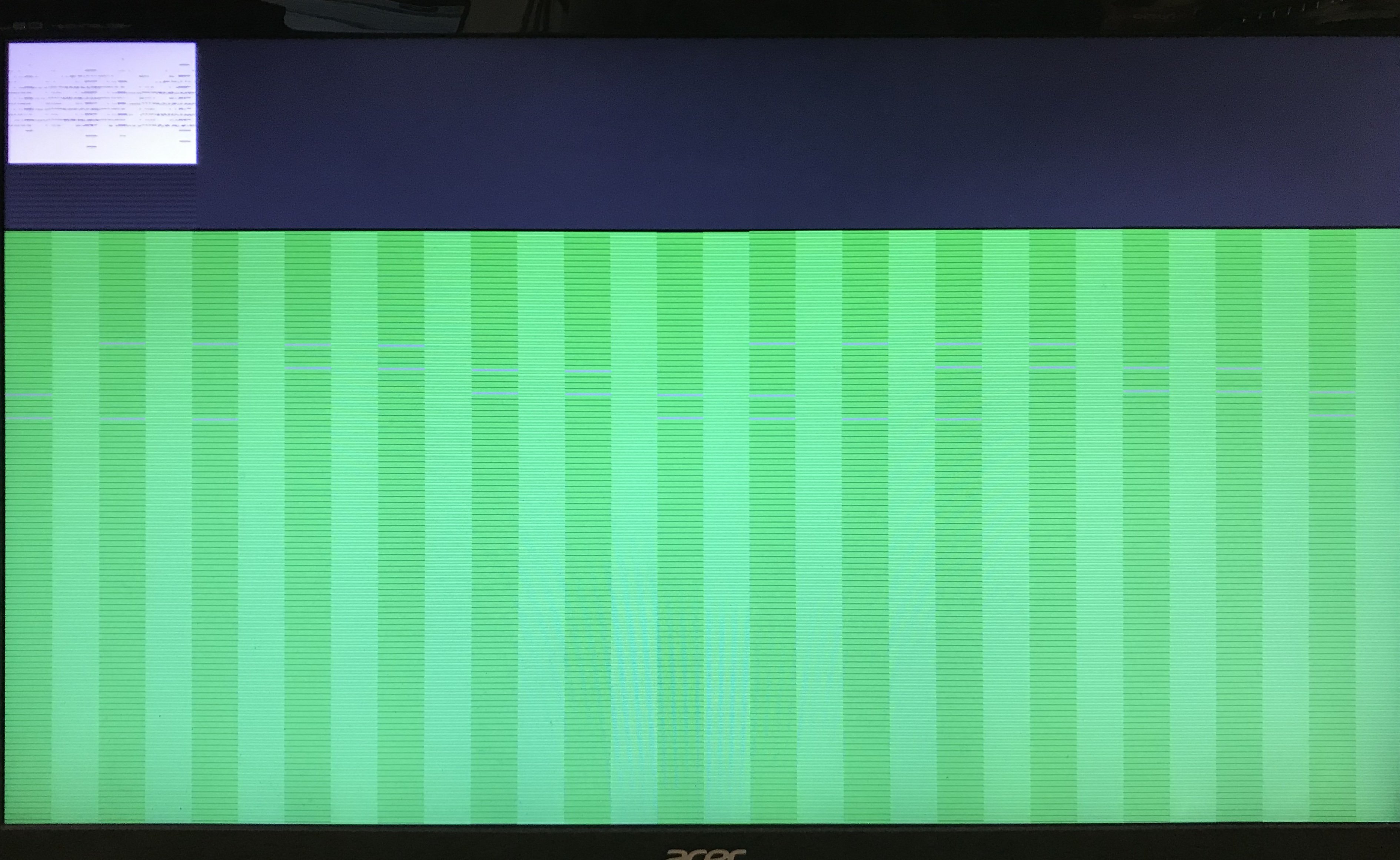

I'm not having a lot of luck with this.
OS: 10.15.1 Catalina
CPU: i7 8700k + Corsair Hydro H150i
board: z390 Aorus Pro (f11 BIOS)
gpu: XFX RX 5700 XT Thicc II 8gb
ram: Corsair Vengeance 32GB (4x8GB) DDR4 3000
I've set all my BIOS settings to those spelled out in this guide, except for BIOS guard which I cannot find in F11.  "Intel Platform Trust Technology" is disabled though.
After running the shell command to create the installer, I've mounted the EFI and pasted the contents of AudioGods Z390 Pro EFI VEGA Navi Radeon VII F11 DSDT.zip.
Booting from the USB shows me the normal Clover boot screen, then I'm able to select the option to install Catalina.  When I select it, I don't get the normal scrolling text.  Everything goes black for several seconds, and then I see the attached image.
This is using a 1080p monitor connected via HDMI.  When I connected to a 4k tv, I got the same behavior except with a lot more of the black space.
I'm pretty novice when it comes to hackintoshing, and right now I'm pretty lost.  Any help would be appreciated.
I have a 5700 XT too and it works with my EFI but it’s not right yet thanks to Catalina so I’m still using a Vega56 for now and will try it again with the next os update.
try this anyway, go into the clover config and remove the agdpmod=pikera and -cdfon boot flags and try again buddy. :)
32 minutes ago, larabee said:
@AudioGod WhateverGreen is still not optimized for it. Do you feel adventurous ? Remove WEG and see if it works :)
I can run my 5700xt with the current WEG kext and it works for me. Not great mind you but it works..lol
i sure don’t get a garbled green screen anyway.

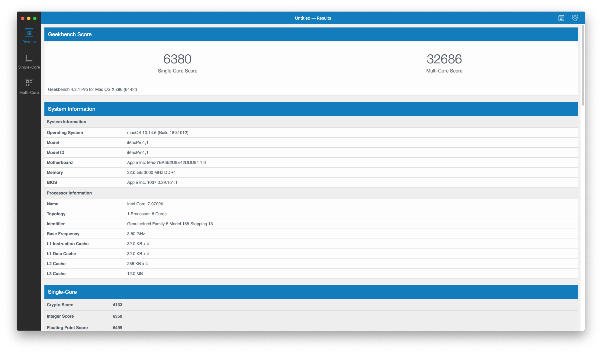

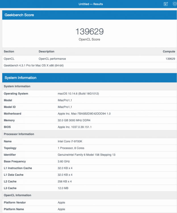

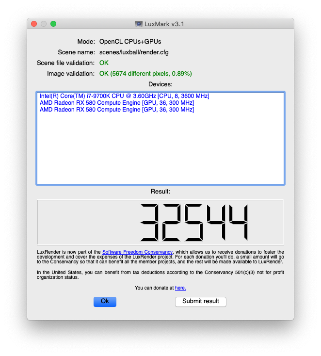

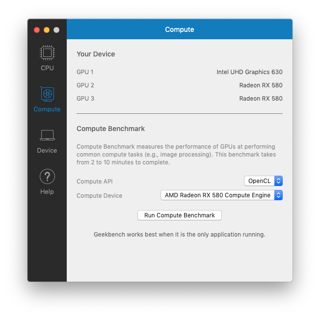

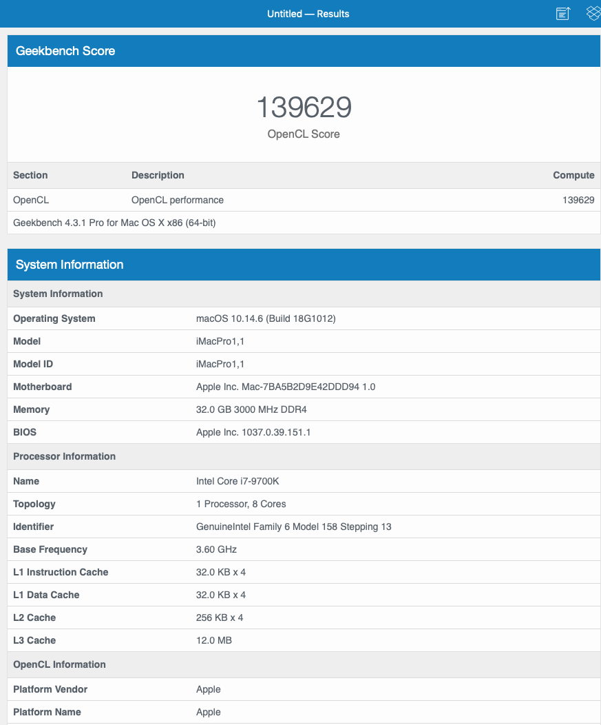

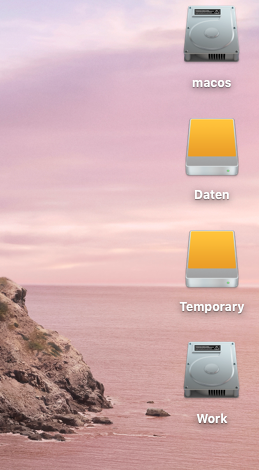

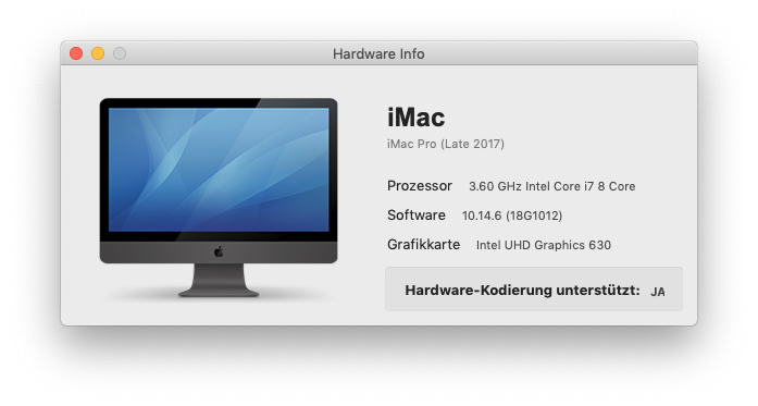

At first many thanks to @AudioGod and all the beautiful minds who made this build possible.
I'm still on Mojave 10.14.6, thus I went with  an older EFI (Z390 Pro DSDT EFI.zip) and BIOS F10 with small changes though.

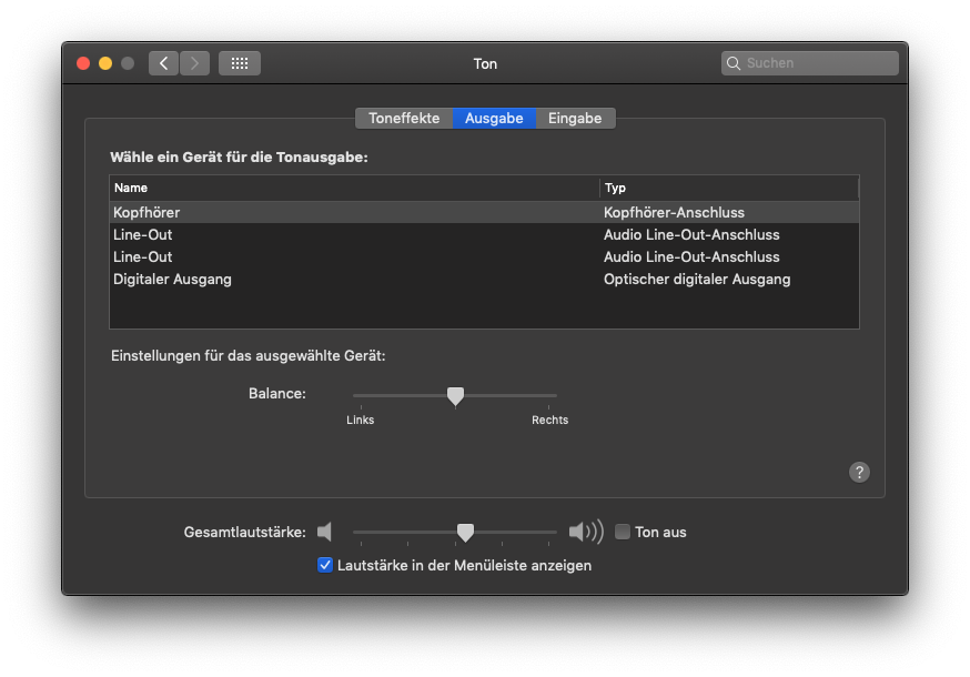

I've had sound distortions with the original EFI thus I've changed the following:
config.plist:
<key>Devices</key>
	<dict>
		<key>Audio</key>
		<dict>
			<key>AFGLowPowerState</key>
			<true/>
			<key>Inject</key>
			<string>11</string>
			<key>ResetHDA</key>
			<true/>
		</dict>
and updated:
- Lilu.kext to 1.3.9
- AppleALC,kext to 1.4.3

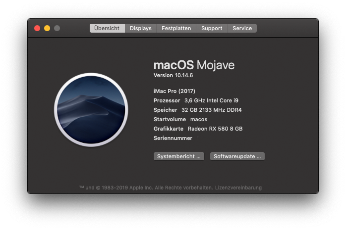

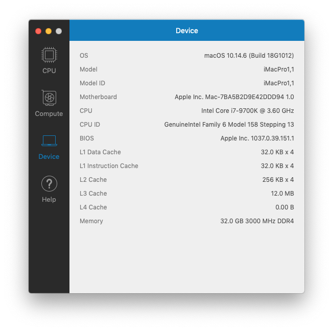

To Do:
- About this Mac showing I9 instead of I7
- Hot-Swap on SATA devices - thanks to @eSaF
Any suggestions how to fix them would be much appreciated.
Again, many thanks for this build.
Edited by noctrl

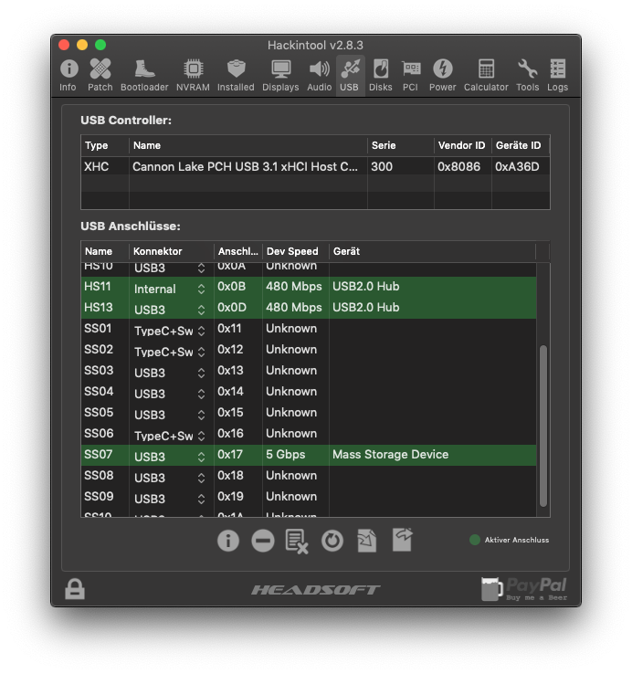

If I remember correctly you need to add this patch to your config.plist also in the BIOS you need to enable 'Hot Swop' for that particular port. Good luck.
Name - com.apple.driver.AppleAHCIPort
Find    - 40600200
Replace - 00000000
Comment - Patch Hotplug
  • Thanks 1
Find    - 40600200
Replace - 00000000
Perfect! Thanks a lot for that one. It works like a charm. Beside that the external icon patch included in the config.plist must be an InfoPlistPatch!
			<dict>
				<key>Comment</key>
				<string>External Icons</string>
				<key>Disabled</key>
				<false/>
				<key>Find</key>
				<string>45787465726E616C</string>
				<key>InfoPlistPatch</key>
				<true/>
				<key>Name</key>
				<string>AppleAHCIPort</string>
				<key>Replace</key>
				<string>496E7465726E616C</string>
			</dict>
Edited by noctrl

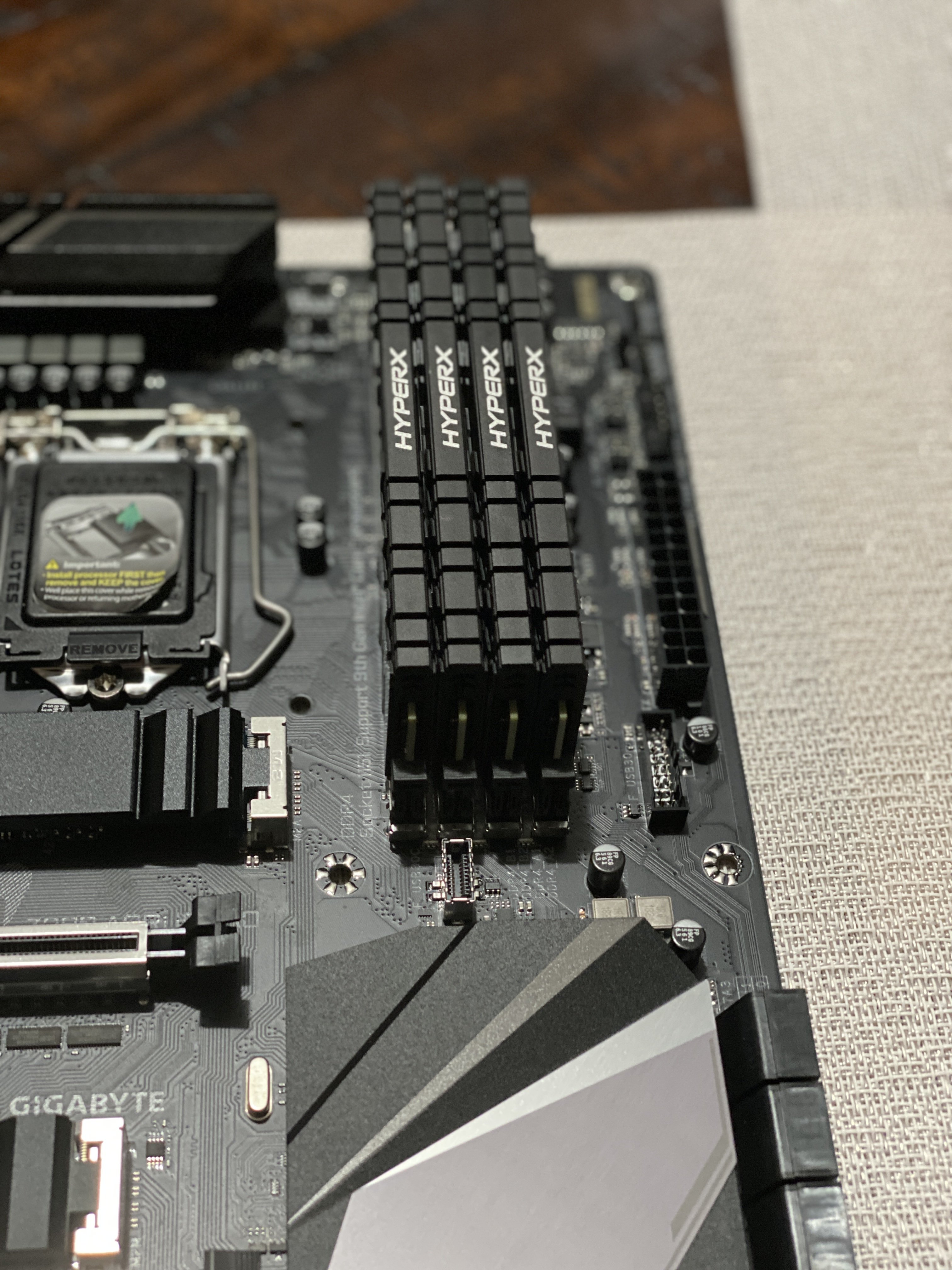

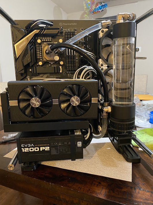

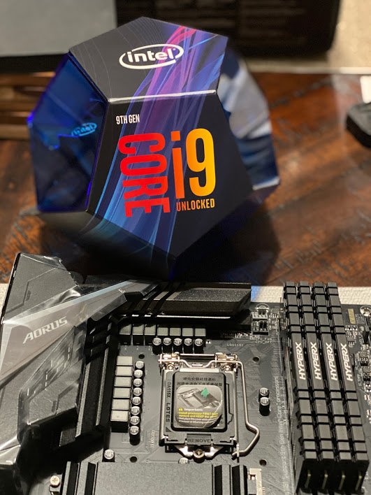

Hi Everyone,
Just joined.  This Hackintosh thing has been quite a journey for me over the last month.
Gigabyte Z390M Gaming + i3-9100F to i5 9600K to then deciding to return everything and just dual boot on my main rig (i7-7700K, Asus Z270G Strix board).  I had just got that finally working perfectly the day before yesterday and then I got the upgrade itch.  Switched out the board in my main rig with this beautiful beast, dropped in an i9-9900K, 64 GB DDR 3200, and an RX 580. (Main rig had a Water Cooled GTX 1080 which decided to poop itself the other day).  After a few hiccups here and there with the installer seeming to stall at 11 minutes remaining I decided to call it a night (3:30AM) and this morning I woke up to a complete install. Yay!  Then I ran into this thread this morning and wish I'd had stumbled on it yesterday to save me hours of headaches.  I think I'll do a fresh install again today following this guide just for the heck of it.
Anyway I have a question,  I'd like to understand why are we going with iMacPro 1,1 in this guide instead of 19,1?
Thanks for any input, I included some pictures of my build.  I'll take some better pictures of the rig once I run new tubing and clean the dust off the bad boy.
@hungrywallet Hey buddy, I’m glad my thread and EFI has helped you,  i went with macpro1,1 as myself @larabee and @glasgood ran countless amounts of tests and found smbios macpro1,1 to be a lot more friendly with the nvram and in tests it scored higher. Also myself and @larabee prefer not having the igpu enabled and again smbios macpro1,1 just fits the bill better.
Saying all of that though there’s nothing wrong with iMac19,1 and it works perfectly with my EFI so if you want to switch to it then just add the flag slide=0 into the clover config and enable the igpu in the bios. If it doesn’t want to boot after you do that then all you have to do is pull the battery from the motherboard for a minute or two and then load back in your Bios profile and away you go.
little tip, if you Want to use a Vega or Radion VII or Navi gpu then unlock MSR on your motherboard and that will prevent those pesky memory allocation failures at startup. :)
Edited by AudioGod
