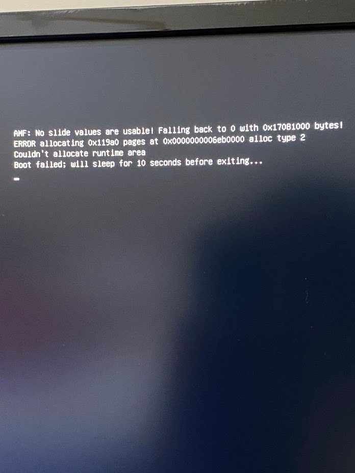

Guide Update
I am going to revert the EFI back to SMBios MacPro1,1 as to many of you are having to many problems getting it to run correctly under SMBios iMac19,1
The fix at the moment that works best would be to stop using Aptiomemoryfix.EFI and swap over to OsxAptioFix2Drv-free2000.efi and this would resolve the memory allocation failures at startup but since the Dev of OsxAptioFix2Drv-free2000.efi has pleaded with people not to use this driver in fear of it causing hardware failure I am not willing to use it but I have to add that the amount of system failures caused by using OsxAptioFix2Drv-free2000.efi is as far as I know a big fat Zero so if you want to carry on using my EFI under SMBios19,1 and can’t get it to work properly in its current form then that’s the fix to make it work correctly for you.

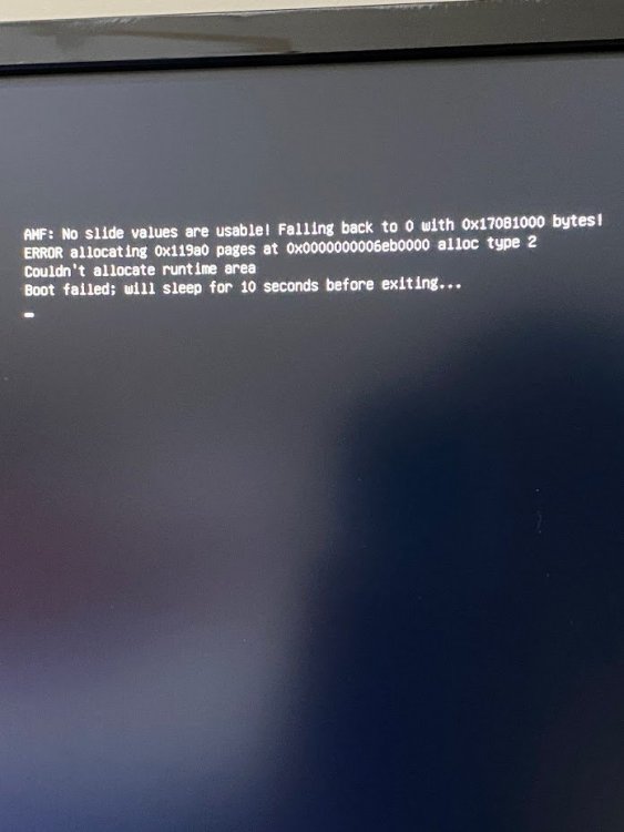

Anyway, switched to the NAVI EFI, had to add the agpdmod=pikera flag to fix the black screen at log in.  Also, been trying to fix the DRM issue without using the shiki flag to no avail.  After messing with it some I got the following error yesterday for the first time.

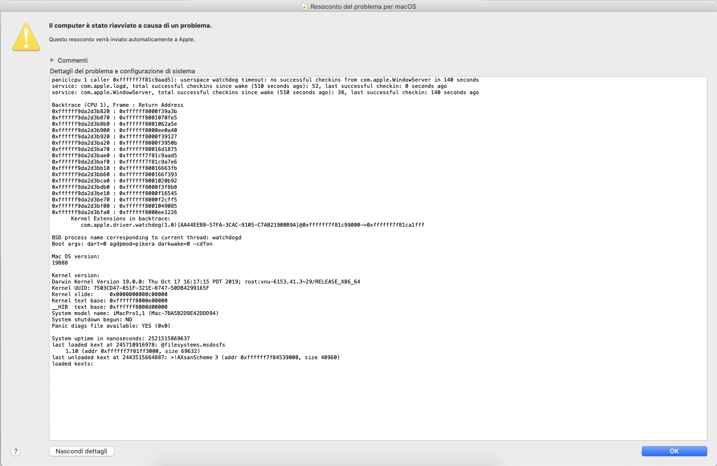

3 minutes ago, ilcondannato said:
Uhm this is log after "netflix + MacPro1,1 freeze on Safari"...mouse is moving...but nothing elese...2 min and system reboot
449760176_Schermata2019-11-12alle16_22_52.thumb.png.f9096563522fc6d7ec9b145e3d246268.png

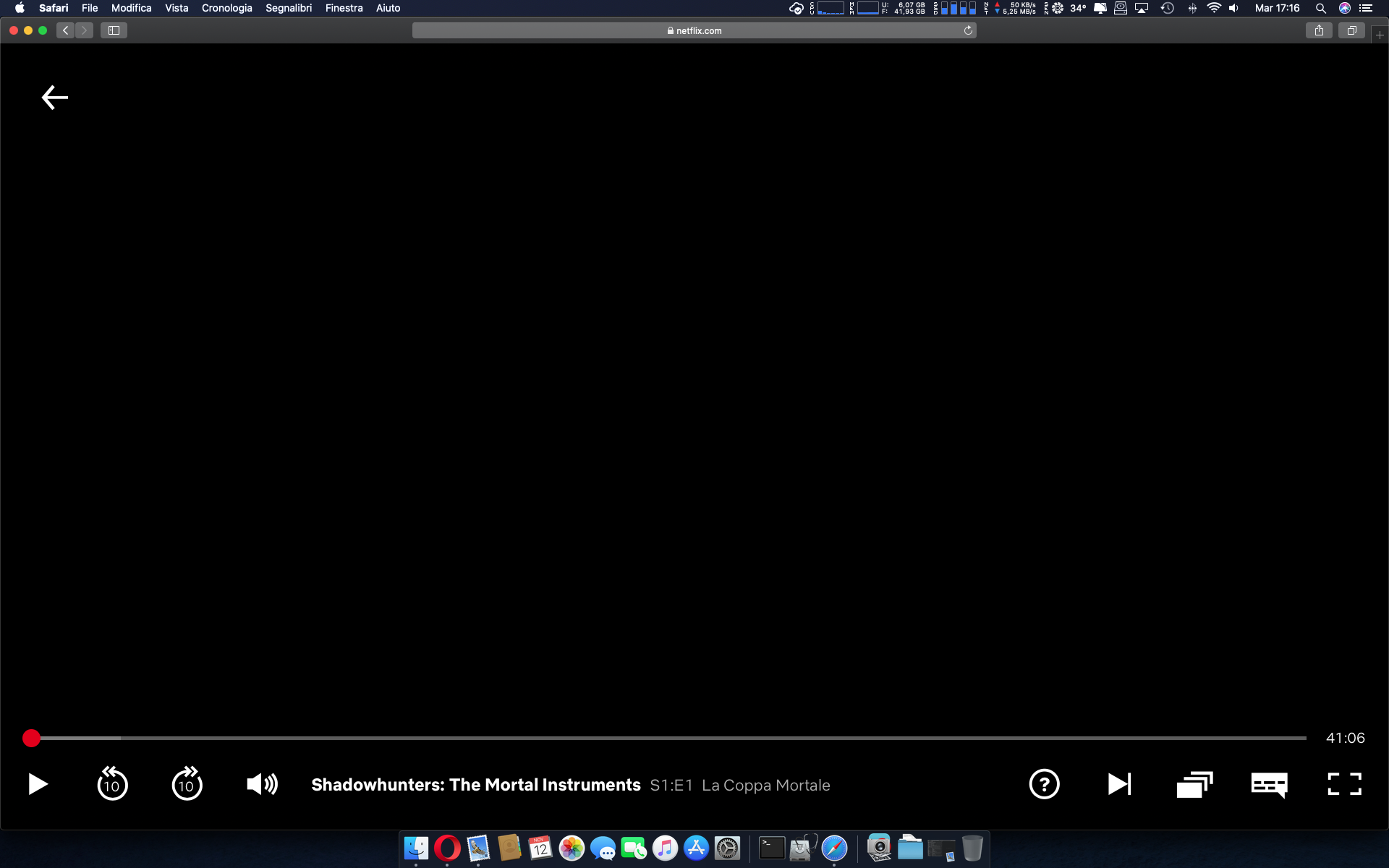

here more recent bios... try with Nitro+ , SE Bios (blue card) and with LimitedEd. bios...nothing change on 19.1 (not freeze but not play with drm issue..) Now i will try with MacPro 1,1 ...BRB
Woah just reupload Limited Ed firmware on one channel of my nitro... now works on MacPro1,1 (not at all on 19.1)...btw...i don't use sidecar so...stay good with 1,1 :-D
1872473392_Schermata2019-11-12alle17_16_53.thumb.png.da5acf94a4c1d58fefa5e324401c25cb.png
(ok screenshot is black 'couse they block it...but IT WORKS!)
