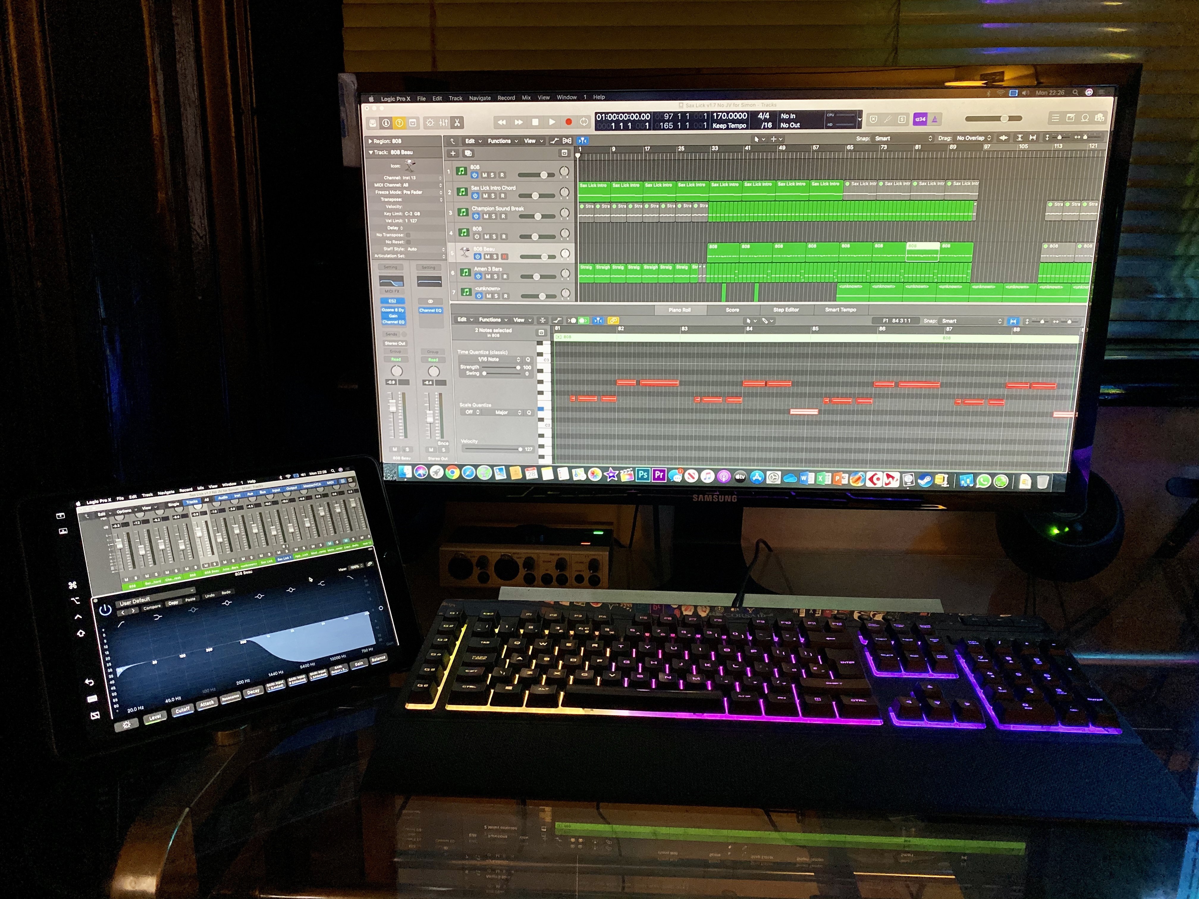

AudioGod Posted October 30, 2019 Author Share Posted October 30, 2019 (edited) 13 minutes ago, lygi said: Oh that's awesome! All bios settings stay same? My I9 has been OC to 5GHz and is stable AF So far I have noticed that Sidecar is not working - but will take a deeper look tomorrow. Busy season has landed at work Yes all bios settings remain the same. For Sidecar to work you need to have your igpu enabled and also use smbios 19,1 plus your need the boot flag slide=0 and then Sidecar will work. as for you oc, be warned as the new bios is so different that none of the power tables are the same so your overclock will more then likely need fine tuning again because of it. It’s a good thing though as the new bios is miles better Edited October 30, 2019 by AudioGod Link to comment https://www.insanelymac.com/forum/topic/339980-audiogods-aorus-z390-pro-patched-dsdt-mini-guide-and-discussion/page/11/#findComment-2695505 Share on other sites More sharing options...
tasc Posted October 31, 2019 Share Posted October 31, 2019 (edited) On 10/29/2019 at 8:06 PM, AudioGod said: I have now updated The EFI again for Catalina 10.15.1 to stop the system going to a black screen at install. You are now totally safe to update Catalina Using This EFI. Updated 30/10/2019 AudioGods Z390 Pro EFI VEGA Navi Radeon VII F11 DSDT.zip - Use with Bios revision F11 Only (Catalina 10.15.1 Vega, Navi, Radeon VII DSDT Installed) AudioGods Z390 PRO EFI RX F11 DSDT.zip - Use with Bios revision F11 Only (Catalina 10.15.1 RX5XX DSDT Installed) PLEASE NOTE - Please flash your motherboard bios to revision F11 to use my current EFI. It’s a major rework of the bios and vital changes have been made to the layout and power tables. New DSDTs have been created and installed into the new EFI’s but will not work correctly with any other bios revision. Latest Gigabyte Z390 PRO BIOS (F11) mb_bios_z390-aorus-pro_f11.zip Awesome AudioGod! How did you update the Pro EFI? I thought you didn't even have the motherboard anymore!? Also, won't we need to change at least the bios setting for that new bios aperture setting to work with 19,1? If so, do we need slide=0 anymore? Any other bios settings updates? I've updated to 15.1 already, but with this new info I'm planning to try and update BIOS, switch to 19,1 and use your updated EFI. Thanks! Edited October 31, 2019 by tasc 1 Link to comment https://www.insanelymac.com/forum/topic/339980-audiogods-aorus-z390-pro-patched-dsdt-mini-guide-and-discussion/page/11/#findComment-2695532 Share on other sites More sharing options...
