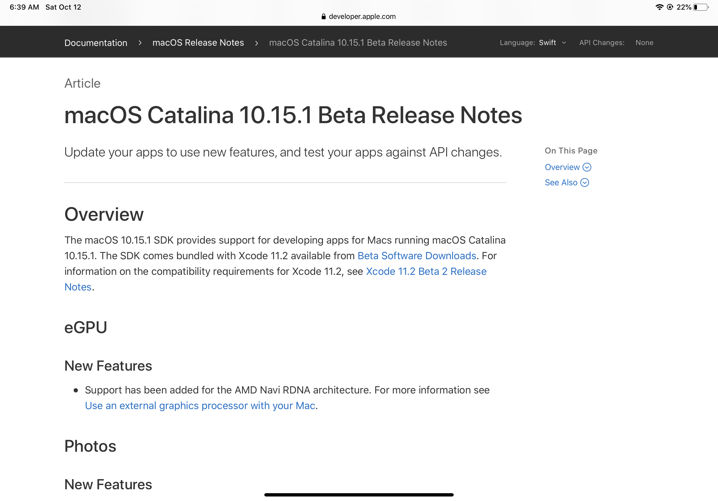

AudioGod Posted October 12, 2019 Author Share Posted October 12, 2019 (edited) 7 minutes ago, larabee said: @AudioGod good news: 10.15.1 will have support for AMD RDNA 5700xt. Try out the beta. That’s awesome, it’s a great card. I have two sitting here right now for sale online but I’m so keeping one now I’ve heard that...lol im gonna bang the beta on my test drive and see what goes on. nothing will make me happier then the day I can drop out the vega 56 from my system. Ive got every gpu from the rtx 2070 upwards sitting here and I use a vega 56....so wrong! ive got a 2080 ti (strix) that scores over 19000 in timespy out of the box...wtf man? That’s nearly 3 of my vega 56’s all running oc’s to equal that.... Edited October 12, 2019 by AudioGod Link to comment https://www.insanelymac.com/forum/topic/339980-audiogods-aorus-z390-pro-patched-dsdt-mini-guide-and-discussion/page/8/#findComment-2693301 Share on other sites More sharing options...

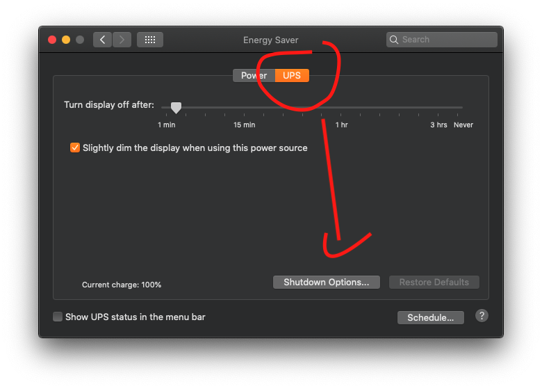

gino8080 Posted October 12, 2019 Share Posted October 12, 2019 I have a problem , because I'm using apcupsd a small utility to control the UPS power and shutdown process in case of energy failure but this is a 32 bit app! , so it will stop working on Catalina! Do you guys have any hints for this? or any shell script / alternative app? Osx Native energy power does not work, it does not appear in the energy saver (sometimes yes) maybe it's some setting on Efi ? Anyone is using a Smart UPS attached to machine? the model I'm using is this one APC by Schneider Electric BR1500GI UPS, 1500 VA/865 Watt, AVR https://www.amazon.it/gp/product/B0041MP81Y/ref=ppx_yo_dt_b_asin_title_o02_s01?ie=UTF8&psc=1 Link to comment https://www.insanelymac.com/forum/topic/339980-audiogods-aorus-z390-pro-patched-dsdt-mini-guide-and-discussion/page/8/#findComment-2693350 Share on other sites More sharing options...

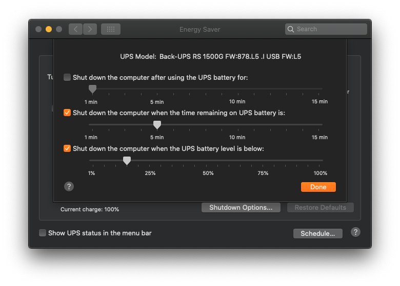

D3v1L Posted October 13, 2019 Share Posted October 13, 2019 13 hours ago, gino8080 said: I have a problem , because I'm using apcupsd a small utility to control the UPS power and shutdown process in case of energy failure but this is a 32 bit app! , so it will stop working on Catalina! Do you guys have any hints for this? or any shell script / alternative app? Osx Native energy power does not work, it does not appear in the energy saver (sometimes yes) maybe it's some setting on Efi ? Anyone is using a Smart UPS attached to machine? the model I'm using is this one APC by Schneider Electric BR1500GI UPS, 1500 VA/865 Watt, AVR https://www.amazon.it/gp/product/B0041MP81Y/ref=ppx_yo_dt_b_asin_title_o02_s01?ie=UTF8&psc=1 apc perdete ogni speranza o voi che lo usate ..... ATM no one 64bit ups software fon OS X sorry .... i have 2 x apc ups and on osx i’m put myself on “speraindio” mode lol Link to comment https://www.insanelymac.com/forum/topic/339980-audiogods-aorus-z390-pro-patched-dsdt-mini-guide-and-discussion/page/8/#findComment-2693395 Share on other sites More sharing options...
gino8080 Posted October 13, 2019 Share Posted October 13, 2019 Flawless Update!! thanks to @AudioGod @glasgood and all the others! for this great perfect EFI!! 10 hours ago, ilcondannato said: apc perdete ogni speranza o voi che lo usate ..... ATM no one 64bit ups software fon OS X sorry .... i have 2 x apc ups and on osx i’m put myself on “speraindio” mode lol Btw I also found the solution for my usb APC! If like me, your USB APC it does NOT appear in the native system power energy saver tab: you have to UNINSTALL completely every other manager like the very old apcupsd (use the uninstall script provided with it) sudo /usr/local/sbin/apcupsd-uninstall reboot, and then you should see your APC in the native energy saver, now you can set timeout, auto shutdown etcc when your machine is going on battery!! 2 Link to comment https://www.insanelymac.com/forum/topic/339980-audiogods-aorus-z390-pro-patched-dsdt-mini-guide-and-discussion/page/8/#findComment-2693456 Share on other sites More sharing options...

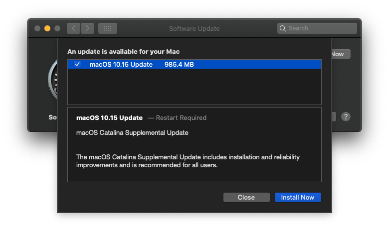

panosru Posted October 18, 2019 Share Posted October 18, 2019 (edited) @larabee Thanks for the hint!! (btw I wouldn't need more than 4k, the monitor I want to connect is just 1920x1080 ) Another issue I have now is that couple of days ago there was a new update for Catalina: But I'm clicking Install Now, it restarts but the update is not installed, it is still there :/ EDIT: I tried to boot into safe mode by holding the shift key on boot, but it boots on normal mode, is there any other way for hackintosh to boot into a safe mode? Edited October 18, 2019 by panosru Link to comment https://www.insanelymac.com/forum/topic/339980-audiogods-aorus-z390-pro-patched-dsdt-mini-guide-and-discussion/page/8/#findComment-2694073 Share on other sites More sharing options...
AudioGod Posted October 18, 2019 Author Share Posted October 18, 2019 19 minutes ago, panosru said: @larabee Thanks for the hint!! (btw I wouldn't need more than 4k, the monitor I want to connect is just 1920x1080 ) Another issue I have now is that couple of days ago there was a new update for Catalina: But I'm clicking Install Now, it restarts but the update is not installed, it is still there :/ EDIT: I tried to boot into safe mode by holding the shift key on boot, but it boots on normal mode, is there any other way for hackintosh to boot into a safe mode? It’s not selecting the correct drive for you at restart after the install begins. make sure when it gets to the clover boot up splash that the Catalina install drive is selected and your be fine. Didn’t happen to me when I updated but happened to a friend and that’s the fix. Link to comment https://www.insanelymac.com/forum/topic/339980-audiogods-aorus-z390-pro-patched-dsdt-mini-guide-and-discussion/page/8/#findComment-2694074 Share on other sites More sharing options...
panosru Posted October 18, 2019 Share Posted October 18, 2019 I'm not getting the clover splash, so I guess I have to make that change in my clover config and then revert it back right? Link to comment https://www.insanelymac.com/forum/topic/339980-audiogods-aorus-z390-pro-patched-dsdt-mini-guide-and-discussion/page/8/#findComment-2694075 Share on other sites More sharing options...
