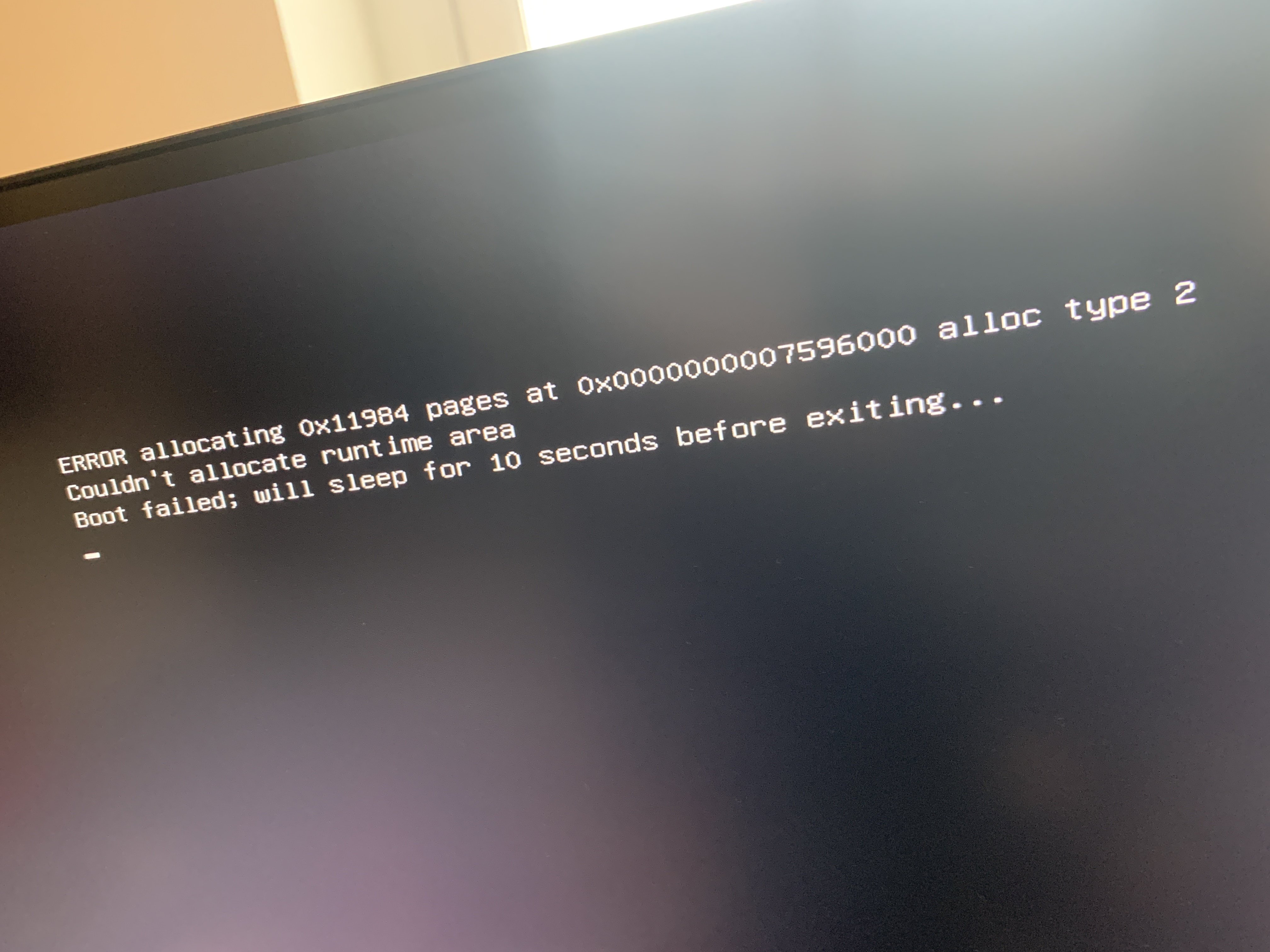

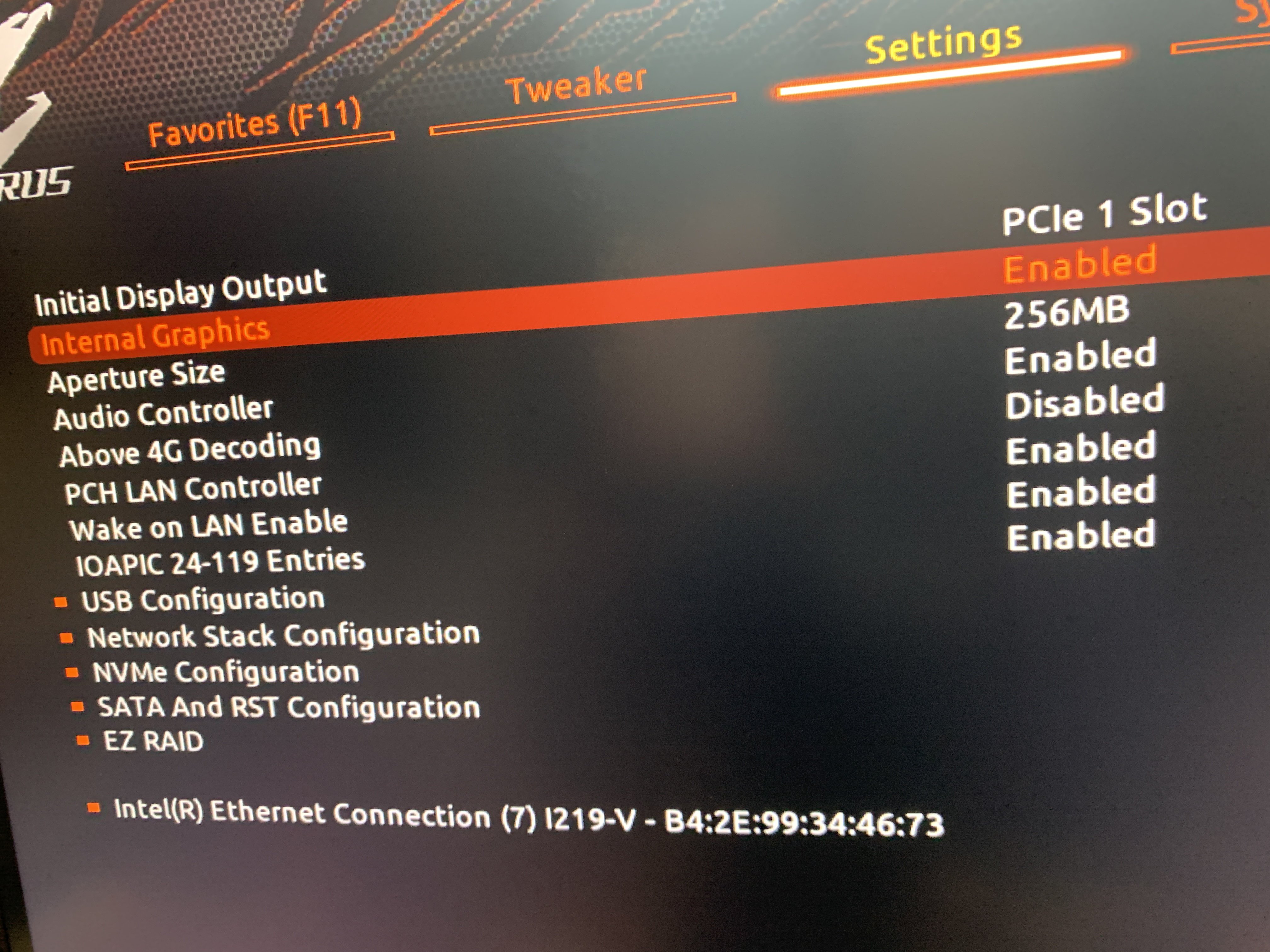

tasc Posted October 31, 2019 Share Posted October 31, 2019 (edited) 54 minutes ago, larabee said: I extracted my dsdt and sent to him to do the patching by Mald0n. Change your Aperture size from 256mb to 512 mb with the new bios. Ah gotcha, thanks @larabee. Do you have any PCI devices in your machine besides video card? If you're running bluetooth device or wifi, etc, I think I may need a DSDT based on my slimmed down setup. Also noticed a couple new boot arguments, what do these do? agdpmod=pikera -cdfon Edited October 31, 2019 by tasc Link to comment https://www.insanelymac.com/forum/topic/339980-audiogods-aorus-z390-pro-patched-dsdt-mini-guide-and-discussion/page/12/#findComment-2695542 Share on other sites More sharing options...
larabee Posted October 31, 2019 Share Posted October 31, 2019 (edited) 26 minutes ago, tasc said: Ah gotcha, thanks @larabee. Do you have any PCI devices in your machine besides video card? If you're running bluetooth device or wifi, etc, I think I may need a DSDT based on my slimmed down setup. Also noticed a couple new boot arguments, what do these do? agdpmod=pikera -cdfon I don't have any other PCI-E devices that need patching. I have a wifi/bluetooth card that works natively too. When I do the DSDT extraction, I already remove all unnecessary devices out of my system. agdpmod=pikera is an argument for WhateverGreen. It replaces board-id with board-ix in the binary file for your graphic card to work properly (only seems to work well if there's only one graphic card in the PCI-E slot) -cdfon is another WhateverGreen magic to enable HDMI 2.0 on your graphic card. 43 minutes ago, jardium666 said: im testing AudioGods Z390 PRO EFI RX F11 DSDT.zip - Use with Bios revision F11 Only (Catalina 10.15.1 RX5XX DSDT Installed) but i can't make to work my both monitors, any advice? btw im using a rx580 red devil Would you mind elaborating a little bit? Are you having problem with 2 displays? If so, what connectors are you using? Is your system working fine with 1 monitor? Edited October 31, 2019 by larabee Link to comment https://www.insanelymac.com/forum/topic/339980-audiogods-aorus-z390-pro-patched-dsdt-mini-guide-and-discussion/page/12/#findComment-2695544 Share on other sites More sharing options...

AudioGod Posted October 31, 2019 Author Share Posted October 31, 2019 9 hours ago, tasc said: Awesome AudioGod! How did you update the Pro EFI? I thought you didn't even have the motherboard anymore!? Also, won't we need to change at least the bios setting for that new bios aperture setting to work with 19,1? If so, do we need slide=0 anymore? Any other bios settings updates? I've updated to 15.1 already, but with this new info I'm planning to try and update BIOS, switch to 19,1 and use your updated EFI. Thanks! Hi Buddy, SMBios 19,1 works fine with the efi just enable the igpu and add slide=0 to the boot arguments. if it fails to boot after you make the changes then don’t panic just pull the battery from the motherboard for a minute or two and that will reset the space free for memory allocation and it will boot again. also on the new bios raise the bios aperture from 256mb too 512mb (experimental) Link to comment https://www.insanelymac.com/forum/topic/339980-audiogods-aorus-z390-pro-patched-dsdt-mini-guide-and-discussion/page/12/#findComment-2695572 Share on other sites More sharing options...

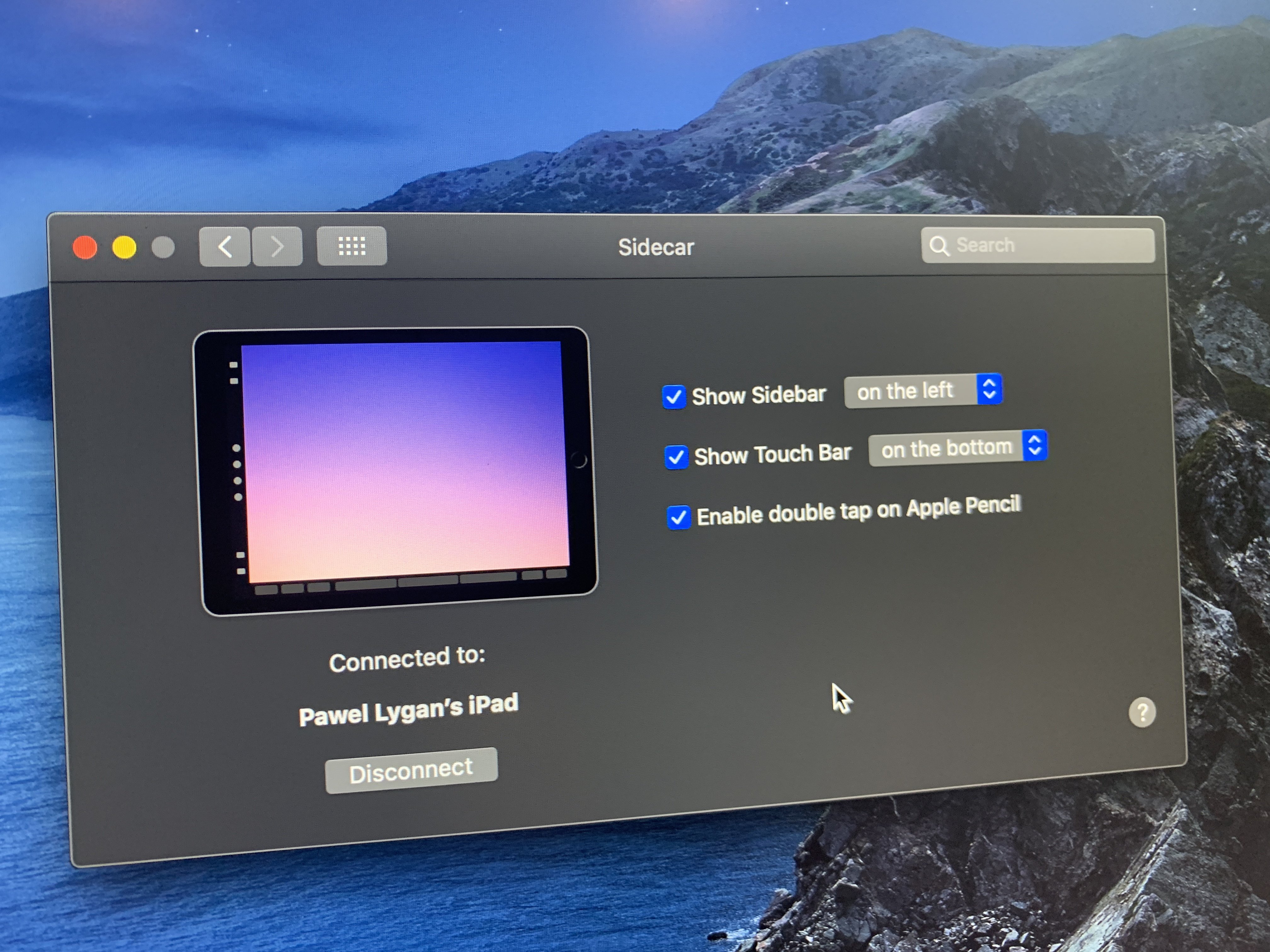

lygi Posted November 1, 2019 Share Posted November 1, 2019 7 On 10/30/2019 at 8:16 PM, AudioGod said: For Sidecar to work you need to have your igpu enabled and also use smbios 19,1 plus your need the boot flag slide=0 and then Sidecar will work. as for you oc, be warned as the new bios is so different that none of the power tables are the same so your overclock will more then likely need fine tuning again because of it. It’s a good thing though as the new bios is miles better Bios F11, your brand new EFI, but still struggling with Sidecar. With IGPU Enabled got an error as pictured, and with AUTO sidecar doesn't see my ipad (SMBIOS 19.1) Link to comment https://www.insanelymac.com/forum/topic/339980-audiogods-aorus-z390-pro-patched-dsdt-mini-guide-and-discussion/page/12/#findComment-2695732 Share on other sites More sharing options...
AudioGod Posted November 1, 2019 Author Share Posted November 1, 2019 (edited) 7 minutes ago, lygi said: Bios F11, your brand new EFI, but still struggling with Sidecar. With IGPU Enabled got an error as pictured, and with AUTO sidecar doesn't see my ipad (SMBIOS 19.1) You need to add the boot flag slide=0 to your clover config (you can also do it temporarily at the clover start up splash by pressing space and selecting slide=0) and if it still doesn’t play ball then all you need to do is reset your bios by pulling out its battery from the motherboard for a minute and then load back bios defaults then put your settings back in and done. igpu enabled in bios Edited November 1, 2019 by AudioGod Link to comment https://www.insanelymac.com/forum/topic/339980-audiogods-aorus-z390-pro-patched-dsdt-mini-guide-and-discussion/page/12/#findComment-2695733 Share on other sites More sharing options...
lygi Posted November 1, 2019 Share Posted November 1, 2019 Slide=0 was already set. Will try the trick with battery Link to comment https://www.insanelymac.com/forum/topic/339980-audiogods-aorus-z390-pro-patched-dsdt-mini-guide-and-discussion/page/12/#findComment-2695736 Share on other sites More sharing options...
AudioGod Posted November 1, 2019 Author Share Posted November 1, 2019 3 minutes ago, lygi said: Slide=0 was already set. Will try the trick with battery Yes do so that will do it for you. Link to comment https://www.insanelymac.com/forum/topic/339980-audiogods-aorus-z390-pro-patched-dsdt-mini-guide-and-discussion/page/12/#findComment-2695738 Share on other sites More sharing options...
lygi Posted November 1, 2019 Share Posted November 1, 2019 Boom! Thank you! 1 Link to comment https://www.insanelymac.com/forum/topic/339980-audiogods-aorus-z390-pro-patched-dsdt-mini-guide-and-discussion/page/12/#findComment-2695752 Share on other sites More sharing options...

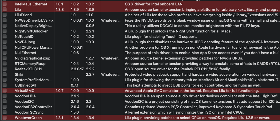

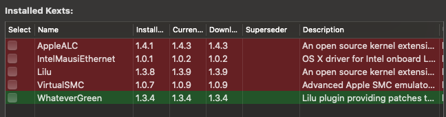

texem Posted November 2, 2019 Share Posted November 2, 2019 (edited) why didn't you upgrade WEG to 134 ? Edited November 3, 2019 by texem Link to comment https://www.insanelymac.com/forum/topic/339980-audiogods-aorus-z390-pro-patched-dsdt-mini-guide-and-discussion/page/12/#findComment-2695927 Share on other sites More sharing options...
AudioGod Posted November 2, 2019 Author Share Posted November 2, 2019 2 hours ago, gino8080 said: Hello guys! please can you help me with my Pink screen pronlem? I have Catalina 19A602 and 2 monitors attached main with DVI to HDMI and the secondary HDMI to HDMI and the Original EFI (i mean not the newest one) When I awake screens from sleep, i got the secondary or both monitors with all colors PINK!! after some second and mouse moves, pinks goes away, but the colors seems {censored}ed, white are too brights, like an overexposed photo! Anyone got some hints? maybe i need to update WhaterEvergreen or Lilu? or somehting like that? please help! just updated weg to 1.3.4 and your be fine again bud 1 Link to comment https://www.insanelymac.com/forum/topic/339980-audiogods-aorus-z390-pro-patched-dsdt-mini-guide-and-discussion/page/12/#findComment-2695928 Share on other sites More sharing options...

gino8080 Posted November 5, 2019 Share Posted November 5, 2019 On 11/3/2019 at 12:07 AM, AudioGod said: just updated weg to 1.3.4 and your be fine again bud Hello buddy! sadly upgraded WEG but problem still here (maybe is just less frequent) On 11/3/2019 at 12:05 AM, texem said: why didn't you upgrade WEG to 134 ? Because I usually tend to NOT touch anything when it's working please is there anything else I can try? maybe are the VGTAB settings injected? Should I share my EFI? Link to comment https://www.insanelymac.com/forum/topic/339980-audiogods-aorus-z390-pro-patched-dsdt-mini-guide-and-discussion/page/12/#findComment-2696166 Share on other sites More sharing options...
