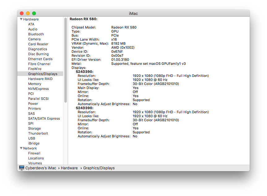

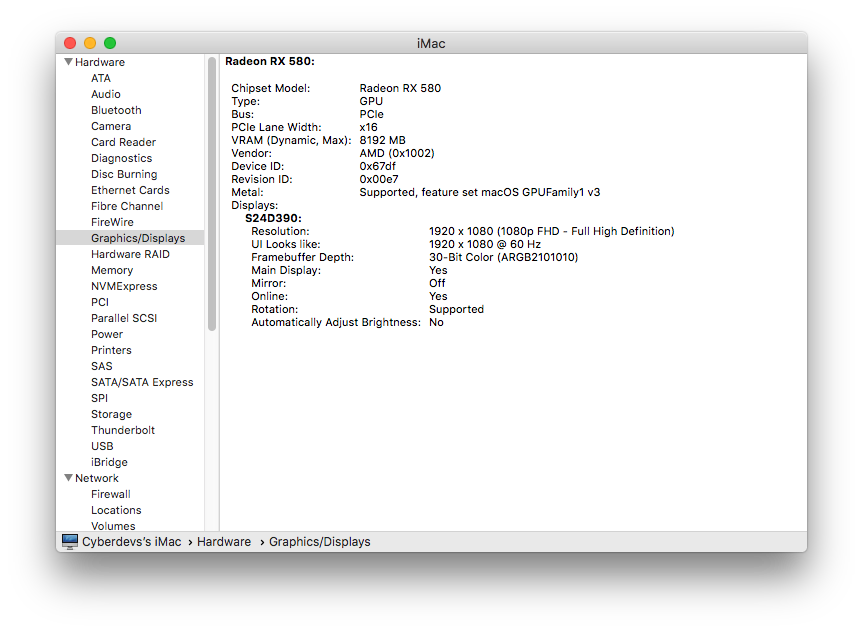

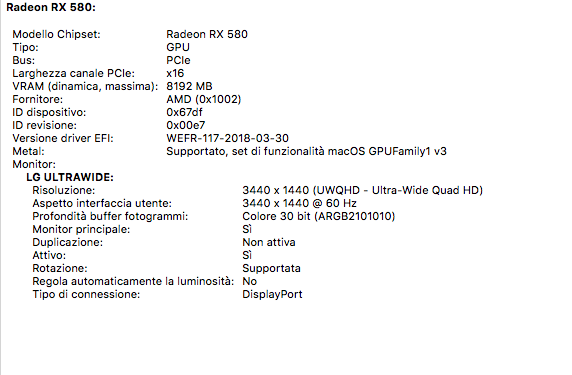

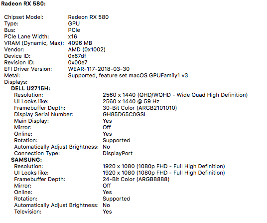

Slice Posted March 31, 2018 Share Posted March 31, 2018 Is it true that RX480 and RX580 shared same DeviceID but different revision c7 for 480 and e7 for 580? Please confirm if you have one of these cards. Link to comment https://www.insanelymac.com/forum/topic/333909-macos-high-sierra-10134-17e202-is-out/page/3/#findComment-2606616 Share on other sites More sharing options...
Cyberdevs Posted March 31, 2018 Share Posted March 31, 2018 (edited) 33 minutes ago, Slice said: Is it true that RX480 and RX580 shared same DeviceID but different revision c7 for 480 and e7 for 580? Please confirm if you have one of these cards. Here's the results on my RX 580: Chipset Model: Radeon RX 580 Type: GPU Bus: PCIe PCIe Lane Width: x16 VRAM (Total): 8 GB Vendor: AMD (0x1002) Device ID: 0x67df Revision ID: 0x00e7 As you can see the Revision id is e7. And from the post @Pavo posted earlier the revision id on his RX 480 is c7. Edited March 31, 2018 by Cyberdevs Link to comment https://www.insanelymac.com/forum/topic/333909-macos-high-sierra-10134-17e202-is-out/page/3/#findComment-2606618 Share on other sites More sharing options...
