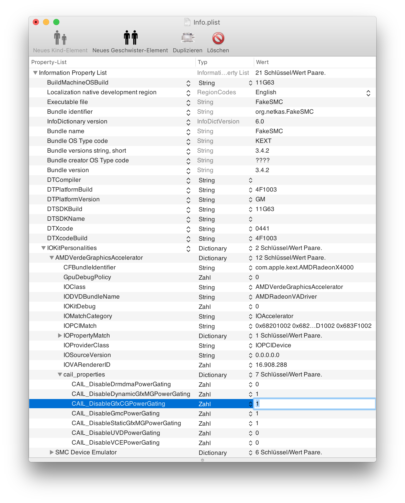

wern apfel Posted April 2, 2018 Share Posted April 2, 2018 7 minutes ago, LuCyr04 said: Yep, it's HD 7770, thanks for the info, but sorry, can you explain or link me to a topic: how to disable GfxCGPowerGating I'll receive the card tomorrow or Wednesday, I already removed my old nvidia from dsdt, I want to change the card without much hassle You can use the attached FakeSMC or copy the verde personalities and paste them into your FakeSMC. FakeSMC.kext_AMD_Verde.zip 1 Link to comment https://www.insanelymac.com/forum/topic/333909-macos-high-sierra-10134-17e202-is-out/page/7/#findComment-2607166 Share on other sites More sharing options...
Lucy183 Posted April 2, 2018 Share Posted April 2, 2018 2 minutes ago, wern apfel said: You can use the attached FakeSMC or copy the verde personalities and paste them into your FakeSMC. FakeSMC.kext_AMD_Verde.zip Thanks, I'd put them the right way? Link to comment https://www.insanelymac.com/forum/topic/333909-macos-high-sierra-10134-17e202-is-out/page/7/#findComment-2607167 Share on other sites More sharing options...
wern apfel Posted April 2, 2018 Share Posted April 2, 2018 2 minutes ago, LuCyr04 said: Thanks, I'd put them the right way? Yes, that's right, it's from the AMDRadeonX4000.kext and I set CAIL_DisableGfxCGPowerGating to 1. 1 Link to comment https://www.insanelymac.com/forum/topic/333909-macos-high-sierra-10134-17e202-is-out/page/7/#findComment-2607168 Share on other sites More sharing options...

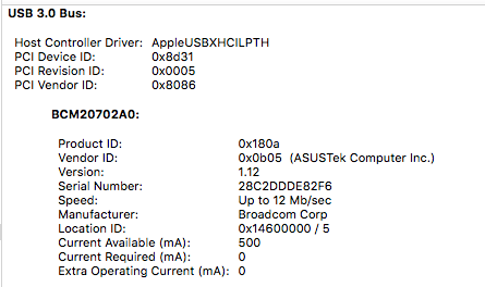

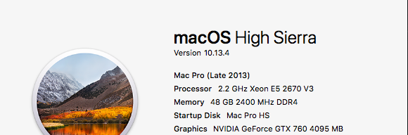

ergot Posted April 2, 2018 Share Posted April 2, 2018 (edited) update OK +nvidia and CUDA *Thanks Fabio!* , checking system the USB 3.0 is now missing, any fix for that on 10.13.4? I also had ASMedia for USB 3.1 now its gone... the only USB 3.0 BUS is the Asus WIFI_BT EDIT* Found this: Name*: AppleUSBXHCI Find* [HEX]: 837d940f 0f839704 0000 Replace* [HEX]: 837d940f 90909090 9090 Comment: USB 10.13.4+ by PMHeart it helps but ASMedia still not detected ...any help will be appreciated ! thanks Edited April 2, 2018 by ergot Link to comment https://www.insanelymac.com/forum/topic/333909-macos-high-sierra-10134-17e202-is-out/page/7/#findComment-2607171 Share on other sites More sharing options...

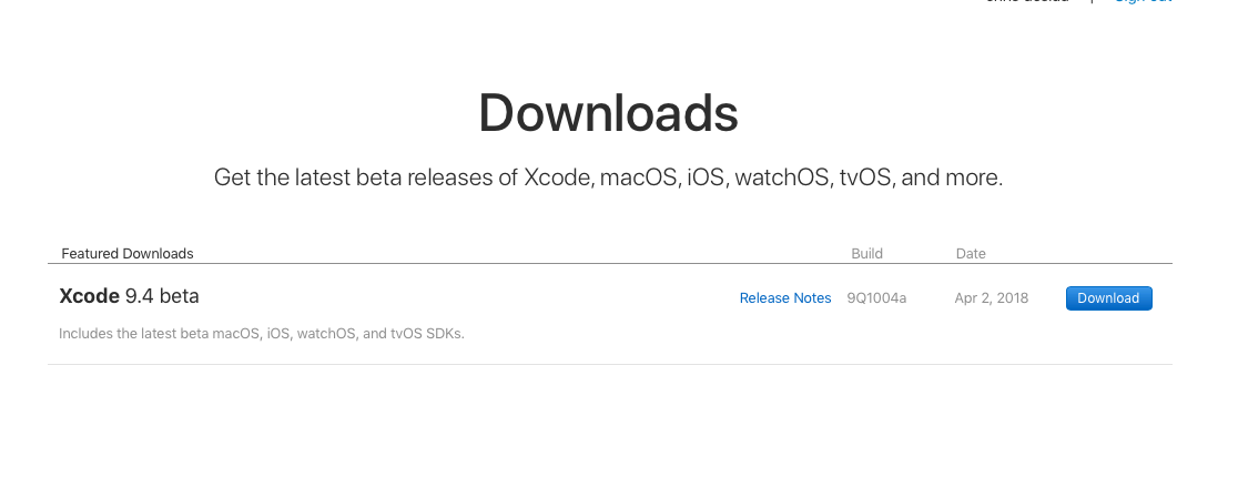

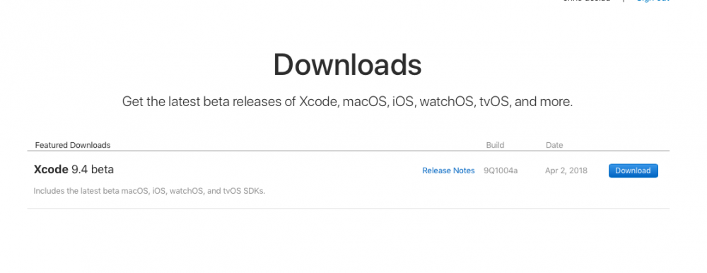

chris1111 Posted April 2, 2018 Share Posted April 2, 2018 Only Xcode available Link to comment https://www.insanelymac.com/forum/topic/333909-macos-high-sierra-10134-17e202-is-out/page/7/#findComment-2607272 Share on other sites More sharing options...
