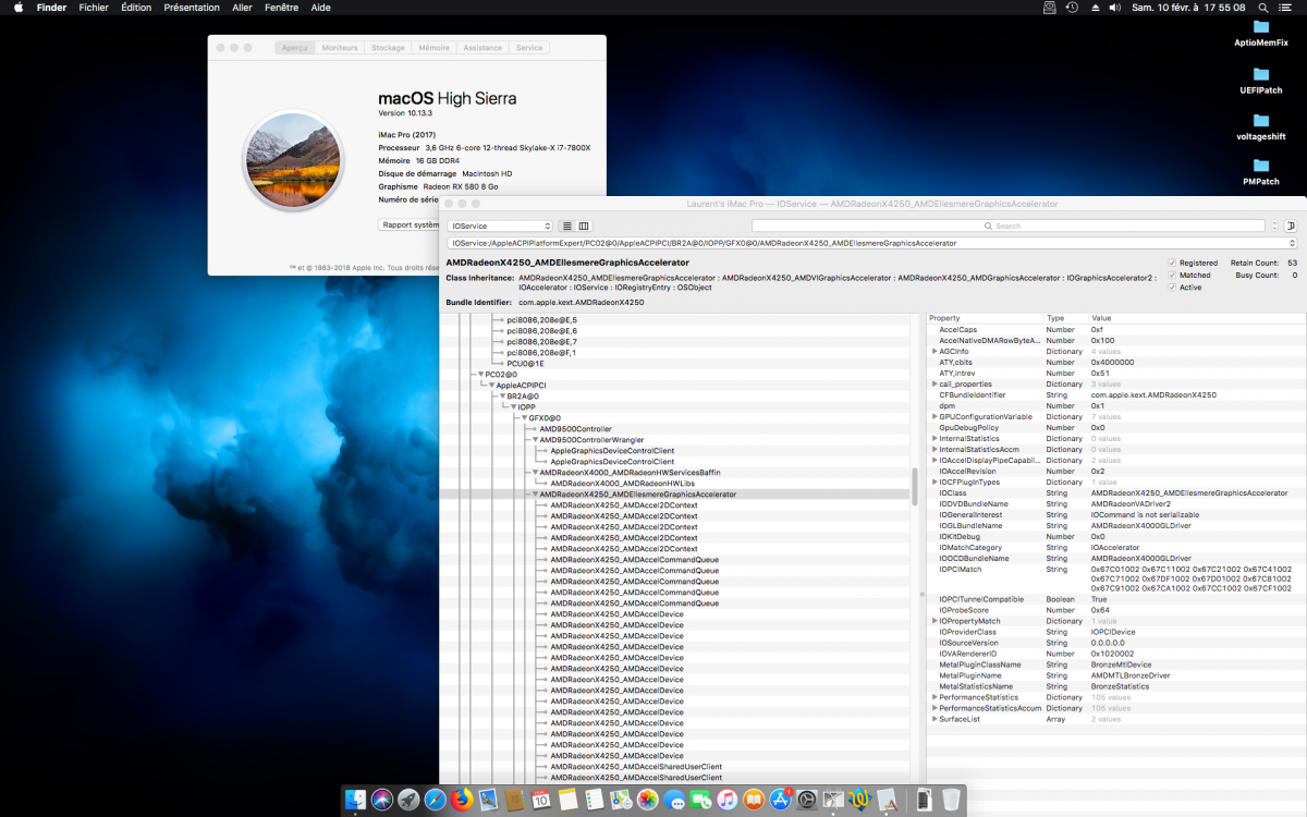

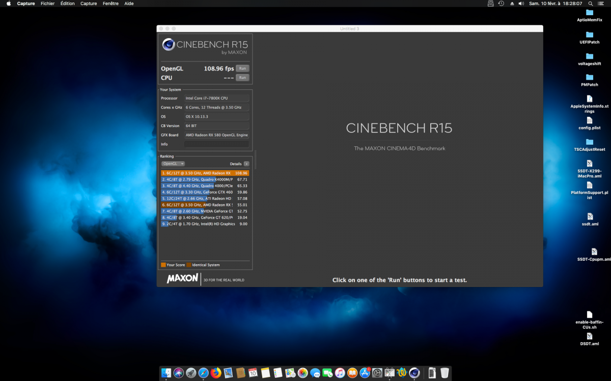

I need some help with my graphics settings :
When I had installed High Sierra with the guide I applied the following graphics seettings for my RX 580 :
 1/ RadeonDelnit in config.plist and watevergreen and lilu kexts in EFI/Clover/Kexts/Other and CPU ssdt.aml in ACPI/Patched
So my benchmark wasn't good about 55 fps
My system was stable sleep and wake with one clic on mouse.
2/ I did some research to improve that :
I set one change  enable-baffin-CUs.sh ellsmere 36
But another time my benchmark wasn't good about 55 fps
3/ I tried another way :
I removed only  watevergreen and lilu kexts :
I can boot my GPU was recognize as R9 XXX
but this time bingo the benchmark was quite good about 108 fps
But another problem this time I had sleep issue my build was randomly rebooting to wake.
Witch way to have graphics and sleep /wake  good ?

As you figured it out already you should not use Whatevergreen and RadeonDeInit together use only one of them or if you have a custom SSDT or just patched the DSDT only use that.
What I mean is:
1. Just Lilu and WhateverGreeen
or
2. Only RadeonDeInit
or
3. SSDT for GPU
or
4. DSDT patch from Mieze
WhateverGreen can solve the sleep/wake issue but as far as I know there were some issues regarding macOS High Sierra (I didn't follow WhateverGreen's evolution for a while I guess if you can compile the latest version it might solve the sleep issue).
You can also use a SSDT for your GPU which essentially does exactly what the RadeonDeInit does but it's more specific to your GPU and it can also solve the R9 XXX issue as well (Which is cosmetic and has no effect on the performance)
To solve the R9 XXX you can either use the SSDT I mentioned or you can use Clover's on the fly patch
Look at http://www.insanelymac.com/forum/topic/328549-tracing-back-the-amd-gpu-wakeup-issue-to-its-origin/and you can fine all about the SSDT or DSDT patching to avoid the black screen on AMD GPUs.
Pavo also has a repo for customs SSDTs for AMD GPUs if you can find it it would help you a lot. It was posted in the topic I just gave the link.

  Thank's cyberdevs for your reply !
You're right i can't have "mixed seettings" :
Well :
- i have compiled my SSDT-RX 580.aml
- i have my ssdt.aml for my CPU
So i will to try to  boot without RadeonDeInit, watevergreen and lilu and see.

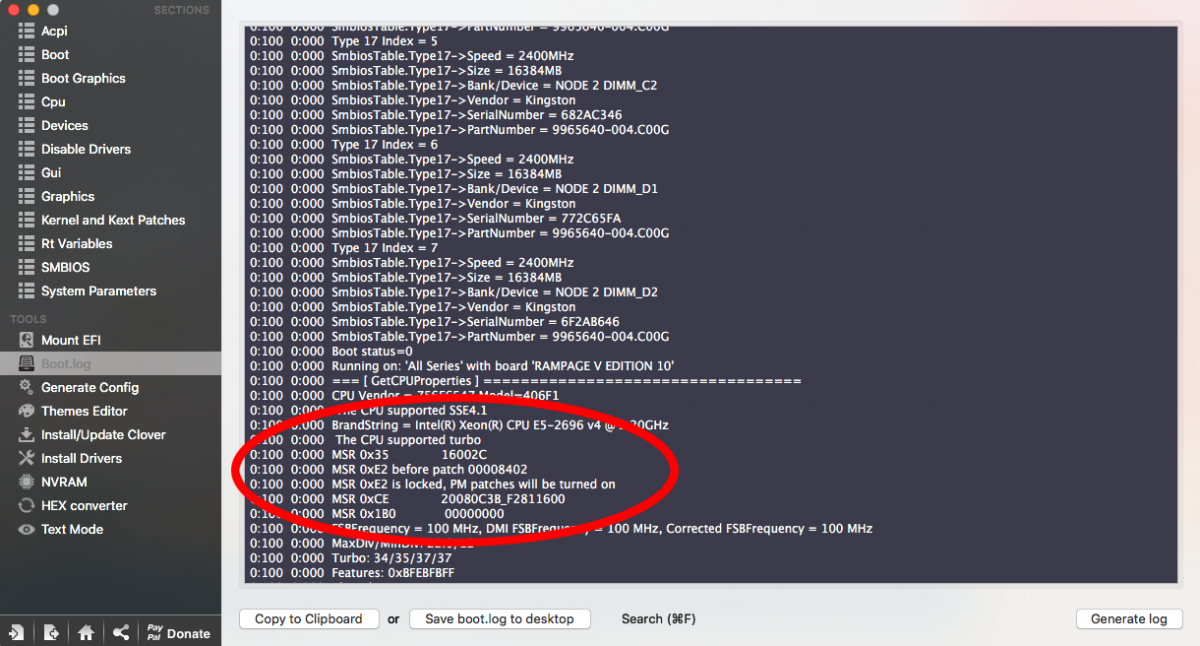

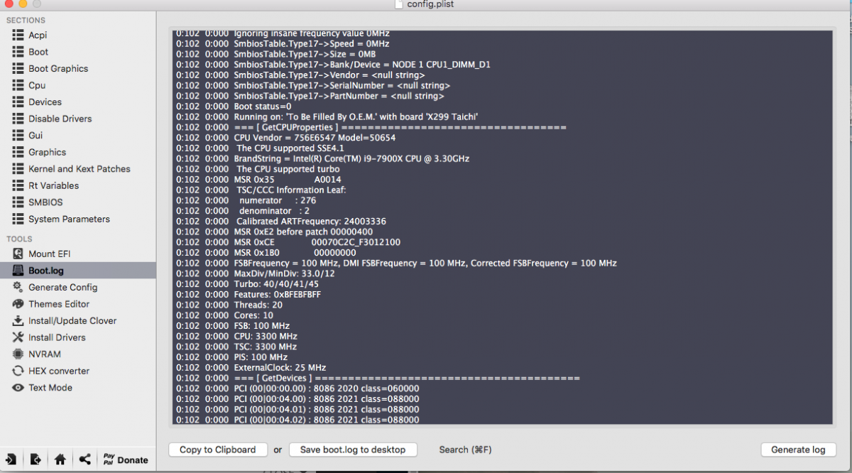

How do I check if my x299 asrock taichi is unlocked?
"X299 Systems with unlocked mainboard BIOS MSR 0xE2 BIOS register"
I have successfully installed my first mackintosh using your EFI and guide.  Now I'm going back just learning all of the things that kinda went over my head.
Thank you for your guide :)
Nice to see another Hackintosh Happy user :)
so to check if your MB is unlocked, I thking the easiest way:
mv ~/Downloads/voltageshift ~/Desktop/  (if you have downloaded voltageshift in downloads folder, you will copy that folder to desktop)
so then
cd ~/Desktop/voltageshift/
sudo chmod -R 755 VoltageShift.kext
sudo chown -R root:wheel ~/Desktop/voltageshift/VoltageShift.kext
./voltageshift read 0xe2
and the result should be something like
RDMSR e2 returns value 0x7e000003
voila :P
If someone have some other idea, I'm sure they will share .. :)
Have a nice day! :)
