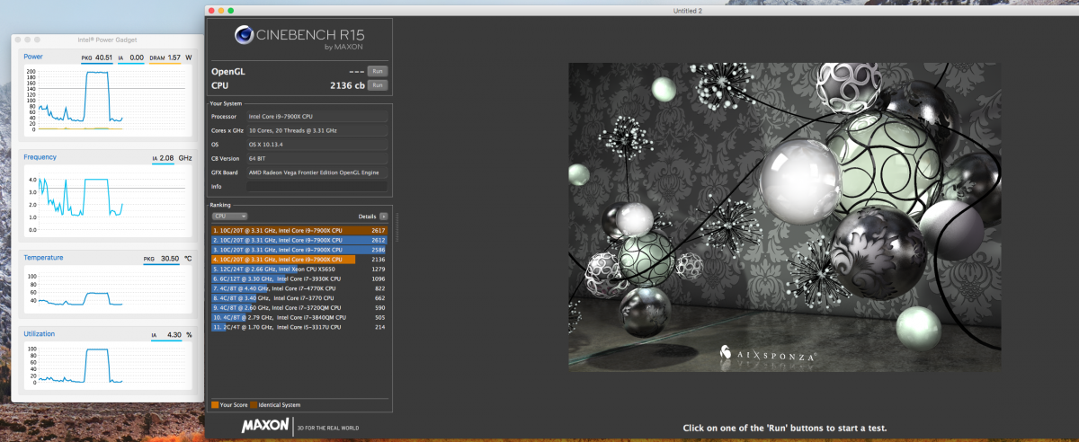

If this helps,
Don't always believe everything you read. I reset my bios to default - no overclock, 7900x. The power draw was 200W.
Don't pay any attention to the temps, it's delidded and on a custom loop.
Probably the 140W was non turbo draw.
If you wanted to you could underclock your processor and run it on air, but then you might as well go for one of the 6 core cheap chips.
I'm sticking with kgp's opinion on this one.
