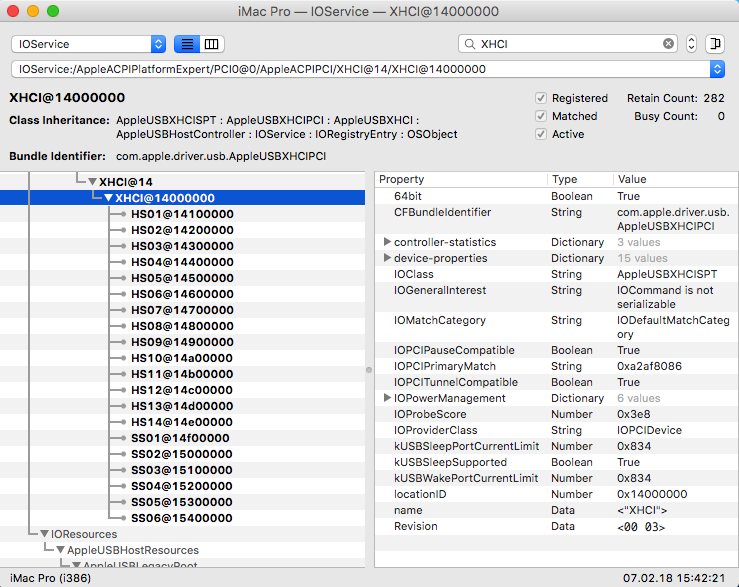

Hi Matthew82
when is it possible Can you share your IOREG and actual config.plist?
I would like to compare with mine :)
Thank you

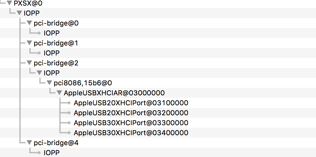

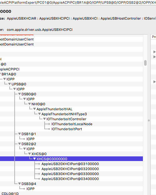

attachicon.gifZrzut ekranu 2018-02-07 o 17.12.29.pngThere no need to connect any device to TB card show in ioreg.
Im asking because I have one unresolved problem in my hack. With TB card hack won't go sleep on second time. Without all working OK.
I see... You might have a different TB PCI implementation in your SSDT... Could you provide details?
In my case, it only shows up under "PCI" or in IOREG, when a TB Device is connected...
I reloaded the IOREG Dump with TB in post       #235
BTW... I have a weird problem with the TBEX 3 and my LaCie TB drive.. The latter only gets initialised on Boot (before passing the BIOS Splash Screen) after removing and replugging the TBEX 3 from/to it's slot. A firmware update for the TBEX 3 did not remove this issue..

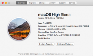

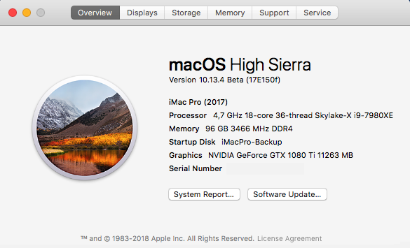

Yet another Guide Update - Implementation of 10.13.4 Beta 2 (17E150f)
Note, that the USB port Limit Patch in the config.plist for 10.13.3 (17D2047)
Name*              Find*[Hex]      Replace* [Hex]    Comment
AppleUSBXHCIPCI    837d8c10        837d8c19          10.13.3 USB Port Limit Patch
must be updated for 10.13.4 Beta 2 (17E150f) to:
AppleUSBXHCI   837d940f 0f839704 0000   837d941a 90909090 9090   10.13.4 USB Port Limit Patch
under "KextsToPatch" in Section "Kernel and Kext Patches" of Clover Configurator, as else not all available XHC USB ports will be natively implemented.
Like always many thanks to @PMHeart from InsanelyMac for providing the respective XHC USB port limit patches.
For further details see Section E.4) - USB Configuration
You can update your iMac Pro macOS High Sierra 10.13.3 (17D2047) build to macOS High Sierra 10.13.4 Beta 2 (17E150f) directly via the Appstore after successfully registration for Apple's Beta Program. However, it is rather recommended to clone your 10.13.3 (17D2047) System Disk with Carbon Copy Cloner (CCC) to a test drive and to update to 10.13.4 Beta 2 (17E150f) on the latter.

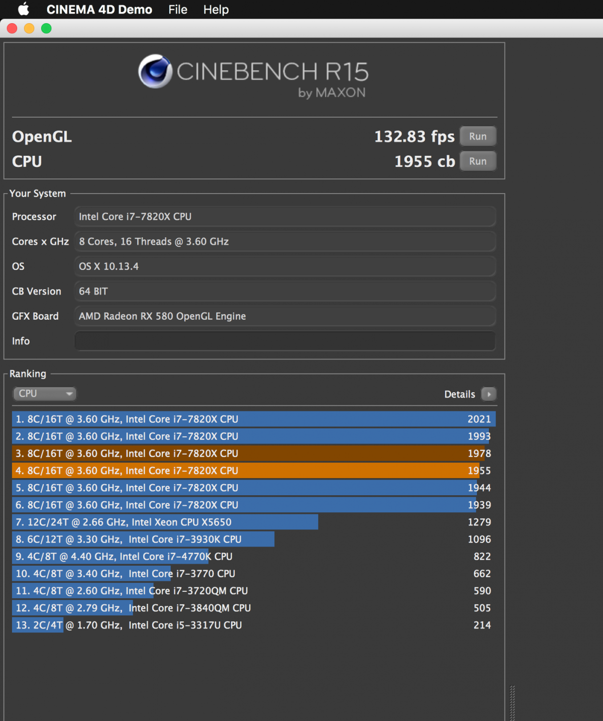

There is no any magic for rx580/480. Insert to slot, check RadeonDelnit and everything is set.
Perhaps using DP port ?
Port have nothing to do. Maybe you have bad card or same mess in your hackintosh setup.
@Loloflat6

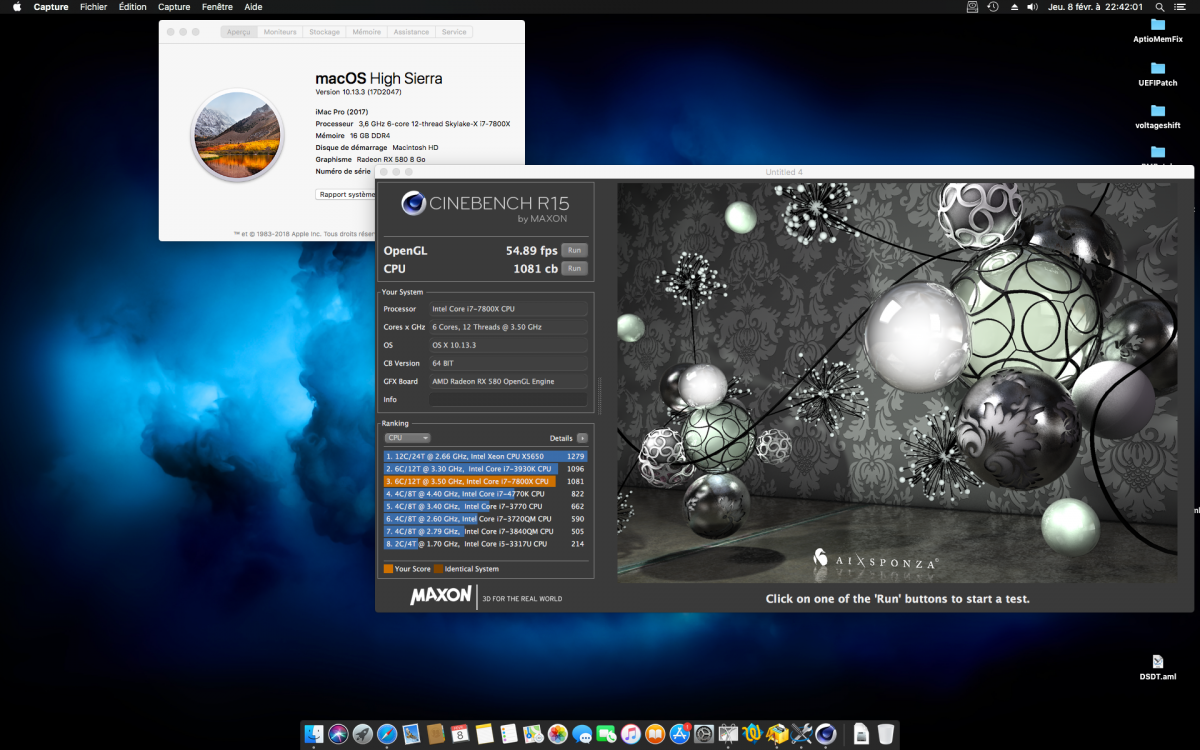

CinebenchZ OpenGl results are very dependent also from cpu Higher turbo boost clock
In my opinion You should also check if your CPU has right value in cpu benchmark and if it reaches high frequency also
@Loloflat6
Thank's : i will chek that and adjust my seettings : i'm agree that this X299 build offers many parameters to set i never had before.

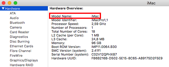

Update of the Update - New macOS High Sierra 10.13.4 Beta 2 Build 17E150g!
  • At first glance no major changes/improvements when compared with 10.13.4 Beta 2 (17E150f)
  • Build number still does not relate with former iMac Pro special builds
  • Persistent "Model Name" error in system profiler under "Hardware" of Apple's System report (iMac instead of iMacPro)
  • Persistent issues at least with the NVIDIA HDAU implementation
Enjoy and have fun,
