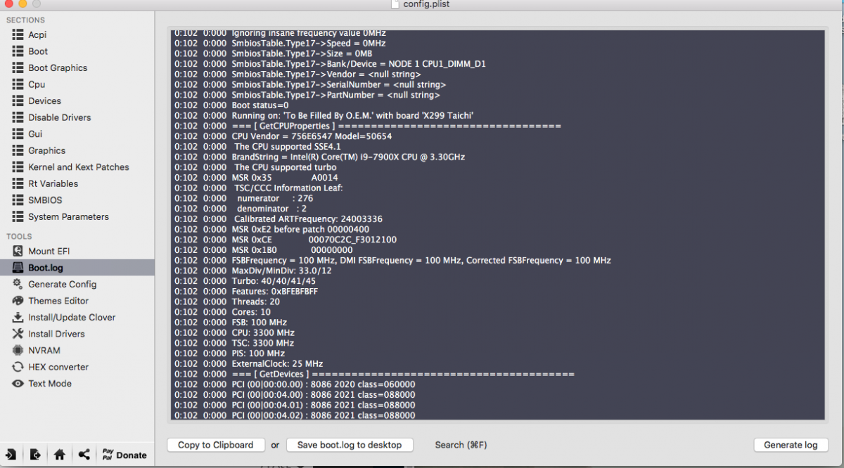

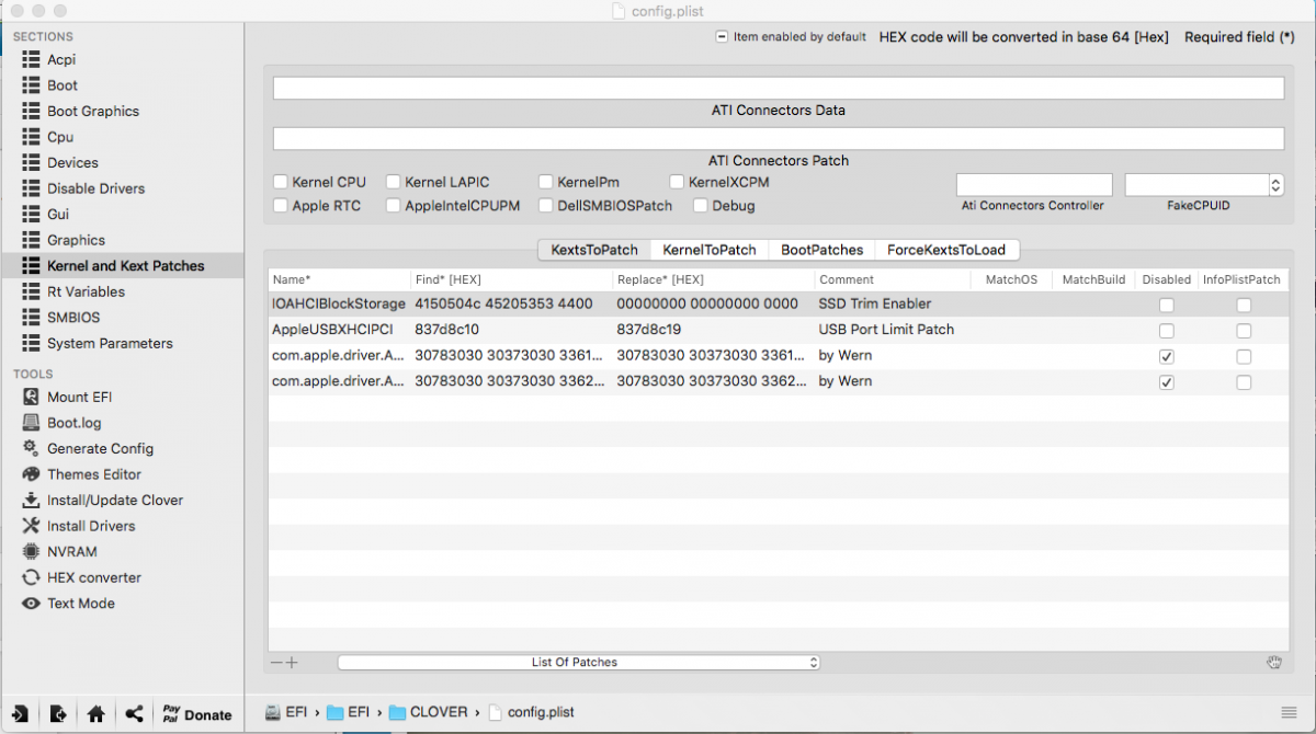

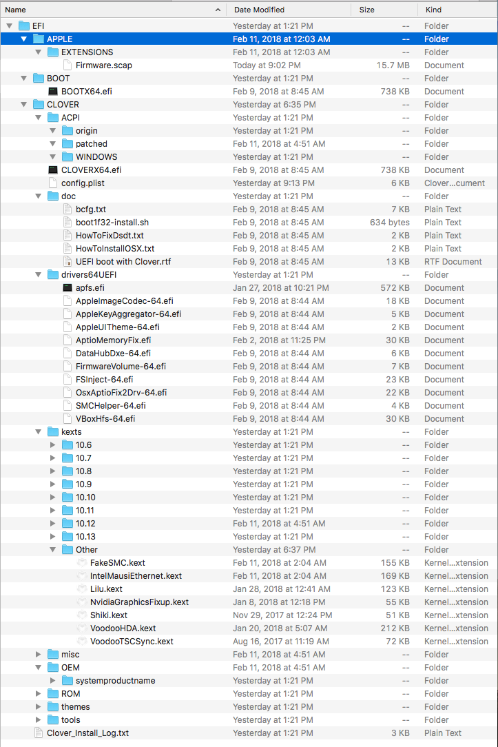

Ok I share :)
if some of you can take a look.  Are there any possible issues that are visible from looking at the boot log?  I've used this guides EFI file which initially didn't work so I removed a few patches, changed to 17.1 though not sure if it was a good choice but eventually it booted.  but I feel I might have removed too much and not applied perhaps everything necessary.
WORKING
ethernet
Nvidia :)
USBs in the back off of motherboard
NOT WORKING
bluetooth :( (this one I'm bummed about)
wifi
front of the case 4 USBs
Audio from HDMI going to TV(this one I'm really bummed)
havne't tried the usb c 3.1 yet in the back

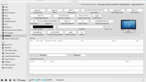

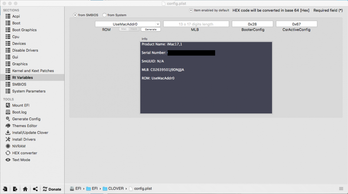

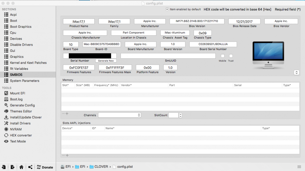

What you mean by  you removed a few patches and you changed to 17,1? You mean SMBIOS iMac17,1? Why do you do that if you have SMBIOS iMacPro1,1 and 10.13.3 (17D2047) available? Please use my latest EFI-Folder distribution and guide implementations. BTW, If you are using  AptioMemoryFix.efi, remove the slide=0 boot flag.. Do you really need npci=0x3000 instead of npci=0x2000? I don't need the npci boot flag at all.. Once you will be on SMBIOS iMacPro1,1, you do not need to use neither NvidiaGraphicsFixup nor Shiki.kext.  You don't use any ACPI patches and you do not inject any audio ID.. Neither you adopted or use a SSDT-X299-iMacPro.aml properly adopted to your system..
My friend, you still have a lot of work ahead to bring your system in line with the actual recommended system implementations. No surprise that you face that many issues. Please carefully read and revise my guide   ;)
All the best and good luck,
KGP
KGP
The reason i removed things because i couldn't boot with your efi straight as it stood. First time doing this!  Which of the things i mentioned that i don't have working will smbios imacPro1.1 fix?  I don't think my bluetooth and wifi is supported at all.  I heard the HDMI audio also won't work as per nvidia drivers as they stand right now while connected to display port at the same time.  But I really hope those things aren't true and they would work.
Firstly when i downloaded high sierra from an actual mac app store i think it came with 17d47 only.  Unless i'm wrong in which case where do i download 17D2047 to make a boot usb?  I don't want to update or anything i'll probably do another clean install with some help as last time i couldn't get you efi working correctly they way it was.
My guide and EFI-Folder use the ASUS Prime X299 Deluxe as baseline. The EFI-Folder however is kept as general as possible.. Though, few adaptations might be necessary when using a mainboard different from the ASUS Prime X299 Deluxe.
Which ASRock X299 mobo are you using? I was recently advised to minimise my config.plist settings. Thus, there might be some additional settings you need to implement in  your config.plist, e.g. ncpi=0x2000 might be one of them... Once everything is properly implemented, all USB ports and also HDAU should properly work. Your onboard BT should work without any issues. Your WIFI onboard chip however might be totally incompatible with OSX. Thus I recommend to think on some alternative Bluetooth/WIFI PCIe Adapter implementation such as the OSXWIFI. Note that there are also cheaper BT/WIFI PCIe adapter solutions available. You also might be able to replace the onboard BT/WIFI module instead.
You cannot download 10.13.3 (17D2047) from the Appstore. My guide implements a detailed guideline how to generate a 10.13.3 (17D2047) USB Flash Drive Installer and how to perform a clean install of  10.13.3 (17D2047) with SMBIOS iMacPro1,1 or any update to 10.13.3 (17D2047) with SMBIOS ImacPro1,1!  See Section D.)!
If you further resist in carefully reading my guide, it is difficult to provide any further help or advise. If you face any problems during the clean install of  10.13.3 (17D2047) with SMBIOS iMacPro1,1, you are always welcome to ask for further help and advise.
Good luck and all the best,
KGP

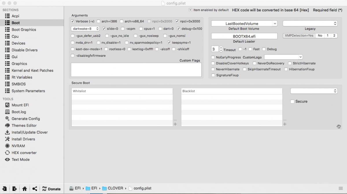

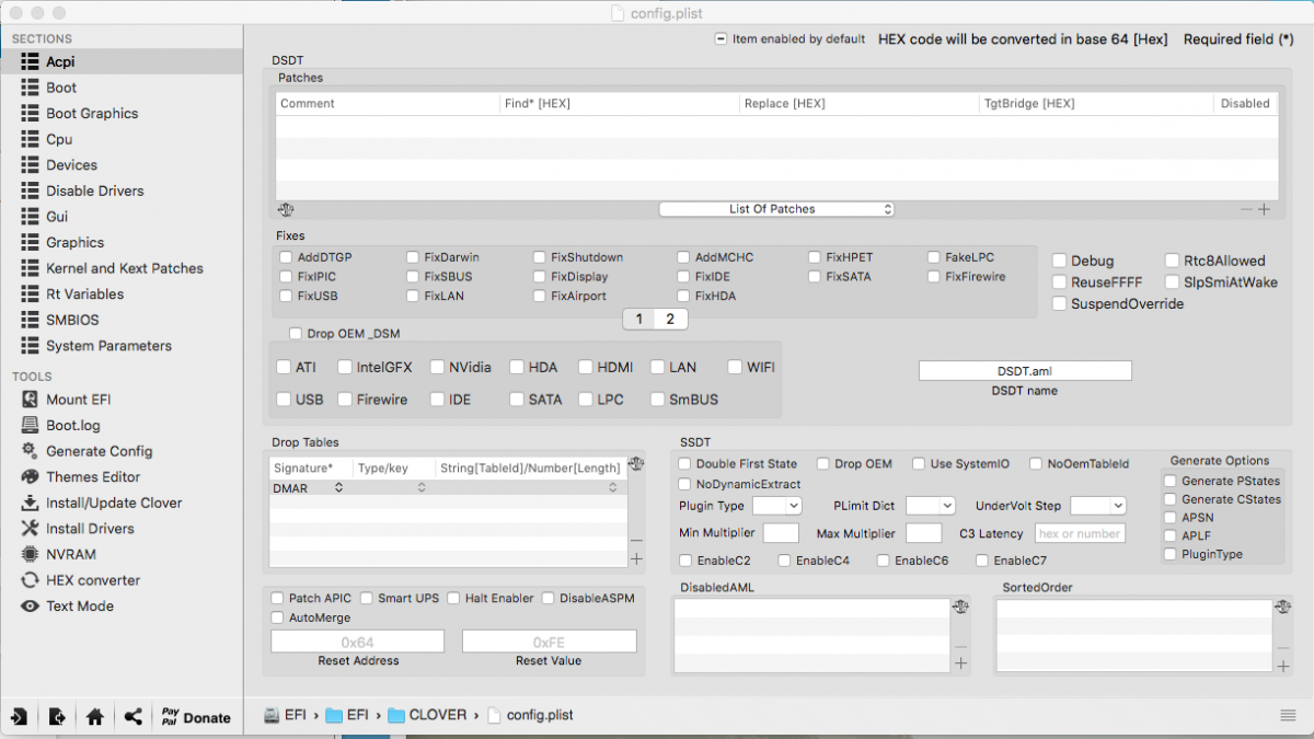

@deckardlives
- use only the "AptioMemoryFix.efi", remove the "OsxAptioFix2Drv.efi"
- use a current "Clover Configurator" ("Vibrant Edition" instead of "Classic Edition")
- remove the "Slide = 0" entry
- select checkbox ACPI / SSDT / Generate Options -> "PluginType"
- remove "npci = 0x3000"
- Update the "USB Port Limit Patch" for 10.13.4

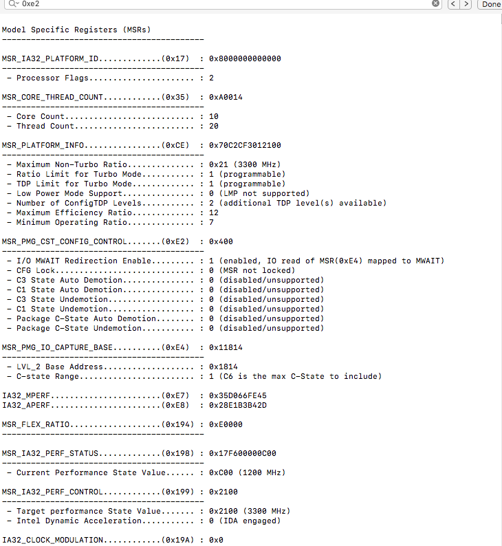

Anyway I just realised that the patches now official published by the coders are some former and not the most recent patches of @interferenc, which now also solve the Skylake-X TSC issue:
# Patch string format
# FileGuid SectionType PatchType:FindPatternOrOffset:ReplacePattern
# Please ensure that the latest symbol in patch string is space
# Possible section types:
#  PE32 image                    10
#  Position-independent code     11
#  TE Image                      12
#  DXE Dependency                13
#  Version information           14
#  User interface string         15
#  16-bit code                   16
#  Guided freeform               18
#  Raw data                      19
#  PEI Dependency                1B
#  SMM Dependency                1C
# Please do not try another section types, it can make the resulting image broken
# Possible patch types:
#  P - pattern-based, first parameter is a pattern to find, second - a pattern to replace
#  O - offset-based, first parameter is hexadecimal offset, second - a pattern toreplace
# Patterns can have . as "any possible value" symbol
# OSX CPU Power Management patches
# Remove lock from MSR 0xE2 register
# SiInit
299D6F8B-2EC9-4E40-9EC6-DDAA7EBF5FD9 12 P:81E10080000033C1:9090909090909090
# PpmInitialize Reset IA32_TSC_ADJUST to 0 instead of enforcing 0xE2 lock
3FFCAE95-23CF-4967-94F5-16352F68E43B 10 P:742CB9E20000000F3248C1E220480BC20FBAE00F488944240872130FBAE80F89442408488B54240848C1EA200F30:BA00000000B800000000B93B0000000F309090909090909090909090909090909090909090909090909090909090
# CpuInitPei Reset IA32_TSC_ADJUST to 0 instead of enforcing 0xE2 lock
01359D99-9446-456D-ADA4-50A711C03ADA 12 P:B9E20000000F328BC8BE0080000023CE0BCF75190BC6894424088954240C8B54240C8B442408B9E20000000F30:BA00000000B800000000B93B0000000F3090909090909090909090909090909090909090909090909090909090
# CpuMpDxe to disable TSC writes
40BEAB40-CECE-4909-B133-20A413AE19E9 10 P:488BD6B9100000008BC648C1EA200F30:90909090909090909090909090909090
The actual patching looks like that:
parseImageFile: Aptio capsule signature may become invalid after image modifications
parseFile: non-empty pad-file contents will be destroyed after volume modifications
patch: replaced 8 bytes at offset 4380h 81E10080000033C1 -> 9090909090909090
patch: replaced 46 bytes at offset 2974h 742CB9E20000000F3248C1E220480BC20FBAE00F488944240872130FBAE80F89442408488B54240848C1EA200F30 -> BA00000000B800000000B93B0000000F309090909090909090909090909090909090909090909090909090909090
patch: replaced 45 bytes at offset 1507h B9E20000000F328BC8BE0080000023CE0BCF75190BC6894424088954240C8B54240C8B442408B9E20000000F30 -> BA00000000B800000000B93B0000000F3090909090909090909090909090909090909090909090909090909090
patch: replaced 16 bytes at offset 1F1Eh 488BD6B9100000008BC648C1EA200F30 -> 90909090909090909090909090909090
Image patched
Did you ever try to apply the latter patches to your Asrock firmware? They make VoodooTSCSync.kext totally obsolete at least with ASUS X299 mainboards ...
hey guys,
I also got notified about the patches being included in UEFIPatch, and saw that they are the older patches and also lack the patch that fixes the e3 wake issue. I submitted a pull request here:
https://github.com/LongSoft/UEFITool/pull/113
The other issue is a minor one, where patching the same GUID more than once does not work properly. Sadly that's still true, but on the upside, we don't really need that.
https://github.com/LongSoft/UEFITool/issues/92
Also, while I am really satisfied with my TSC patches, that addresses a different issue than the MSR unlock, so while the patch is useful, I am not sure that should be in the official UEFIPatch distribution. Thus I only submitted the unlocking patches.
I have gist here with the TSC patches included for Asus boards if anybody needs it, I know it is kgp's guide as well:
https://gist.github.com/interferenc/d82357a13751bc24dcc5942f6af2374b
