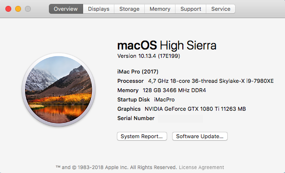

Update to macOS High Sierra 10.13.4 (17E199)
Changes, issues and limitations:
1.) New USB port Limit Patch
Name*          Find*[Hex]               Replace* [Hex]           Comment
AppleUSBXHCI   837d940f 0f839704 0000   837d941a 90909090 9090   10.13.4 USB Port Limit Patch by PMHeart
2.) No Nvidia Web Driver yet released. Use patched Web Driver xxx.106 or xxx.159 instead.
3.) Nvidia HDAU digital audio not working - no PCI driver installed despite an else correct HDAU SSDT PCI device implementation.

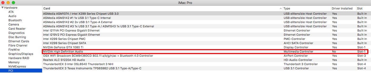

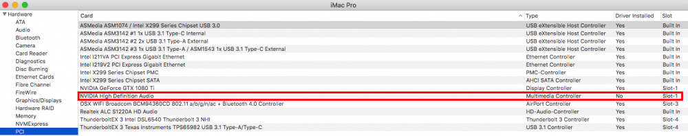

Enjoy and have fun,
1 hour ago, fabiosun said:
For HDMI/DP Nvidia audio implementation check APPLEALC thread or old 10.13.4 beta thread here
must patch AppleHDAController.kext from AppleHDA.kext ... but I dont know how ... I change AppleHDAController.kext from old version 13.3 and it is work ...
You have to way to do it
via config.plist (search in your ioreg device id for HDAU and patch it as @FredWst have said in beta 10.13.4 or use a AppleAlc kext with your device injected in it (see appleALC thread for this
roll back as you did is fine too :)
Edited by Guest
added links

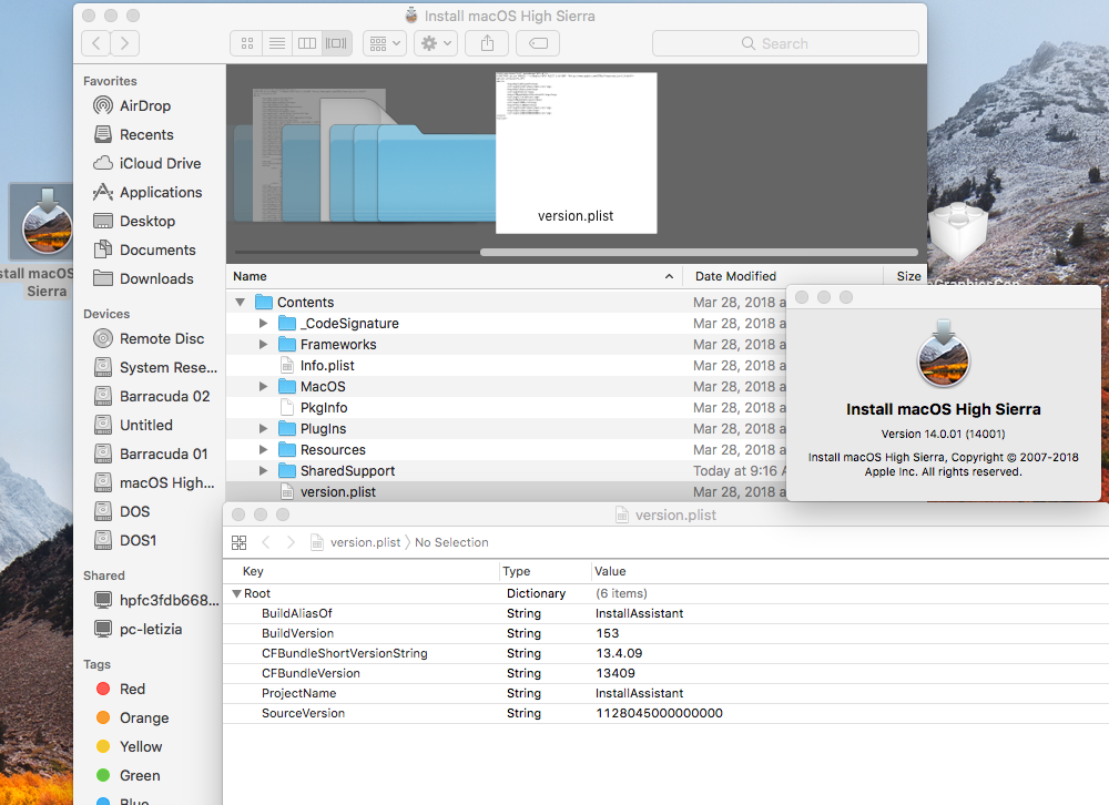

2 minutes ago, KGP-iMacPro said:
The Appstore update installer package to 10.13.4 has 2.5GB! No idea where you take the 15 MB from...
some hours ago , I download only 15 Mb ...twice ... whatever ... can you change links for new 13.4 ?... tkx...
