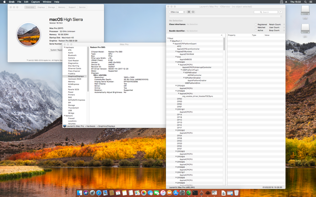

Loloflat6 Posted February 1, 2018 Share Posted February 1, 2018 Nice night : "Live The Future" Must set some parameters later but install is made Cosmetic patch applied Now it's time to go to bed ; Today power management 2 Link to comment https://www.insanelymac.com/forum/topic/331658-how-to-build-your-own-imac-pro-successful-buildextended-guide/page/8/#findComment-2582528 Share on other sites More sharing options...

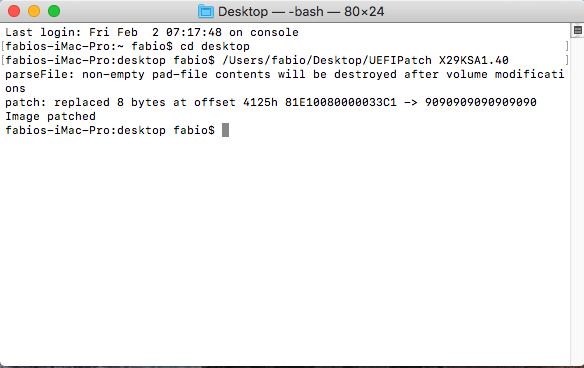

maleorderbride Posted February 2, 2018 Share Posted February 2, 2018 Thanks for the information in this thread. I am attempting to unlock 0xE2 on an ASRock X299 Killer SLI/ac, but I receive the following error using the patches.txt that you link to: bash-3.2$ ./UEFIPatch /Users/newuser/Desktop/UEFIPatch/X29KSA1.40 parseSection: decompression failed with error "Standard decompression failed" parseSection: decompression failed with error "Standard decompression failed" ...... parseSection: decompression failed with error "Standard decompression failed" parseSection: decompression failed with error "Standard decompression failed" parseSection: decompression failed with error "Standard decompression failed" parseSection: decompression failed with error "Standard decompression failed" parseSection: decompression failed with error "Standard decompression failed" parseSection: decompression failed with error "Standard decompression failed" parseSection: decompression failed with error "Standard decompression failed" parseSection: decompression failed with error "Standard decompression failed" parseFile: non-empty pad-file contents will be destroyed after volume modifications patch: replaced 8 bytes at offset 4125h 81E10080000033C1 -> 9090909090909090 patch: replaced 8 bytes at offset 1510h BE0080000023CE0B -> BE0000000023CE0B reconstructSection: executable section rebase failed Error , Any ideas on what should be changed in the patches.txt? Here is the BIOS file if you would like to verify: http://asrock.pc.cdn.bitgravity.com/BIOS/2066/X299%20Killer%20SLIac(1.40)ROM.zip Link to comment https://www.insanelymac.com/forum/topic/331658-how-to-build-your-own-imac-pro-successful-buildextended-guide/page/8/#findComment-2582546 Share on other sites More sharing options...
Guest Posted February 2, 2018 Share Posted February 2, 2018 Thanks for the information in this thread. I am attempting to unlock 0xE2 on an ASRock X299 Killer SLI/ac, but I receive the following error using the patches.txt that you link to: bash-3.2$ ./UEFIPatch /Users/newuser/Desktop/UEFIPatch/X29KSA1.40 parseSection: decompression failed with error "Standard decompression failed" parseSection: decompression failed with error "Standard decompression failed" ...... parseSection: decompression failed with error "Standard decompression failed" parseSection: decompression failed with error "Standard decompression failed" parseSection: decompression failed with error "Standard decompression failed" parseSection: decompression failed with error "Standard decompression failed" parseSection: decompression failed with error "Standard decompression failed" parseSection: decompression failed with error "Standard decompression failed" parseSection: decompression failed with error "Standard decompression failed" parseSection: decompression failed with error "Standard decompression failed" parseFile: non-empty pad-file contents will be destroyed after volume modifications patch: replaced 8 bytes at offset 4125h 81E10080000033C1 -> 9090909090909090 patch: replaced 8 bytes at offset 1510h BE0080000023CE0B -> BE0000000023CE0B reconstructSection: executable section rebase failed Error , Any ideas on what should be changed in the patches.txt? Here is the BIOS file if you would like to verify: http://asrock.pc.cdn.bitgravity.com/BIOS/2066/X299%20Killer%20SLIac(1.40)ROM.zip Hi maleorderbride..how much time I have this message with standard uefipatch Are you sure your bios is not factory unlocked? From many years Asrock unlock it If I remember well from X79 chipset I attached your "patched" bios. You can try to patch from yourself using standard code rush tools Link to comment https://www.insanelymac.com/forum/topic/331658-how-to-build-your-own-imac-pro-successful-buildextended-guide/page/8/#findComment-2582581 Share on other sites More sharing options...
maleorderbride Posted February 2, 2018 Share Posted February 2, 2018 I'll give that a try, but I don't see the patched BIOS? I had assumed it is locked because I need a Kernel patch in order to boot, which the ASUS X299s can drop after patching their BIOS. Perhaps E2 is not locked though, as I see this in bdmesg from clover boot log: (it should say locked, right?) 0:104 0:000 MSR 0xE2 before patch 00000400 0:104 0:000 MSR 0xCE 00070C2C_F3012300 0:104 0:000 MSR 0x1B0 00000000 Link to comment https://www.insanelymac.com/forum/topic/331658-how-to-build-your-own-imac-pro-successful-buildextended-guide/page/8/#findComment-2582992 Share on other sites More sharing options...
Guest Posted February 2, 2018 Share Posted February 2, 2018 I'll give that a try, but I don't see the patched BIOS? I had assumed it is locked because I need a Kernel patch in order to boot, which the ASUS X299s can drop after patching their BIOS. Perhaps E2 is not locked though, as I see this in bdmesg from clover boot log: (it should say locked, right?) 0:104 0:000 MSR 0xE2 before patch 00000400 0:104 0:000 MSR 0xCE 00070C2C_F3012300 0:104 0:000 MSR 0x1B0 00000000 https://we.tl/62tdT8Pvfx sorry was too big I can't test it but in my opinion your bios is factory unlocked Link to comment https://www.insanelymac.com/forum/topic/331658-how-to-build-your-own-imac-pro-successful-buildextended-guide/page/8/#findComment-2583037 Share on other sites More sharing options...
maleorderbride Posted February 2, 2018 Share Posted February 2, 2018 Thanks Fabio! I'm in the midst of other computers stuff right now, but I will test this BIOS later today. Link to comment https://www.insanelymac.com/forum/topic/331658-how-to-build-your-own-imac-pro-successful-buildextended-guide/page/8/#findComment-2583058 Share on other sites More sharing options...

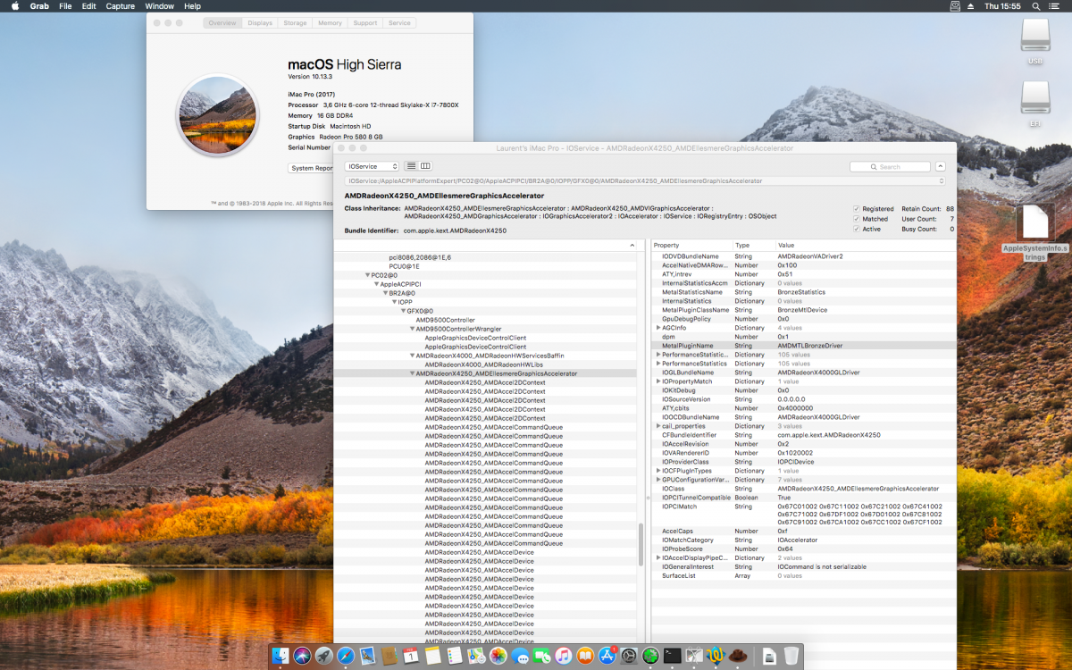

Loloflat6 Posted February 2, 2018 Share Posted February 2, 2018 Notice : my Sapphire Radeon Nitro+ RX580 SE (special edition) 8GB is fully working : fans or stopped when the GPU is not solicited like in Windows 10 no problem after wake . I'll run some benchmarks this week-end... 1 Link to comment https://www.insanelymac.com/forum/topic/331658-how-to-build-your-own-imac-pro-successful-buildextended-guide/page/8/#findComment-2583068 Share on other sites More sharing options...

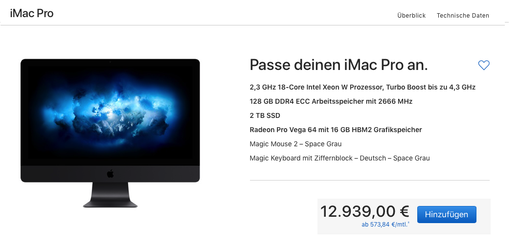

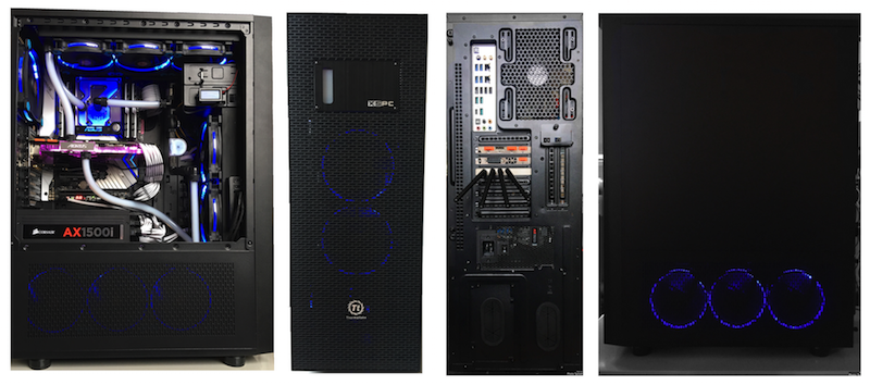

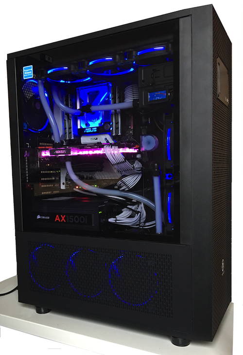

kgp Posted February 3, 2018 Author Share Posted February 3, 2018 iMacPro Hackintosh vs. iMacPro - System Overview and Cost Estimate Mainboard: Asus Prime X299 Deluxe [380€] CPU: i9-7980XE (18 core, 4.4Ghz) [1.900€] RAM Memory: Tridentz DDR-4 3200 Mhz 128GB (8x16GB) Kit (F4-3200C14Q2-128GTZSW) [1.400€] GPU: Gigabyte Aorus GTX 1080 Ti Waterforce WB Extreme Edition 11GB [900€] System Disks: EVO 960 NVMe M.2 1TB (system disk macOS High Sierra 10.13.3) [450€]; EVO 960 NVMe M.2 1TB (system disk macOS Sierra 10.12.6 Sierra) [450€] Power Supply: Corsair AX1500i [450€] Monitor: LG 38UC99-W 38" curved 21:9 Ultra Wide QHD+ IPS Display (3840 pix x 1600 pix) [1.350€] WebCam: Logitech C930e [80€] Mouse: Apple Magic Mouse 2 [75€] Keyboard: Apple Magic Keyboard Wireless [99€] Bluetooth + Wifi: PC/HACKINTOSH - APPLE BROADCOM BCM94360CD - 802.11 A/B/G/N/AC + BLUETOOTH 4.0 [129€] Internal USB2.0 HUB: NZXT AC-IUSBH-M1T [20€] Case: Thermaltake Core X71 Tempered Glass Edition Full Tower Chassis [140€] CPU/GPU Cooling: Water Cooling main components: - 1x EK-FB ASUS Prime X299 RGB Monoblock - Nickel [117€] - 1x EK-CoolStream PE 360 (Triple, 39 mm, Roof) [80€] - 1x EK-CoolStream Ce 280 (Dual, 45mm, Front) [90€] - 2x EK-CoolStream XE 360 (Triple, 60 mm, Cellar) [220€] - 1x XSPC Twin D5 Dual Bay Reservoir/Pump Combo [209€] - 15x Thermaltake Riing 12 High Static Pressure LED Radiator Fan (120mm) [210€] - 5x Thermaltake Riing 14 High Static Pressure LED Radiator Fan (140mm) [100€] - 3x Phantek PMW Fan Hub (up to 12 fans or 30W power consumption) [17€] - 1x Alphacool Eisflügel Flow Indicator Black G1/4 IG [16€] - 1x Phobya Temperatur Sensor G1/4 + C/F Display [22€] ----------- Total Cost: 8904€ ----------- Most of the components purchased at Amazon.de, Caseking.de, Mindfactory.de, Alernate.de Outstanding historical Benchmark Scores finally also depict the excellent overall build and and system performance: Geekbench i9-7980XE (4.8GHz) CPU Benchmark: Multi-Core Sore: 65.348 Single-Core Sore: 5.910 Cinebench i9-7980XE (4.8GHz) CPU Benchmark: 4.618 CB Geekbench Gigabyte Nvidia GeForce GTX 1080 Ti WaterForce WB 11GB Xtreme Edition OpenGL and Metal2 Benchmark: OpenGL Sore: 229.965 Metal 2 Sore : 242.393 Compared with: 2 Link to comment https://www.insanelymac.com/forum/topic/331658-how-to-build-your-own-imac-pro-successful-buildextended-guide/page/8/#findComment-2583485 Share on other sites More sharing options...
kgp Posted February 3, 2018 Author Share Posted February 3, 2018 I'll give that a try, but I don't see the patched BIOS? I had assumed it is locked because I need a Kernel patch in order to boot, which the ASUS X299s can drop after patching their BIOS. Perhaps E2 is not locked though, as I see this in bdmesg from clover boot log: (it should say locked, right?) 0:104 0:000 MSR 0xE2 before patch 00000400 0:104 0:000 MSR 0xCE 00070C2C_F3012300 0:104 0:000 MSR 0x1B0 00000000 With unlocked bios, you should get the correct return value of 0x7E000003 from the voltageshift check, but the latter check might anyway not reveal the proper result because you say that you can't disable the core scope kernel patch, which further supports the conclusion that your BIOS is locked. Take note, that you might just inadequately apply UEFIPatch... You exactly have to follow the approach as described in my guide. Everything, i.e. UEFIPatch, X29KSA1.40 and patches.txt have to be in the UEFIpatch directory on your Desktop! Then you just execute the BIOS patch procedure with the following terminal commands: cd ~/Desktop/UEFIPatch/ ./UEFIPatch X29KSA1.40 This should definitely unlock your BIOS. BTW, your BIOS Firmware does not have the the file name extension .CAP? With the filename extension .40, would it be compatible with UEFiPatch at all? 1 Link to comment https://www.insanelymac.com/forum/topic/331658-how-to-build-your-own-imac-pro-successful-buildextended-guide/page/8/#findComment-2583929 Share on other sites More sharing options...
Loloflat6 Posted February 4, 2018 Share Posted February 4, 2018 Thank's Kgp , I tried but : laurents-imac-pro:UEFIPatch laurent$ cd ~/Desktop/UEFIPatch/ laurents-imac-pro:UEFIPatch laurent$ ./UEFIPatch X29KSA1.40 parseSection: decompression failed with error "Standard decompression failed" parseFile: non-empty pad-file contents will be destroyed after volume modifications patch: replaced 8 bytes at offset 34A5h 81E10080000033C1 -> 9090909090909090 patch: replaced 8 bytes at offset 1522h BE0080000023CE0B -> BE0000000023CE0B reconstructSection: executable section rebase failed Error , laurents-imac-pro:UEFIPatch laurent$ My bios file X299UD4.F4 have 16,8 MO and is larger as Asus Deluxe witch have 8,9 MO. Link to comment https://www.insanelymac.com/forum/topic/331658-how-to-build-your-own-imac-pro-successful-buildextended-guide/page/8/#findComment-2584523 Share on other sites More sharing options...
kgp Posted February 4, 2018 Author Share Posted February 4, 2018 Thank's Kgp , I tried but : laurents-imac-pro:UEFIPatch laurent$ cd ~/Desktop/UEFIPatch/ laurents-imac-pro:UEFIPatch laurent$ ./UEFIPatch X29KSA1.40 parseSection: decompression failed with error "Standard decompression failed" parseFile: non-empty pad-file contents will be destroyed after volume modifications patch: replaced 8 bytes at offset 34A5h 81E10080000033C1 -> 9090909090909090 patch: replaced 8 bytes at offset 1522h BE0080000023CE0B -> BE0000000023CE0B reconstructSection: executable section rebase failed Error , laurents-imac-pro:UEFIPatch laurent$ My bios file X299UD4.F4 have 16,8 MO and is larger as Asus Deluxe witch have 8,9 MO. I guess that the ASUS BIOS Firmware Patching cannot be directly applied on Gigabyte BIOS Firmware, sorry.. 1 Link to comment https://www.insanelymac.com/forum/topic/331658-how-to-build-your-own-imac-pro-successful-buildextended-guide/page/8/#findComment-2584540 Share on other sites More sharing options...
