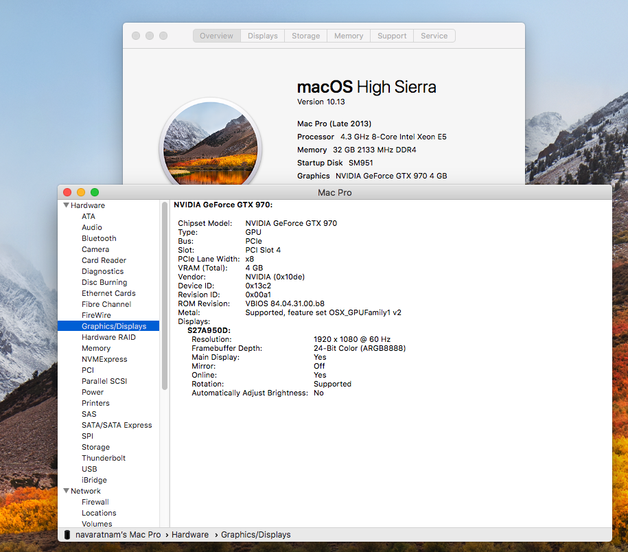

xtddd Posted September 30, 2017 Share Posted September 30, 2017 GTX 970 Its worked with HDMI Displayport black screen. 1-Disabled NV kext via config ( nv_disable=1) 2-Install the original version of the AppleGraphicsControl.kext 3- InstallNVIDIA 10.13 WebDriver package. 4-Enable NV graphics remove this nv_disable=1 5-Add clover config Disable board-id check to prevent no signal © lvs1974, Pike R. Alpha, vit9696 Find BA050000 00 Replace BA000000 00 Name com.apple.driver.AppleGraphicsDevicePolicy 6-Install this kexts to EFI Lilu.kext NvidiaGraphicsFixup.kext NVWebDriverLibValFix.kext 7.Restart with HDMI cable. 8-Final press space bar thick don't reboot on panic this debug is fixed black screen. NvidiaGraphicsFixup.kext is not needed if you apply this patch For my setup, it seemed that having 10-bit color set in macOS caused it to go black. Once I changed to a different resolution, the color depth reset to 24-bit and I could see everything again. It may just be my setup, perhaps. What does System Profiler/Graphics report your display color depth as? Mine is 24-Bit Color (ARGB8888) Mine is also 24-Bit Color (ARGB8888) 1 Link to comment https://www.insanelymac.com/forum/topic/324195-nvidia-web-driver-updates-for-macos-high-sierra-update-nov-13-2020/page/14/#findComment-2504899 Share on other sites More sharing options...
Badruzeus Posted September 30, 2017 Share Posted September 30, 2017 ... Mine is also 24-Bit Color (ARGB8888) 24-bit is just another name for 32-bit, both are same as seen also on Linux Display; it' s about naming and no more... 1 Link to comment https://www.insanelymac.com/forum/topic/324195-nvidia-web-driver-updates-for-macos-high-sierra-update-nov-13-2020/page/14/#findComment-2504902 Share on other sites More sharing options...
corint1 Posted September 30, 2017 Share Posted September 30, 2017 hdmi sound?... how enable hdmi sound ?... using different patches and kext I have image on screen but no sound on hdmi ...please help ... 1050 ti 4 gb Link to comment https://www.insanelymac.com/forum/topic/324195-nvidia-web-driver-updates-for-macos-high-sierra-update-nov-13-2020/page/14/#findComment-2504939 Share on other sites More sharing options...
Leisures Posted September 30, 2017 Share Posted September 30, 2017 24-bit is just another name for 32-bit, both are same as seen also on Linux Display; it' s about naming and no more... so changing it before high sierra whas doing nothing? ....it didnt look like. its a 8 bits vs 10 bits deep colors.. Link to comment https://www.insanelymac.com/forum/topic/324195-nvidia-web-driver-updates-for-macos-high-sierra-update-nov-13-2020/page/14/#findComment-2504972 Share on other sites More sharing options...
Badruzeus Posted September 30, 2017 Share Posted September 30, 2017 so changing it before high sierra whas doing nothing? ....it didnt look like. its a 8 bits vs 10 bits deep colors.. Uhmmb, not really sure then.. I don't see any difference between two, FYI this change was there since 10.12.x afaik. Link to comment https://www.insanelymac.com/forum/topic/324195-nvidia-web-driver-updates-for-macos-high-sierra-update-nov-13-2020/page/14/#findComment-2504977 Share on other sites More sharing options...

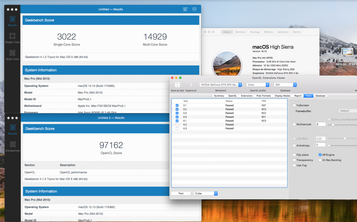

@ROBASEFR Posted September 30, 2017 Share Posted September 30, 2017 Success here with GTX 970 Gainward phantom With latest Clover configurator 4.52: System Parameters: NvidiaWeb:true and InjectSystem ID:true in EFI/Clover/kexts/10.13 -Lilu.kext -NvidiaGraphicsFixup.kext -NVWebDriverLibValFix.kext 1 Link to comment https://www.insanelymac.com/forum/topic/324195-nvidia-web-driver-updates-for-macos-high-sierra-update-nov-13-2020/page/14/#findComment-2505140 Share on other sites More sharing options...
MICKHAEL Posted September 30, 2017 Share Posted September 30, 2017 Success here with GTX 970 Gainward phantom With latest Clover configigurator 4.52: System Parameters: NvidiaWeb:true and InjectSystem ID:true in EFI/Clover/kexts/10.13 -Lilu.kext -NvidiaGraphicsFixup.kext -NVWebDriverLibValFix.kext what type of cable you use? Link to comment https://www.insanelymac.com/forum/topic/324195-nvidia-web-driver-updates-for-macos-high-sierra-update-nov-13-2020/page/14/#findComment-2505217 Share on other sites More sharing options...
Luminadevapps Posted September 30, 2017 Share Posted September 30, 2017 NvidiaGraphicsFixup.kext is not needed if you apply this patch Mine is also 24-Bit Color (ARGB8888) I used nvram.plist too. Link to comment https://www.insanelymac.com/forum/topic/324195-nvidia-web-driver-updates-for-macos-high-sierra-update-nov-13-2020/page/14/#findComment-2505226 Share on other sites More sharing options...
@ROBASEFR Posted September 30, 2017 Share Posted September 30, 2017 what type of cable you use? I use HDMI or DVI-D Link to comment https://www.insanelymac.com/forum/topic/324195-nvidia-web-driver-updates-for-macos-high-sierra-update-nov-13-2020/page/14/#findComment-2505346 Share on other sites More sharing options...
