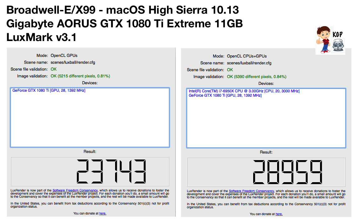

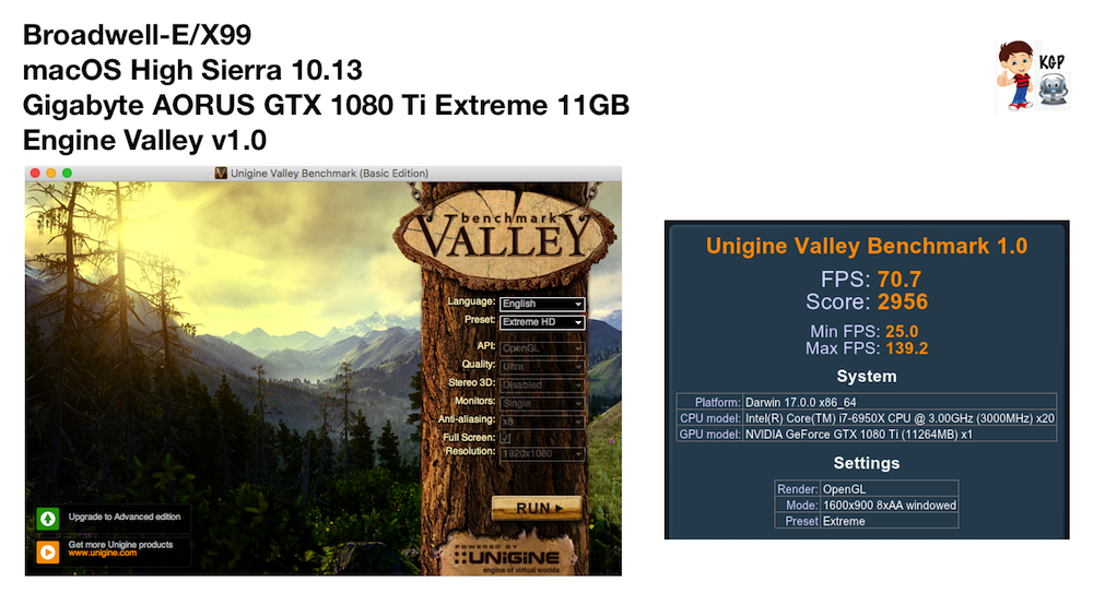

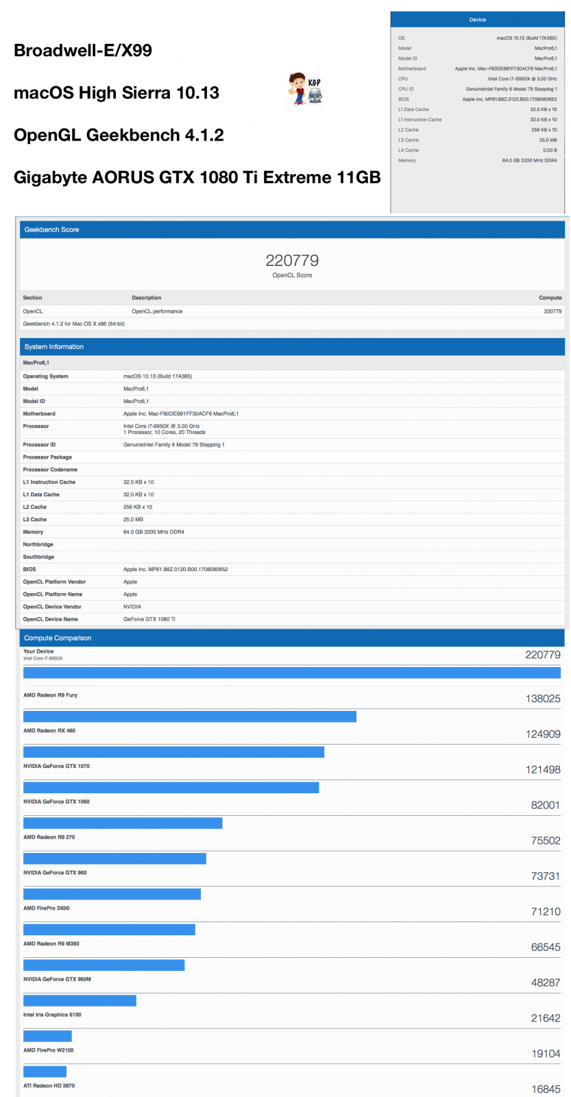

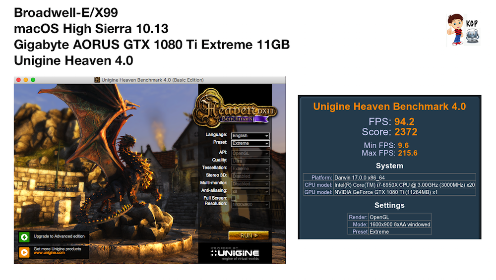

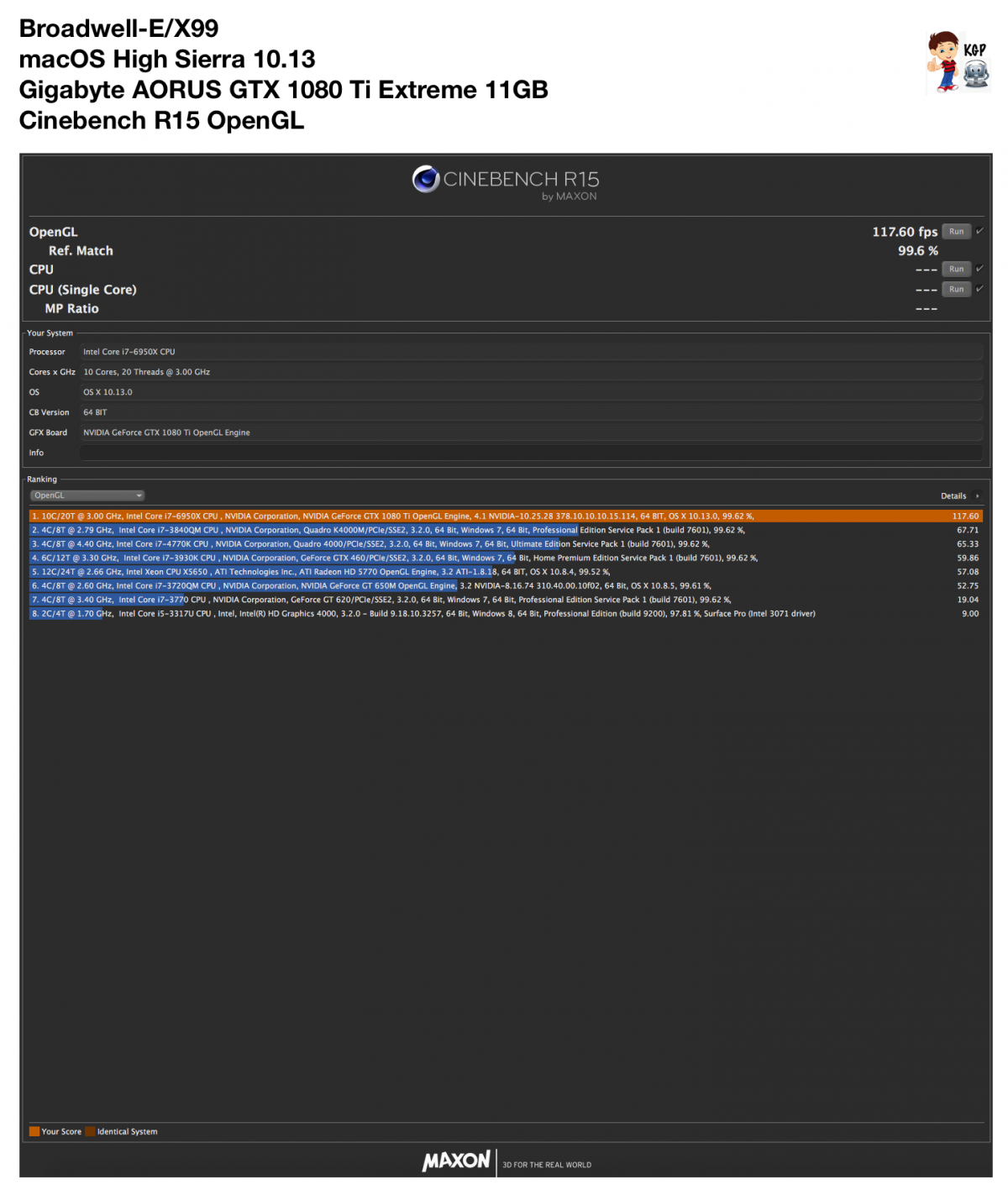

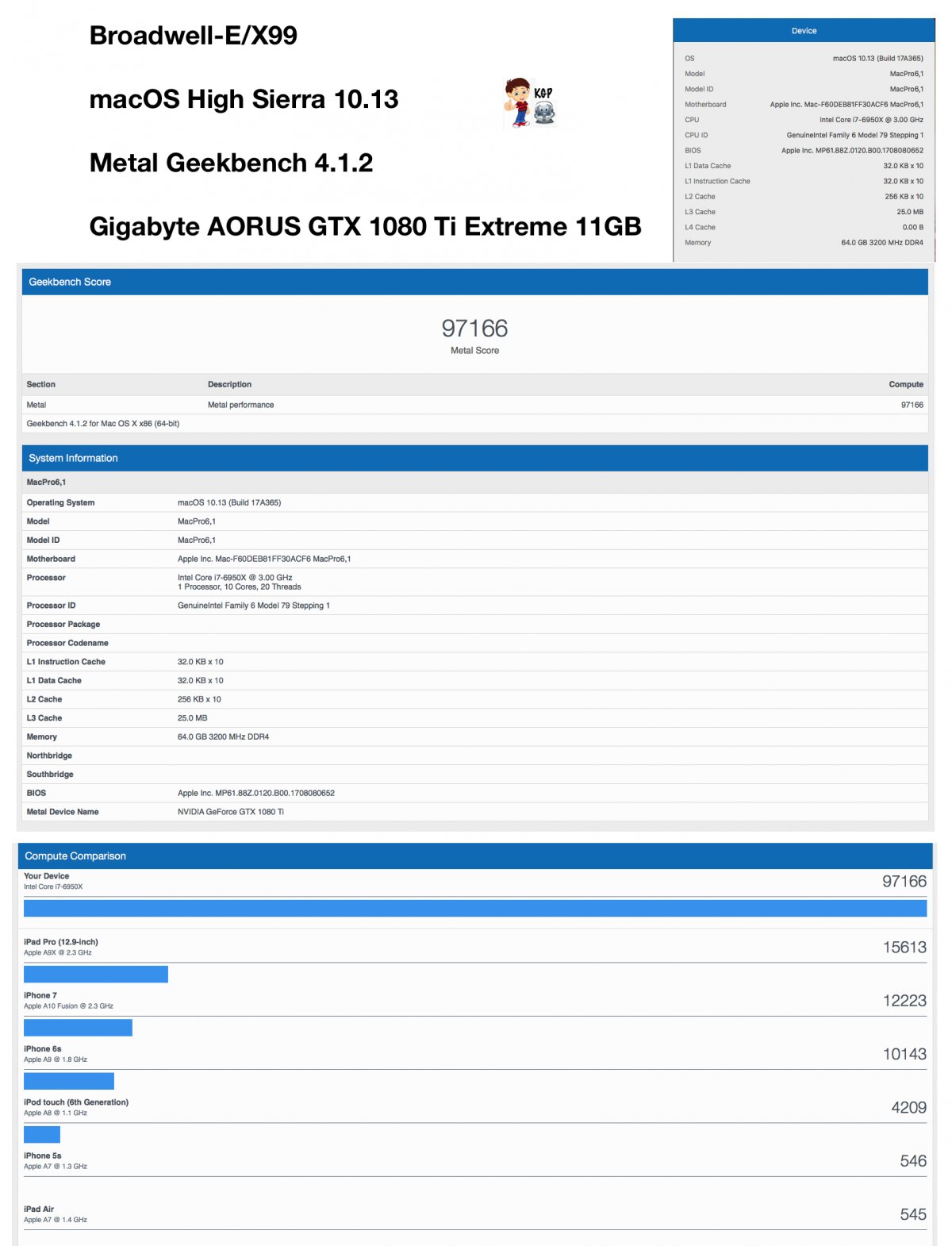

kgp Posted September 27, 2017 Share Posted September 27, 2017 Gigabyte AORUS GTX 1080 Ti Extreme 11GB - macOS High Sierra 10.13 - Benchmarks System: SMBIOS macPro6,1 Broadwell-E/X99; i7-6950X; ASUS X99-A II 64GB TridentZ 3200 MHz Link to comment https://www.insanelymac.com/forum/topic/324195-nvidia-web-driver-updates-for-macos-high-sierra-update-nov-13-2020/page/12/#findComment-2502233 Share on other sites More sharing options...

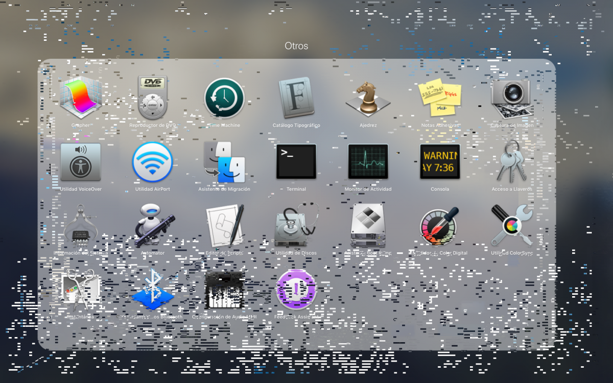

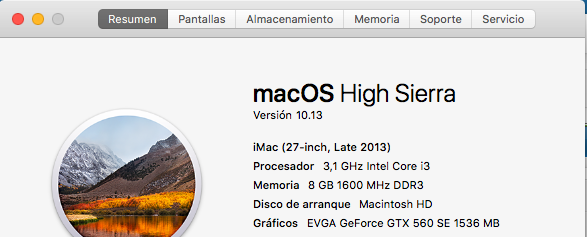

williamzorak Posted September 27, 2017 Share Posted September 27, 2017 hi, i have a evga gtx560 wich didnt have any problem with 10.12 or 10.11, but i have artifacts with high sierra. Most of the times the artifacts come when i put a video from youtube on fullscreen and exit fullscreen. If i put the machine to sleep or change resolution, artifacts are completely gone for a few minutes. tried official drivers and also nvidia webdriver which came out yesterday, have no problems with additional kexts like nvwebdriverlibvalfix.kext or nvidiagraphicsfixup and agdpfix, no black screens at boot, i can confirm that webdriver is working, but the artifacts are the same with those drivers or the official ones. Also played around with applegraphicspowermanagement.kext but nothing changes. Im out of ideas, any help please? thanks in advance!! Link to comment https://www.insanelymac.com/forum/topic/324195-nvidia-web-driver-updates-for-macos-high-sierra-update-nov-13-2020/page/12/#findComment-2502394 Share on other sites More sharing options...
