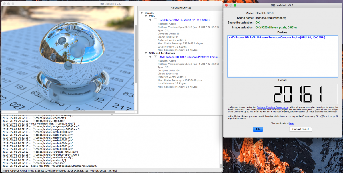

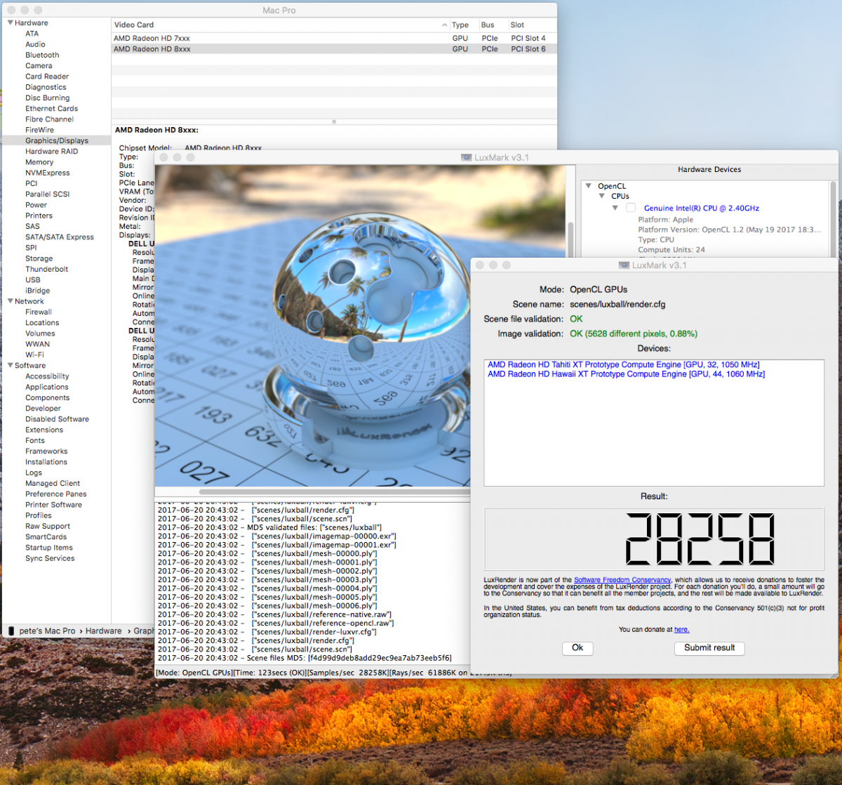

surfinchina Posted June 20, 2017 Share Posted June 20, 2017 Just tried daisy chaining monitors. DP 1.2 still doesn't work. A bit of a shame. On the plus side I plugged in my R9 390x and it worked oob. nothing ticked at all, it's coming up 0x67b01002 with 44 compute units Still needs the helper card or an igpu of course. Luxmark is coming in way higher than the other computer with the R9 Nano - 28250 vs 20100, whereas the other benchmarks such as CB are slower. Leading me to believe that Luxmark is using the 7970 helper card to help. Link to comment https://www.insanelymac.com/forum/topic/324194-pre-release-macos-high-sierra/page/38/#findComment-2448020 Share on other sites More sharing options...
