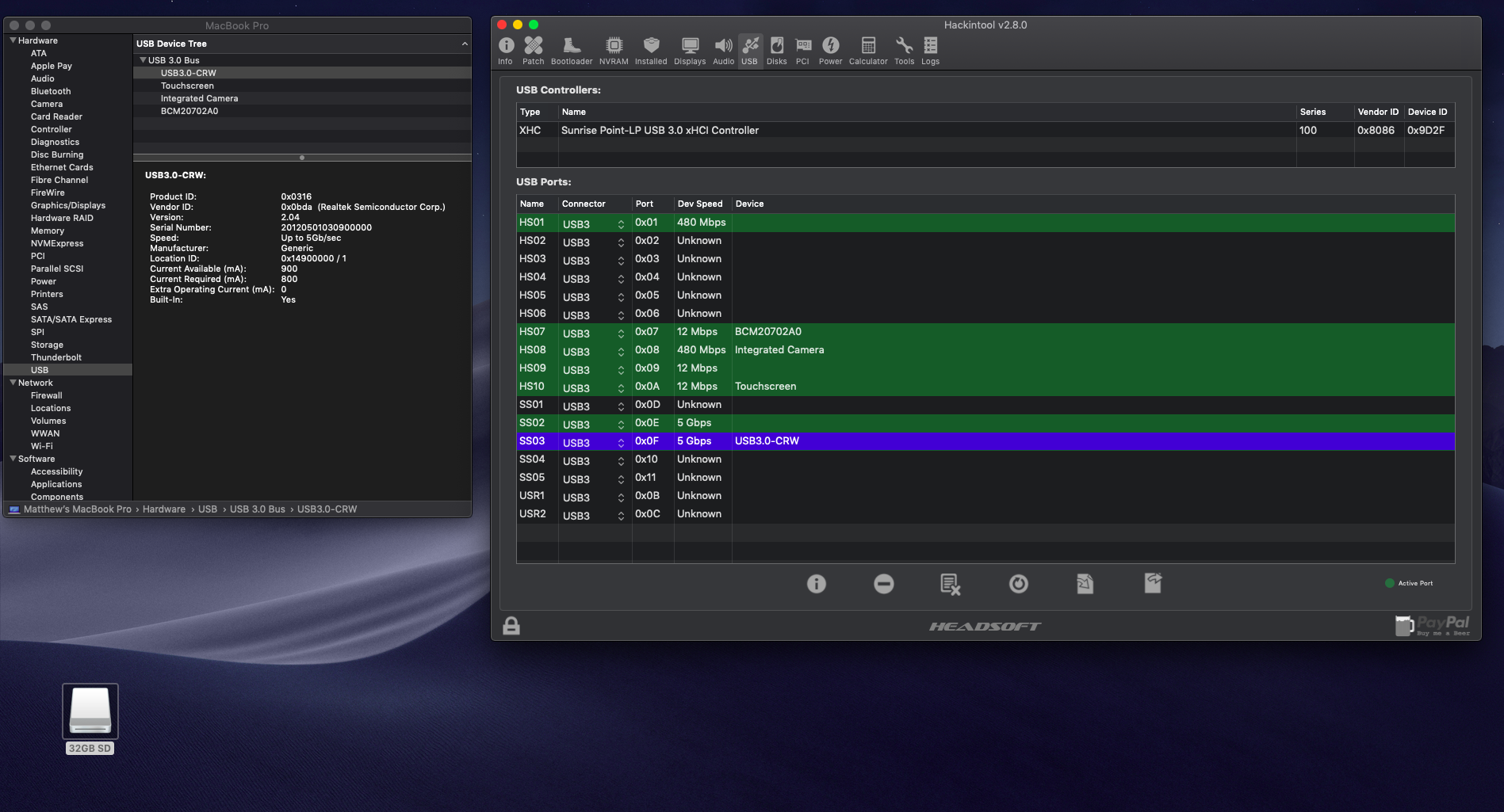

wriggles Posted December 2, 2019 Share Posted December 2, 2019 (edited) Thanks a lot @tluckfor your continuing help. Your old kext (and the SSDT) does indeed solve the problem, but the reason I did not originally use it is because it produces very jerky and imprecise movement with the trackpoint. However, I worked out that I had an incorrect ACPI path for my PS2 controller in the SSDT and, by correcting this, I now have perfect Trackpoint and Clickpad function with Acidanthera's latest version of VoodooPS2 (2.1.0). With that, I now have a perfectly functioning, dual-booting T470 Hackintosh: - Wifi and bluetooth (with a DW1560 card) - SD card reader (no kext required) - Display brightness etc. - Battery life comparable to Windows - CPU power management - USB, USB-C and USB-C charging - Clickpad and Trackpoint. Thanks a lot to you and everyone else in this thread for helping me to build this. Edited December 3, 2019 by wriggles 1 Link to comment https://www.insanelymac.com/forum/topic/315451-guide-lenovo-t460t470-macos-with-clover-and-opencore/page/39/#findComment-2699404 Share on other sites More sharing options...
pure.wisdom Posted December 3, 2019 Share Posted December 3, 2019 23 hours ago, wriggles said: Thanks a lot @tluckfor your continuing help. Your old kext (and the SSDT) does indeed solve the problem, but the reason I did not originally use it is because it produces very jerky and imprecise movement with the trackpoint. However, I worked out that I had an incorrect ACPI path for my PS2 controller in the SSDT and, by correcting this, I now have perfect Trackpoint and Clickpad function with Acidanthera's latest version of VoodooPS2 (2.1.0). With that, I now have a perfectly functioning, dual-booting T470 Hackintosh: - Wifi and bluetooth (with a DW1560 card) - SD card reader (no kext required) - Display brightness etc. - Battery life comparable to Windows - CPU power management - USB, USB-C and USB-C charging - Clickpad and Trackpoint. Thanks a lot to you and everyone else in this thread for helping me to build this. I have issue with the Capslock's light with lastest version voodoops2. How you use sd card reader without kext? thanks Link to comment https://www.insanelymac.com/forum/topic/315451-guide-lenovo-t460t470-macos-with-clover-and-opencore/page/39/#findComment-2699519 Share on other sites More sharing options...
tluck Posted December 4, 2019 Author Share Posted December 4, 2019 On 12/2/2019 at 12:20 PM, wriggles said: Thanks a lot @tluckfor your continuing help. Your old kext (and the SSDT) does indeed solve the problem, but the reason I did not originally use it is because it produces very jerky and imprecise movement with the trackpoint. However, I worked out that I had an incorrect ACPI path for my PS2 controller in the SSDT and, by correcting this, I now have perfect Trackpoint and Clickpad function with Acidanthera's latest version of VoodooPS2 (2.1.0). With that, I now have a perfectly functioning, dual-booting T470 Hackintosh: - Wifi and bluetooth (with a DW1560 card) - SD card reader (no kext required) - Display brightness etc. - Battery life comparable to Windows - CPU power management - USB, USB-C and USB-C charging - Clickpad and Trackpoint. Thanks a lot to you and everyone else in this thread for helping me to build this. Great. if you have any updates to T470 ACPI/DSDT/SSDT set, I can update the repo accordingly. Link to comment https://www.insanelymac.com/forum/topic/315451-guide-lenovo-t460t470-macos-with-clover-and-opencore/page/39/#findComment-2699550 Share on other sites More sharing options...
carlinyos Posted December 4, 2019 Share Posted December 4, 2019 On 12/2/2019 at 9:20 PM, wriggles said: Thanks a lot @tluckfor your continuing help. Your old kext (and the SSDT) does indeed solve the problem, but the reason I did not originally use it is because it produces very jerky and imprecise movement with the trackpoint. However, I worked out that I had an incorrect ACPI path for my PS2 controller in the SSDT and, by correcting this, I now have perfect Trackpoint and Clickpad function with Acidanthera's latest version of VoodooPS2 (2.1.0). With that, I now have a perfectly functioning, dual-booting T470 Hackintosh: - Wifi and bluetooth (with a DW1560 card) - SD card reader (no kext required) - Display brightness etc. - Battery life comparable to Windows - CPU power management - USB, USB-C and USB-C charging - Clickpad and Trackpoint. Thanks a lot to you and everyone else in this thread for helping me to build this. How did you manage to have your sdcard reader working?? Link to comment https://www.insanelymac.com/forum/topic/315451-guide-lenovo-t460t470-macos-with-clover-and-opencore/page/39/#findComment-2699634 Share on other sites More sharing options...
torch2k Posted December 5, 2019 Share Posted December 5, 2019 Hi @tluck, first of all: THANK you for putting this together. I just got my t470s today. I have a couple of questions: 1. I installed Mojave on APFS which I am fine with. Can I skip #3 (Convert the Logical volume to Physical volume (for HFS))? 2. I don't understand step 4b. I ran the install_clover_scripts.cmd, but when I run "sudo mount -t msdos...", msdos doesn't exist. Is that a mistake/typo? 3. I created a custom DSDT using your scripts, but then the laptop doesn't seem to work right on the next reboot. I think maybe it has something to do with the step above I just mentioned. Thanks in advance for any help! Link to comment https://www.insanelymac.com/forum/topic/315451-guide-lenovo-t460t470-macos-with-clover-and-opencore/page/39/#findComment-2699650 Share on other sites More sharing options...
robored Posted December 5, 2019 Share Posted December 5, 2019 Is 4K/60Hz working with the T460 (via mini-DP to DP) in MacOS? Tried to hackintosh my T450s but it wouldn't work with an external 4K display (only getting 1440p max), maybe HD4000 wasn't up to par or DVMT was too low. If 4K/60Hz works with the T460 without flashing custom bios to change the DVMT, I might upgrade. Thanks! Link to comment https://www.insanelymac.com/forum/topic/315451-guide-lenovo-t460t470-macos-with-clover-and-opencore/page/39/#findComment-2699713 Share on other sites More sharing options...
lml Posted December 5, 2019 Share Posted December 5, 2019 Is 4K/60Hz working with the T460 (via mini-DP to DP) in MacOS? Tried to hackintosh my T450s but it wouldn't work with an external 4K display (only getting 1440p max), maybe HD4000 wasn't up to par or DVMT was too low. If 4K/60Hz works with the T460 without flashing custom bios to change the DVMT, I might upgrade. Thanks! Unfortunately it doesn't work. At least not for me. Link to comment https://www.insanelymac.com/forum/topic/315451-guide-lenovo-t460t470-macos-with-clover-and-opencore/page/39/#findComment-2699734 Share on other sites More sharing options...
tluck Posted December 6, 2019 Author Share Posted December 6, 2019 On 12/4/2019 at 8:44 PM, torch2k said: Hi @tluck, first of all: THANK you for putting this together. I just got my t470s today. I have a couple of questions: 1. I installed Mojave on APFS which I am fine with. Can I skip #3 (Convert the Logical volume to Physical volume (for HFS))? 2. I don't understand step 4b. I ran the install_clover_scripts.cmd, but when I run "sudo mount -t msdos...", msdos doesn't exist. Is that a mistake/typo? 3. I created a custom DSDT using your scripts, but then the laptop doesn't seem to work right on the next reboot. I think maybe it has something to do with the step above I just mentioned. Thanks in advance for any help! 1) you can skip when using APFS 2) if you cut/paste there could be odd formatting chars in there. step 4 (4b) the purpose is put the EFI Clover package onto your HD/SSD into the ESP partition so you don't need the USB anymore. sudo mkdir /Volumes/ESP sudo mount -t msdos /dev/disk0s1 /Volumes/ESP 3) step 4c - means replace the original ACPI/patched (DSDT/SSDT) files with the custom ones you just created (but maybe the ones in the zip will work fine.) presuming perhaps started with the DSDT.T470 files? so gain mount the ESP via commands above (or use the espmount.bash script I provide) copy the zip the ESP and then update with your files. Link to comment https://www.insanelymac.com/forum/topic/315451-guide-lenovo-t460t470-macos-with-clover-and-opencore/page/39/#findComment-2699758 Share on other sites More sharing options...
wriggles Posted December 6, 2019 Share Posted December 6, 2019 (edited) On 12/4/2019 at 9:11 PM, carlinyos said: How did you manage to have your sdcard reader working?? It just works natively as a USB device. No kexts or tweaks needed. Make sure you haven't disabled it in SSDT-XHC-T470.dsl. Edited December 6, 2019 by wriggles 1 Link to comment https://www.insanelymac.com/forum/topic/315451-guide-lenovo-t460t470-macos-with-clover-and-opencore/page/39/#findComment-2699774 Share on other sites More sharing options...
pure.wisdom Posted December 7, 2019 Share Posted December 7, 2019 On 12/6/2019 at 6:56 AM, wriggles said: It just works natively as a USB device. No kexts or tweaks needed. Make sure you haven't disabled it in SSDT-XHC-T470.dsl. SDcard is maybe native on 10.15.1. I just remove sdcard.kext and it still work good Link to comment https://www.insanelymac.com/forum/topic/315451-guide-lenovo-t460t470-macos-with-clover-and-opencore/page/39/#findComment-2699878 Share on other sites More sharing options...
Styxie Posted December 8, 2019 Share Posted December 8, 2019 Too bad the SD card is PCI-E on T460, I would've really liked native SD card reader support! 1 Link to comment https://www.insanelymac.com/forum/topic/315451-guide-lenovo-t460t470-macos-with-clover-and-opencore/page/39/#findComment-2699955 Share on other sites More sharing options...
igormclven Posted December 12, 2019 Share Posted December 12, 2019 On 12/6/2019 at 7:56 AM, wriggles said: It just works natively as a USB device. No kexts or tweaks needed. Make sure you haven't disabled it in SSDT-XHC-T470.dsl. That's good. I see that you have overcome several problems that I still have. Could you please share your EFI folder with us? Thank you very much. Link to comment https://www.insanelymac.com/forum/topic/315451-guide-lenovo-t460t470-macos-with-clover-and-opencore/page/39/#findComment-2700321 Share on other sites More sharing options...

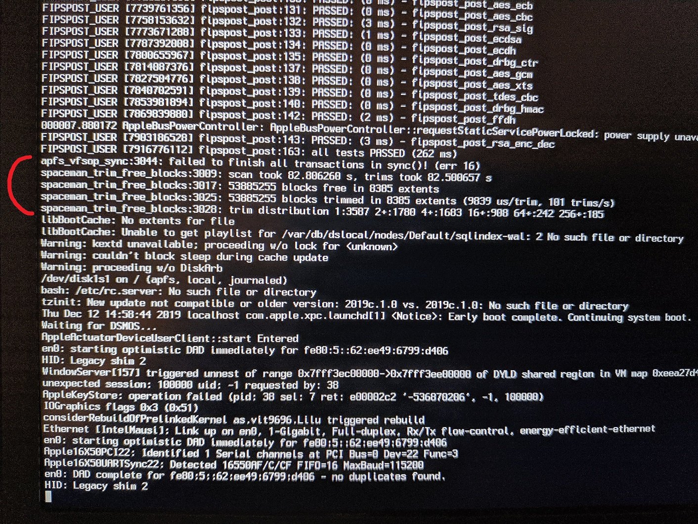

yokarlos3 Posted December 13, 2019 Share Posted December 13, 2019 Hello, I recently installed High Sierra and Catalina in a T460s and with both OS I'm getting a slow boot because the 'spaceman_trim_free_blocks' task takes more than a minute to complete on every reboot. It looks like there are tons of blocks to trim (~53885255). This also happens with just turning on the computer and restarting. However, if I disable Trim in the clover config.plist, booting is fast. I also noticed that erasing the disk or creating partitions with DiskUtil also takes several minutes when Trim is enabled, or just a couple of seconds if it's disabled. The disk model is INTEL SSDSCKGF240A5L and BIOS N1CET78W (1.46). I'm also using the EFI folder from tluck's github. Is anyone experiencing this issue? Regards Link to comment https://www.insanelymac.com/forum/topic/315451-guide-lenovo-t460t470-macos-with-clover-and-opencore/page/39/#findComment-2700469 Share on other sites More sharing options...
