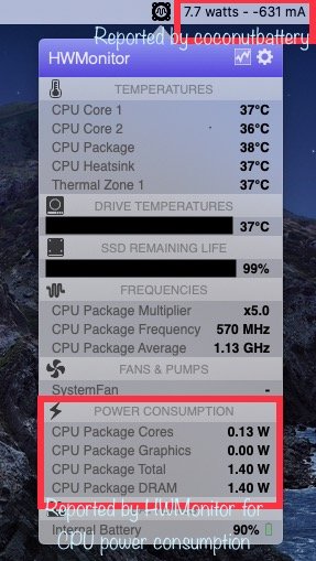

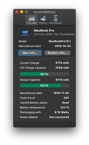

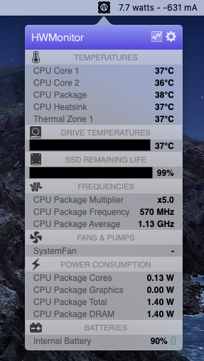

nijhawank Posted January 5, 2020 Share Posted January 5, 2020 (edited) @junaed.rx @adaml75 Just want to be sure that I'm having the best possible battery life. I tried all options... 1. tluck's original X86PlatformPluginInjector 2. CPUFriend with data generated from CPUFriendFriend (using CPUFriend and CPUFriendDataProvider kexts under /LibraryExtensions 3. CPUFriend with ssdt_data.aml generated with CPUFriendFriend to /e/c/a/patched (removed original SSDT-CPU.aml from tluck's patch) However, with all options the lowest I can go to is around 7.5 - 8w. See the screenshot, do you think this is the ideal or there's something wrong? What is your average lowest power consumption? This is while typing this and nothing else running and it has been a while since I booted it, with around 75% brightness. Edited January 5, 2020 by nijhawank Link to comment https://www.insanelymac.com/forum/topic/315451-guide-lenovo-t460t470-macos-with-clover-and-opencore/page/40/#findComment-2702958 Share on other sites More sharing options...

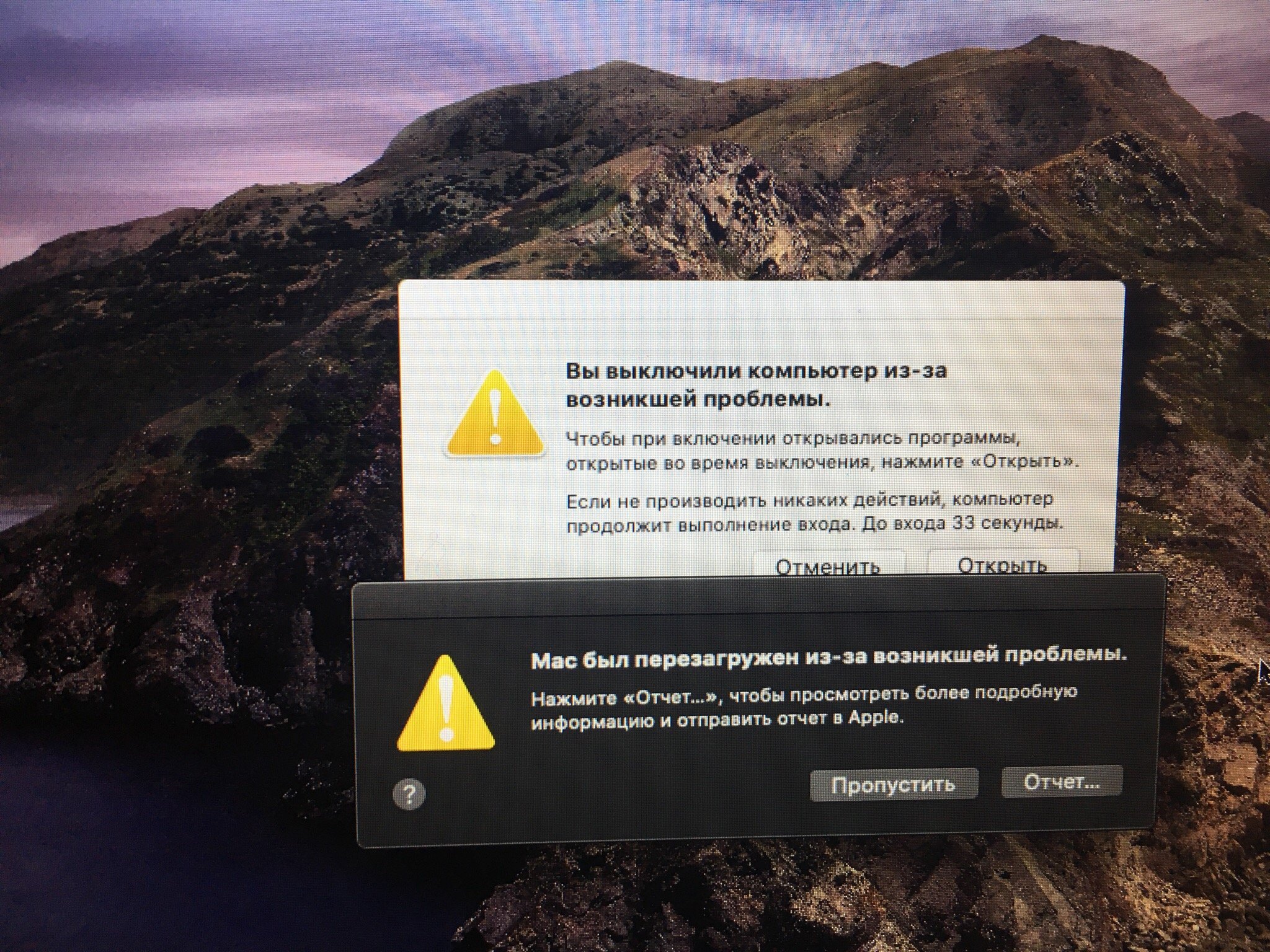

poison44rus Posted January 5, 2020 Share Posted January 5, 2020 Hello !! help me please!! I don’t speak English, so write simpler. Link to comment https://www.insanelymac.com/forum/topic/315451-guide-lenovo-t460t470-macos-with-clover-and-opencore/page/40/#findComment-2702963 Share on other sites More sharing options...
poison44rus Posted January 5, 2020 Share Posted January 5, 2020 (edited) Я скопировал файлы отсюда /Users/evgen/Downloads/Lenovo-T460-Clover-2019.11.25/DSDT.T460 и перенес их сюда / Тома / ESP / EFI / CLOVER / ACPI / patched это сработало !! но при загрузке вот такая ошибка каждый раз !! ошибка.rtf Спойлер Edited January 5, 2020 by poison44rus Link to comment https://www.insanelymac.com/forum/topic/315451-guide-lenovo-t460t470-macos-with-clover-and-opencore/page/40/#findComment-2702968 Share on other sites More sharing options...

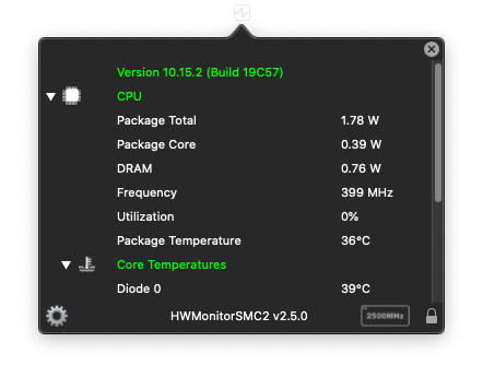

junaed.rx Posted January 5, 2020 Share Posted January 5, 2020 6 hours ago, nijhawank said: @junaed.rx @adaml75 Just want to be sure that I'm having the best possible battery life. I tried all options... 1. tluck's original X86PlatformPluginInjector 2. CPUFriend with data generated from CPUFriendFriend (using CPUFriend and CPUFriendDataProvider kexts under /LibraryExtensions 3. CPUFriend with ssdt_data.aml generated with CPUFriendFriend to /e/c/a/patched (removed original SSDT-CPU.aml from tluck's patch) However, with all options the lowest I can go to is around 7.5 - 8w. See the screenshot, do you think this is the ideal or there's something wrong? What is your average lowest power consumption? This is while typing this and nothing else running and it has been a while since I booted it, with around 75% brightness. Hi @nijhawank, Here is my cpu idle activity. It certainly Between 1.5 to 2 in idle condition. Yours feels little Bit up. I think SSDT-CPU is required to inject plugintype with CPUFriend kext. Link to comment https://www.insanelymac.com/forum/topic/315451-guide-lenovo-t460t470-macos-with-clover-and-opencore/page/40/#findComment-2703011 Share on other sites More sharing options...
nijhawank Posted January 5, 2020 Share Posted January 5, 2020 2 hours ago, junaed.rx said: Hi @nijhawank, Here is my cpu idle activity. It certainly Between 1.5 to 2 in idle condition. Yours feels little Bit up. I think SSDT-CPU is required to inject plugintype with CPUFriend kext. Plugin-type = One is also injected by the SSDT generated by CPUFriendFriend and I guess having both tluck’s original SSDT-CPU along with the one generated by CPUFriendFriend will result in duplicate stuff. regarding the power consumption, can you report your power consumption from coconutbattery app. It would be available once you go to preferences and configure it to report power consumption in the top menu bar. The 7-8 watts is what reported as my system power consumption by coconutbattery and if you only talk about CPU package total that is 1.40 watts as displayed by the HWMonitor in the screenshot Link to comment https://www.insanelymac.com/forum/topic/315451-guide-lenovo-t460t470-macos-with-clover-and-opencore/page/40/#findComment-2703030 Share on other sites More sharing options...
junaed.rx Posted January 5, 2020 Share Posted January 5, 2020 46 minutes ago, nijhawank said: Plugin-type = One is also injected by the SSDT generated by CPUFriendFriend and I guess having both tluck’s original SSDT-CPU along with the one generated by CPUFriendFriend will result in duplicate stuff. regarding the power consumption, can you report your power consumption from coconutbattery app. It would be available once you go to preferences and configure it to report power consumption in the top menu bar. The 7-8 watts is what reported as my system power consumption by coconutbattery and if you only talk about CPU package total that is 1.40 watts as displayed by the HWMonitor in the screenshot Mine is discharging faster than yours. I think this is normal. Link to comment https://www.insanelymac.com/forum/topic/315451-guide-lenovo-t460t470-macos-with-clover-and-opencore/page/40/#findComment-2703036 Share on other sites More sharing options...
