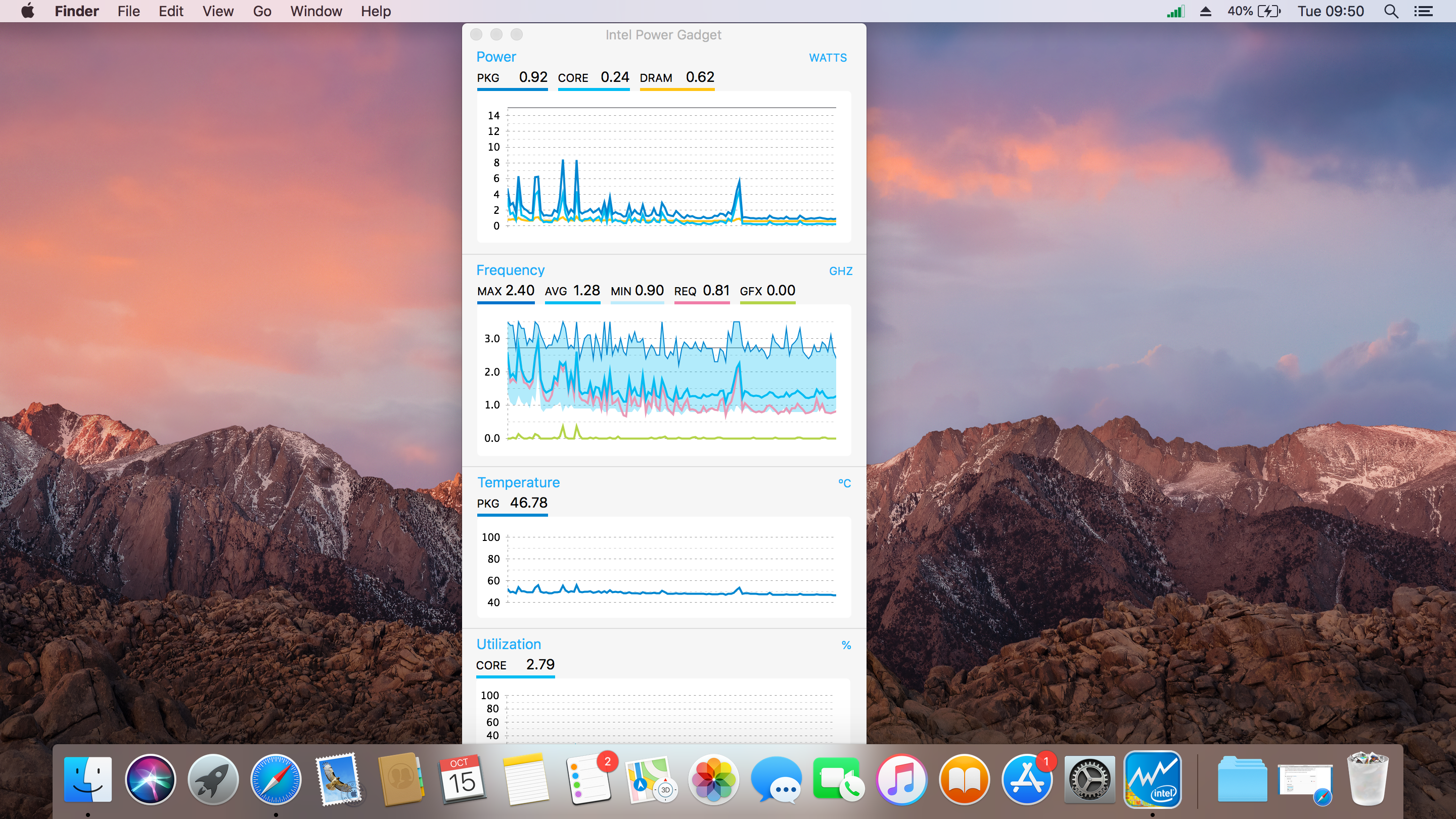

junaed.rx Posted October 21, 2019 Share Posted October 21, 2019 X86platformplugininject Not loading on catalina. Anyone know how can I fix this. Getting very bad p states Spoiler P-State ratio * 100 = Frequency in MHz ------------------------------------------ CPU P-States [ 18 (24) 28 ] iGPU P-States [ (6) ] CPU C3-Cores [ 1 2 3 ] CPU C7-Cores [ 0 1 2 3 ] CPU P-States [ 18 20 24 (27) 28 ] iGPU P-States [ (6) ] CPU C3-Cores [ 0 1 2 3 ] CPU P-States [ 18 20 24 (26) 27 28 ] iGPU P-States [ (6) ] CPU P-States [ 18 20 24 (25) 26 27 28 ] iGPU P-States [ (6) ] CPU P-States [ 18 20 24 (25) 26 27 28 ] iGPU P-States [ 6 ] CPU P-States [ 18 20 (23) 24 25 26 27 28 ] iGPU P-States [ 6 ] CPU P-States [ (13) 18 20 23 24 25 26 27 28 ] iGPU P-States [ 6 ] Link to comment https://www.insanelymac.com/forum/topic/315451-guide-lenovo-t460t470-macos-with-clover-and-opencore/page/36/#findComment-2694504 Share on other sites More sharing options...
nijhawank Posted October 22, 2019 Share Posted October 22, 2019 On 10/21/2019 at 9:41 AM, junaed.rx said: X86platformplugininject Not loading on catalina. Anyone know how can I fix this. Getting very bad p states Reveal hidden contents P-State ratio * 100 = Frequency in MHz ------------------------------------------ CPU P-States [ 18 (24) 28 ] iGPU P-States [ (6) ] CPU C3-Cores [ 1 2 3 ] CPU C7-Cores [ 0 1 2 3 ] CPU P-States [ 18 20 24 (27) 28 ] iGPU P-States [ (6) ] CPU C3-Cores [ 0 1 2 3 ] CPU P-States [ 18 20 24 (26) 27 28 ] iGPU P-States [ (6) ] CPU P-States [ 18 20 24 (25) 26 27 28 ] iGPU P-States [ (6) ] CPU P-States [ 18 20 24 (25) 26 27 28 ] iGPU P-States [ 6 ] CPU P-States [ 18 20 (23) 24 25 26 27 28 ] iGPU P-States [ 6 ] CPU P-States [ (13) 18 20 23 24 25 26 27 28 ] iGPU P-States [ 6 ] i haven’t checked x86platformplugininject on Catalina but so can’t comment if it’s a general problem or something with your setup but try this https://olarila.com/forum/viewtopic.php?p=71532#p71532 This is basically doing the same thing in a newer way which is cpufriend. Link to comment https://www.insanelymac.com/forum/topic/315451-guide-lenovo-t460t470-macos-with-clover-and-opencore/page/36/#findComment-2694625 Share on other sites More sharing options...
junaed.rx Posted October 22, 2019 Share Posted October 22, 2019 5 hours ago, nijhawank said: i haven’t checked x86platformplugininject on Catalina but so can’t comment if it’s a general problem or something with your setup but try this https://olarila.com/forum/viewtopic.php?p=71532#p71532 This is basically doing the same thing in a newer way which is cpufriend. Thanks for the suggestion, but I already tried that method with a new problem. I get restart from wake from sleep. So I am trying to revert back to the old solution. Link to comment https://www.insanelymac.com/forum/topic/315451-guide-lenovo-t460t470-macos-with-clover-and-opencore/page/36/#findComment-2694681 Share on other sites More sharing options...
nijhawank Posted October 22, 2019 Share Posted October 22, 2019 (edited) 7 minutes ago, junaed.rx said: Thanks for the suggestion, but I already tried that method with a new problem. I get restart from wake from sleep. So I am trying to revert back to the old solution. Can you tell me the command that you used to print p/c states in your problem description above. I will check what does it say on my Hackintosh (which is still on 10.14.3). Edited October 22, 2019 by nijhawank Link to comment https://www.insanelymac.com/forum/topic/315451-guide-lenovo-t460t470-macos-with-clover-and-opencore/page/36/#findComment-2694682 Share on other sites More sharing options...
junaed.rx Posted October 22, 2019 Share Posted October 22, 2019 1 minute ago, nijhawank said: Can you tell me the command that you used to print p/c states in your problem description above. I will check what does it say on my Hackintosh. I used hackintool >> tools >> get appleintelinfo (which loads piker's appleintelinfo kext to get p states). Also "sudo kextstat | grep -y plugininject" doesn't show the plugin loded. Also I can see on ioreg that on frequency vector default value is loaded not injected value from tlucks x86platformplugininject. Link to comment https://www.insanelymac.com/forum/topic/315451-guide-lenovo-t460t470-macos-with-clover-and-opencore/page/36/#findComment-2694683 Share on other sites More sharing options...
Styxie Posted October 23, 2019 Share Posted October 23, 2019 I'm getting these P and C states (see below). I was getting similar states as @junaed.rx when I had X86PlatformPluginInjector only in Clover/kexts/other. I transferred X86PlatformPluginInjector.kext to /Library/Extensions by using Hackintool and by compiling my own DSDT and SSDTs by using the script that tluck thankfully included (see first post). ssdtPrgen by PikerAlpha is not needed to achieve these states. CPU Ratio Info: ------------------------------------------ Base Clock Frequency (BLCK)............. : 100 MHz Maximum Efficiency Ratio/Frequency...... : 4 ( 400 MHz) Maximum non-Turbo Ratio/Frequency....... : 25 (2500 MHz) Maximum Turbo Ratio/Frequency........... : 30 (3000 MHz) IGPU Info: ------------------------------------------ IGPU Current Frequency.................. : 0 MHz IGPU Minimum Frequency.................. : 300 MHz IGPU Maximum Non-Turbo Frequency........ : 300 MHz IGPU Maximum Turbo Frequency............ : 1000 MHz IGPU Maximum limit...................... : No Limit P-State ratio * 100 = Frequency in MHz ------------------------------------------ CPU P-States [ (4) 20 28 ] iGPU P-States [ ] CPU C3-Cores [ 0 1 2 3 ] CPU C7-Cores [ 0 1 2 3 ] CPU P-States [ (4) 18 20 28 ] iGPU P-States [ ] CPU P-States [ (4) 18 20 28 ] iGPU P-States [ ] CPU P-States [ 4 (5) 18 20 28 ] iGPU P-States [ ] CPU P-States [ 4 5 (17) 18 20 28 ] iGPU P-States [ ] CPU P-States [ 4 5 17 18 20 (27) 28 ] iGPU P-States [ ] CPU P-States [ 4 5 17 18 20 27 28 (29) ] iGPU P-States [ ] CPU P-States [ 4 5 17 18 20 22 27 28 (29) ] iGPU P-States [ ] CPU P-States [ 4 5 17 18 20 22 (26) 27 28 29 ] iGPU P-States [ ] CPU P-States [ 4 5 17 18 20 22 26 27 (28) 29 ] iGPU P-States [ (6) ] CPU P-States [ 4 5 17 18 20 22 26 27 (28) 29 ] iGPU P-States [ 6 ] CPU P-States [ 4 5 (7) 17 18 20 22 26 27 28 29 ] iGPU P-States [ 6 ] Link to comment https://www.insanelymac.com/forum/topic/315451-guide-lenovo-t460t470-macos-with-clover-and-opencore/page/36/#findComment-2694731 Share on other sites More sharing options...
junaed.rx Posted October 23, 2019 Share Posted October 23, 2019 1 hour ago, Styxie said: I'm getting these P and C states (see below). I was getting similar states as @junaed.rx when I had X86PlatformPluginInjector only in Clover/kexts/other. I transferred X86PlatformPluginInjector.kext to /Library/Extensions by using Hackintool and by compiling my own DSDT and SSDTs by using the script that tluck thankfully included (see first post). ssdtPrgen by PikerAlpha is not needed to achieve these states. CPU Ratio Info: ------------------------------------------ Base Clock Frequency (BLCK)............. : 100 MHz Maximum Efficiency Ratio/Frequency...... : 4 ( 400 MHz) Maximum non-Turbo Ratio/Frequency....... : 25 (2500 MHz) Maximum Turbo Ratio/Frequency........... : 30 (3000 MHz) IGPU Info: ------------------------------------------ IGPU Current Frequency.................. : 0 MHz IGPU Minimum Frequency.................. : 300 MHz IGPU Maximum Non-Turbo Frequency........ : 300 MHz IGPU Maximum Turbo Frequency............ : 1000 MHz IGPU Maximum limit...................... : No Limit P-State ratio * 100 = Frequency in MHz ------------------------------------------ CPU P-States [ (4) 20 28 ] iGPU P-States [ ] CPU C3-Cores [ 0 1 2 3 ] CPU C7-Cores [ 0 1 2 3 ] CPU P-States [ (4) 18 20 28 ] iGPU P-States [ ] CPU P-States [ (4) 18 20 28 ] iGPU P-States [ ] CPU P-States [ 4 (5) 18 20 28 ] iGPU P-States [ ] CPU P-States [ 4 5 (17) 18 20 28 ] iGPU P-States [ ] CPU P-States [ 4 5 17 18 20 (27) 28 ] iGPU P-States [ ] CPU P-States [ 4 5 17 18 20 27 28 (29) ] iGPU P-States [ ] CPU P-States [ 4 5 17 18 20 22 27 28 (29) ] iGPU P-States [ ] CPU P-States [ 4 5 17 18 20 22 (26) 27 28 29 ] iGPU P-States [ ] CPU P-States [ 4 5 17 18 20 22 26 27 (28) 29 ] iGPU P-States [ (6) ] CPU P-States [ 4 5 17 18 20 22 26 27 (28) 29 ] iGPU P-States [ 6 ] CPU P-States [ 4 5 (7) 17 18 20 22 26 27 28 29 ] iGPU P-States [ 6 ] Thanks @Styxie, I will try that, I only had x86platformplugininject on c/k/o before. Link to comment https://www.insanelymac.com/forum/topic/315451-guide-lenovo-t460t470-macos-with-clover-and-opencore/page/36/#findComment-2694735 Share on other sites More sharing options...
nijhawank Posted October 23, 2019 Share Posted October 23, 2019 AppleLPC is not required on a SkyLake+ system and causes EFICheck to happen. I did the following to disable it on my hackintosh... 1. Removed SSDT-LPC-T460.aml from the ACPI/patched directory 2. Patched DSDT with an additional patch https://github.com/syscl/XPS9350-macOS/blob/master/DSDT/patches/syscl_PPMCnPMCR.txt 3. Added EFICheckDisabler kext linked in the thread. 1 Link to comment https://www.insanelymac.com/forum/topic/315451-guide-lenovo-t460t470-macos-with-clover-and-opencore/page/36/#findComment-2694787 Share on other sites More sharing options...
