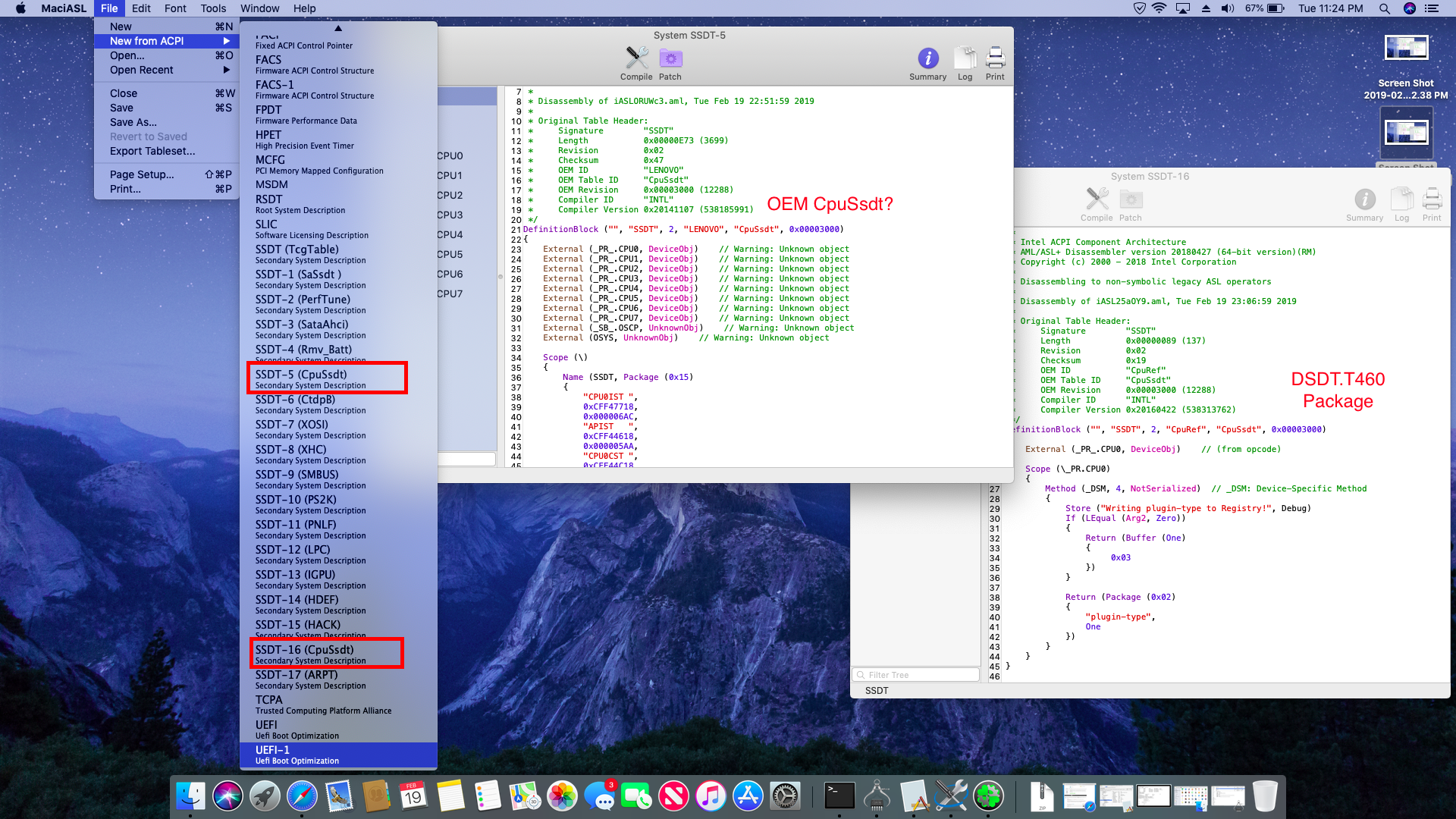

I am using the v2019.1.24 release for my Lenovo T460 and everything is working. However, when I saw the kexts loaded, X86PlatformPlugin doesn't seem to be loaded but ACPI_SMC_PlatformPlugin. The laptop is otherwise running smooth.
Is this the correct behavior or something is missing. I did generate and using my own DSDTs using the included DSDT.T460 package.
Hi @tluck
Please see my above message. Yesterday the x86platformplugin was not loaded. However today when I checked, x86platformplugin is loaded.
Then when I checked the available SSDTs from MaciASL, I see that there were two entries for CpuSsdt. One is the OEM version and other one is from your DSDT.T460 package. See the screenshot below.
Could that be the reason for the random behavior for x86platformplugin. I see that DropOem=false in your config.plist. If this is the problem, how can I remove only this CpuSsdt?

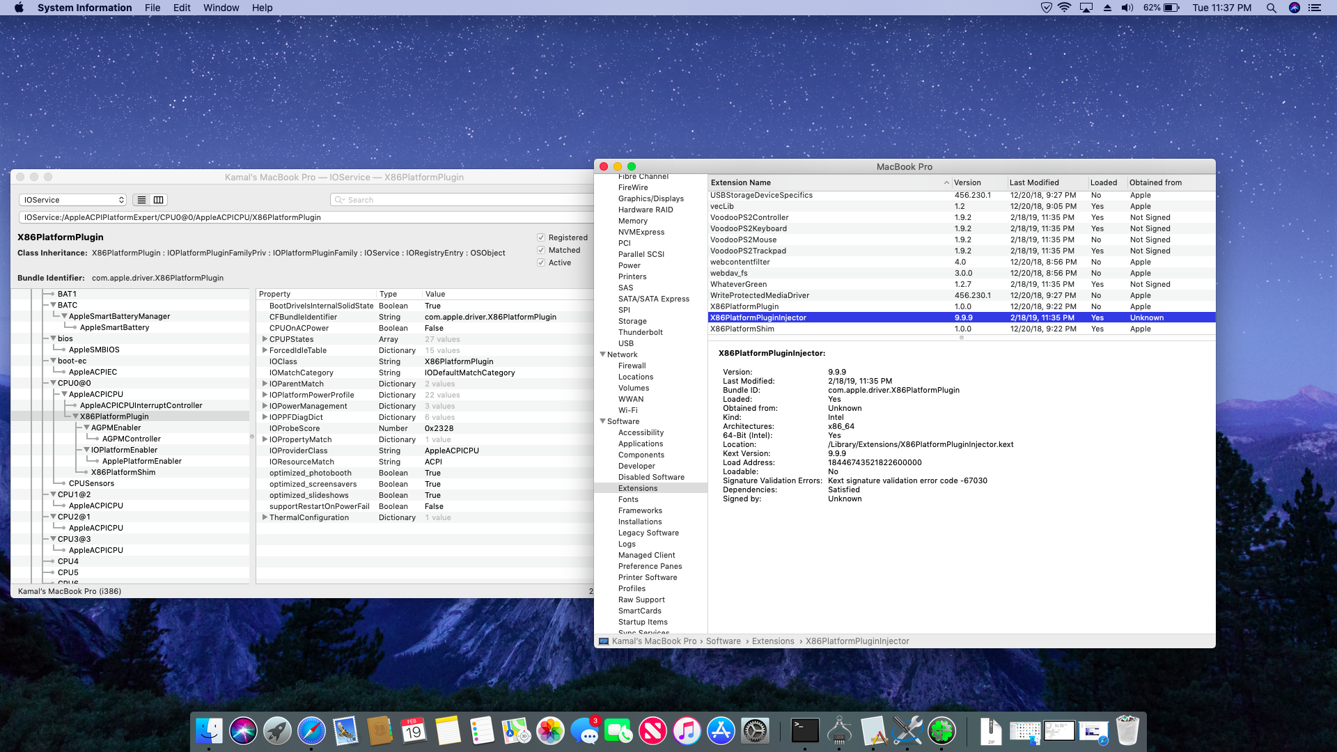

Nope. I'm confused. I see this in System Report which suggests that X86PlatformPlugin is not loaded. But then IORegistryViewer Shows X86PlatformPlugin properly attached to CPU0. What is correct?

On 2/20/2019 at 9:51 AM, nijhawank said:
anybody ???
if you see plugin-type =1 and X86PlatformPlugin on CPU0 you should be ok
you should see something like this on the commandline
$ ioreg -l|grep plugin-type
    | | |   "plugin-type" = 1
    | | |   |   "IOParentMatch" = {"IOPropertyMatch"={"plugin-type"=1},"IOProviderClass"="IOACPIPlatformDevice"}
$ ioreg -l|grep CPUPSta
    | | |   |   "CPUPStates" = ({"Frequency"=3800,"PState"=0},{"Frequency"=3700,"PState"=1},{"Frequency"=3600,"PState"=2},{"Frequency"=3500,"PState"=3},{"Frequency"=3400,"PState"=4},{"Frequency"=3300,"PState"=5},{"Frequency"=3200,"PState"=6},{"Frequency"=3100,"PState"=7},{"Frequency"=3000,"PState"=8},{"Frequency"=2900,"PState"=9},{"Frequency"=2800,"PState"=10},{"Frequency"=2700,"PState"=11},{"Frequency"=2600,"PState"=12},{"Frequency"=2500,"PState"=13},{"Frequency"=2400,"PState"=14},{"Frequency"=2300,"PState"=15},{"Frequency"=2200,"PState"=16},{"Frequency"=2100,"PState"=17},{"Frequency"=2000,"PState"=18},{"Frequency"=1900,"PState"=19},{"Frequency"=1800,"PState"=20},{"Frequency"=1700,"PState"=21},{"Frequency"=1600,"PState"=22},{"Frequency"=1500,"PState"=23},{"Frequency"=1400,"PState"=24},{"Frequency"=1300,"PState"=25},{"Frequency"=1200,"PState"=26},{"Frequency"=1100,"PState"=27},{"Frequency"=1000,"PState"=28},{"Frequency"=900,"PState"=29},{"Frequency"=800,"PState"=30})
$ kextstat|grep -i x86
  110    1 0xffffff7f827d4000 0x17000    0x17000    com.apple.driver.X86PlatformPlugin (1.0.0) C8EB8538-6D03-3B0A-99E4-BEF44E1A97A7 <109 91 23 14 12 8 7 6 5 3 1>
  156    1 0xffffff7f827eb000 0x7000     0x7000     com.apple.driver.X86PlatformShim (1.0.0) B69E0EB3-0C17-3332-A4DB-B06FEAD4713E <110 109 14 8 5 3>
