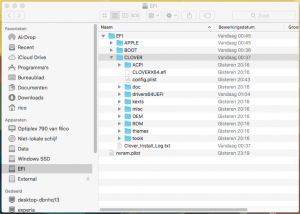

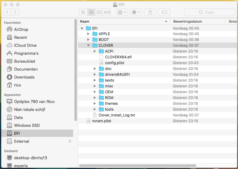

Guest ricoc90 Posted October 24, 2017 Share Posted October 24, 2017 @Chris1111: I'm running my optiplex 790 on UEFI straight from the EFI partition now (so no need to create a seperate partition to install Clover on). I don't know why, but as I said back then I couldn't navigate the EFI because it'd make the BIOS freeze and the GUI would get malformed. Also it wouldn't boot from BOOTX64. Apparently that has to do with the EFI partition itself, not sure why though. I reformatted the EFI partition and reinstalled Clover without luck: same freezing issue. Then I ran fsck_msdos a couple of times and now I'm able to boot BOOTX64 without any issues Link to comment https://www.insanelymac.com/forum/topic/312656-guide-macos-sierra-1012-dell-optiplex-780-760-755-790-990/page/51/#findComment-2521807 Share on other sites More sharing options...
chris1111 Posted October 24, 2017 Share Posted October 24, 2017 @Chris1111: I'm running my optiplex 790 on UEFI straight from the EFI partition now (so no need to create a seperate partition to install Clover on). I don't know why, but as I said back then I couldn't navigate the EFI because it'd make the BIOS freeze and the GUI would get malformed. Also it wouldn't boot from BOOTX64. Apparently that has to do with the EFI partition itself, not sure why though. I reformatted the EFI partition and reinstalled Clover without luck: same freezing issue. Then I ran fsck_msdos a couple of times and now I'm able to boot BOOTX64 without any issues Schermafbeelding 2017-10-24 om 15.59.30.png do you have a background boot GUI to large compare to ESP Legacy ? Link to comment https://www.insanelymac.com/forum/topic/312656-guide-macos-sierra-1012-dell-optiplex-780-760-755-790-990/page/51/#findComment-2522080 Share on other sites More sharing options...
Guest ricoc90 Posted October 24, 2017 Share Posted October 24, 2017 do you have a background boot GUI to large compare to ESP Legacy ? The verbose text just before the Clover GUI comes up (like AFPS logs and such) are really large But other than that it's fine. Clover's GUI itself as well as the actual boot process is 1080p Used CsmVideoDxe to get rid of the APFS logs, so it's not really bothering to me Link to comment https://www.insanelymac.com/forum/topic/312656-guide-macos-sierra-1012-dell-optiplex-780-760-755-790-990/page/51/#findComment-2522083 Share on other sites More sharing options...
