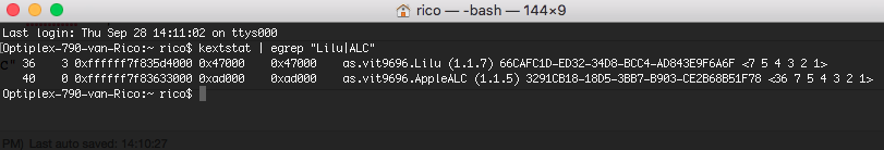

lucsansag Posted September 28, 2017 Share Posted September 28, 2017 My output of kextstat | egrep "Lilu|ALC": DSDT: Audio still not working. Link to comment https://www.insanelymac.com/forum/topic/312656-guide-macos-sierra-1012-dell-optiplex-780-760-755-790-990/page/49/#findComment-2503418 Share on other sites More sharing options...

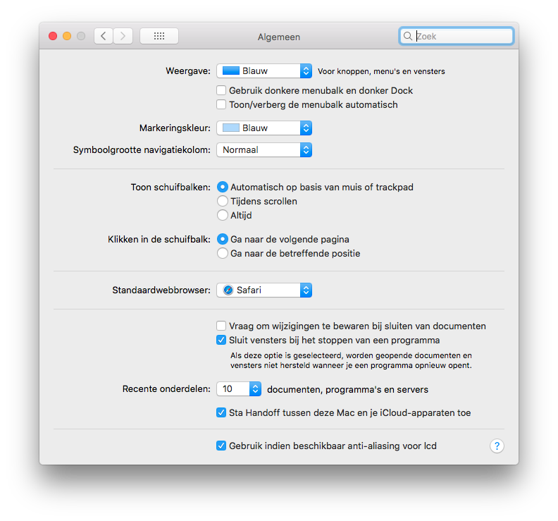

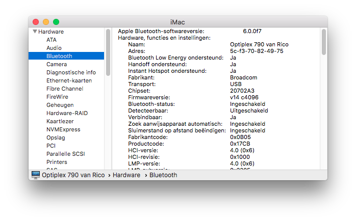

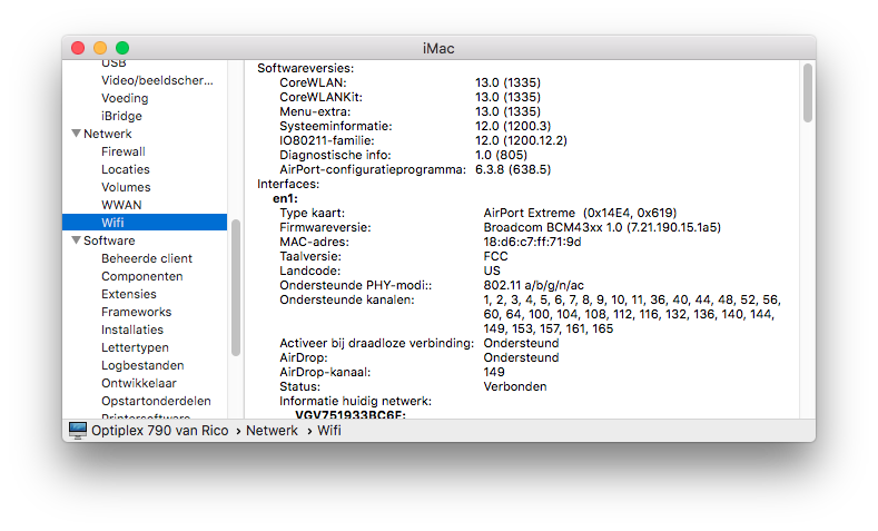

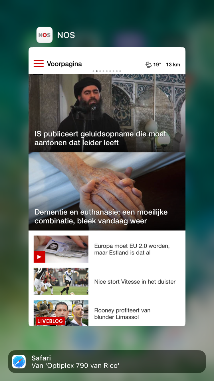

Guest ricoc90 Posted September 28, 2017 Share Posted September 28, 2017 So, for anyone interested... As i posted some time ago, I managed to get handoff + continuity supported by using the TP-Link Archer T6E low-profile PCIe wifi card and Asus BT400 USB Bluetooth dongle. However, this didn't quite work OOB. The wiFi card wasn't recognized within macOS at all which required a bunch of patches and the USB Bluetooth dongle needed a patch to enable handoff. Well, within High Sierra this changed drastically, in a positive way. The WiFi works as Airport OOB, so does handoff support on the Asus BT400!No patches needed anymore AT ALL on that matter. The only issue is that High Sierra introduced two new kexts: BrcmNIC and BrcmNIC-MFG, which the Archer T6E drives on. However, in order to use handoff you'll need Brcm4360 to load rather than the other two. In Sierra, The Archer T6E's DeviceID actually was in the Brcm4360 kext, but this is not the case in High Sierra. So, I went for a little DSDT patch: Method (_DSM, 4, NotSerialized) // { Store (Package (0x0C) { "model", Buffer (0x2D) { "Wireless Network Adapter (802.11 a/b/g/n/ac)" }, "device_type", Buffer (0x08) { "AirPort" }, "built-in", Buffer (One) { 0x00 }, "name", Buffer (0x10) { "AirPort Extreme" }, "AAPL,slot-name", Buffer (0x09) { "Built In" }, "compatible", Buffer (0x0D) { "pci14e4,4353" // original id = pci14e4,43a0 } }, Local0) DTGP (Arg0, Arg1, Arg2, Arg3, RefOf (Local0)) Return (Local0) } Which loads up Brcm4360 and voila: Handoff+Continuity works Link to comment https://www.insanelymac.com/forum/topic/312656-guide-macos-sierra-1012-dell-optiplex-780-760-755-790-990/page/49/#findComment-2503519 Share on other sites More sharing options...

Guest ricoc90 Posted September 29, 2017 Share Posted September 29, 2017 Finally, when the upgrade finished, I had to boot from my unmodified, existing installation of Sierra (I cloned my sierra installation to a different internal hard drive and I upgraded from there, to play it safe) and replace the HD5450 rollback drivers, as the screen was black. That means that I need a spare working Hackintosh installation every time a High Sierra update is released so that I can replace my graphics drivers? Thanks for all your help No. You can boot into safe mode (-x) and replace the kexts from there Link to comment https://www.insanelymac.com/forum/topic/312656-guide-macos-sierra-1012-dell-optiplex-780-760-755-790-990/page/49/#findComment-2503747 Share on other sites More sharing options...

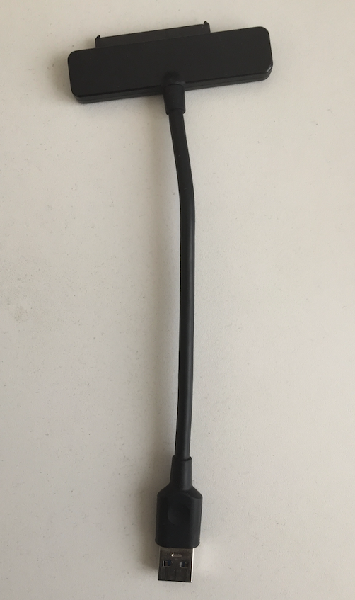

MacPeet Posted September 29, 2017 Author Share Posted September 29, 2017 @ernani statement for LayoutID13: internal Speaker is rear / green, intended for external speakers front / green is intended for headphones (automatic changeover) when you plug HP Subject Rollback: My SSD is only loose in the Optiplex780. I use this adapter and change the kexte over a second computer. very easy red registration screen after rollback: Yes I've got that too. Also on my real MacPro3.1 with HD5770 and Roolback a red login screen. So far no solution. Private messages in this forum: Sorry, no support via private mail. Please use the thread. Support via private mail only for my best friends here. This will be too much for me, sorry. Sleep: Sleep does not interest me very much. No, sleep does not work with me either with High Sierra. He goes cleanly into the sleep, but after waking up - black screen. I still have no solution. Link to comment https://www.insanelymac.com/forum/topic/312656-guide-macos-sierra-1012-dell-optiplex-780-760-755-790-990/page/49/#findComment-2504323 Share on other sites More sharing options...
lucsansag Posted September 29, 2017 Share Posted September 29, 2017 I've got audio working again with the last AppleALC @MacPeet posted.I don't use a mic so I'm fine with just output. 1 Link to comment https://www.insanelymac.com/forum/topic/312656-guide-macos-sierra-1012-dell-optiplex-780-760-755-790-990/page/49/#findComment-2504395 Share on other sites More sharing options...
