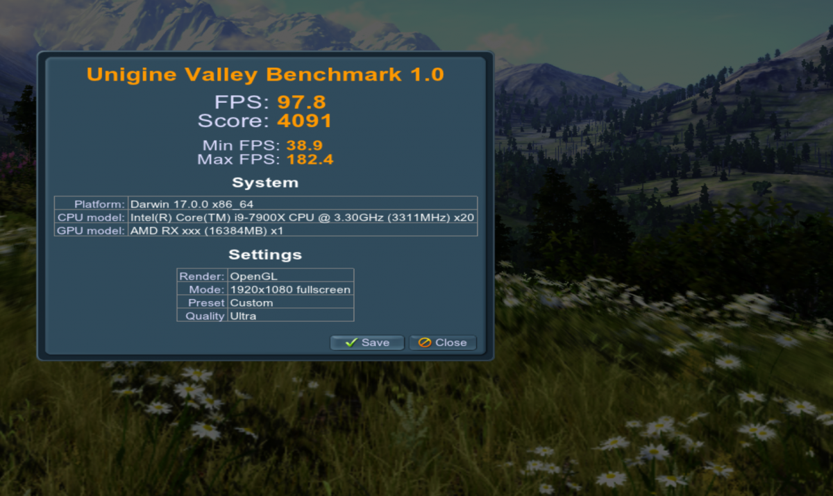

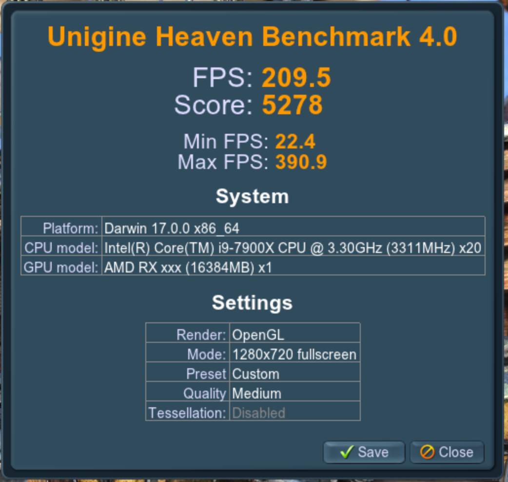

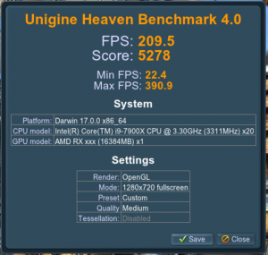

Gigamaxx Posted August 15, 2017 Share Posted August 15, 2017 I got that in Heaven benchmark as well, so am pretty sure it's a driver thing. Haven't tried HDMI, but my boot screen is always the 2nd DP port. One weird thing I do get is a complete freeze sometimes. I think it's GPU because there's a bank of lights near the power connectors on the GPU which all go blue (max power) and the GPU gets hot. I noticed that the Drivers are setting my Frequency at 1630MHz and my card is rated at 1547MHz (air cooled). maybe Apple plans to use the liquid cooled variants in the Mac Pro. They are set to 1630 for boost clock speed. See the Luxmark bench below frequency 1630MHz. My fan spins like crazy and the tachometer pegs out to max for most of the bench, but when its done it calls down quickly and temps drop fast, thanks to "AutoWattMan". I figure we should be getting at least 28,000 for Luxmark Ball bench. 1 Link to comment https://www.insanelymac.com/forum/topic/312582-amd-polaris-ids-on-sierra-high-sierra/page/27/#findComment-2479900 Share on other sites More sharing options...

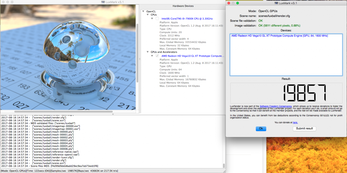

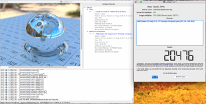

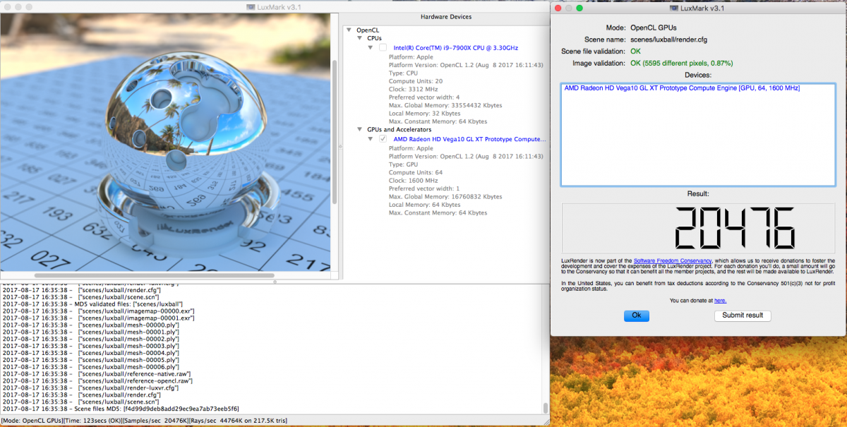

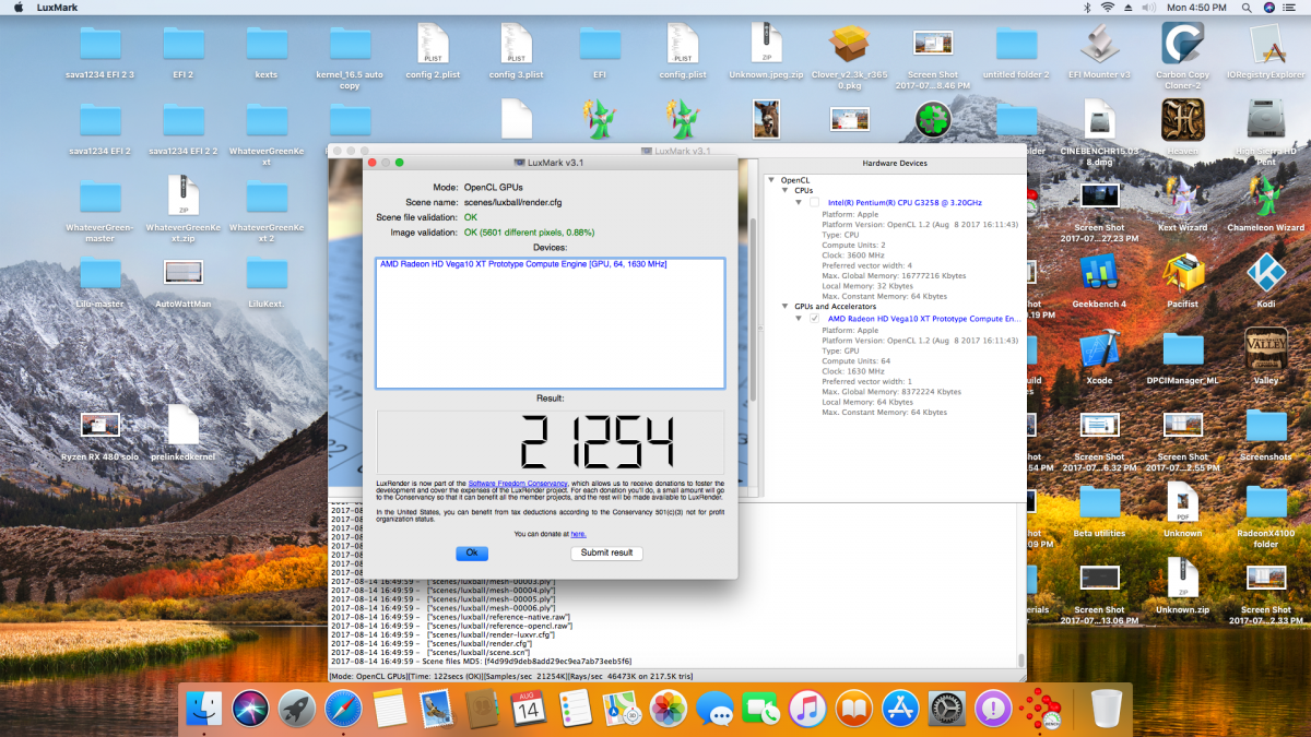

surfinchina Posted August 16, 2017 Share Posted August 16, 2017 I noticed that the Drivers are setting my Frequency at 1630MHz and my card is rated at 1547MHz (air cooled). maybe Apple plans to use the liquid cooled variants in the Mac Pro. They are set to 1630 for boost clock speed. See the Luxmark bench below frequency 1630MHz. My fan spins like crazy and the tachometer pegs out to max for most of the bench, but when its done it calls down quickly and temps drop fast, thanks to "AutoWattMan". I figure we should be getting at least 28,000 for Luxmark Ball bench. Yes the noise isn't so great. I've got an EK water block on pre-order, due next week I'm getting GPU freeze, but not on full noise, it seems to be video playback in Chrome related. Maybe java? edit: I just ran luxmark and mine is showing 1600MHz and the score is lower than yours... edit 2: My device id is showing as 0x68631002. Yours is? 1 Link to comment https://www.insanelymac.com/forum/topic/312582-amd-polaris-ids-on-sierra-high-sierra/page/27/#findComment-2480098 Share on other sites More sharing options...
Gigamaxx Posted August 16, 2017 Share Posted August 16, 2017 Yes the noise isn't so great. I've got an EK water block on pre-order, due next week I'm getting GPU freeze, but not on full noise, it seems to be video playback in Chrome related. Maybe java? edit: I just ran luxmark and mine is showing 1600MHz and the score is lower than yours... Screenshot 2017-08-16 14.57.59.png edit 2: My device id is showing as 0x68631002. Yours is? 0x687F1002, Gigabyte RX Vega 64 8gb. You have the Frontier Edition 16gb correct? Have you tried Uningine using custom mode and no anti-aliasing? My pentium G3258 system shows the Vega 64 with 24 bit color ARGB8888, but now with my Skylake i5 6500 I'm getting 30 bit ARGB210101010. What is your color bit? glview-ATI Radeon HD Vega10 XT Prototype OpenGL Engine.txt.zip 1002_687f_6b761002.rom.zip Link to comment https://www.insanelymac.com/forum/topic/312582-amd-polaris-ids-on-sierra-high-sierra/page/27/#findComment-2480120 Share on other sites More sharing options...

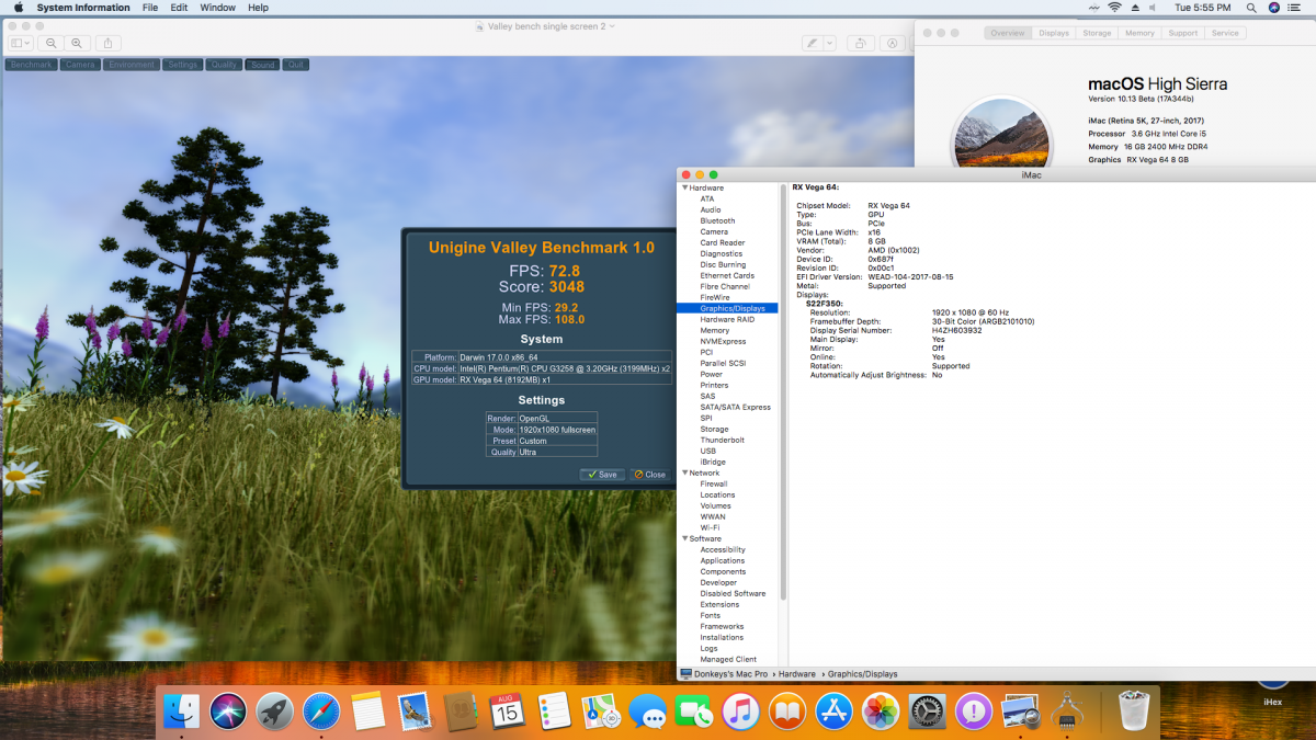

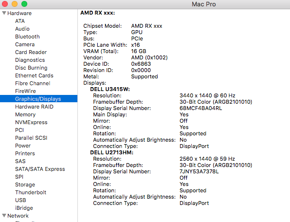

surfinchina Posted August 16, 2017 Share Posted August 16, 2017 0x687F1002, Gigabyte RX Vega 64 8gb. You have the Frontier Edition 16gb correct? Have you tried Uningine using custom mode and no anti-aliasing? My pentium G3258 system shows the Vega 64 with 24 bit color ARGB8888, but now with my Skylake i5 6500 I'm getting 30 bit ARGB210101010. What is your color bit? About this Mac i5 6500 Vega 64.png Yes I have the frontier Edition. I think the CPU helps too... I'll download valley and do the same settings as you. (done) edit: Link to comment https://www.insanelymac.com/forum/topic/312582-amd-polaris-ids-on-sierra-high-sierra/page/27/#findComment-2480146 Share on other sites More sharing options...

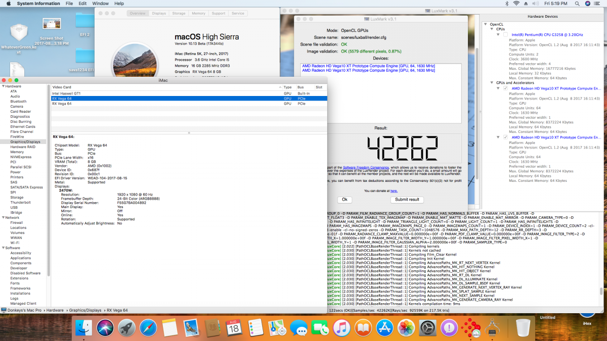

surfinchina Posted August 17, 2017 Share Posted August 17, 2017 I noticed that the Drivers are setting my Frequency at 1630MHz and my card is rated at 1547MHz (air cooled). maybe Apple plans to use the liquid cooled variants in the Mac Pro. They are set to 1630 for boost clock speed. See the Luxmark bench below frequency 1630MHz. My fan spins like crazy and the tachometer pegs out to max for most of the bench, but when its done it calls down quickly and temps drop fast, thanks to "AutoWattMan". I figure we should be getting at least 28,000 for Luxmark Ball bench. I tried this SMBIOS - iMac Pro 19.1 - from pike https://pikeralpha.wordpress.com/2017/06/07/2017-imac-pro-smbios-data/ and improved my GPU scores significantly. Nearly 20% on cinebench and the Luxmark as you see below. I can't see any improvement on my CPU though. Hopefully the OS X drivers will mature with time... 1 Link to comment https://www.insanelymac.com/forum/topic/312582-amd-polaris-ids-on-sierra-high-sierra/page/27/#findComment-2480728 Share on other sites More sharing options...

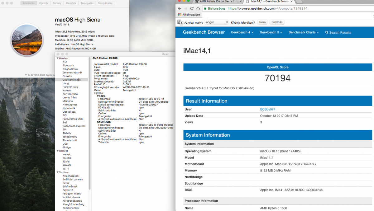

BCBoy1 Posted October 13, 2017 Share Posted October 13, 2017 Hi! Whatevergreen and Lilu.kext works well with me too! Gigabyte RX460 4 gb! 1 Link to comment https://www.insanelymac.com/forum/topic/312582-amd-polaris-ids-on-sierra-high-sierra/page/27/#findComment-2515102 Share on other sites More sharing options...
