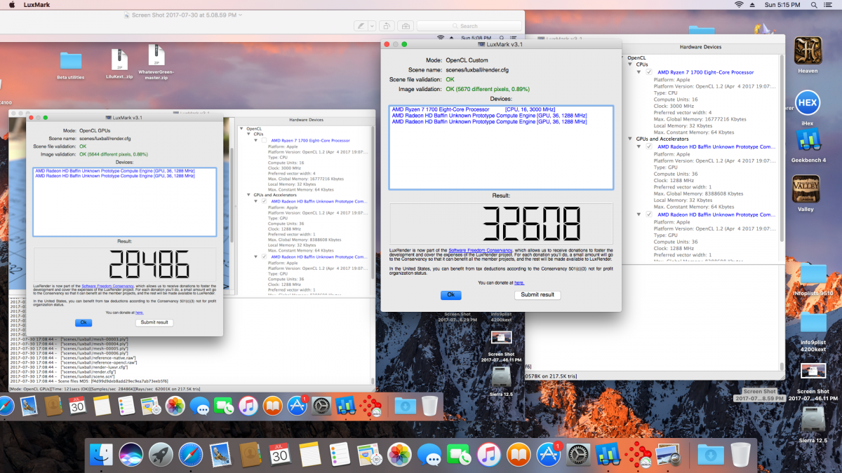

Picasso Posted August 1, 2017 Share Posted August 1, 2017 @ Gigamaxx Thanks for the input, in a couple of hours I will try your suggestions. Can you post the luxmark ball scene of 460? with the value it's ok. No necesary upload the image. Link to comment https://www.insanelymac.com/forum/topic/312582-amd-polaris-ids-on-sierra-high-sierra/page/25/#findComment-2472640 Share on other sites More sharing options...

Gigamaxx Posted August 1, 2017 Share Posted August 1, 2017 @ Gigamaxx Thanks for the input, in a couple of hours I will try your suggestions. Can you post the luxmark ball scene of 460? with the value it's ok. No necesary upload the image. My Gigabyte RX 460 4gb just did a 6399 in Lexmark ball in High Sierra Pentium G3258 with the lilu and green kexts. My best score was around 6900 in Sierra with an i5 6500 CPU. 1 Link to comment https://www.insanelymac.com/forum/topic/312582-amd-polaris-ids-on-sierra-high-sierra/page/25/#findComment-2472647 Share on other sites More sharing options...
