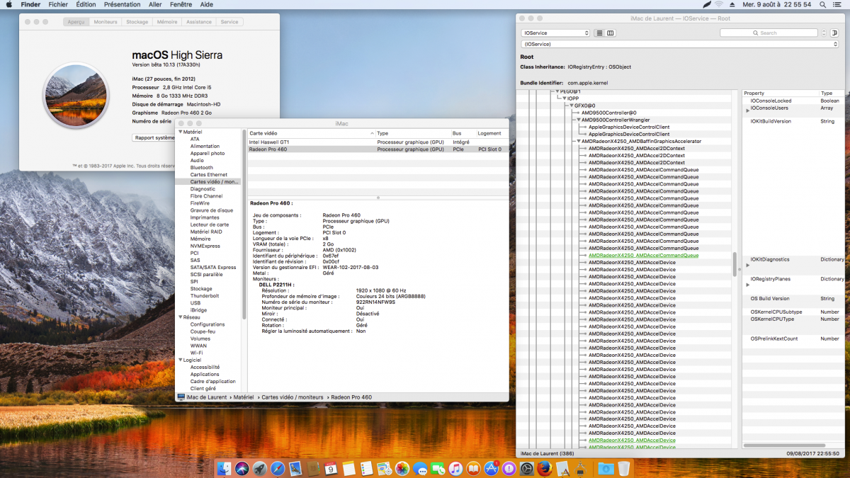

Loloflat6 Posted August 9, 2017 Share Posted August 9, 2017 Here my radeon report : Link to comment https://www.insanelymac.com/forum/topic/312582-amd-polaris-ids-on-sierra-high-sierra/page/26/#findComment-2477008 Share on other sites More sharing options...

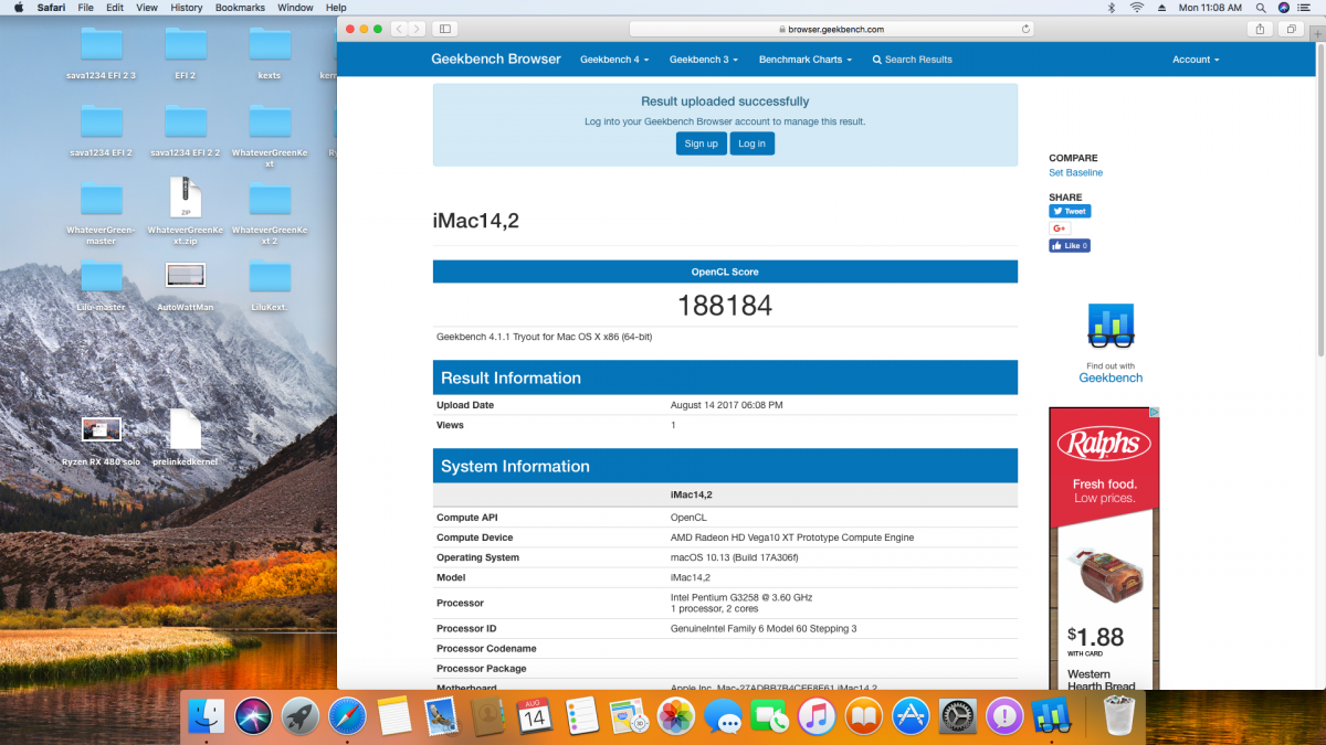

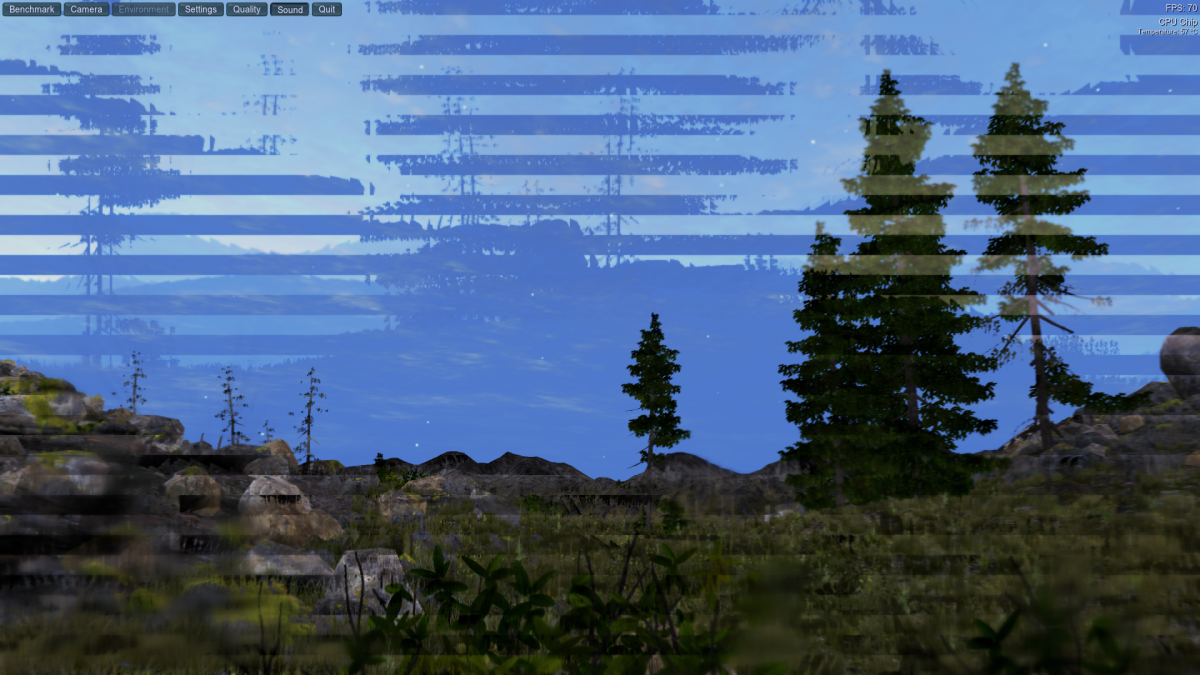

Gigamaxx Posted August 14, 2017 Share Posted August 14, 2017 AMD RX Vega 64 8gb, Gigabyte reference model is working High Sierra beta with no clover fixes or injections IGPU is disabled. Name is R9 xxx same as frontier edition, Geekbench is about the same. Some buggy red graphics glitches in about this Mac for some reason. Open Gl bugs, need to fix my Skylake rig to use the iMac 18.3 definition. 1 Link to comment https://www.insanelymac.com/forum/topic/312582-amd-polaris-ids-on-sierra-high-sierra/page/26/#findComment-2479126 Share on other sites More sharing options...

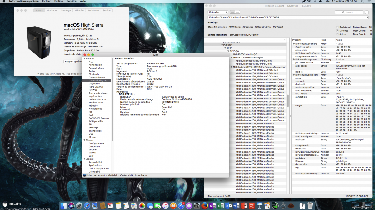

Loloflat6 Posted August 14, 2017 Share Posted August 14, 2017 After some change in my config.plist : PEG as primary Link to comment https://www.insanelymac.com/forum/topic/312582-amd-polaris-ids-on-sierra-high-sierra/page/26/#findComment-2479183 Share on other sites More sharing options...
vandroiy2012 Posted August 15, 2017 Share Posted August 15, 2017 AMD RX Vega 64 8gb, Gigabyte reference model is working High Sierra beta with no clover fixes or injections IGPU is disabled. Name is R9 xxx same as frontier edition, Geekbench is about the same. Some buggy red graphics glitches in about this Mac for some reason. Open Gl bugs, need to fix my Skylake rig to use the iMac 18.3 definition. Hi. Please try this WhateverGreen. WhateverGreen.kext.zip Add Vega 64 and Vega Frontier Edition identifiers and fix Prototype OpenCL/OpenGL engine names (see FAQ) 1 Link to comment https://www.insanelymac.com/forum/topic/312582-amd-polaris-ids-on-sierra-high-sierra/page/26/#findComment-2479249 Share on other sites More sharing options...

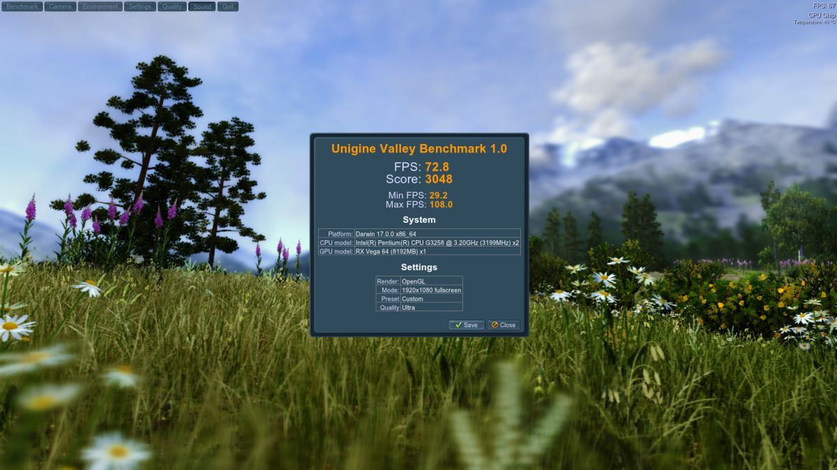

Gigamaxx Posted August 15, 2017 Share Posted August 15, 2017 Hi. Please try this WhateverGreen. WhateverGreen.kext.zip Add Vega 64 and Vega Frontier Edition identifiers and fix Prototype OpenCL/OpenGL engine names (see FAQ) Will do, I just copied my disk and am running benches. My first boot had the previous version, and now I'm running without. I have only been able to get 24 bit color, would like to get at least 32 bit and ultimately 30 bit 2101010. I will download it and load it and report back. Update: I loaded whateverGreenKext and booted. I get Green screen after boot, I unplug HDMI and reattach and screen loads. The green screen was random before but now is 3 boot cycles in a row. Vega 64 IOReg WhateverGreen HS 6.zip bootlog.log.txt.zip Link to comment https://www.insanelymac.com/forum/topic/312582-amd-polaris-ids-on-sierra-high-sierra/page/26/#findComment-2479277 Share on other sites More sharing options...
vandroiy2012 Posted August 15, 2017 Share Posted August 15, 2017 Will do, I just copied my disk and am running benches. My first boot had the previous version, and now I'm running without. I have only been able to get 24 bit color, would like to get at least 32 bit and ultimately 30 bit 2101010. I will download it and load it and report back. Update: I loaded whateverGreenKext and booted. I get Green screen after boot, I unplug HDMI and reattach and screen loads. The green screen was random before but now is 3 boot cycles in a row. Green screen is unfortunately currently out of WhateverGreen fixes, and the fact you see it with WhateverGreen installed is most likely just a coincidence caused by a boot delay or similar. To clarify, you got green screen with and without WhateverGreen, just the newer WhateverGreen made it appear way more frequently? I have several ideas on what could cause it, but nothing definite. It is either to do with connectors (perhaps encoder/transmitter or priority are unsuitable for HDMI), or some aty_config or aty_properties configuration is wrong. If you have enough time and skills you could try providing the following properties in all configurations via Arbitrary or ACPI: CFG,CFG_NVV Number 2 PP,PP_PhmUseDummyBackEnd Number 0 CFG,CFG_PTPL2_TBL Data <d2000000 cc000000 c6000000 c0000000 ba000000 b4000000 ae000000 a8000000 a2000000 9c000000 96000000 8c000000 82000000 78000000 6e000000 1e000000> They come from different frames from Vega drivers, and may well affect you green screen. Also you could try setting priority to HDMI by specifying connector-priority with hdmi sense id, or perhaps the opposite, you could make DP first, and HDMI second, some while ago it worked for 2xx series. 2 Link to comment https://www.insanelymac.com/forum/topic/312582-amd-polaris-ids-on-sierra-high-sierra/page/26/#findComment-2479703 Share on other sites More sharing options...
Gigamaxx Posted August 15, 2017 Share Posted August 15, 2017 I think it wants to use Displayport first, last night I connected 2 monitors one to Displayport via adapter and one HDMI. The DisplayPort acted as boot screen and initialized first, the HDMI screen activated later after boot but was not the Desktop screen with icons. Booting via Displayport only got rid of the Green screen issue. I did have random green screen with and without WhateverGreenkext, using HDMI port. It is most likely just an ironic coincidence that it is Green and not a blue screen. I think it may also be an issue with Vega drivers at this point, using Uningine Valley and Heaven benchmarks it has horizontal bars running across the screen. They are distortions of the screen image. If I disable Anti-Aliasing or (1080p x 8) feature the screen is perfect. Link to comment https://www.insanelymac.com/forum/topic/312582-amd-polaris-ids-on-sierra-high-sierra/page/26/#findComment-2479840 Share on other sites More sharing options...
